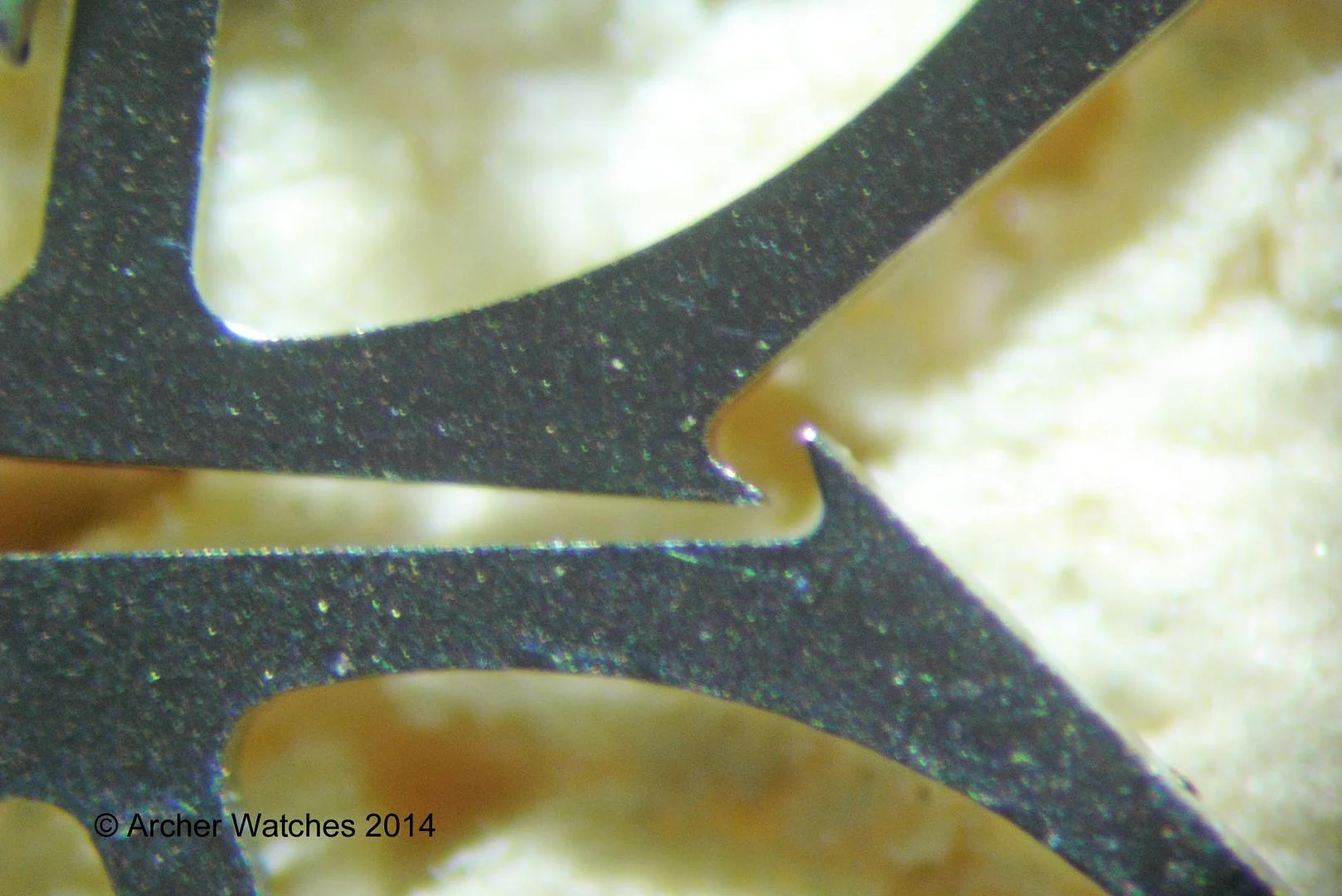

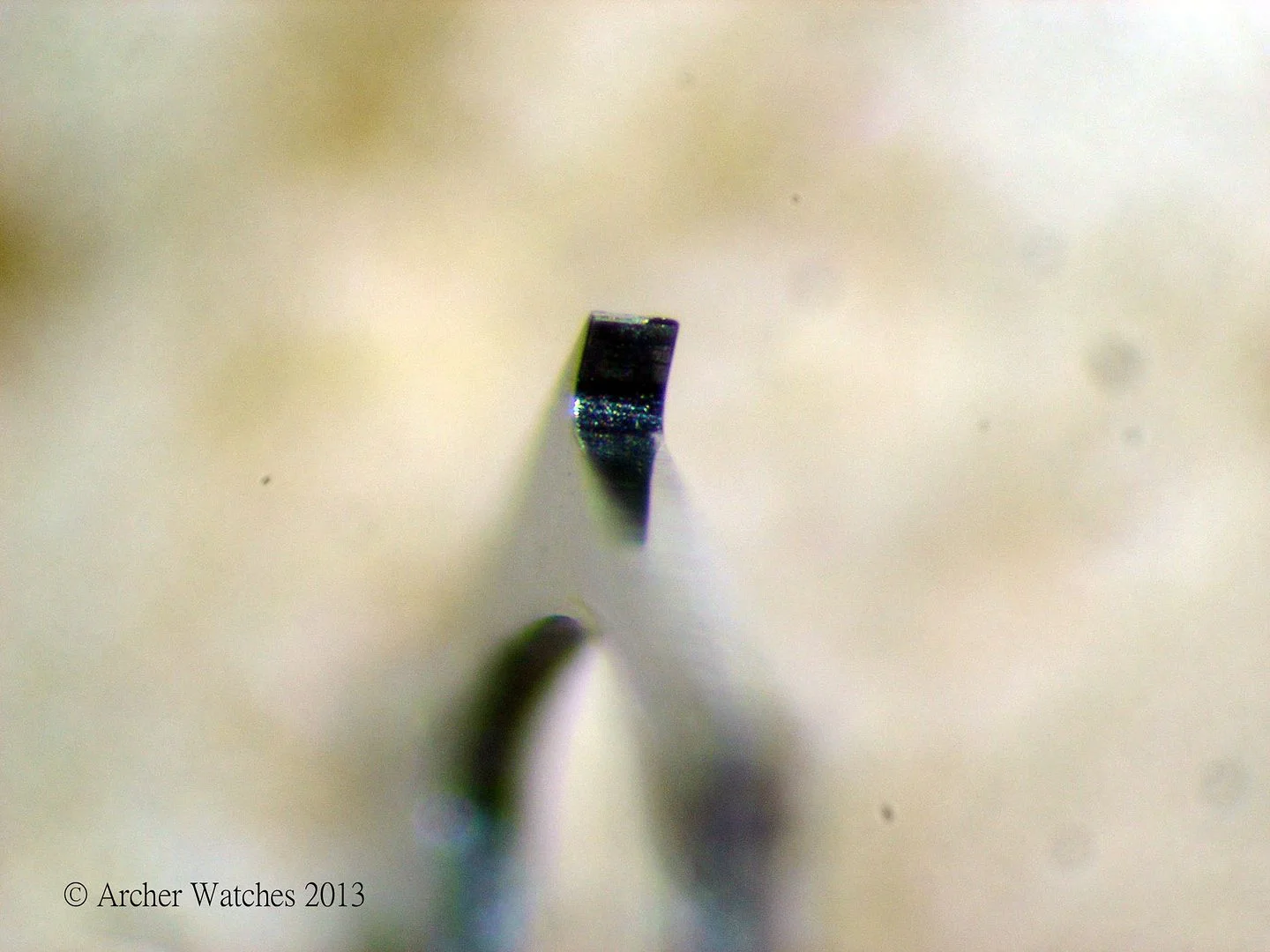

Certainly oils dry out, and that causes parts to wear. That is true no matter the type of escapement. He's also correct that the escape wheel and pallet fork in a lever escapement watch rarely wear out (if there is wear say on the escape wheel, it's usually on the pivots, not the surfaces involved in providing the impulse). The co-axial wheel and pallet fork in co-axial watches are often replaced - just look at any photo that someone posts of the parts that were returned with their watch from Omega, and you will nearly always see the co-axial wheel, and often the pallet fork.

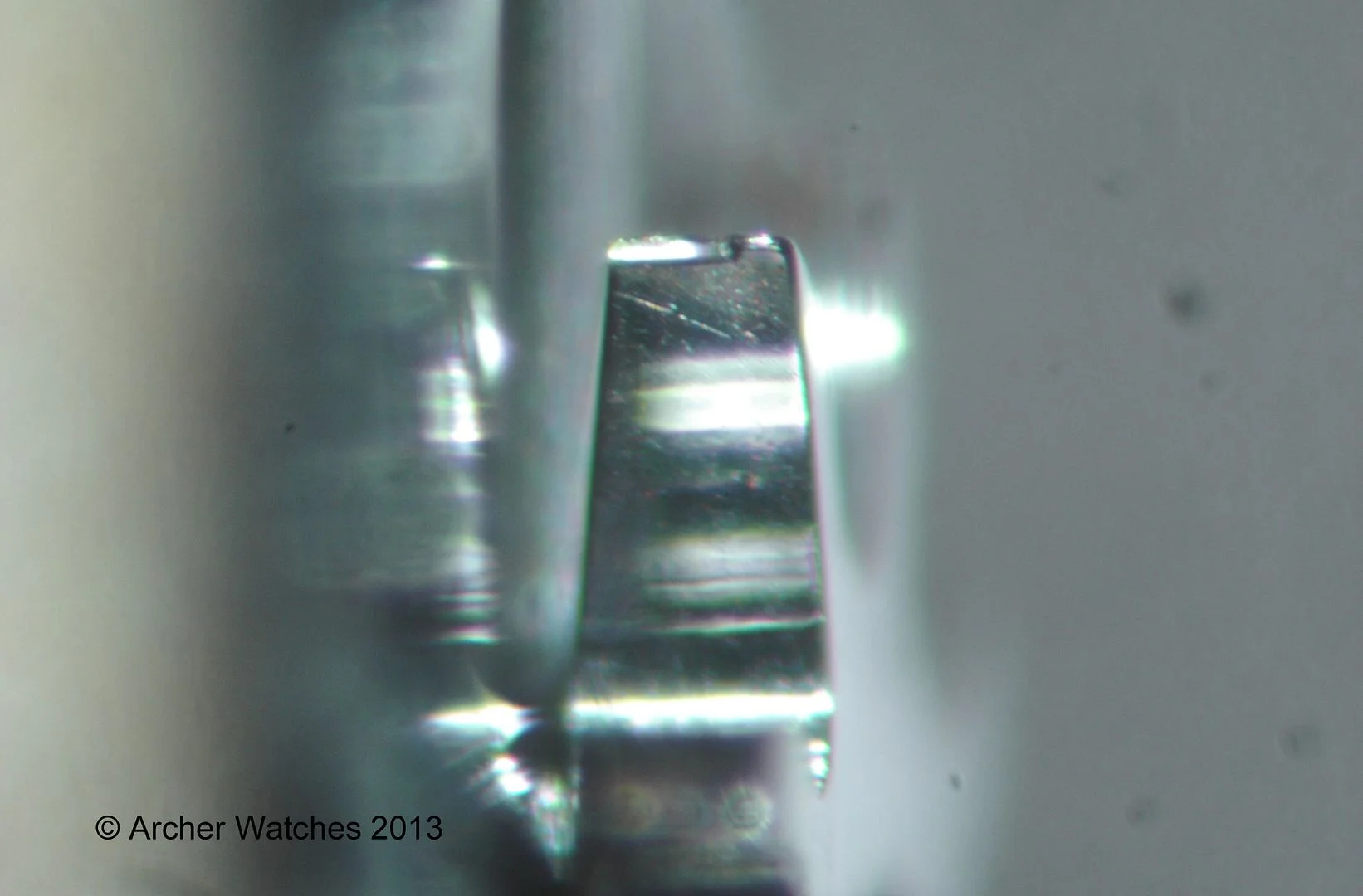

I saw this wear years ago...here's a co-axial wheel with the worn upper teeth:
New and old wheels - you can see some of the lower teeth on the old wheel are shorter:
Different view of the wear on the lower teeth:

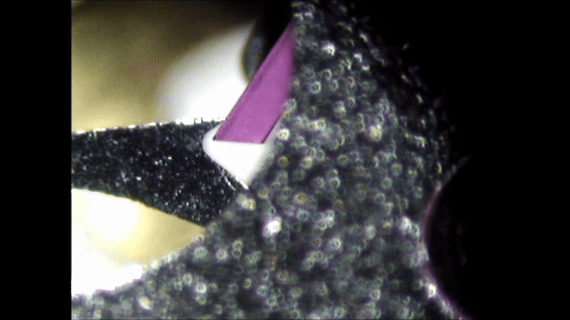

The oil that is applied to a co-axial escapement is, according to Omega and the training I received, there to cushion impacts, rather than reduce sliding friction. So if this is not for friction, how can the video claim that this oil drying up causes the wear? The reality is that the design of the co-axial is what causes the wear. This gif is of the interaction between the co-axial wheel teeth and the pallet fork jewel. If you watch the thin tip of the tooth go over the sharp edge of the pallet for jewel, it's not difficult to understand how the wear happens on these teeth:
The reality is, these will chew themselves up over time and they are pretty routinely replaced.

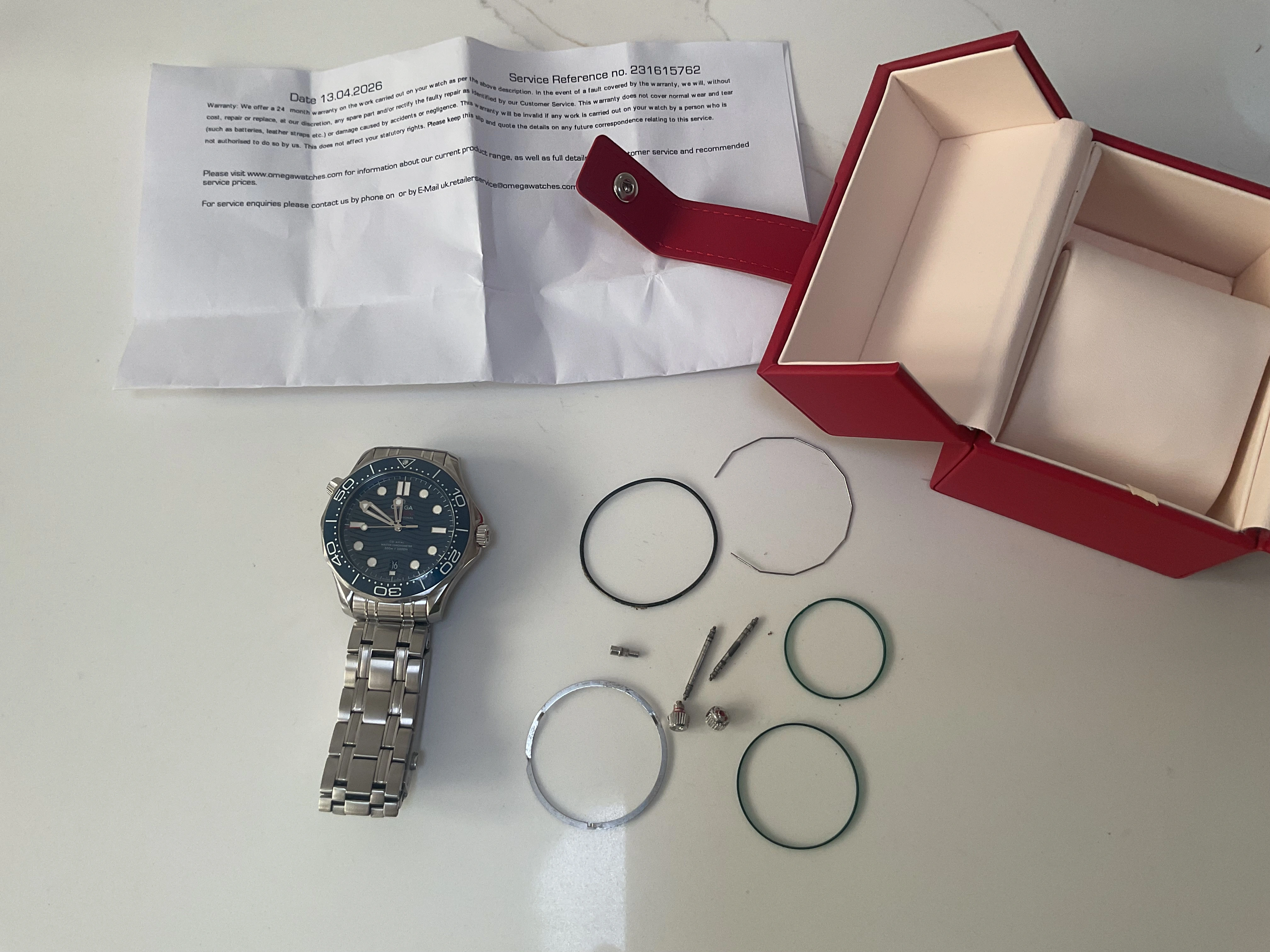

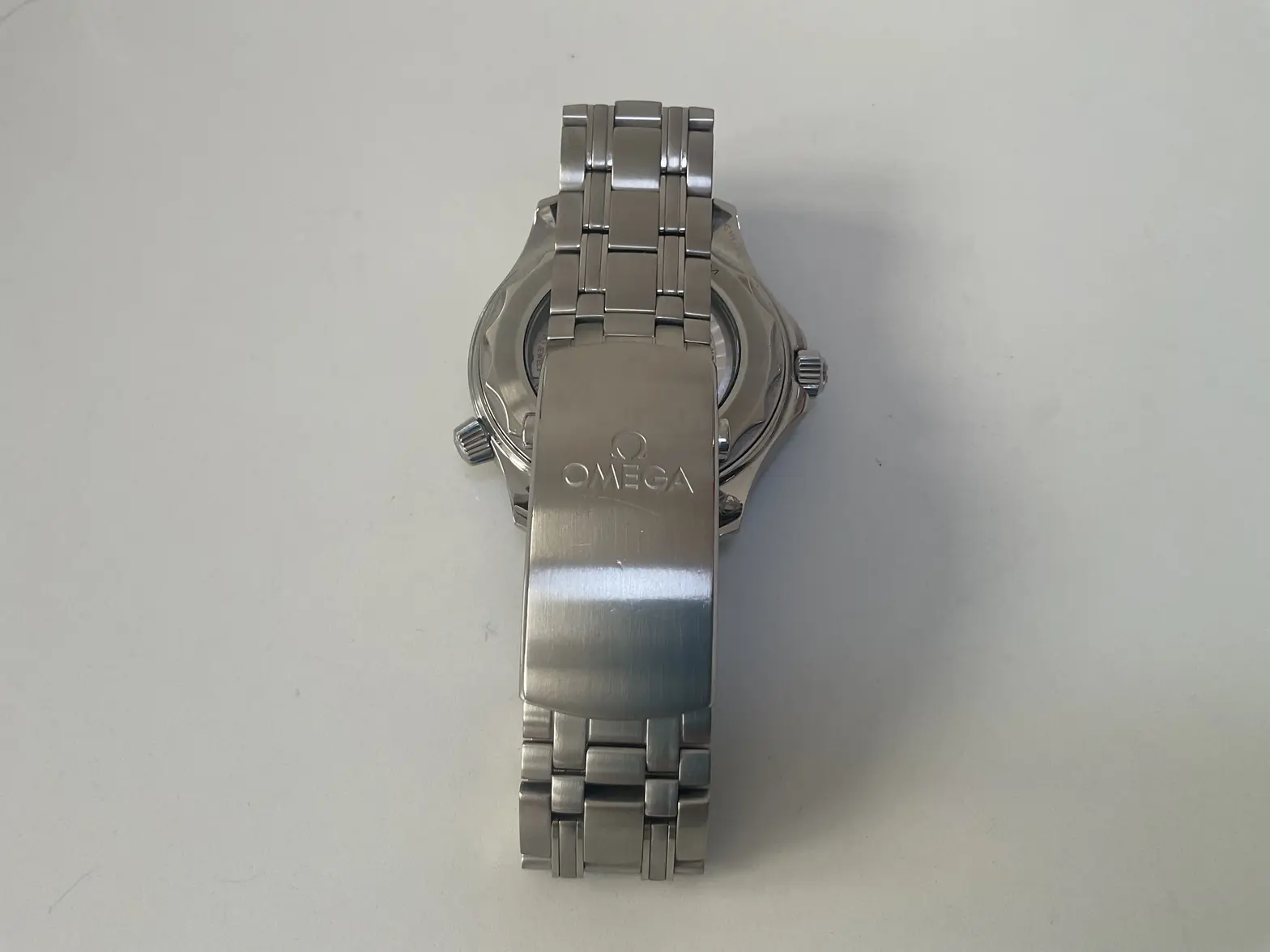

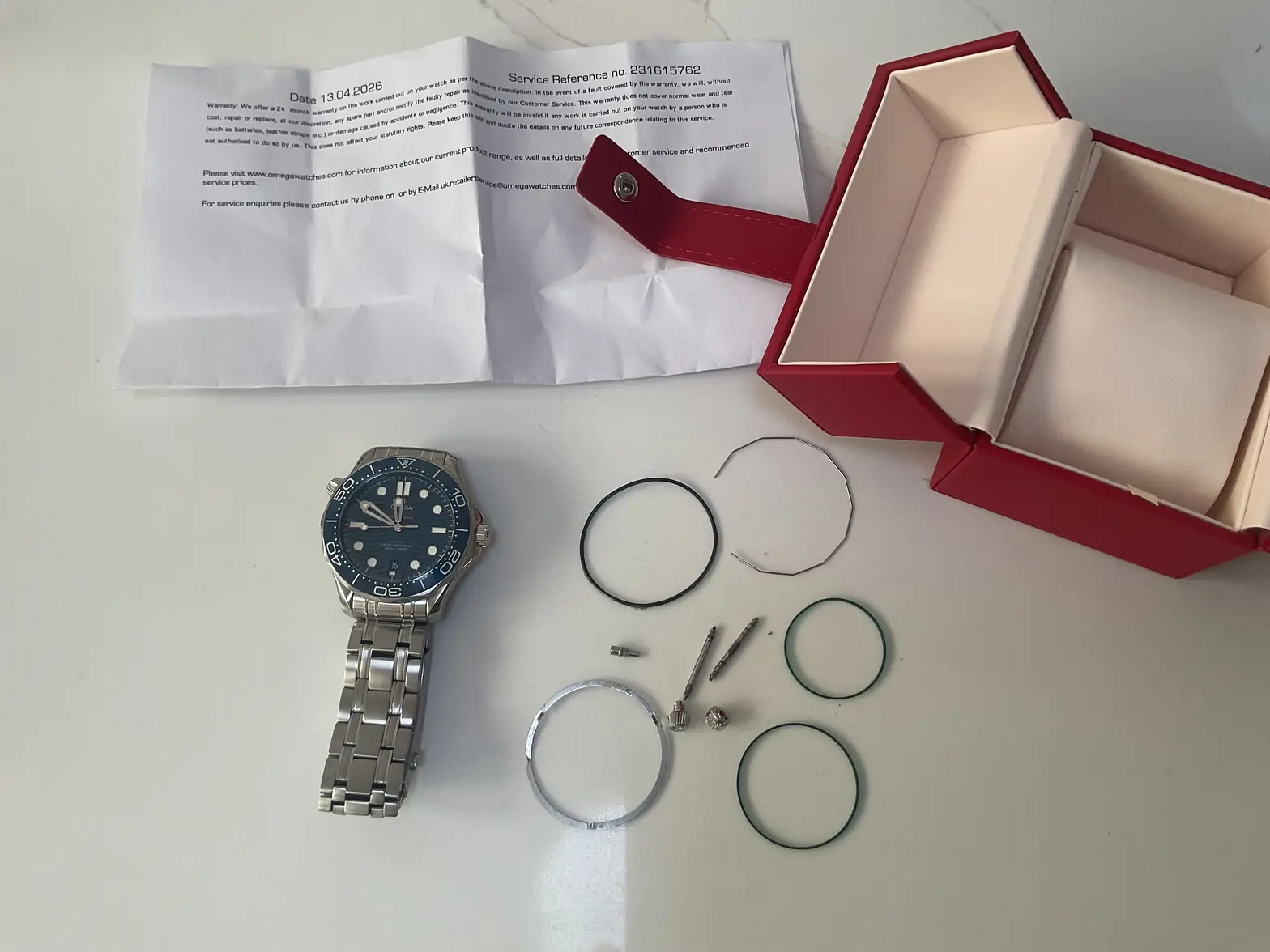

Well, it’s back. 24 weeks quoted back in 12ish so that’s good, £610 paid, now £650 so another plus.

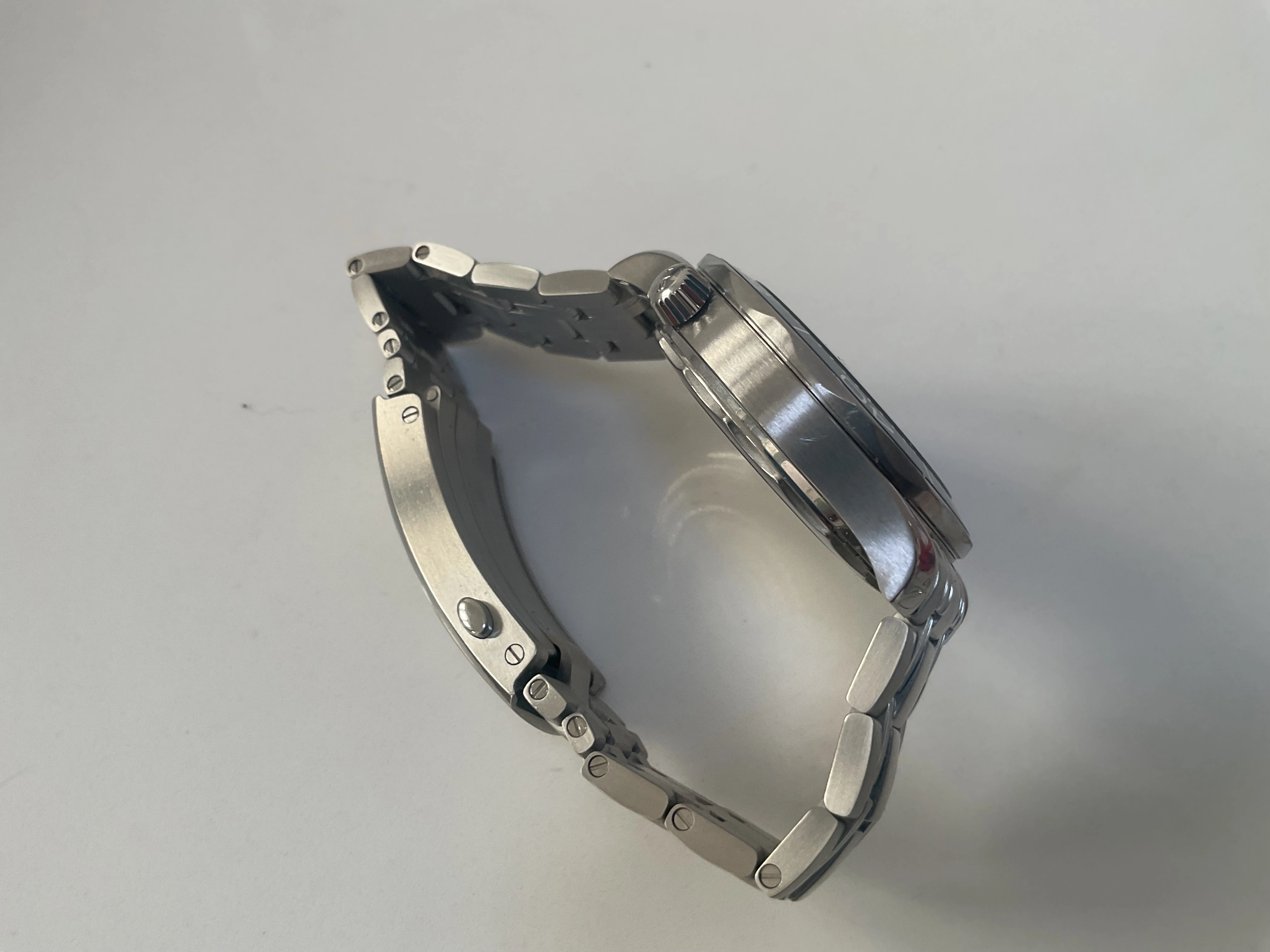

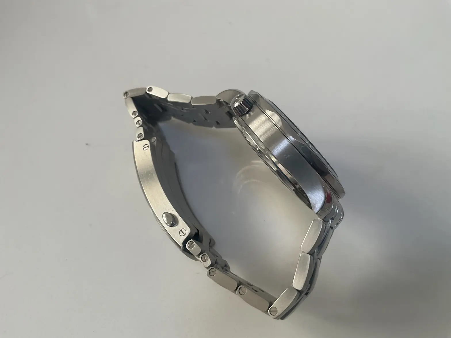

Watch looks good, not new but well improved after my 6 years of abuse. They polished out most of the damage on the ‘upper’ part of the case. The bracelet, not much short of miraculous.
No internal parts returned, the salesman said they don’t return innards anymore, I wonder why? (Takes off conspiracist hat and moves on). Also no guarantee card, as I was expecting, just a bit of A4.

Did they test it for Wateroopness?
1,853
4,466
2 year guarantee tells me they must have.
Definitely feels lighter on the wrist so helium replaced at service, too?
