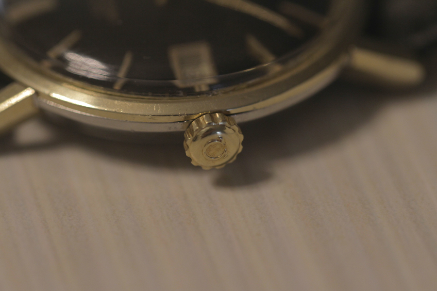

    I have an omega seamaster deville watch that I had sent out to get overhauled. The original crown had a loose washer in between the crown and case. The watchmaker doing the service replaced the crown (different from the original) and pin. Now, when the crown is pulled out to the third position to set the date, it's loose. This never happened with the original crown.
    Here is a video showing what happens.
    I'm also including the only image of the original crown I have from this watch. It's a bit blurry, but you can see it's not the same crown as the "new" one on the watch now.
    I contacted the watch repair person about it, but he insisted it was ok. But, I want to get the proper replacement crown and this problem fixed.
    Can anyone recommend someone that can handle this?
    I've taken my watch to several local people in my area and they all say they can't get the right part(s). Even though I gave them several places to look for them online....I'm baffled. Please help!

    It's not normal. The replacement crown likely has too large tube size, or something is wrong with the crown and stems. Crowns with the old style are still available, but I don't know if they will fit. Omega specified replacement crown is also definitely available from Omega or parts suppliers like CousinsUK or Ofrei. Here's one from Ofrei, based on my guess your watch model is 166.020: http://www.ofrei.com/page_147.html#8006.

    You should be able to bring it back to the watchmaker and say it's in no way normal. Ask him to show you anything normal like that. Then you can ask him if anything is wrong inside, take picture of the movement and inside case back, and ask him to get the correct crown.
    PS: if the person who did that job is not local to you then ask for some refund then find a local watchmaker. It's not a complicated job to replace the crown.

    There may be two issues at once here. First one is the crown is incorrect. Second is he only changed the outer, female part of the stem and kept the old inner one which could be worn out or rusted and therefore appears to not hold on to the outer part tightly. Did he say how many parts of the crown stem (pin) he changed and how much it cost?

    After confirming the issues with my watch and several attempts to find someone who could fix the problem, I was able to get this fixed correctly. The issue was an incorrect tube and wrong crown. I now have the correct tube and crown for the watch.
    Many thanks to TNTwatch and Al Archer for their assistance. The repair was done by a fairly new company in my area "The Jewelers Closet" aka: Neighborhood watch company.
    Here's an image with the new crown/tube.
