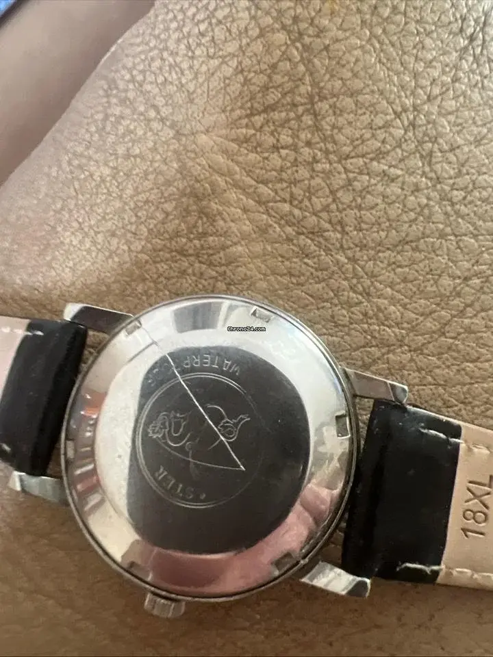

I am looking into getting an Omega Seamaster cal. 565 and found a watch that looks decent. But it has quite a dent/ break (?) on the back of the case.
Could anyone with more experience take a look at the picture and let me know if it is a big deal/ would affect the watch and price?
Thank you!!

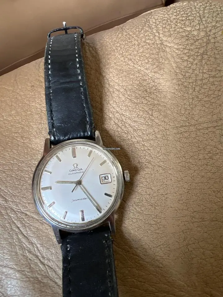

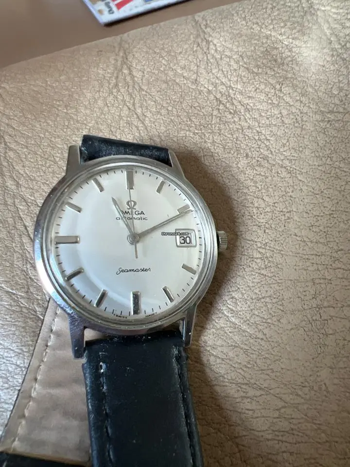

You should be more concered about the badly re-finished dial and the condition of the hands.

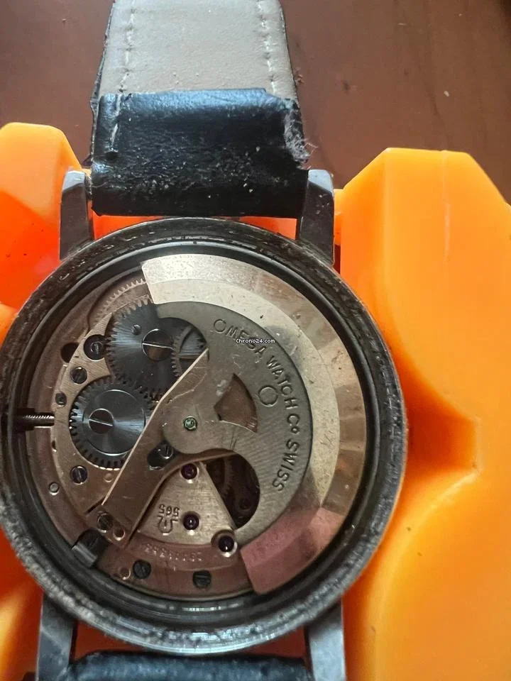

The movement also looks tired and is showing signs of rotor axle/bushing wear.
There's significant corrosion on the perphery of the case where the seal goes.

Very bad redial, the movement looks tired, wrong crown, case looks like a Geneve and not a Seamaster, don't buy this watch!
On the back you see scratch, probably from an opening attempt
