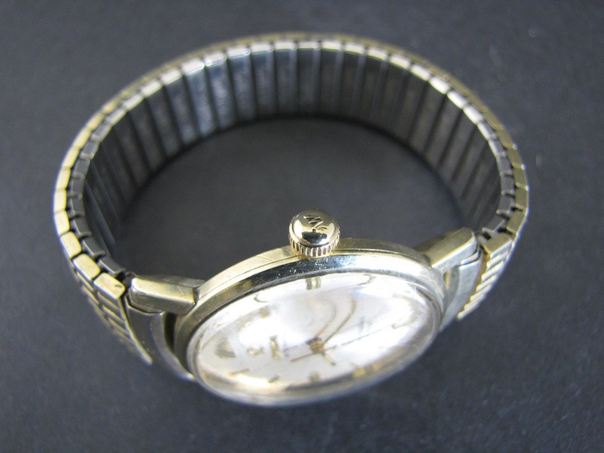

    1 The crown has a letter 'W' or 'M' on it rather than the Omega symbol. So I guess this is a replacement? And do you know what the 'W' or 'M' stands for?

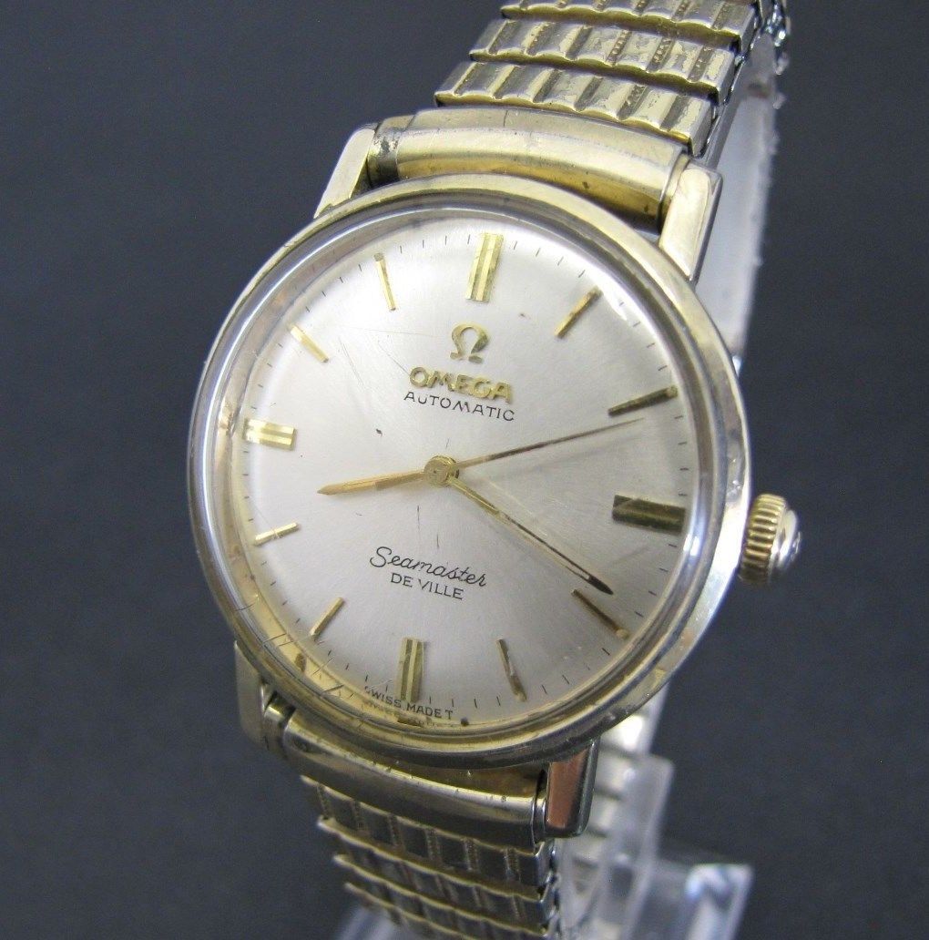

    4 After the word 'Swiss Made' there is a letter 'T' - do you know what this stands for?

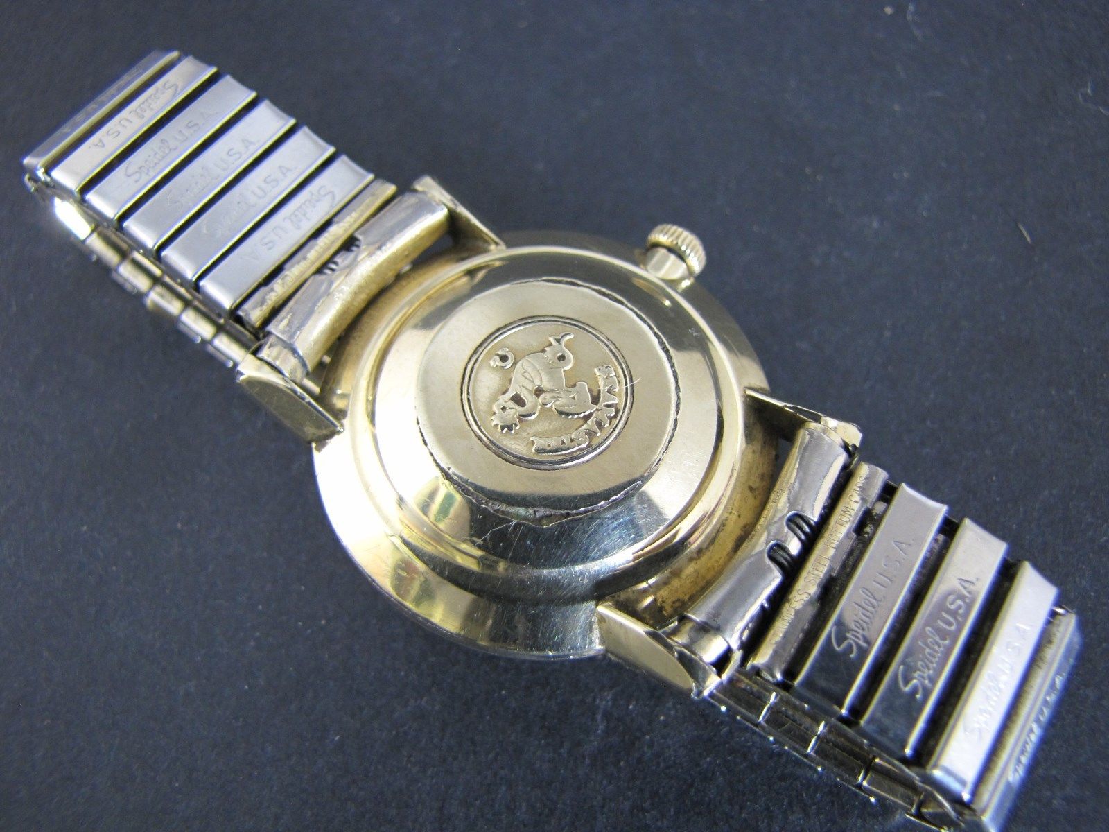

    5 On the back it looks as if some eejit tried to get it open with a pen knife or similar, but I read somewhere that you actually remove the mechanism from the front? Not that I'd ever dream of attempting that.

    4. T stands for tritium, the radioactive material used on the hands and dial.
    5. Yes, the movement is accessed by removing the crystal. Someone was really determined. Foolishly determined.

    It's a well worn watch but it does look original with exception of the crown. The marks on the back could possibly be caused by corrosion. Get it serviced, throw away that awful bracelet, put it on a nice leather strap and enjoy.

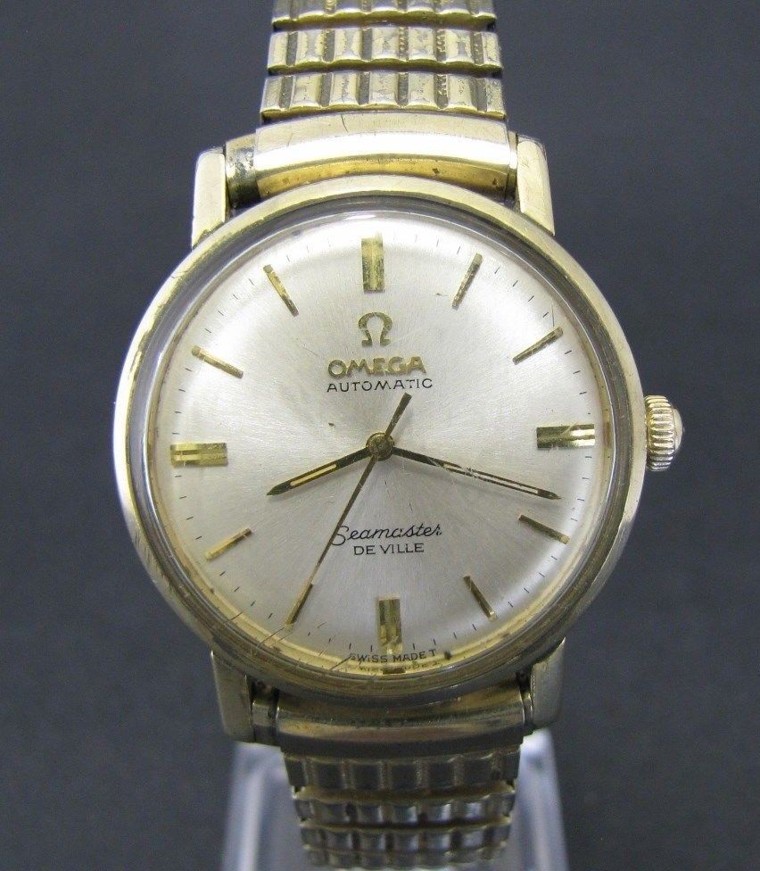

    Mid-size Seamaster, most likely a reference B 6308, US market watch, with caliber 670 NOT caliber 550.
    Case back is simply very worn, that damage was not caused by an attempt to access the movement.
    Crystal is in fact plastic, these did not use glass crystals.
    Dial looks pretty good and original.
    Crown looks like Waltham.
