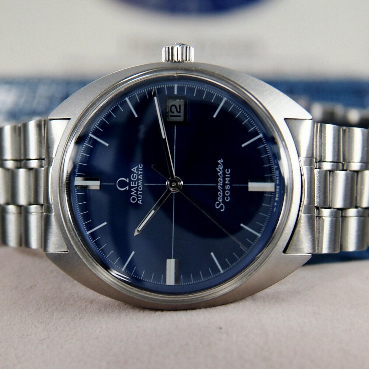

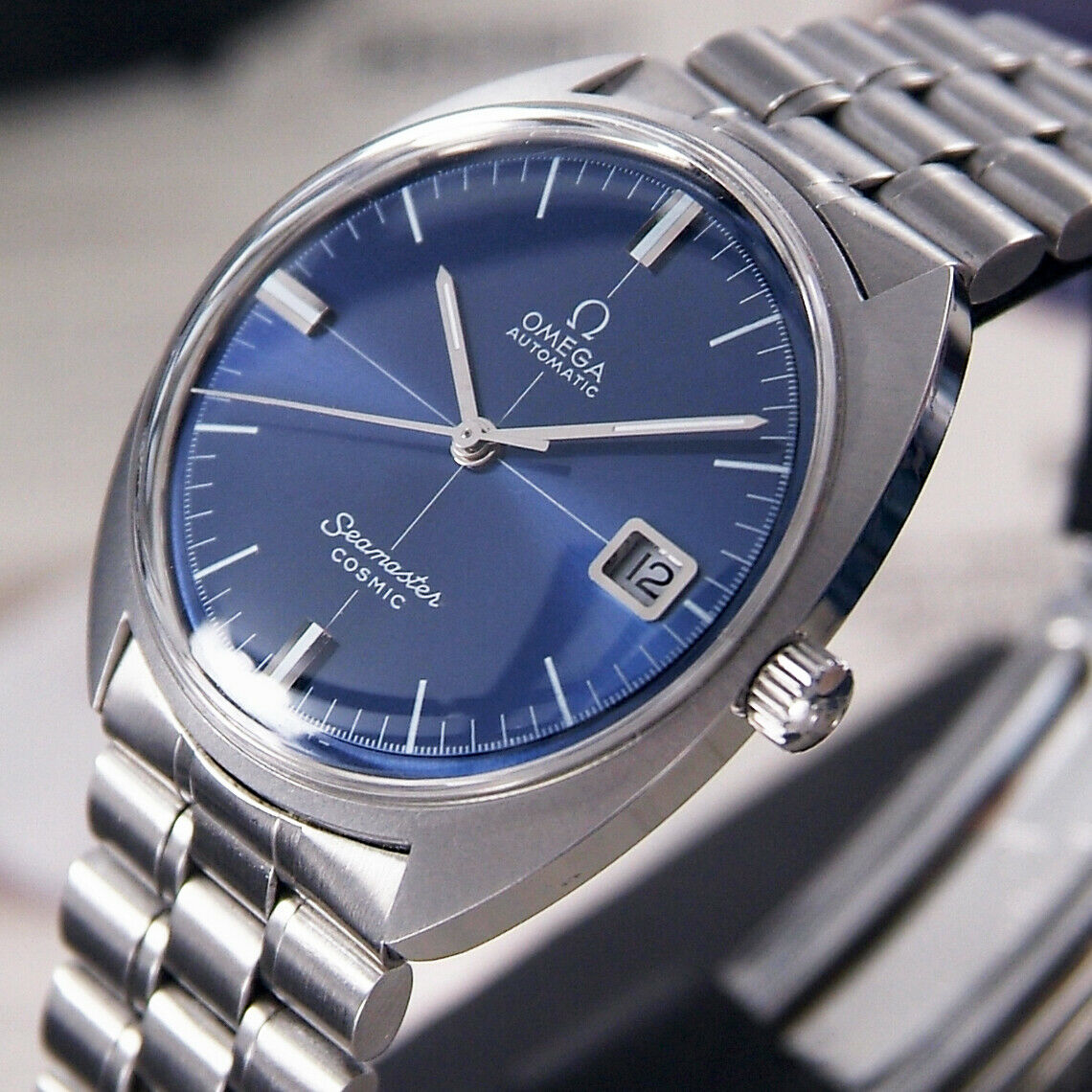

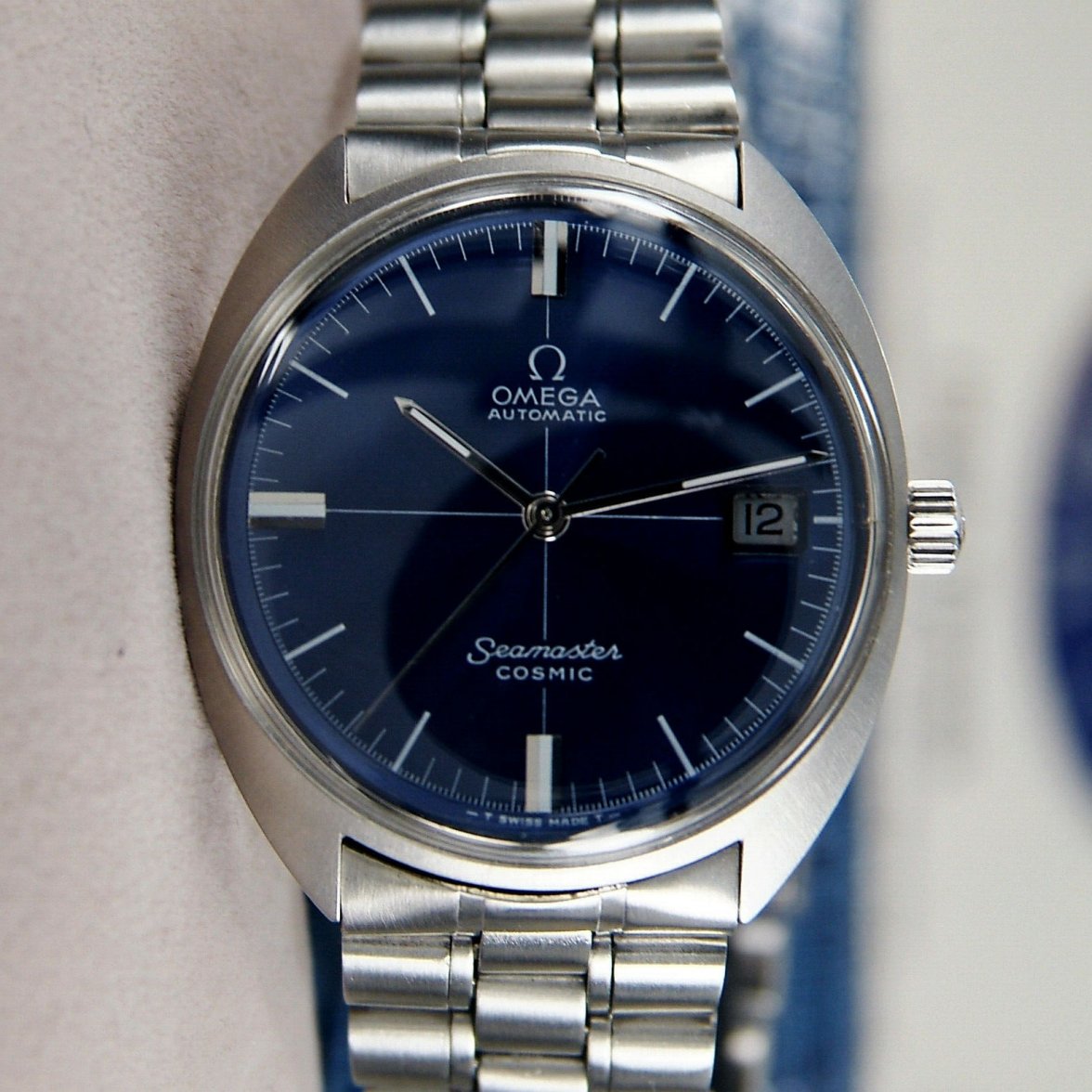

Hello everyone,
I'm new here, the watch Bug bit me about two years ago and now I'm venturing into the world of Vintage watches.
I recently found this Seamaster on ebay and impulsive me pulled the trigger.
It looks legit to me but again I am far from being an expert.
The add said the watch has been polished, an aftermarket acrylic glass was placed and the dial was re-painted.
I'm not planning on reselling or anything this one I'd like to keep to commemorate a special occasion.
Any thoughts and/or advise are welcome.
Happy Holidays to everyone, Giorgio.

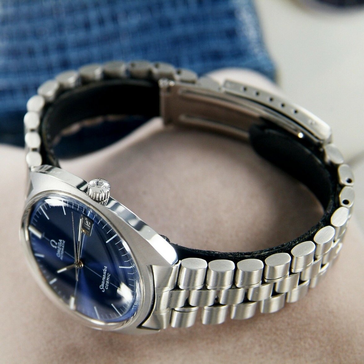

Apparently it's all said about the watch, what could we add?

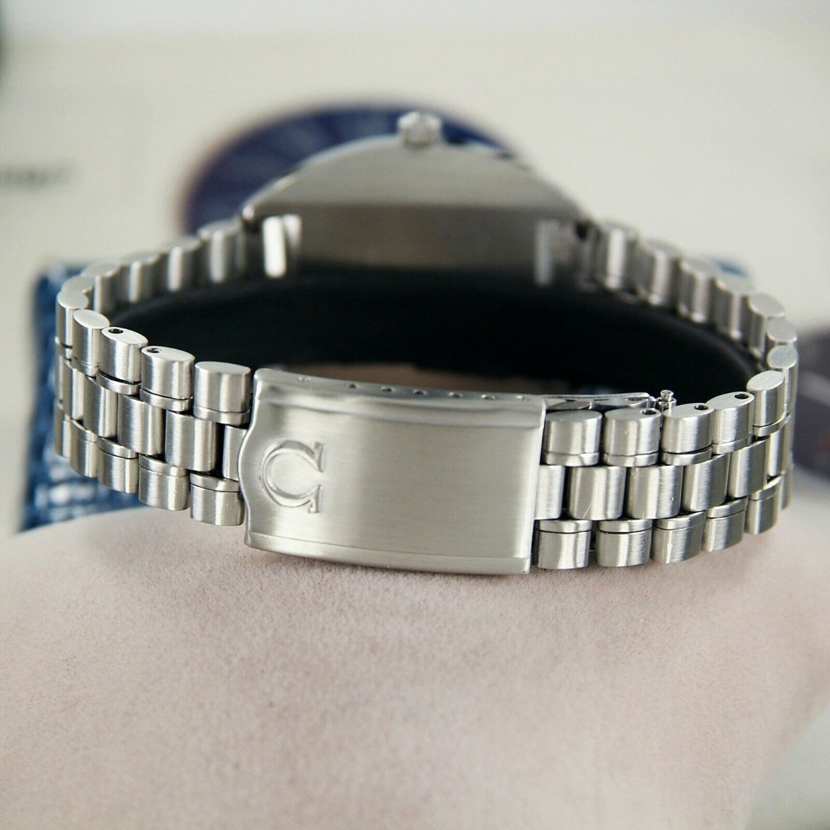

I know nothing about the bracelet...

hiya Georgio can't say it isn't pretty! she's lookin good and if you like it then it's all good 馃榾
Hi guys thanks for the answers, honestly as long as it doesn't turn out to be a fake, I'm happy with it.

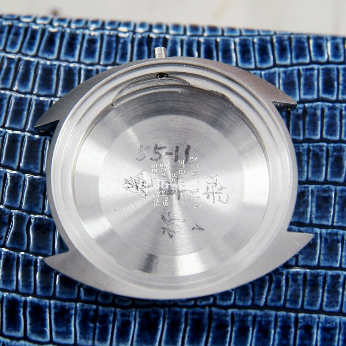

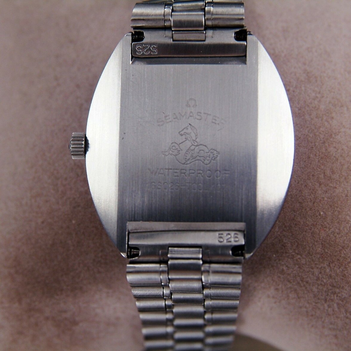

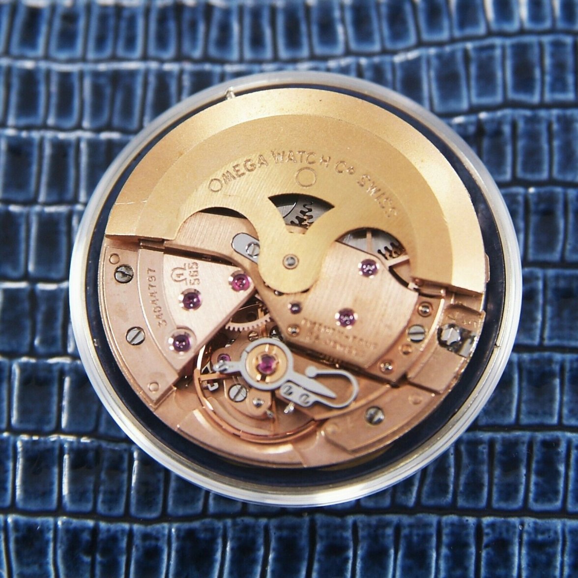

If it鈥檚 a redial, it鈥檚 amongst the best I鈥檝e seen. A better in-focus pic of the movement would be nice to see.
Just because it鈥檚 interesting (others here have seen way more than me) the Japanese (?) watchmakers marks inside the caseback are kinda cool

Honestly.... It looks stunning!
I'll be damned but that dial looks fantastic and the polishing to create the original lines is very well done.

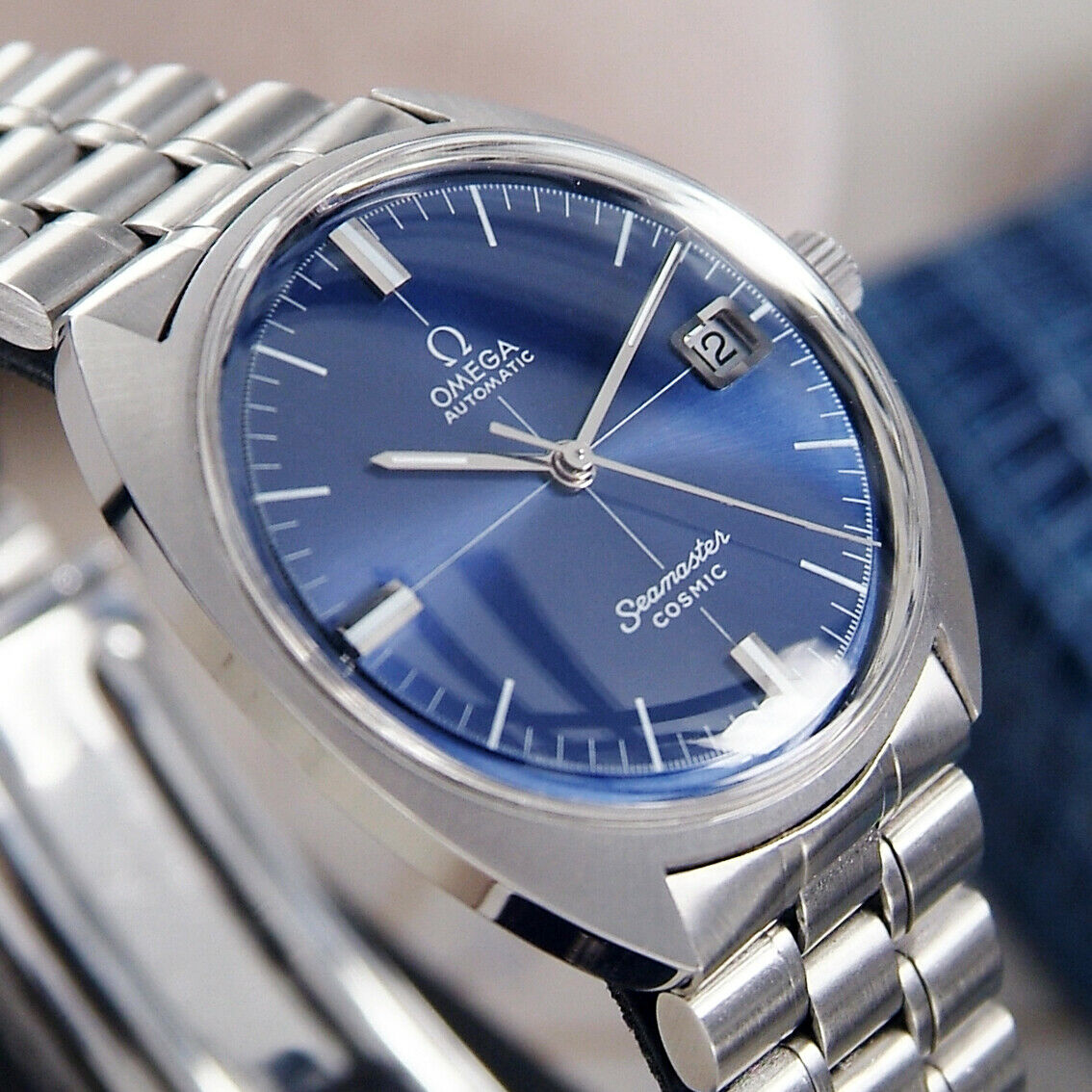

You鈥檒l find many on here that look down on redials from a collector's point of view. The philosophy is that you want to keep as much of the watch in original, untouched condition as possible, which has an impact on value to other collectors.
However, if you want a watch in good, wearable condition, that has a vintage vibe despite the cosmetic work and is there to mark a special occasion, then I think you have done really well. The calibre 565 is a great movement: it鈥檚 in the Dynamic that is my avatar and it鈥檚 a rock solid, workhorse movement with a good reserve. It鈥檚 also a common movement that is easy to get serviced in the future.
My first vintage Omega was a redialled Seamaster and I love it, because it was bought for me as a ten year anniversary present. It鈥檚 clean and elegant and its collector's worth is irrelevant to me because I鈥檓 never going to sell it and I love wearing it. And, because I don鈥檛 need to worry about its value, I can wear it as often as I like without too much worry. Naturally, it set me off on a slippery slope and I have added other, original, pieces to the stable, but this will always be special to me, and ultimately that鈥檚 the main thing.
Wear yours in celebration and in good health!

BOOM! there you go! this is supposed to be a fun hobby and it's all about enjoying the vintage vibe! sure 100% original is nice but as long as one isn't trying to pretend or present otherwise, there's nothing wrong with wearing and enjoying an old watch that had a makeover to improve the look on the wrist. it's good bang for the buck. sooner or later the supply of all-original oldies is gonna dry up and be too expensive to enjoy.
This is pretty par for the course for watches coming out of South Korea now.
16,305
45,025
I figured this was from Korea. I saw a stunning ladies TV seamaster being offers from a Korean seller that had a blue dial just like this and the seller was very clear that it was a refinished dial- so no deception. I have a ladies TV seamaster with the original silver dial that in decent shape but the blue dial was stunning. I reached out to the seller and asked if he had just a dial to sell but alas he said they don鈥檛 keep stock as they refinish the dials individually.
I too own a redialed seamaster- it鈥檚 beautiful and very well done and orginally I loved it- but as I have gotten deeper into the hobby and originality became important to me, I found myself not wearing it because I knew it wasn鈥檛 original- it鈥檚 a psychological thing- has nothing to do with the watch.
Yours is a beauty and about as good a redial as anyone could ask for. Considering this wasn鈥檛 a color option offered by Omega (as far as I know) it makes it unique and that color will pop on the wrist. If it wasn鈥檛 serviced by the seller ( and even if they said it was you don鈥檛 know to what extent), you should find an independent watchmaker and have it serviced- that will keep it running reliably for years.
Wear it with pride and welcome to the forum.

Nothing wrong with a redial if properly disclosed. The case work looks good, but a couple of things bug me. They left a rusted case clamp on the watch, so I do question when I see the time and effort that's gone into the case, is that where the real effort stopped? How well was the movement service done? It's important because parts for these are going up in price all the time, and can often total more than the labour for the service.
Second is the use of an aftermarket crystal...generally speaking not good for vintage Omegas to use an aftermarket crystal, as most of them don't have the proper stepped tension ring, and on this watch the crystal is what holds everything in place securely.
It does look nice though...
