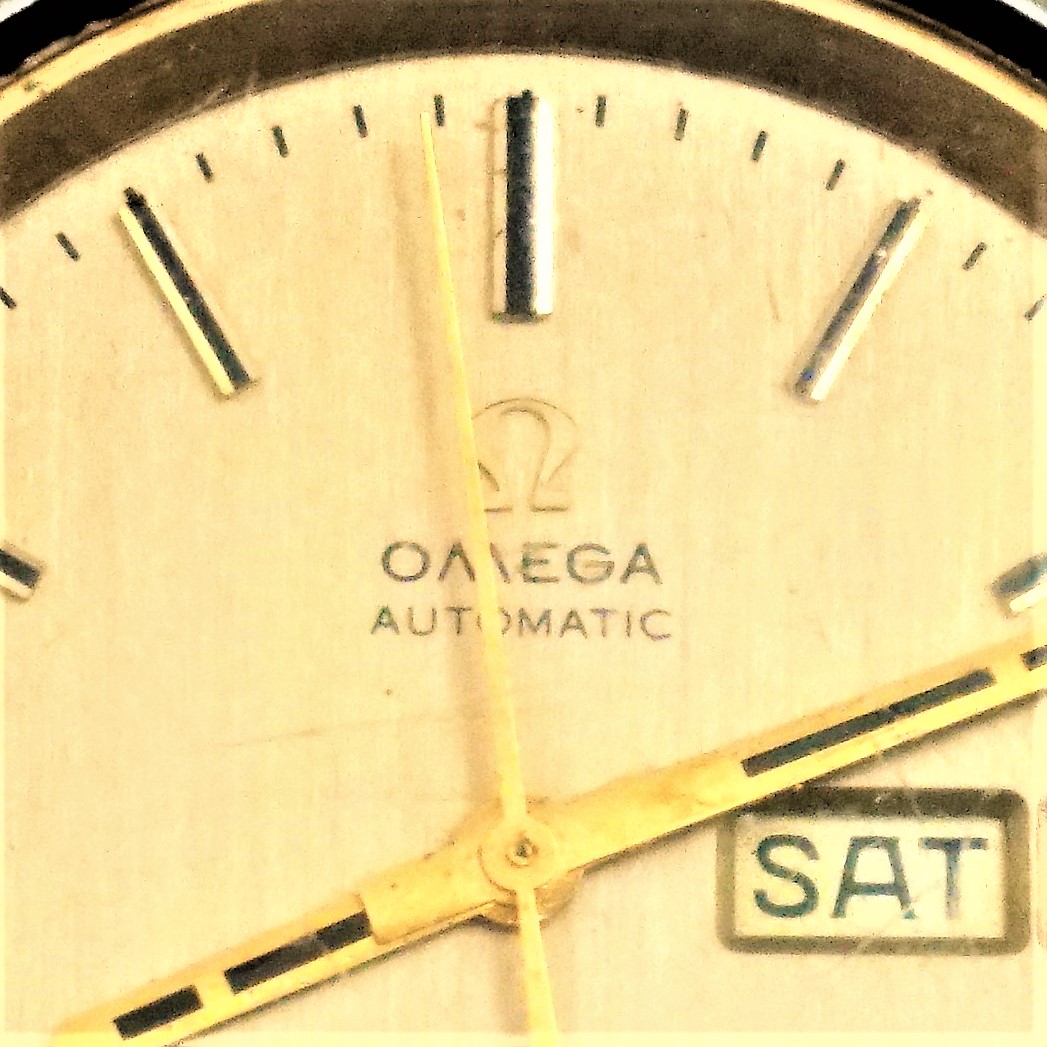

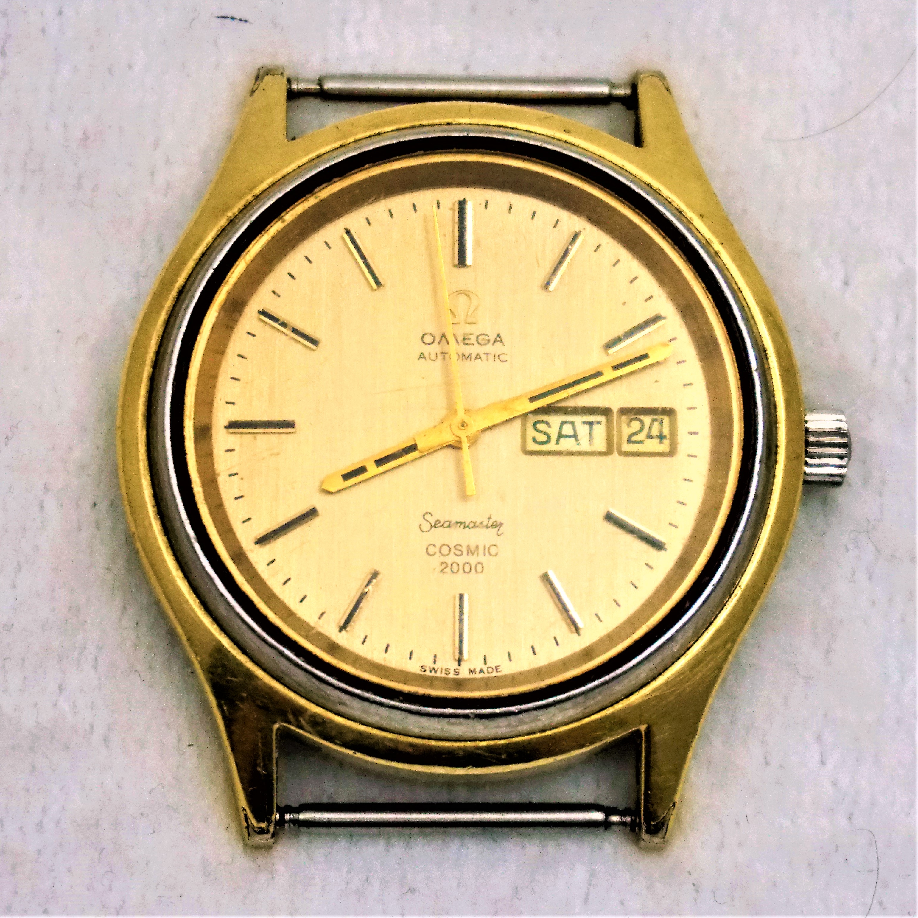

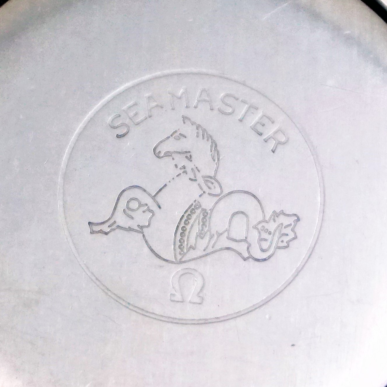

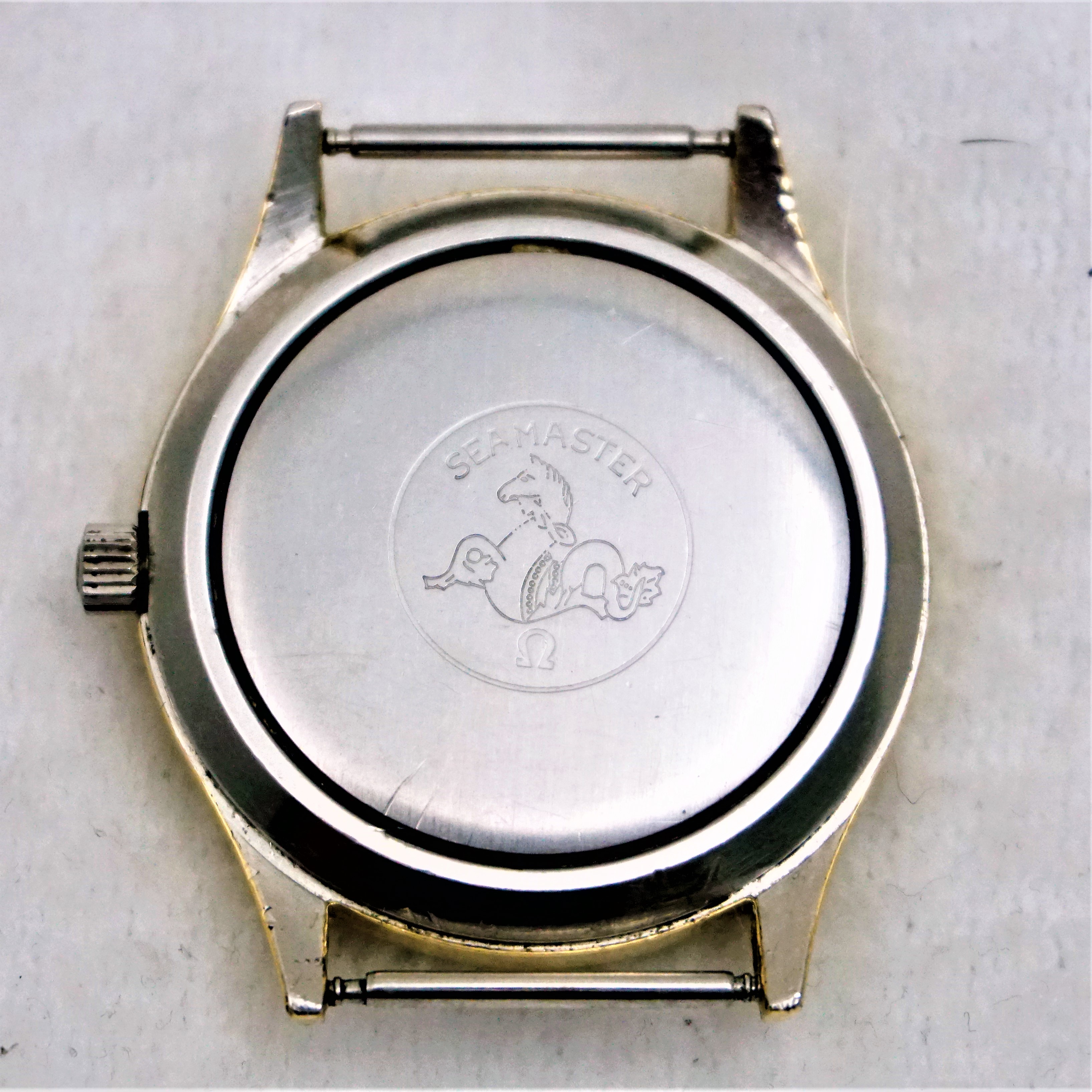

    Got this from a seller in Canada through the 'Bay and upon receipt saw immediate red flags. Though well built and running smoothly as it should, the text on the dial, especially the word "Seamaster" along with the spacing between Seamaster Cosmic and 2000 was uneven, although the dial had no signs of being restored, retouched, or redone in any way. The "Mineral Glass Crystal" had major scratching-an unmistakable sign of a cheap glass knock off. Next I noticed the Seamonster logo on the back seemed odd and under closer magnification showed missing lines (from nose to ear and from breast to chin as well as the first A in Seamaster) that could not be from wear, leaving only poor engraving as the cause. I bought this watch on 11/14/2017. What do you all think? I say 100% FAKE from the day it was born.

    I would say it is a terrible refinished dial in a worn-out old case, but not a fake. Do you have pictures of the movement?

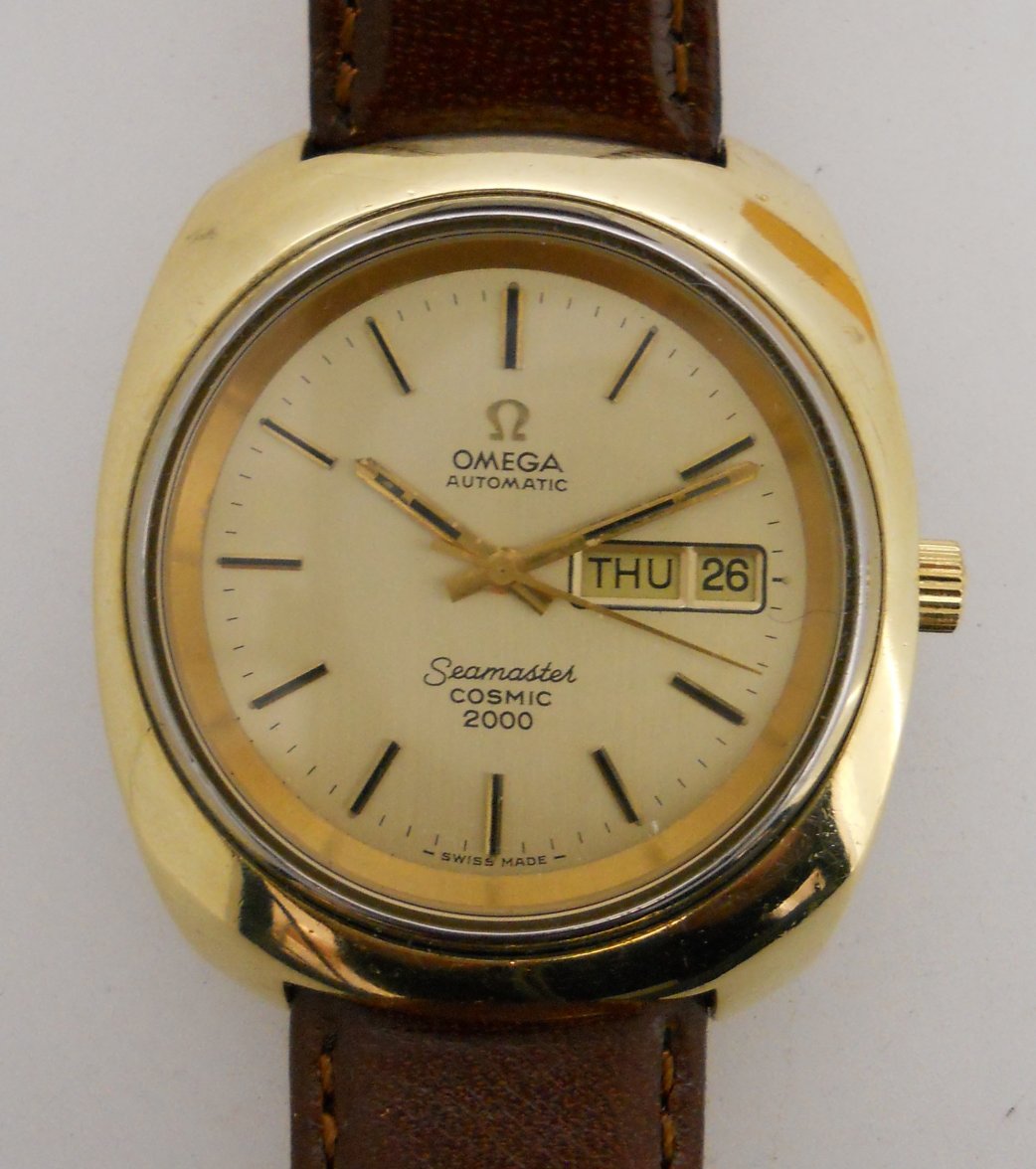

    Re dial for sure. This is what it should look like.

    I disagree on the redial, there are too many other things that are off. The hands are cheaply finished with a rough texture. I wish I could open it and see what is powering this phony thing. I know my OMEGAS, especially from the 60's and 70's and this one is 100% vintage but fake. Albeit, a VERY good fake.

    Part of the "A" in "SEAMASTER" on the case back is completely missing. NOT worn off. MISSING. Companies tend to not mess up their own branding.

    OP has done a great job convincing themselves their watch is fake, however no one would ever bother faking this model. :confused:

    Redial real dial in a fake case with real hands?
    I’d love to see the inside.
    :edit:
    Ok just a redial

    I would love a better explanation as to why the engraving on the case back is so clearly not up to the standard of OMEGA. I will do you one better, Convince me it is NOT fake. I think it was faked back when these watches were new. Not a modern fake. Tell me why I am wrong...and show your work!

    I have two Cosmic 2000 Seamasters with the tuna can cases. Both of mine have the Hippocampus faintly etched, not stamped.
    One is worn to the point of extremely hard to see, the other is a little better but worn.
    Your example is the result of a light stamping, years of wear and probably polishing.
    Only an idiot would try to fake the unusual construction of this model.

    I just wanted to see what people's opinions were. In my experience, Not even a stamp would completely leave out portions of the design and deeply stamp the letter right next to it. I used to deal specifically in coins and aside from a poorly prepared die, these missing lines and parts of letters are not possible through stamping. Leading to what conclusion I do not know, but I am not new to this game and something is not right with this watch. If I knew what that was, I wouldn't be asking the oracle...

    An Omega Seamaster Cosmic 2000 with a heavily worn gold capped case, a poorly executed re-dial and slightly oxidised hands, all housing a Caliber 1022 and owned by a person who seems to have a serious case of buyer's remorse.

    It's not fake, it's just a redial. Everything is genuine (bar the finish on the dial).
    As above, it's just wear that has worn down the engraving on the back.
  20. OMEGALOMANIAC Nov 28, 2017
