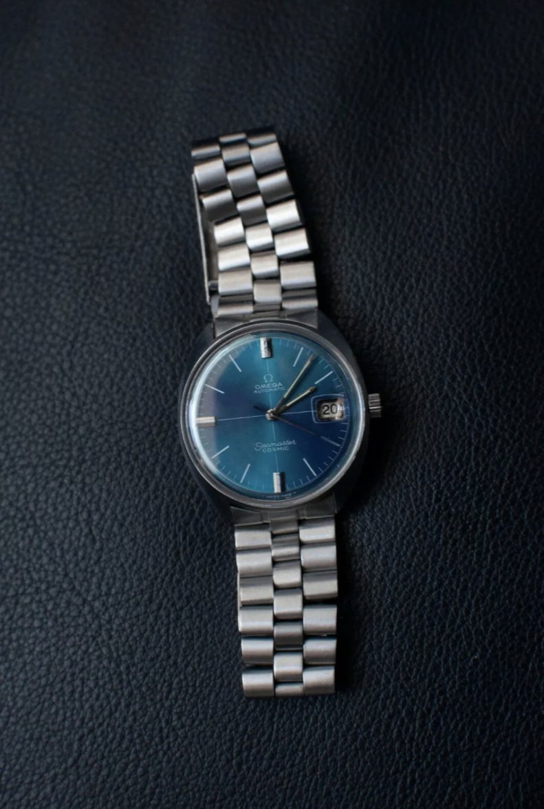

    IMG_1378.JPG Hello all. I have always wanted an Omega watch, but could never see it happening. I recently purchased this Seamaster Cosmic, caliber 565. The back of the case is marked, top to bottom: the Omega symbol, SEAMASTER, the sea horse logo, WATERPROOF, and 166026-TOOL 107. It is signed on the crystal, crown, movement, and case inside, however, is it a real Omega? If so, anything you can tell me about it would be greatly appreciated. Is it a 1967? Has it been redialed? Is it a Frankenwatch? Unfortunately, I could only load the one picture. It runs like a top, and has been keeping perfect time. I normally wear vintage Seiko watches, so I'm out of my comfort zone here!
  2. Sherbie Jan 22, 2017
    1,321
    1,859
    Welcome
    Watch looks ok to me - dial looks right, and not redialed. These need a special tool to open the watch ( as you noted), and it opens up by the front - ie the special tool removed the crystal, then you have to remove the crown and stem, then you can take out the movement.
    Please leave this to a professional though, and only then if they have the tool to do so.
    Cal 565 inside is a great movement, with quickset date
    Enjoy

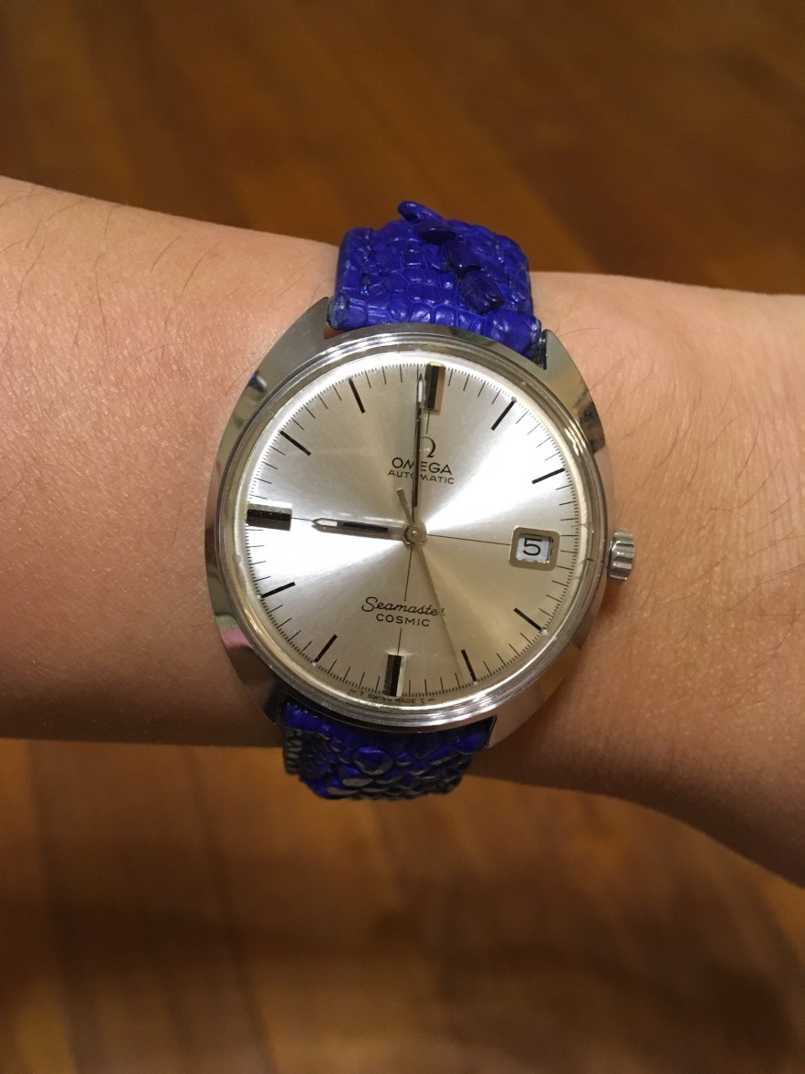

    I had a strap that was smaller, then the lug by maybe 1mm? Mark B is right, it falls out easily, in the end, I needed to build up the strap side with glue to make up the difference.

    My little cosmic

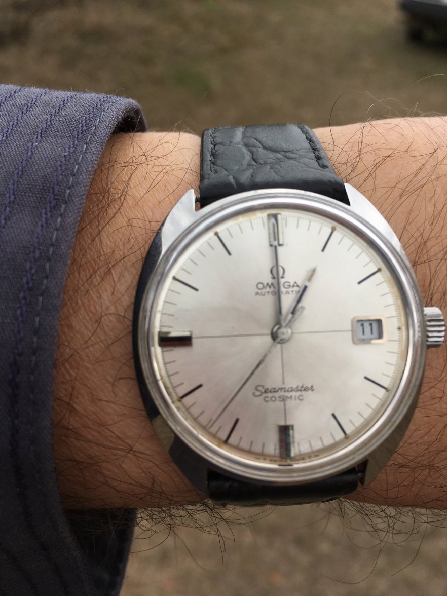

    this is on a crocodile mini horn back strap. Looks too contemporary for this eatch

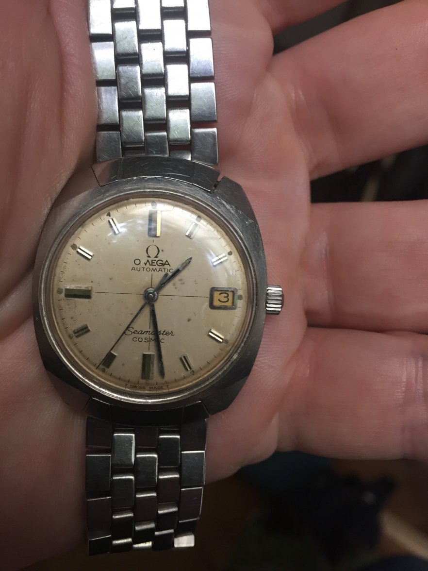

    A bit worse for wear, but original brick bracelet

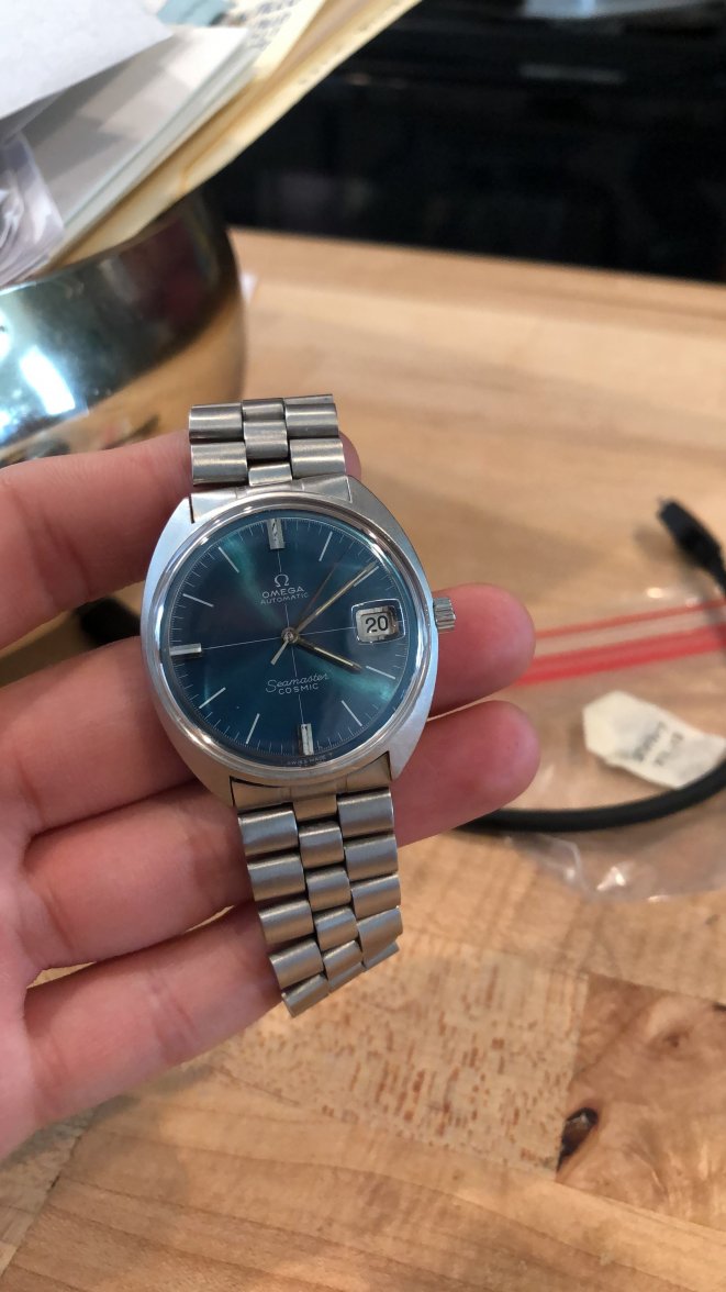

    Hey guys what do you guys think about my cosmic? I fount it and its a different blue tone. 0D4EC330-B624-4BCB-89F8-8DBE065F7433.jpeg B7CC42C1-DFBC-444A-B174-9FE15225D17E.jpeg

    The crystal is also incorrect. They didn't come with cyclops eye as far as I know.

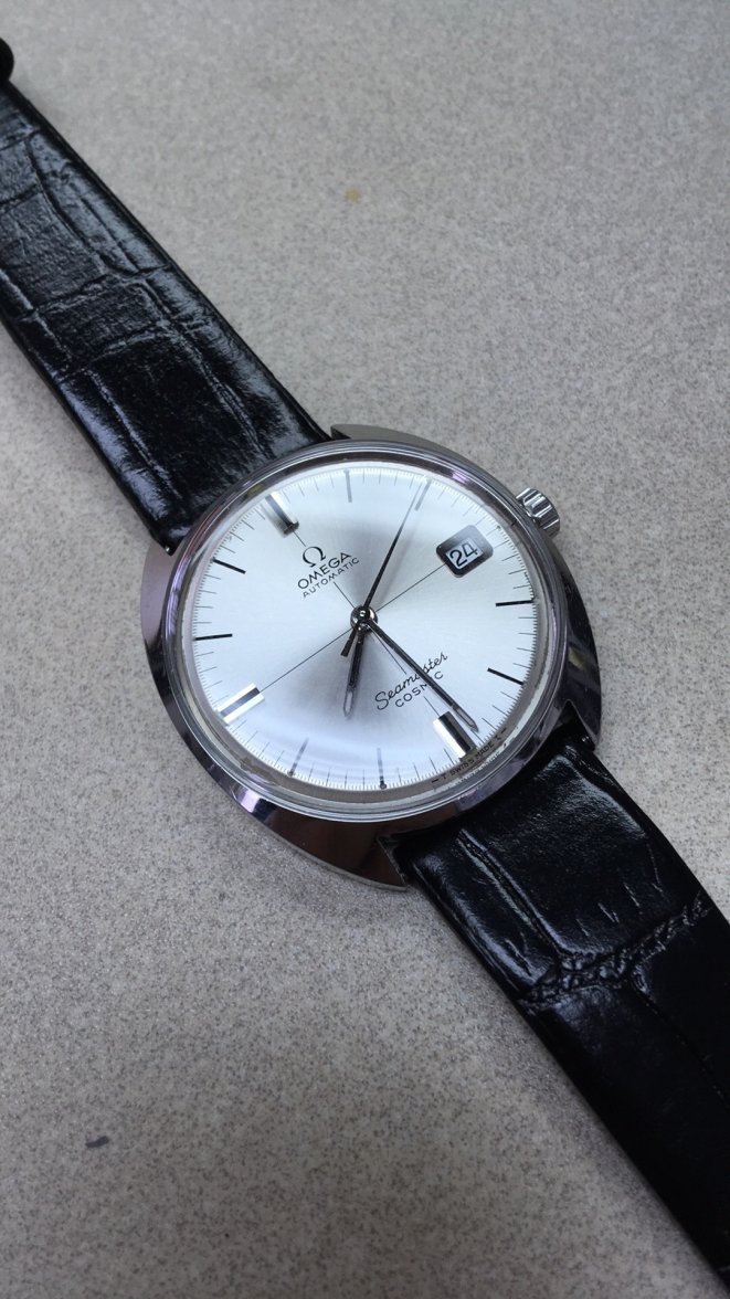

    Not sure if they came with it or not but I’ve seen quite a few with it and the size is correct for the the case ref :)
    Mine has it too:

    The crystal that is used in this case is also used in other cases, and it came in versions with the magnifier. Both for the date, and the day/date. The crystal listed for the Cosmic case specifically does not include the magnifier.

    I should have a talk to my watchmaker then, as he used a new one of those even after servicing it :confused:

    063PZ5123 - no magnifier
    063PZ5123L - date magnifier
    063PZ5123LL - day/date magnifier
