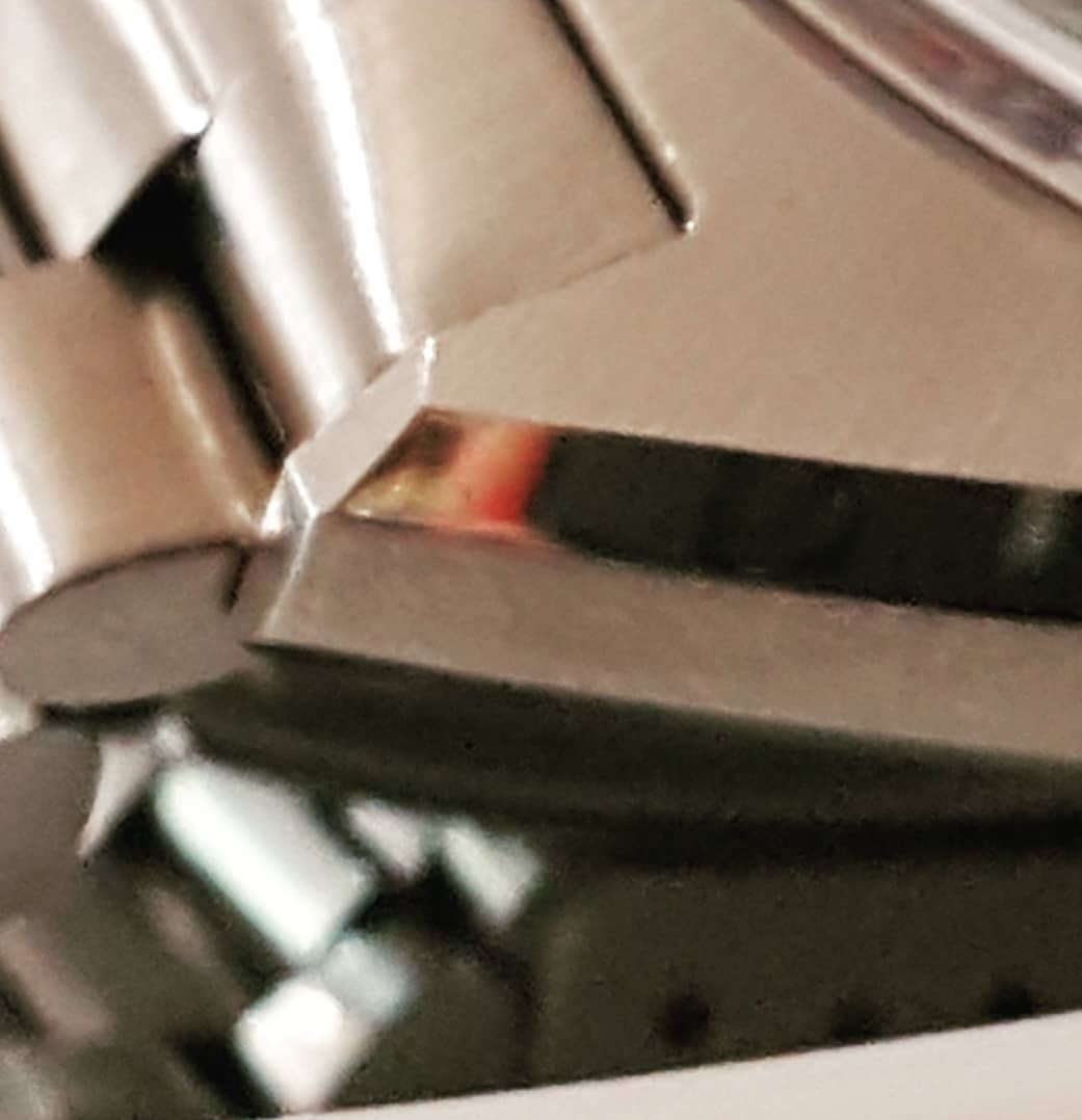

Yes, that's right, too often there are terribly refinished cases and -backs.
Face of the watch is sunburst brushed, chamferings are highly polished up and below the straight brushed side parts of the case.

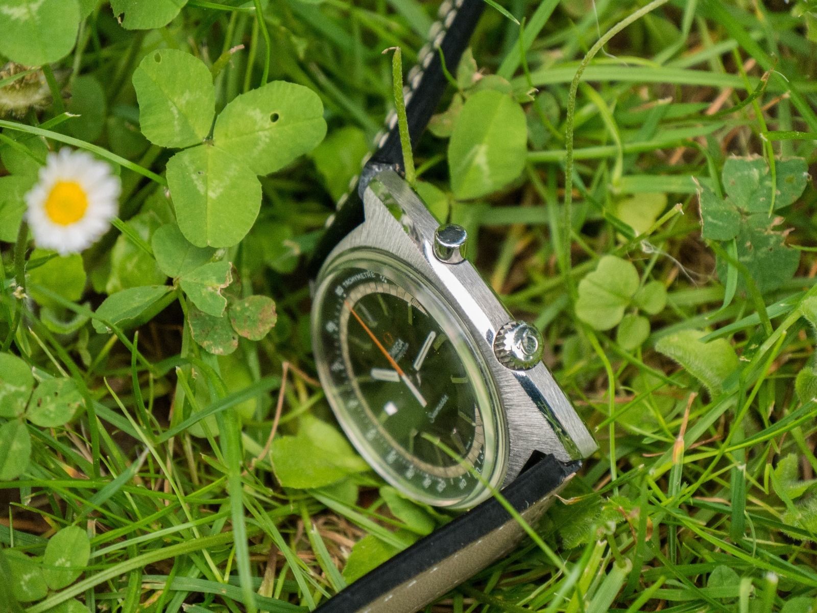

The Omega 145.007 Jumbo Chronostop has the same finish as the 145.008.
I have a first hand 145.008, that was worn only a couple of times.
The front has a sunburst brush finish:
