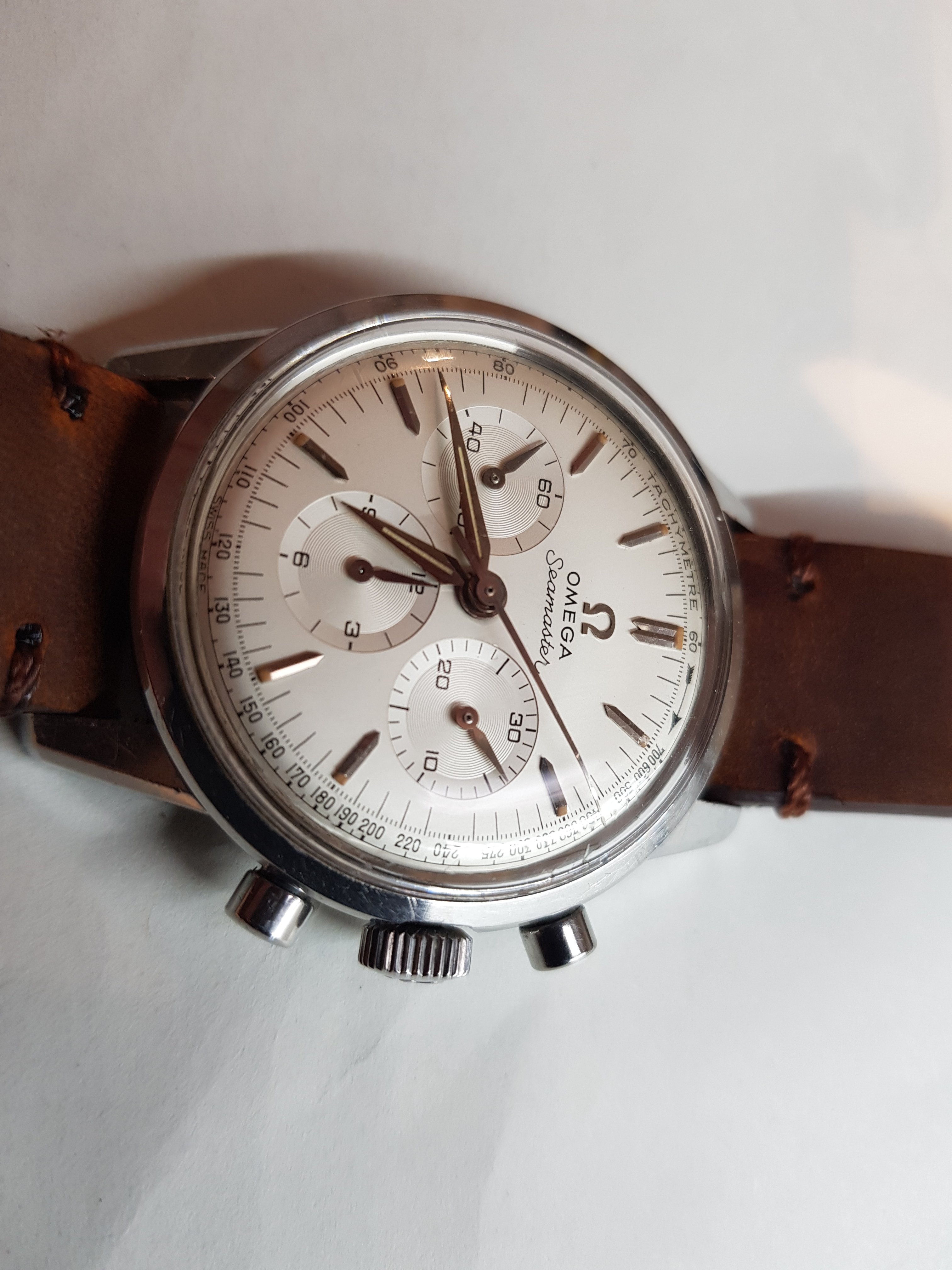

After transferring the money via PayPal (those exchange rates on paypal are insane; if you can choose the exchange rates of your credit card which should be much cheaper) this is what the post man brougth some days later. 😁😁😁 (the other side looked the same)

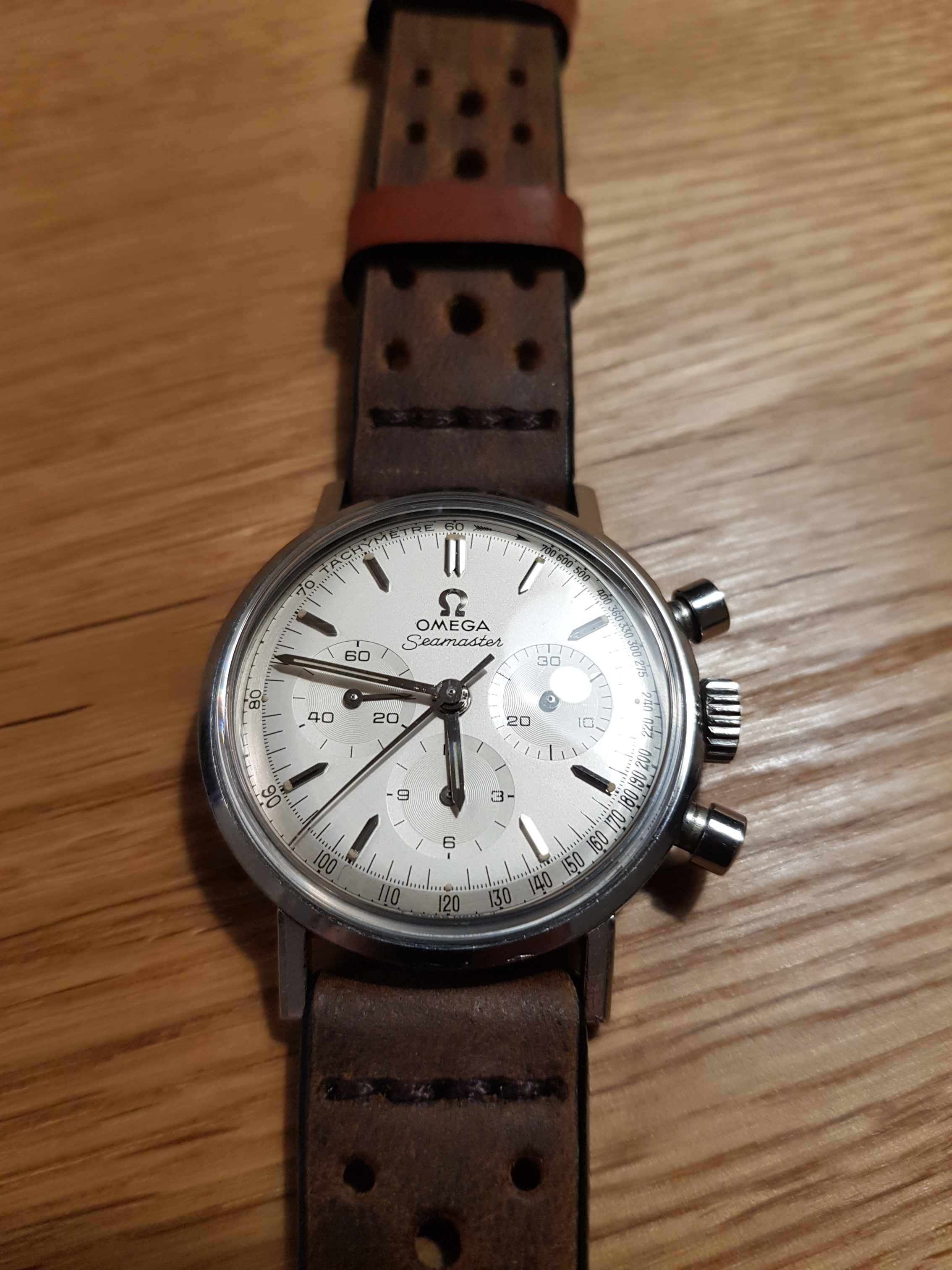

And this is how it arrived today - love it. 🥰🥰🥰 (strap from two stitch straps)
Cheers

Very nice watch, well done 👍

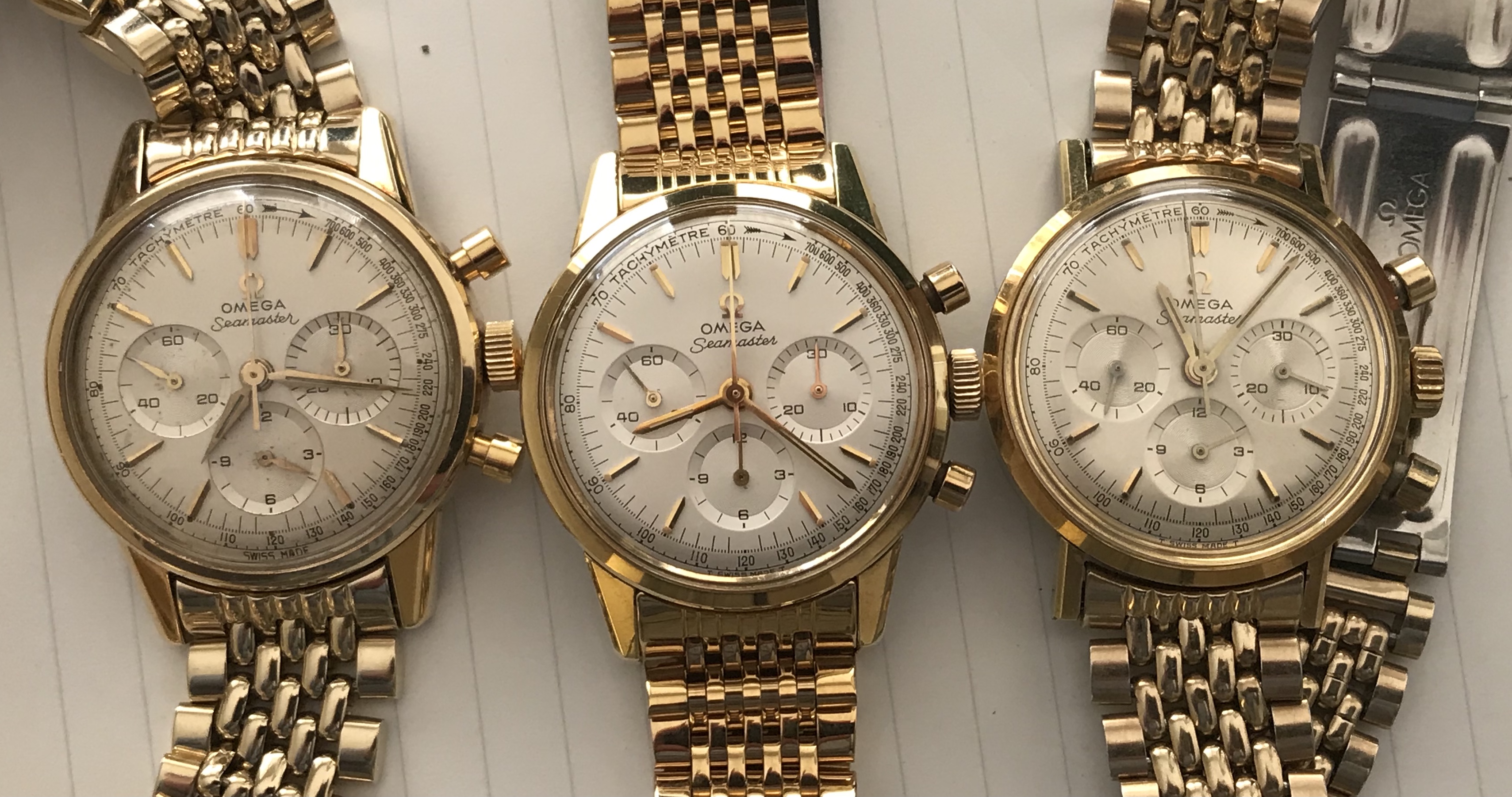

Next, you’ll start looking for a spare movement, to deal with the 321 spare parts issue. You’ll then see that a complete watch is frequently no more than just buying a movement. Soon, you’ll have 3 or 4, and then you’ll be really going.
Don’t ask me how I know.
