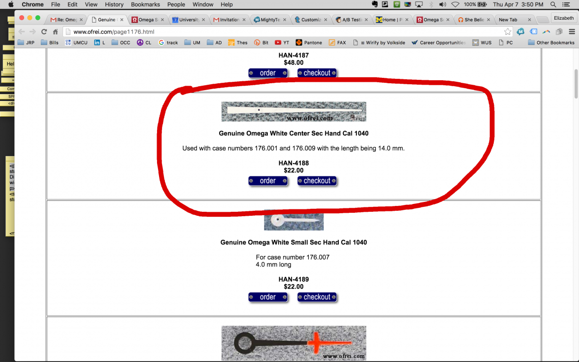

    It's interesting because I too have questioned that. I've seen this type on other examples and also on Otto Frei's site listed for that cal. Do you know what the correct seconds hand is? Is it like the one in photo 3? Long and skinny with no detail at the end ? I've attached a screenshot from otto's site.

    Looking at the excellent reference work @Andy K created, none of the watches with the 1040 movement except the Speedmasters have this style of hand. I'm inclined to say it's never been original to a 176.007.
    https://omegaforums.net/threads/an-encyclopedia-of-omega-cal-1040-and-1041-dials.36789/
    The one in your picture 3 seems correct. It's difficult to say if the one in the otto Frei image you posted is the same one. The website also lists another one, which is supposedly for the Big Blue, is $2 more expensive, had a different (Ofrei) parts number, but seems identical in every way (176.004 also has the 1040 movement). Short answer: I don't know, but I'd love to find out.
