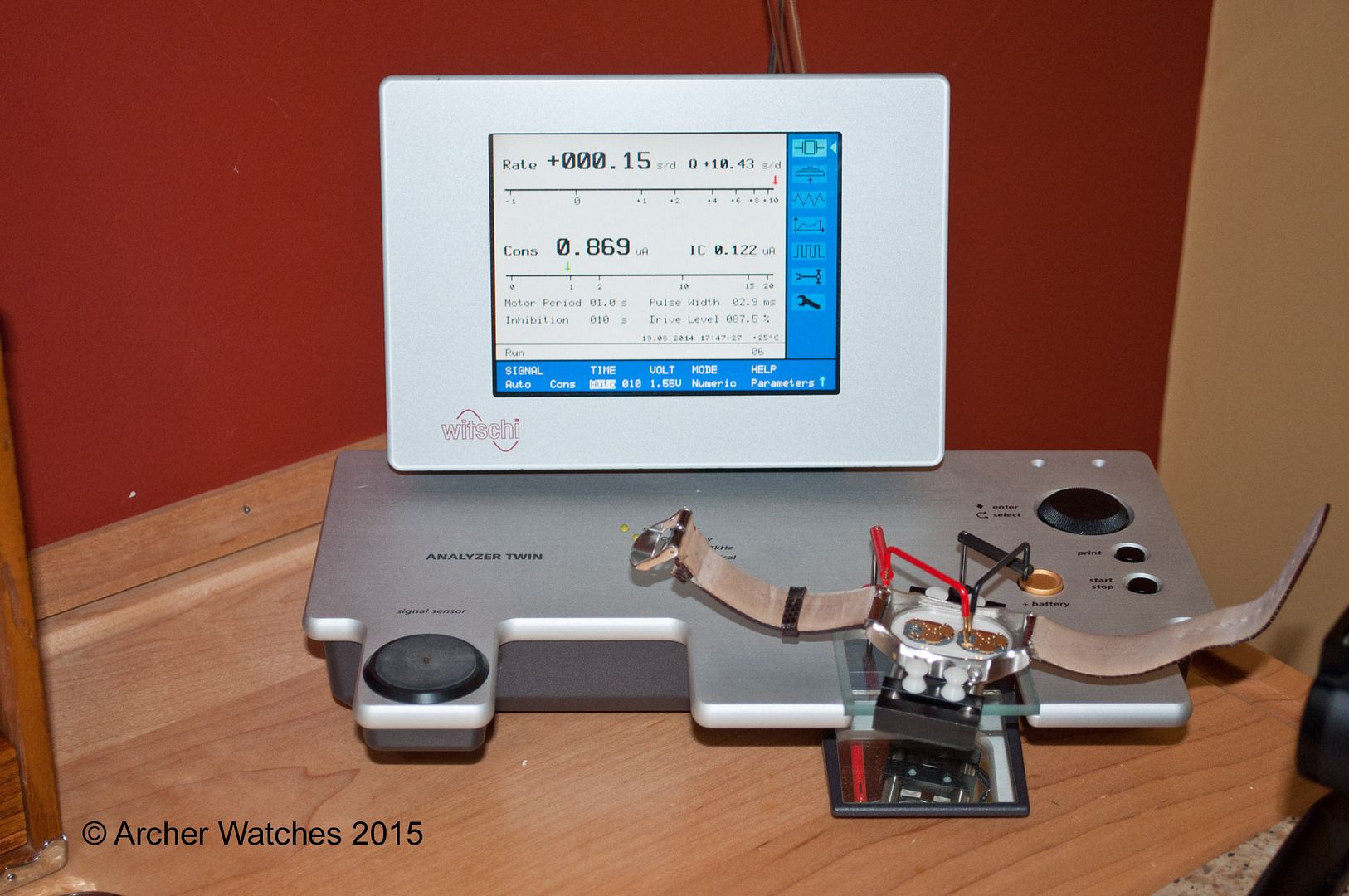

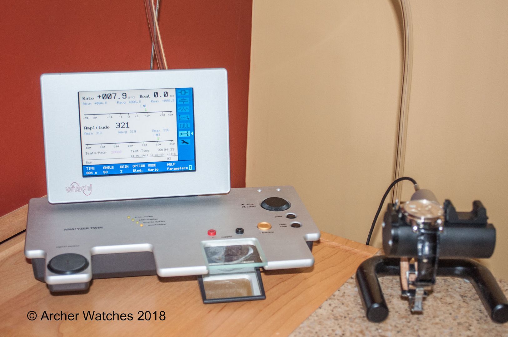

I use a Witschi Analyzer Twin. As there is a requirement for a quartz analyzer (at least there was back in the time I obtained my certification) and I work on quartz anyway, I wanted a machine that would do both mechanical and quartz watches. For quartz it is very useful for all the checks that need to be done:
Fort mechanical watches it has the standard diagram mode, but I probably use that the least. I am typically using a numeric display like this:

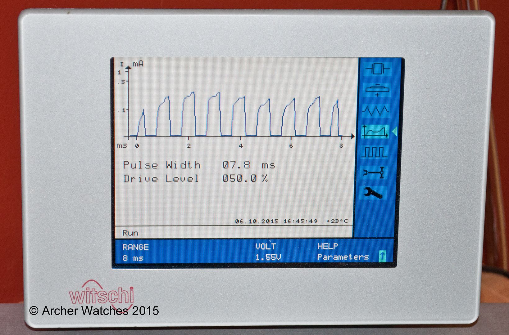

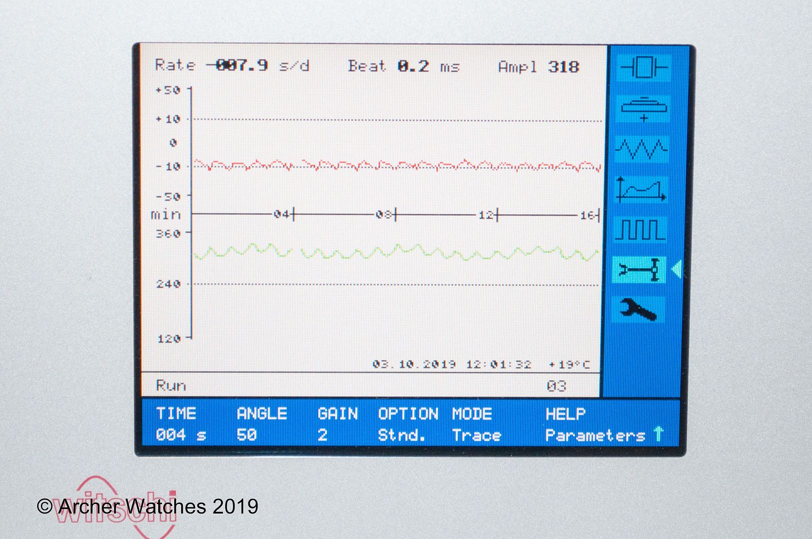

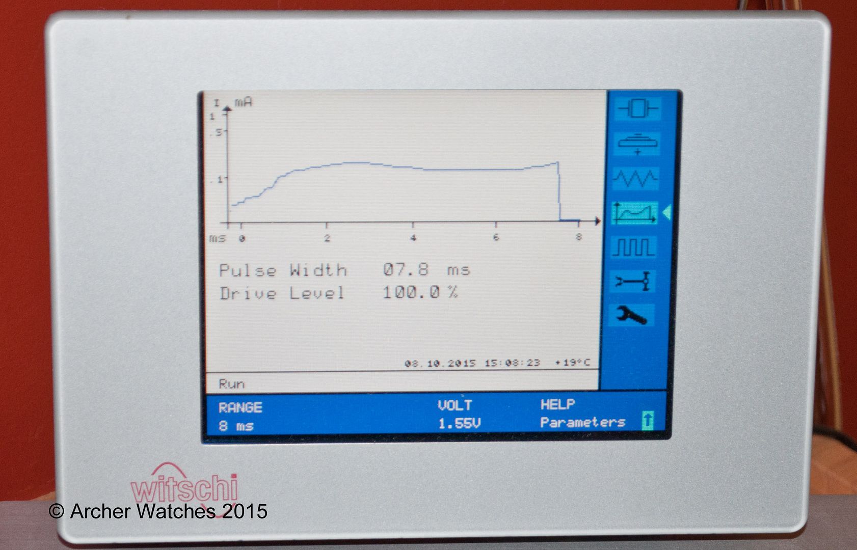

The trace mode is useful for diagnosing the causes of longer term variations:
And for checking positional variation, there a screen specifically for that:

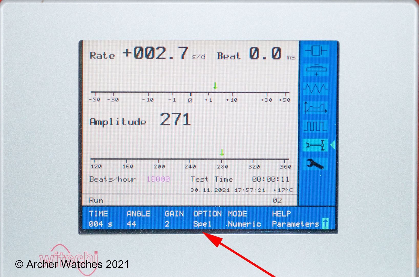

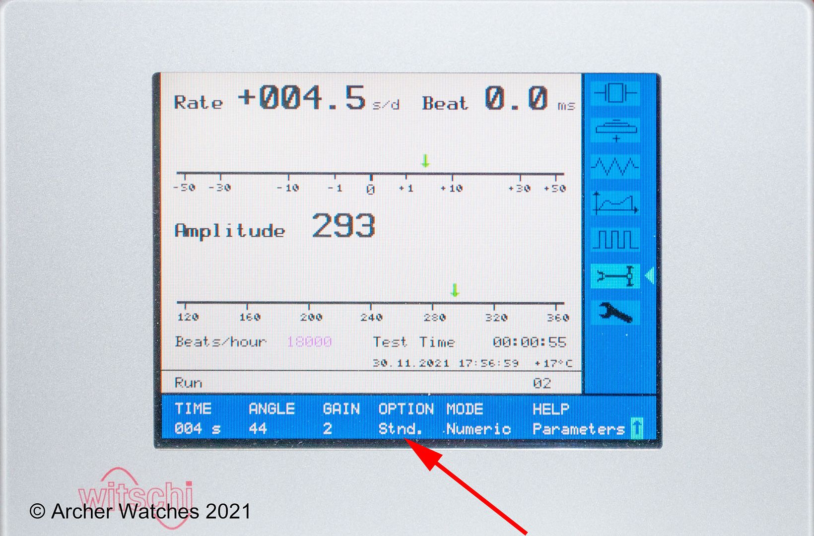

For co-axial, the machine will require a specific program setting - here is my machine set for a traditional Swiss lever escapement:
When measuring Omega co-axial escapements, you use this setting - special 1:
With the AP special escapement, you use this setting - special 2:
Note that all 3 of these measurements were taken using the same movement, and all within 1 minute of each other, so you can see the variation in amplitude...
So unless a timing machine has these special settings, it will not work with a co-axial escapement. I haven't looked for a list of approved machines in a while, but I know for sure that the Witschi Chronoscope S1 and X1 are approved, in addition to the machine I use.
If you require any additional assistance, please let me know.

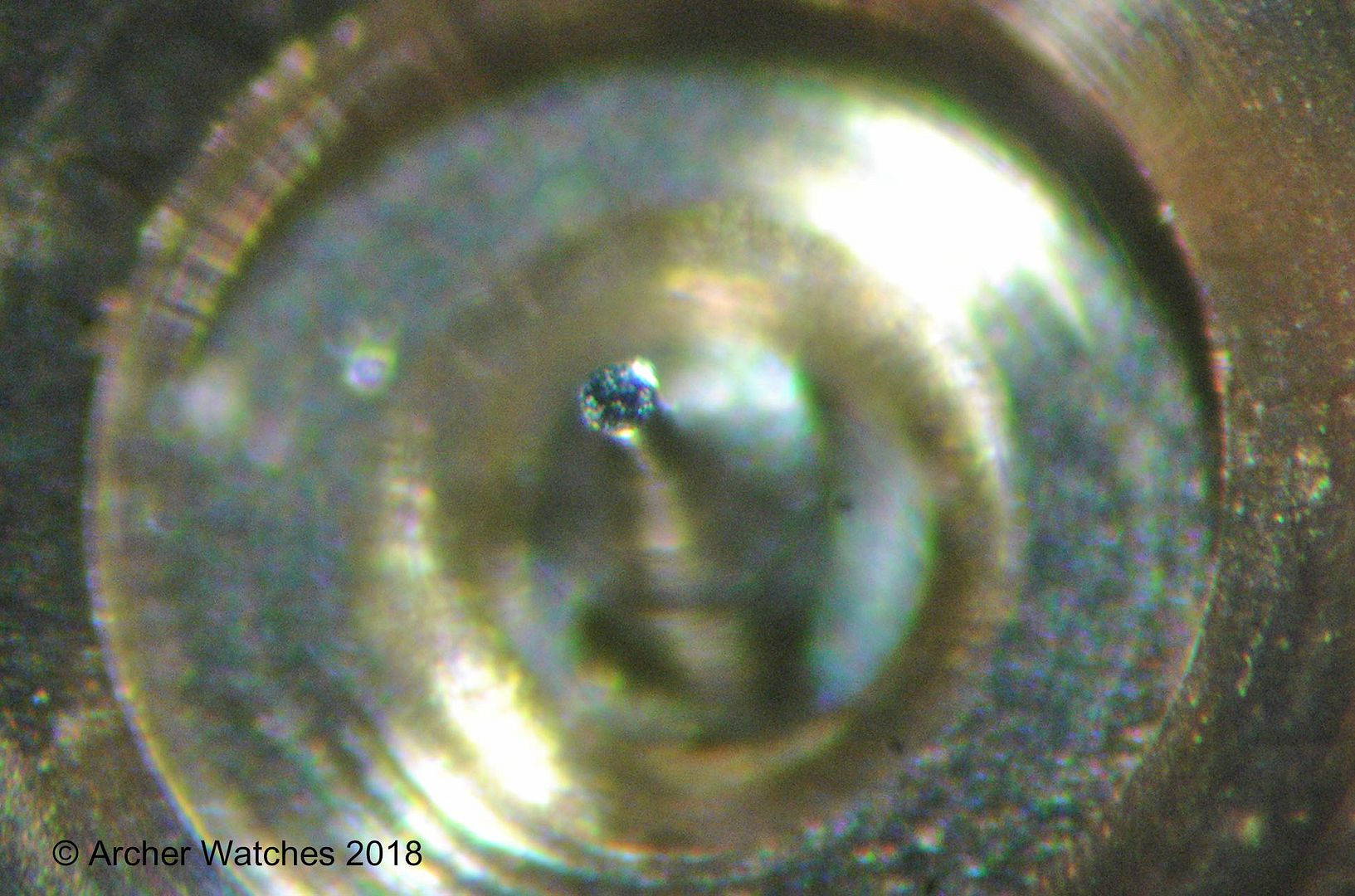

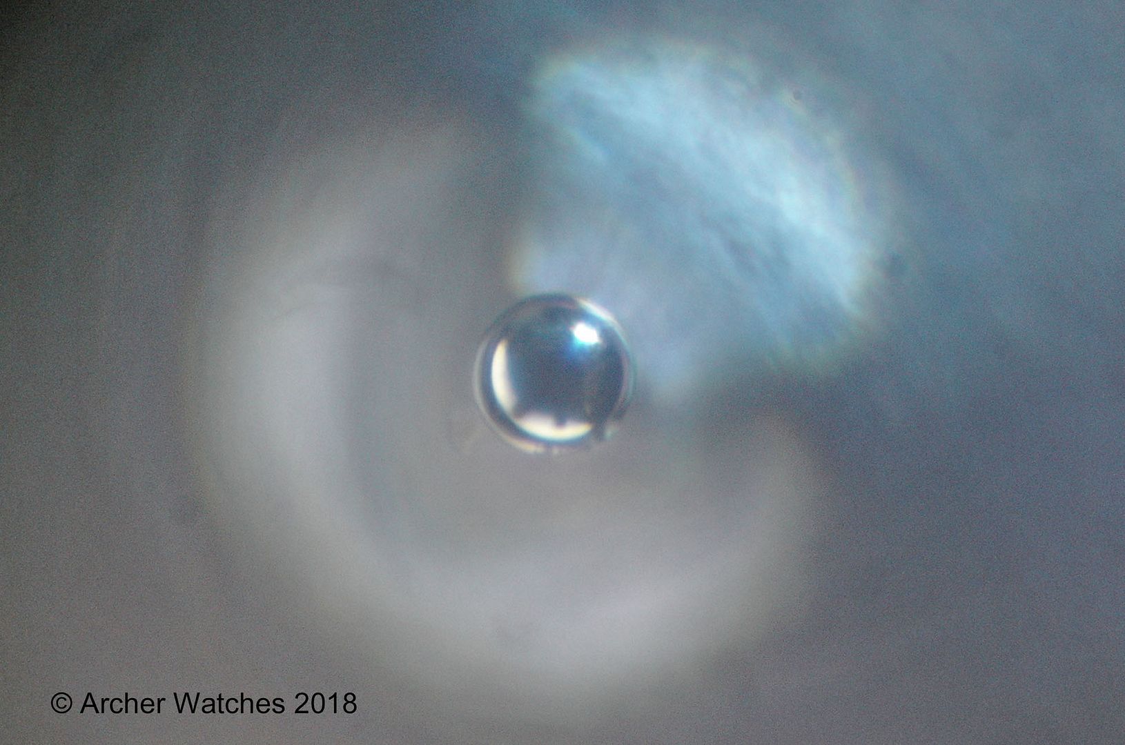

Back to burnishing - I would say the most common reason I use my Jacot tool is to correct flattened ends of balance staffs on vintage watches. When they run for years on dry pivots it can flatten them, and also wear the balance cap jewels:
Flattened pivot:
Mounted in the Jacot:
Here using the lanterns and with just the end of the staff visible:
Initial burnishing:
Final result - the end of the staff is much more rounded and is perfectly burnished to a mirror finish:
This corrected a 30 degree difference in amplitude from dial up to dial down...
Cheers, Al
