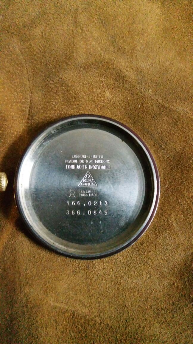

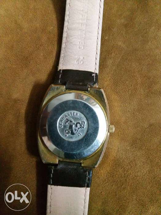

    I got an old omega golden watch. I am giving few pics of the same. Would like to get suggestion/ advice from you whether the back cover is genuine or not. I am confused with the back cover since I saw a 4 digit number written on the top of the back cover in other similar type of watches. and that number is absent here.
    Further to this the back cover carries a round shape sprakling decoration. that is also absent in the back cover. the calibre is 1022 with 23 jewels. back cover also marks 166.0213 and 366.0845.
    Also kindly advice me, is it true that a different back cover other than this model will not fit in this watch?
    Shall be grateful for your suggestion please.

    Hi @S Dhar, it sounds like you have the right case back for this model, if you post pictures here it can be confirmed. With regard to the four digit number, this is seen on quartz models, which yours isn't, to denote the calibre used, so don't worry that yours doesn't have it.

    Here are more pics

    uploaded the back cover pic. please have a look.

    You have a gold plated omega watch.
    It's appears all original dial, case, and caseback. There is also a number starting with a 3x( most likely) million on the movement which can tell you it's approx age.
    That case back carries 2 model numbers, either for 2 watches or they changed the model number of this watch. Totally normal in that period. You can look up both models and see which yours is and double check which movement is in it to make sure it's correct.
    As for the dial not exactly matching reference pictures, there is a fair amount of dial variation and yours appears correct and original to me.
    Edited Mar 29, 2017
