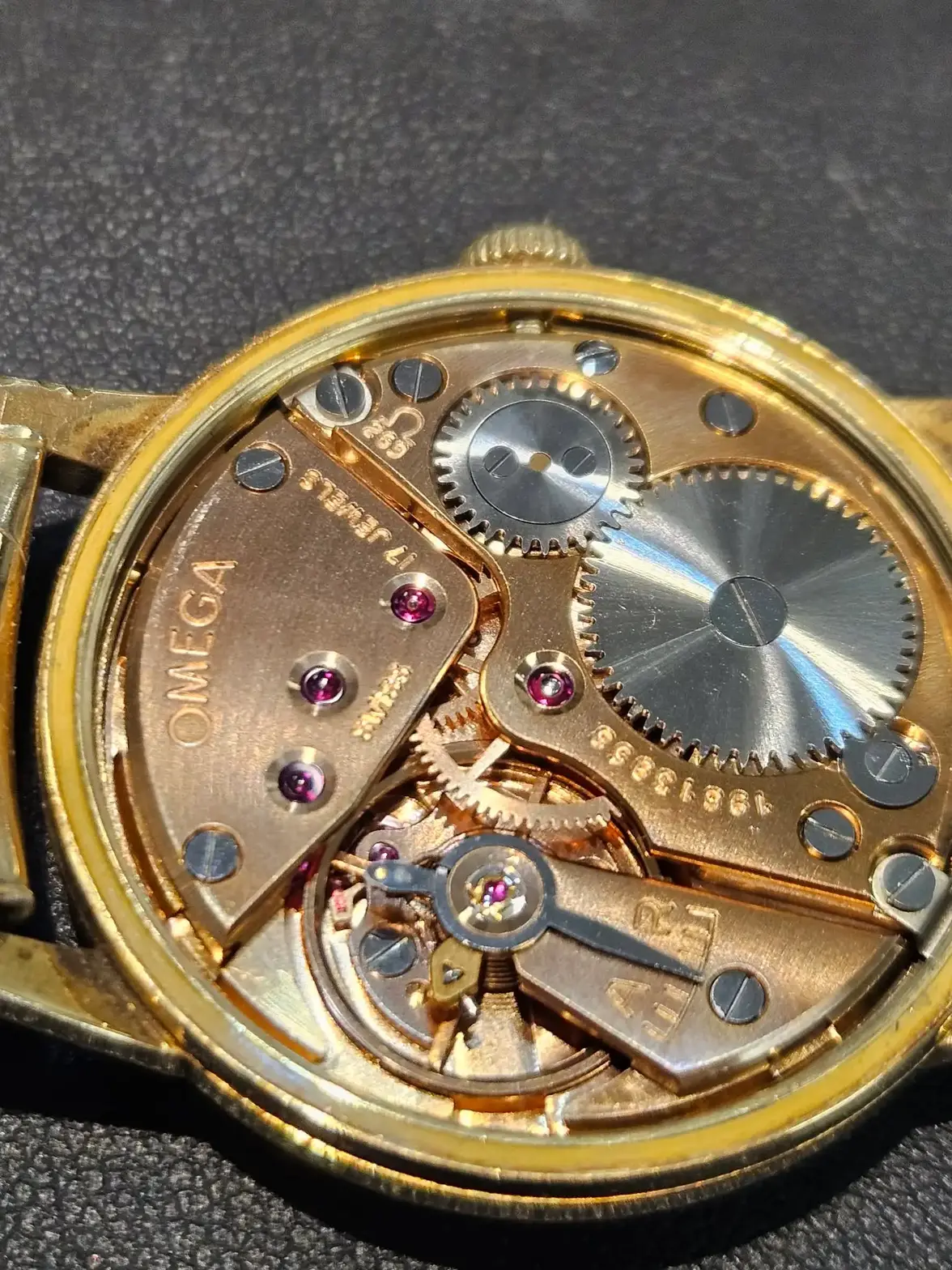

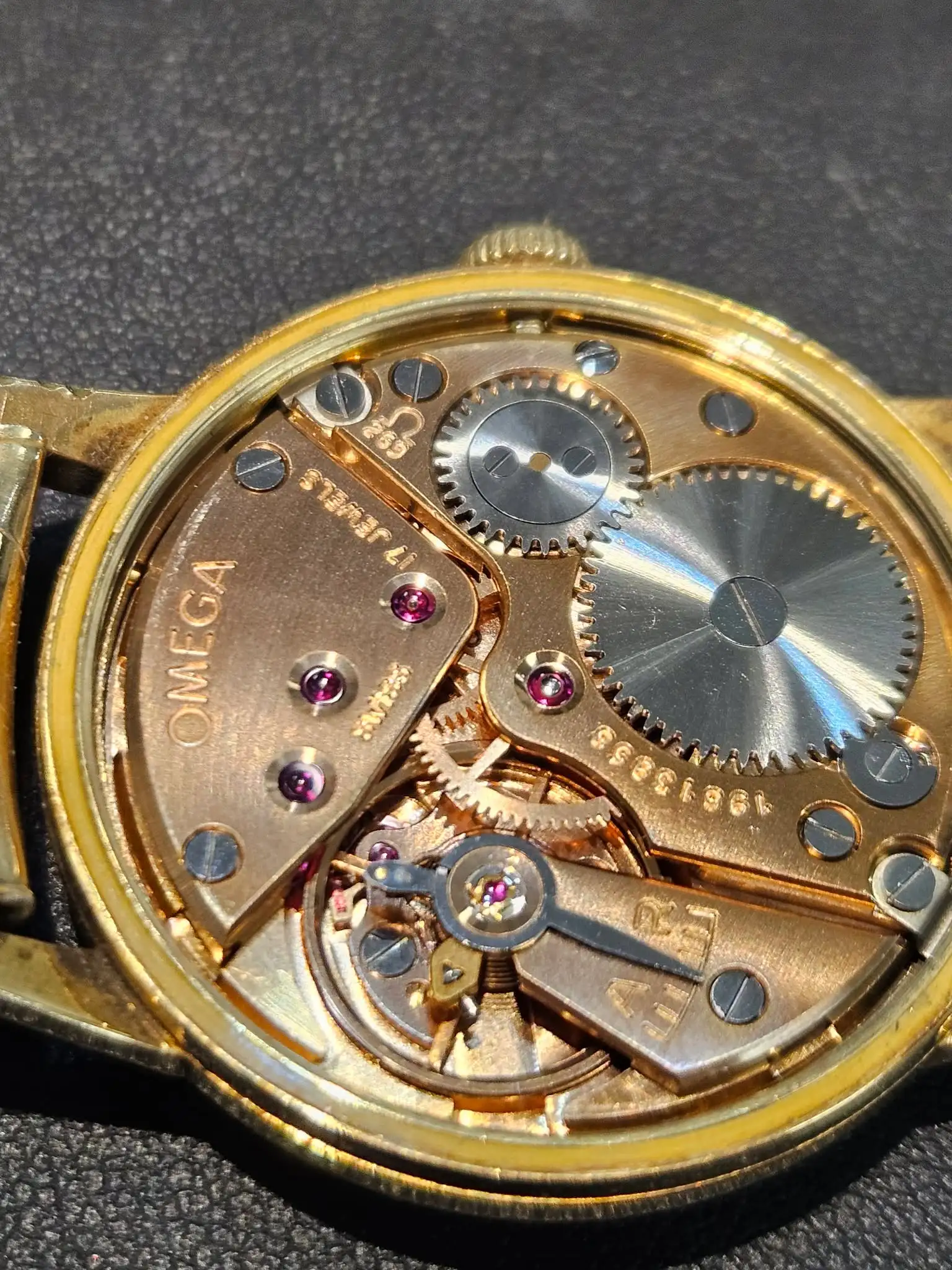

Regarding opening the back, it’s “lefty loose-y and righty tight-y”. But I would only let a watchmaker do it. There is a good chance that the rubber O-ring inside has turned to liquid goop and you might end up with a mess on your hands.
The bracelet is not made by Omega and has little value. The crown is missing its plating and needs to be replaced. The crystal also needs to be replaced.
The movement is likely a cal. 268 or 269, which is one of Omega’s better manual movements, but it likely to require servicing after all these years of not being used. Dial is nice and original.
Someone is going to need to invest $500 or so to get it restored properly. I can see $300 to $400 (US) for this in current condition, but not more.

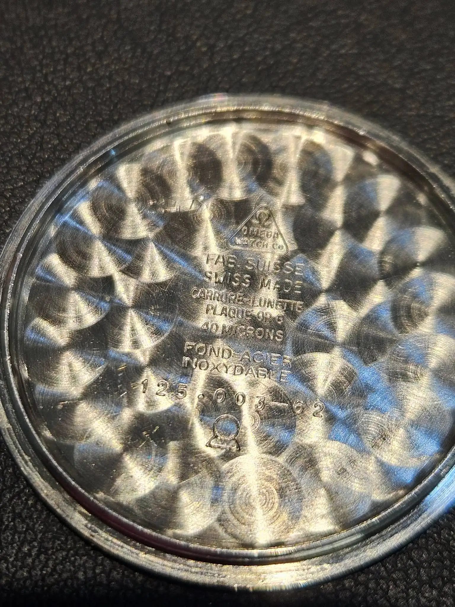

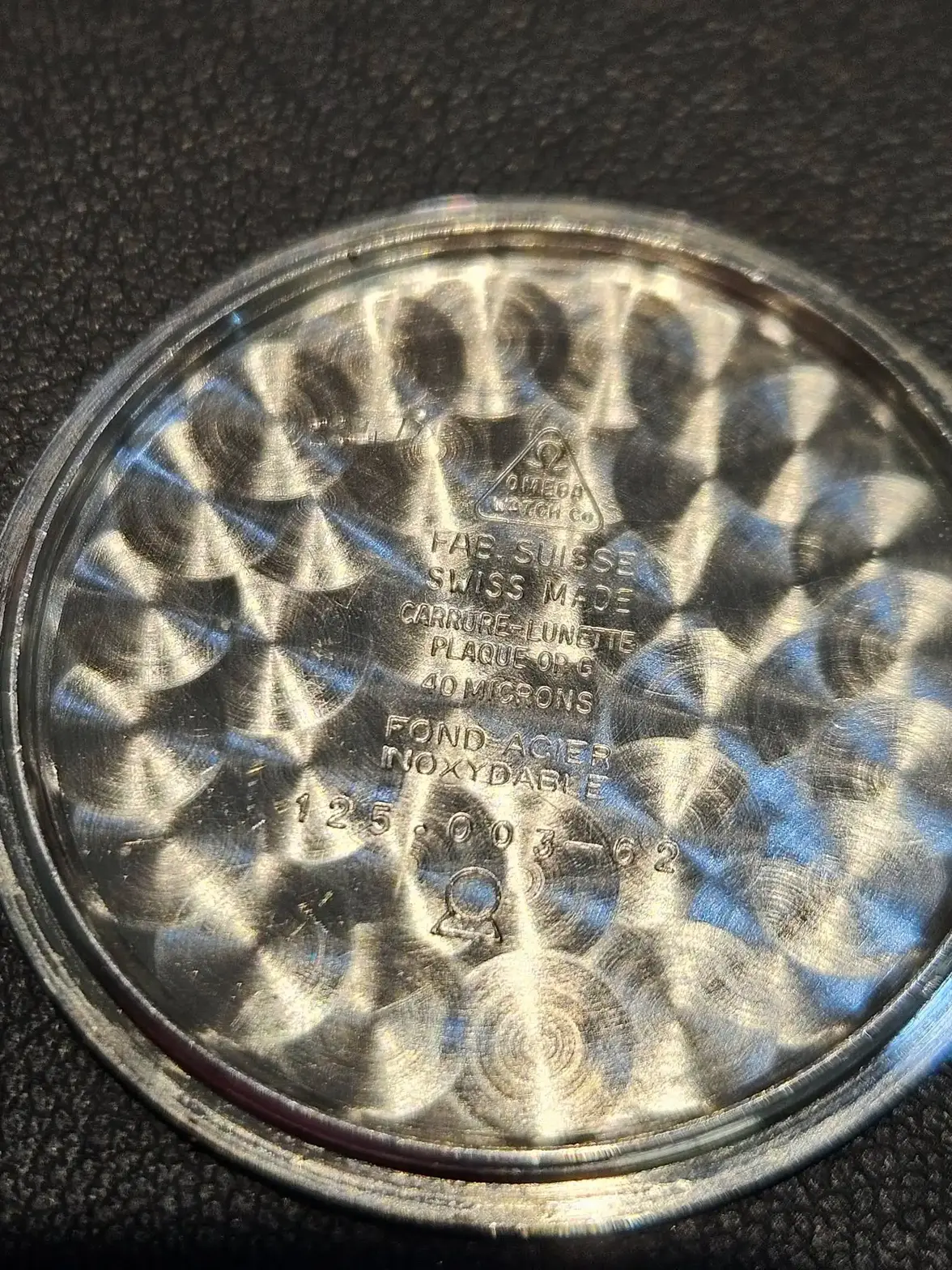

I took the watch in to have the back removed for pictures. this is a 125-003-62 269 movement.
just an update. you educated guess was correct. thank you

125.003-62 is the 'model' number, though there were plenty of configurations for these. 'gold' plated/filled/etc examples tend to sell for less than stainless models.
Last 3 ebay sales of this model:
https://www.ebay.com/itm/358634966913
https://www.ebay.com/itm/267656316095
https://www.ebay.com/itm/389887394695
They seem to have sold for $425, $499.99, and < $427.50 (accepted offer).
Cheaper ones both have worse dials, and the middle $499 one is in nicer condition. So I'd put the value of this mid-$400s or so based on comps.
FINDING someone willing to PAY that much is the trick of course, you might end up holding this for a while trying to find someone willing to pay more than gator's estimate.
