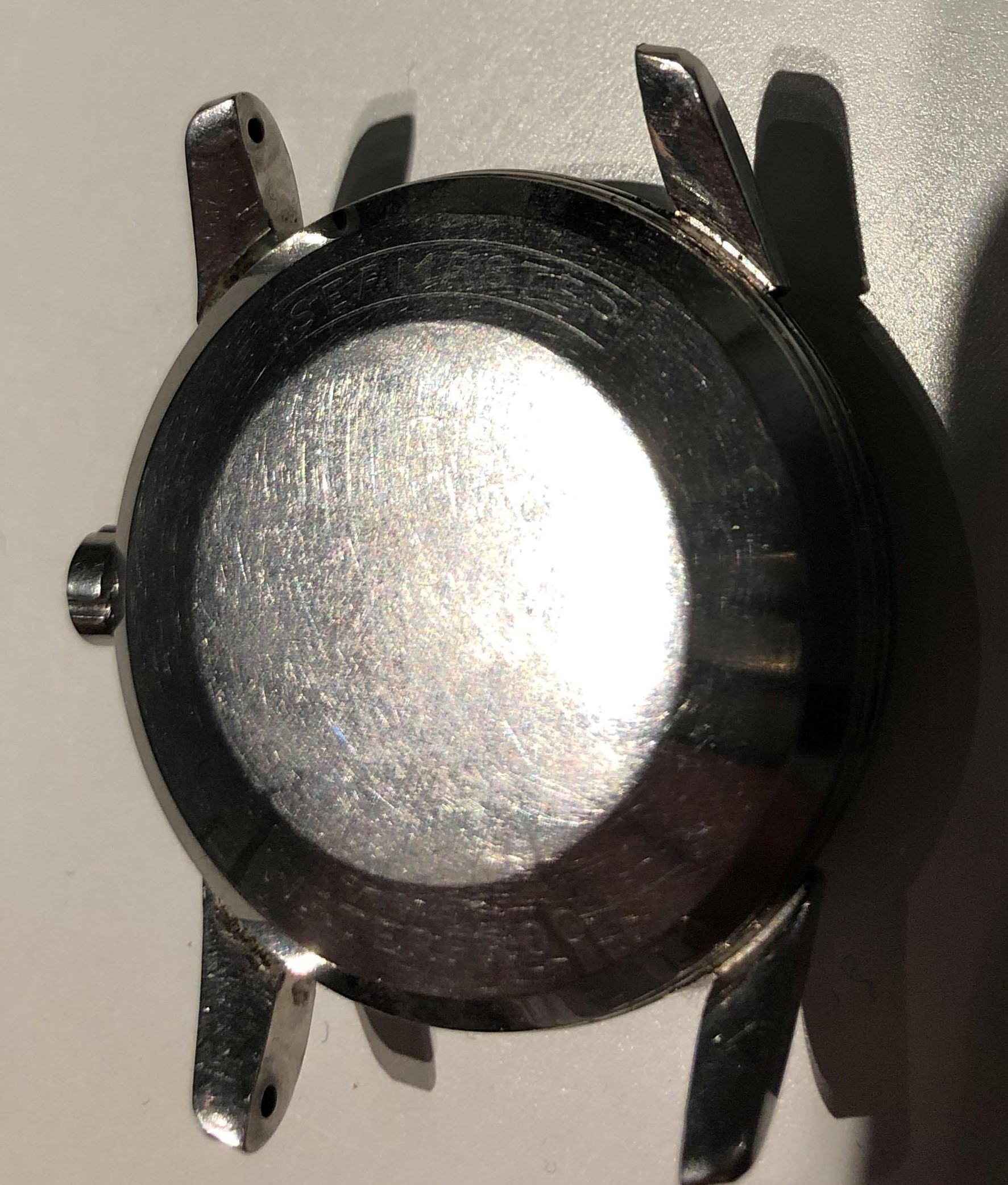

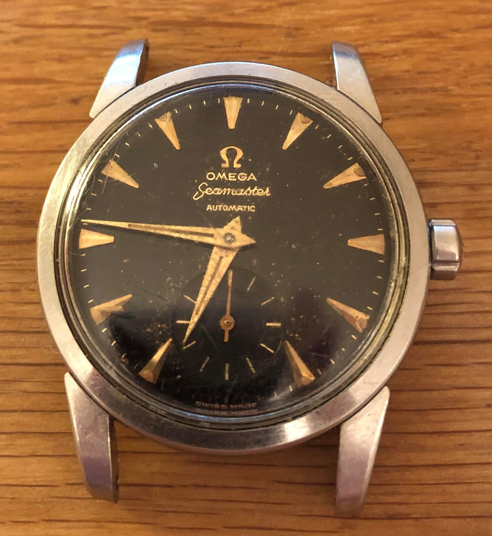

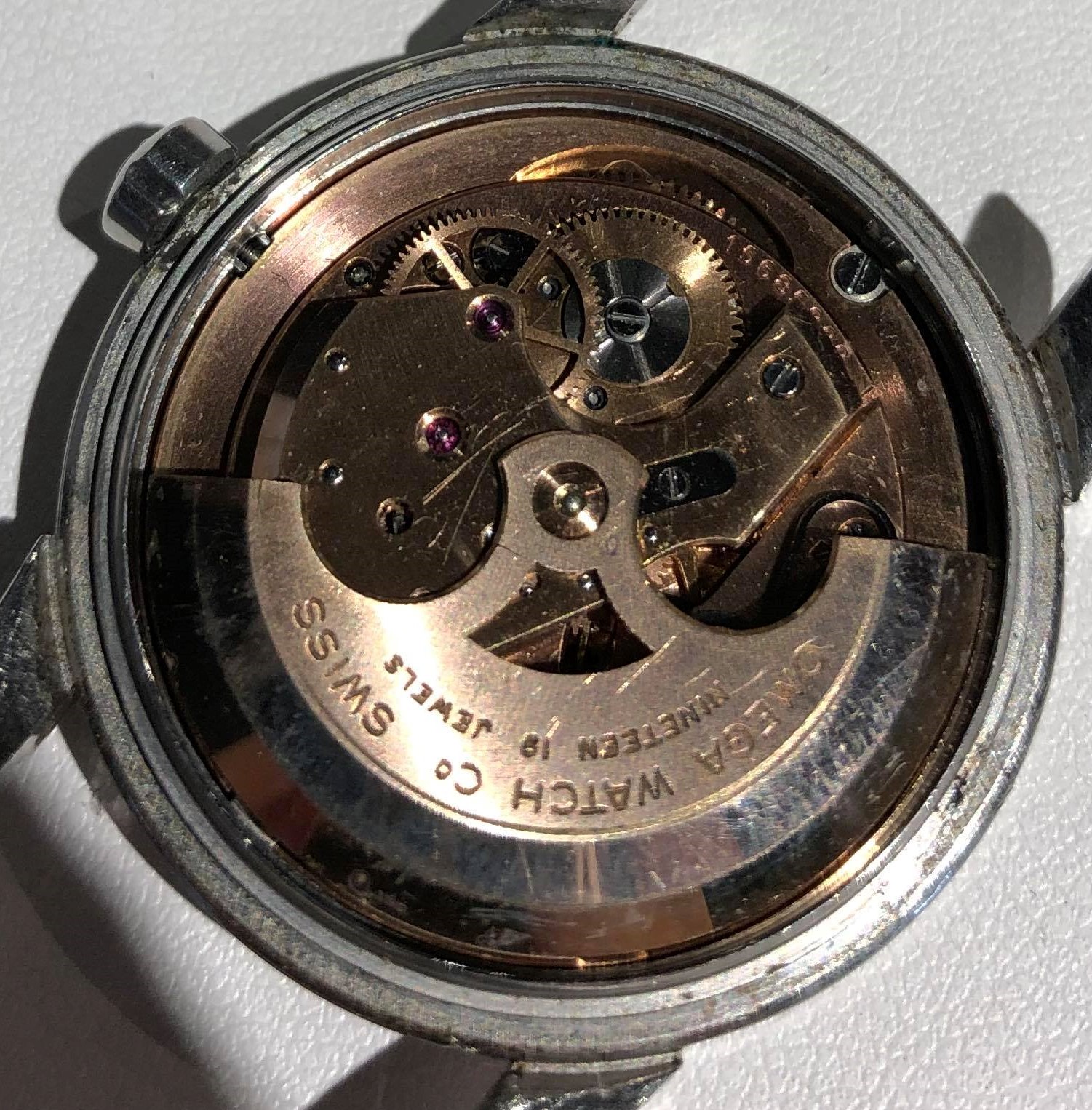

Hi all,

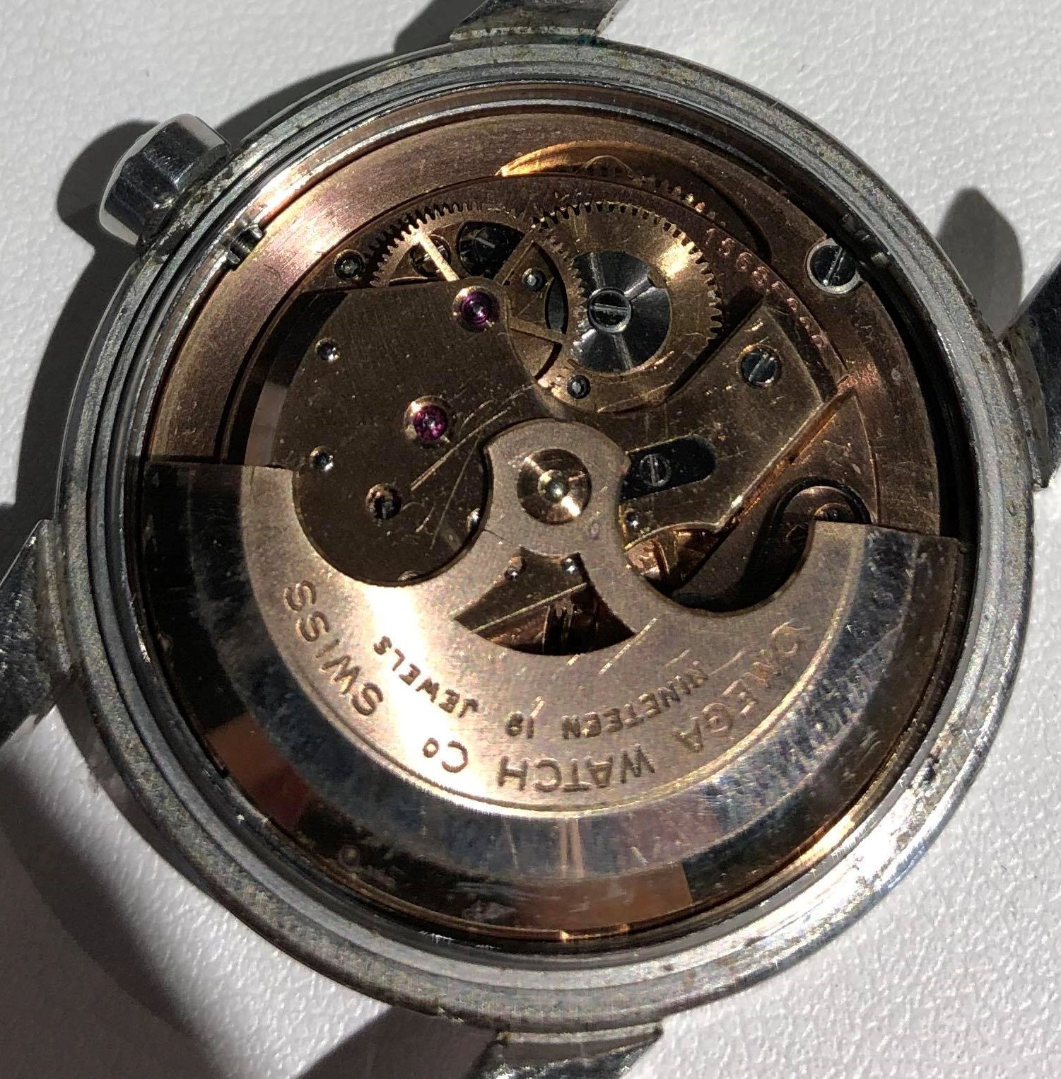

I have inherited an old Omega Seamaster 2848 Cal. 491. Although I have found some forum threads with similar versions, I have not found the exact match - and wondered what you guys could tell me about the watch and its potential value.
The watch is in pretty bad condition and has not been in use for decades. I am considering having it repaired, but an omega repair/service is quite expensive (500 to 800 EUR, maybe more considering its condition) in Norway.
Thus, I turn to you for advice on the following:
1) What can you tell me about the watch model?
2) What is an estimated value? Is it above the cost of repair?
3) If repaired, how often would it need service?
4) The front seems to be of plexi glass - is this common for the model series?
a. If this is plexi glass - this makes the front polishable. Is this pretty straight forward and something that I can do? Or should this be left to the service guy?
5) Some information to the service guy; e.g. what NOT to change to preserve its value.
a. The dial - even with some corrosion?
b. Change the plexi to sapphire?
Some information on the watch:
Black dial - looks to be some corrosion on the inside
Subdial
Outer caseback features the words “Seamaster” and “Waterproof”
Lug width ca. 18 mm, Dial width: ca. 34mm.
19 Jewels

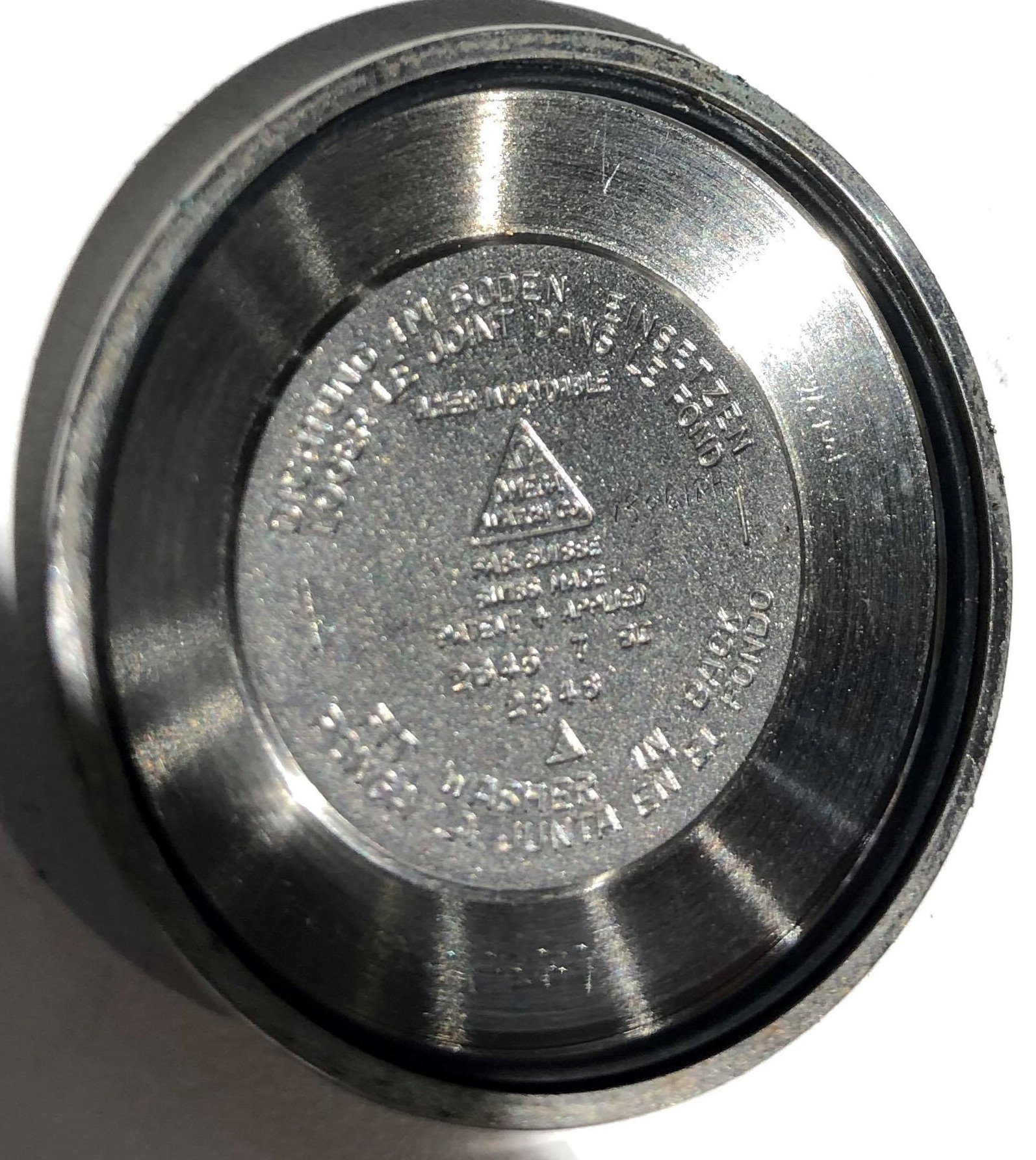

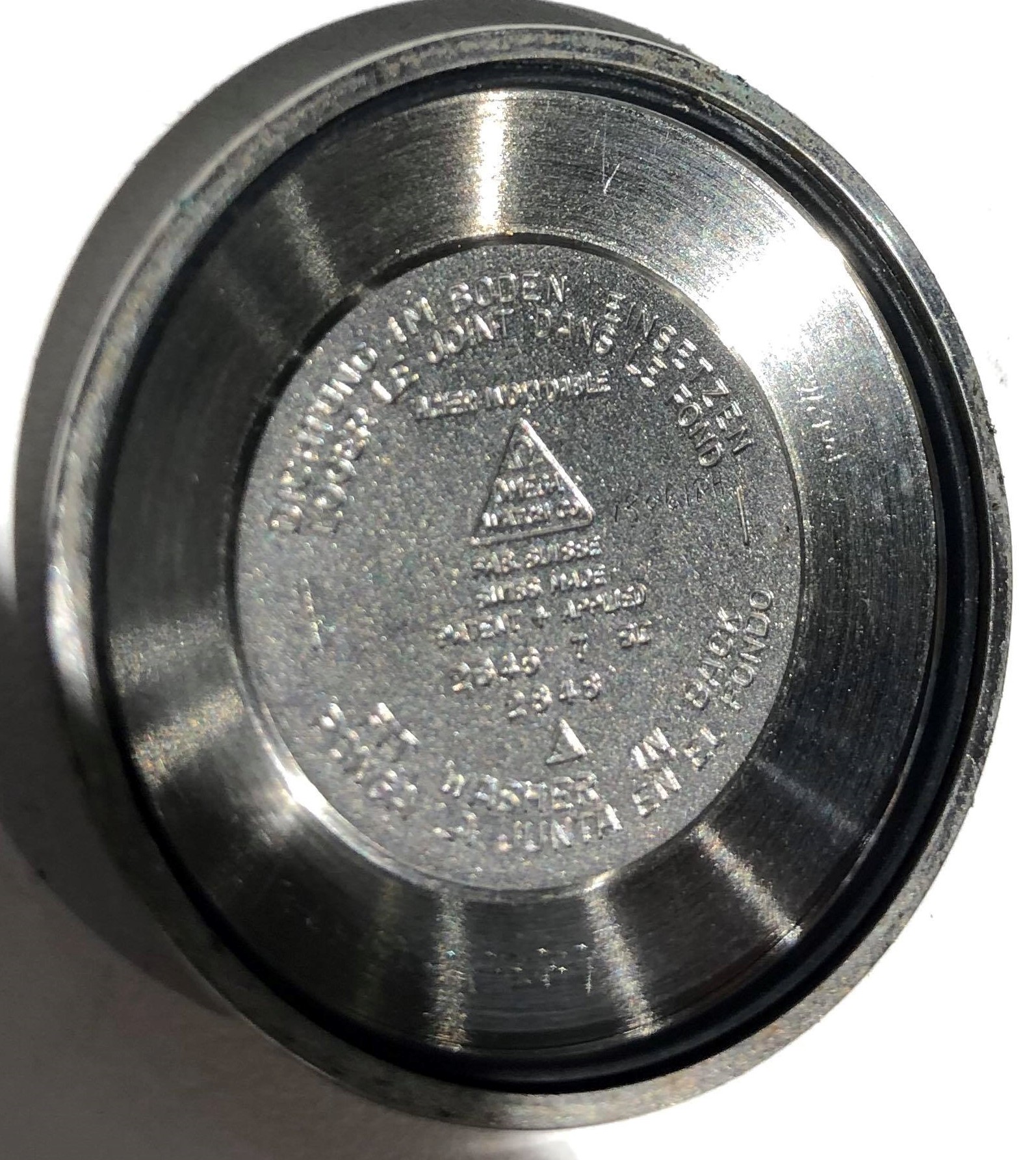

The inside of the caseback seems to indicate the following: 2846 7 SC 2848 (I got the watch opened at the watchmakers, so the photo is quite bad)
Thanks!

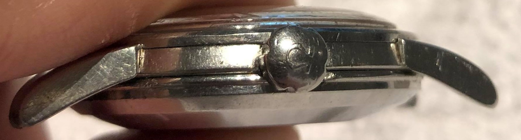

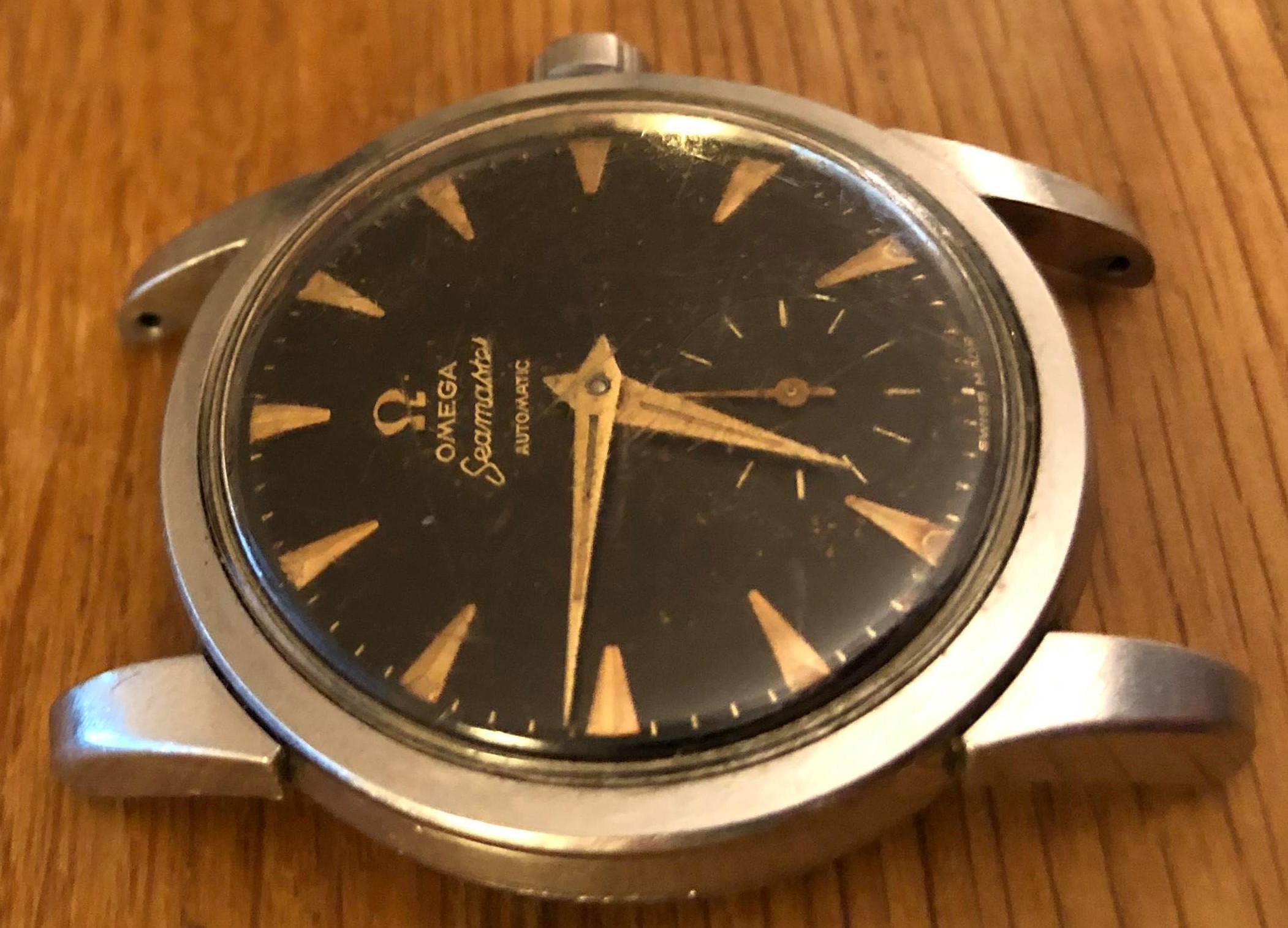

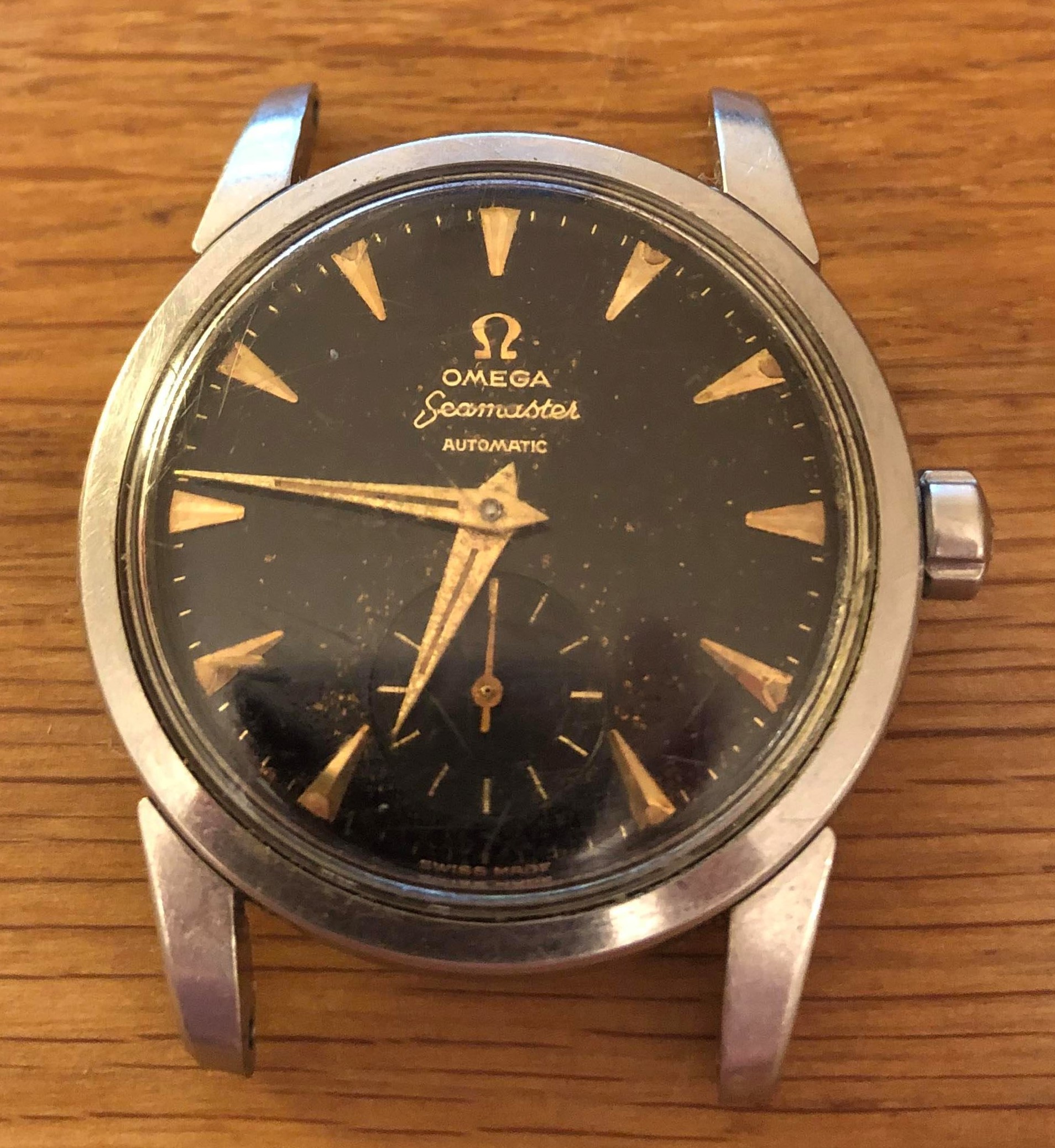

I think it's a great watch and a great inheritance too.
First things first, remove all ideas about sending this watch to Omega for a service. There has been a huge amount written on this forum as to why that is not recommended for a vintage model. To sum it up: expensive and they will likely want to change a lot of cosmetic parts for non period correct replacements
I would expect a normal service ( excluding parts ) but including a crystal polish to be around 150-200 euros. Find someone who has experience with vintage, specifically Omega and ideally with access to parts.

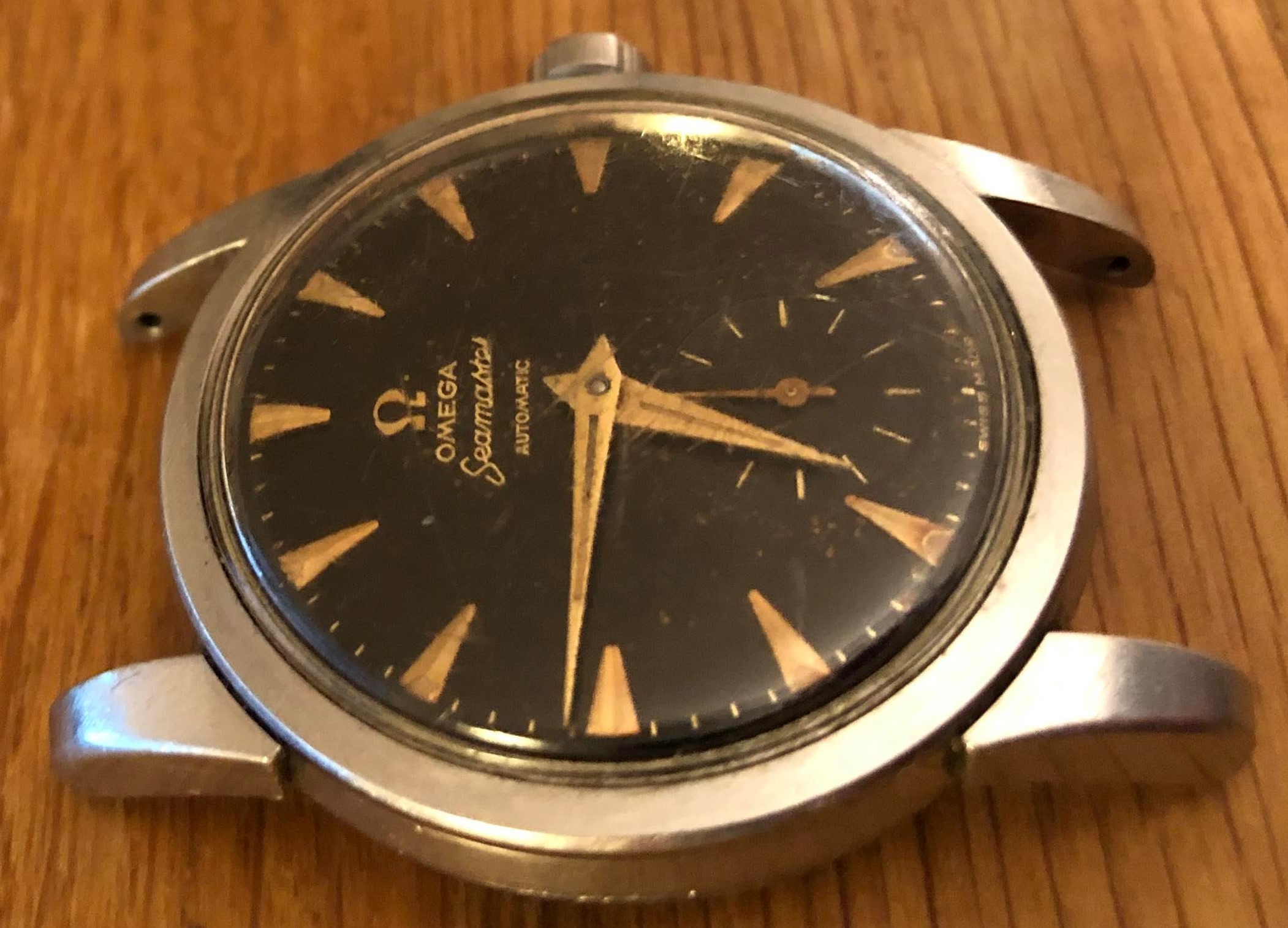

Don't touch the dial- you won't improve it

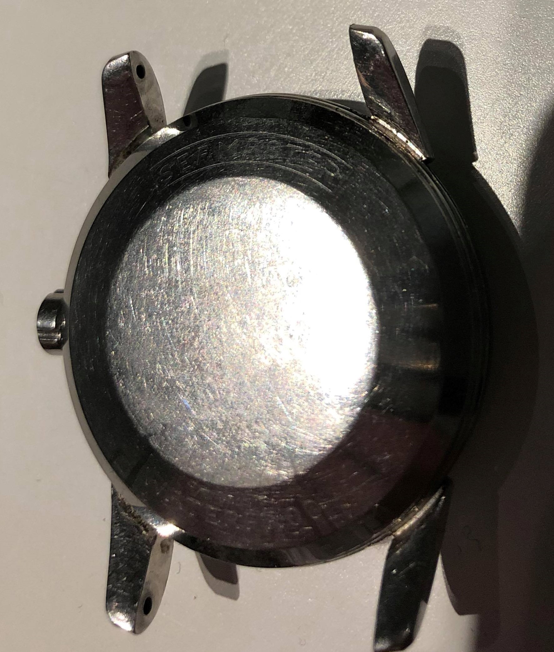

Don't let the case be polished- ultrasonic clean only- the case shows its age nicely, leave it that way.

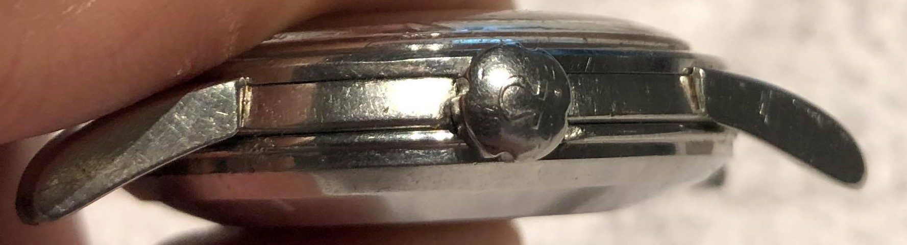

Try to save the original crown- it has the old and attractive logo
Value- As-is I'd be buying @ E400, that due to the dial damage, if the dial was mint I'd go up to maybe E500
If it was serviced/cleaned up and for sale in a vintage watch shop/site I'd expect to see a price tag of E1500-1750 on it ( Most people around here wouldn't pay retail of course )
Hope that helps a bit!

Buy a tube of polywatch and give the crystal a polish. It’ll look very much better.

A watch designed for an acrylic crystal should have an acrylic crystal.

Fair market value for an unpolished, fully intact black 2848 would be > $1000 US, in my opinion.
Nice example! You're most fortunate.
