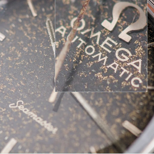

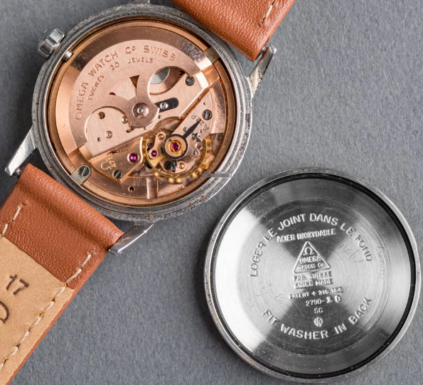

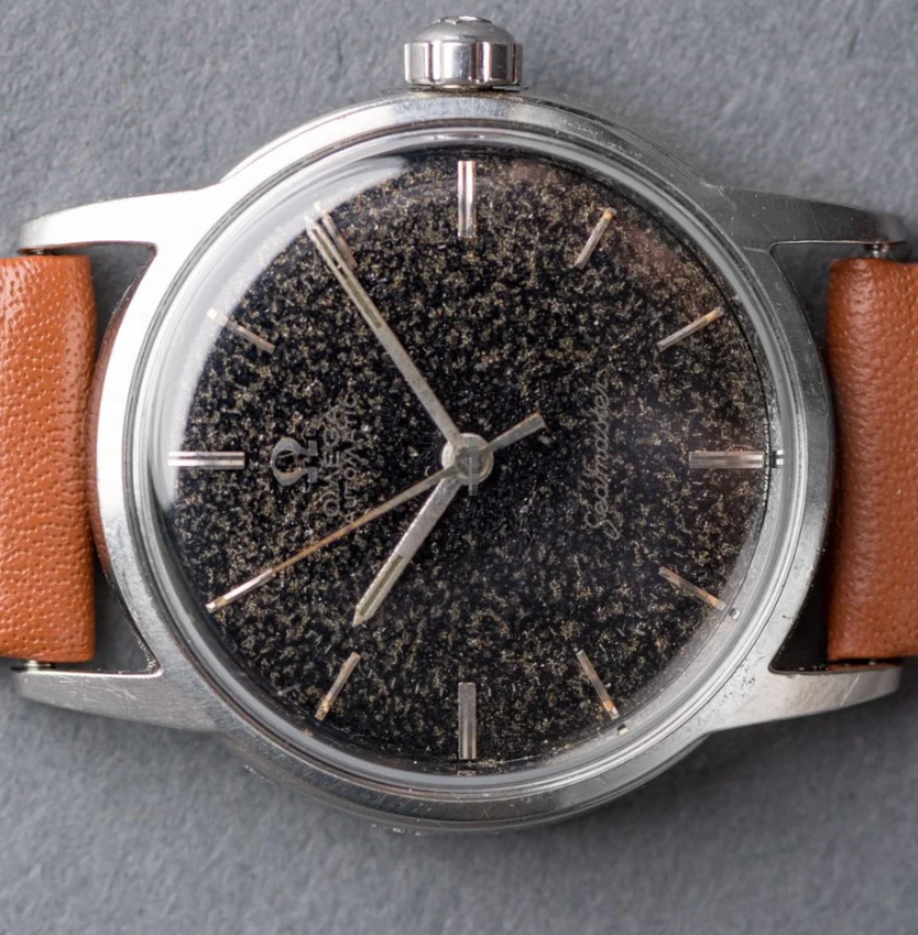

Hi all! I have just joined and looking for a 50s Omega to enter thhe vintage world. I came across this (supposedly) '58 Seamaster cal.471. Does it look original? Is it worth giving it a go, if the price is right (and if so, what the "right" prace would be?

Hey, thanks for the swift reply. I know that black dials were not very common and they can develop such patina. I'm not sure though if it matches the year etc. Lugs are not razor sharp, but they are not overly rounded considering the age. The hands look alright to me, same as crown which I saw in other 2790s that were claimed to be original.
Plus - I have a tiny wrist, that's why I am considering a really small watch, unless this will look really odd for a male.

Sounds good. Black dials from that era are known to age like this, dial is original. Case seems ok, there's corrosion visible on the hands, especially the second hand. Movement looks clean, but do factor in a service regardless. The crown is even the correct flat feet example, nice detail.
As you mentioned, it's a very small reference with 32mm in diameter. That has a significant effect on the price. The 700USD asking isnt completely bonkers, but for that size still on the high side. Not surprisingly though, given it's offered by a dealer on C24. I'd say some negotiating wouldn't be outrageous.

Will look very small, like tiny, the 471 is a 25mm movement normally seen in women's watches, a quick check suggests less than 32mm watch diameter in fact, one listing states 31.8mm. Watches of this era are already small, even the full size are only 34-35mm so I personally think it will look silly, yes. Price wise? The size and heavy patina hold it's value back, low to mid hundreds of bucks tops IMO, maybe $500 tops.

Thank you very much @MtV and @padders - both of you confirming size might be a concern here made me think that probably it's not for me, even though I like the overall look of the watch.
