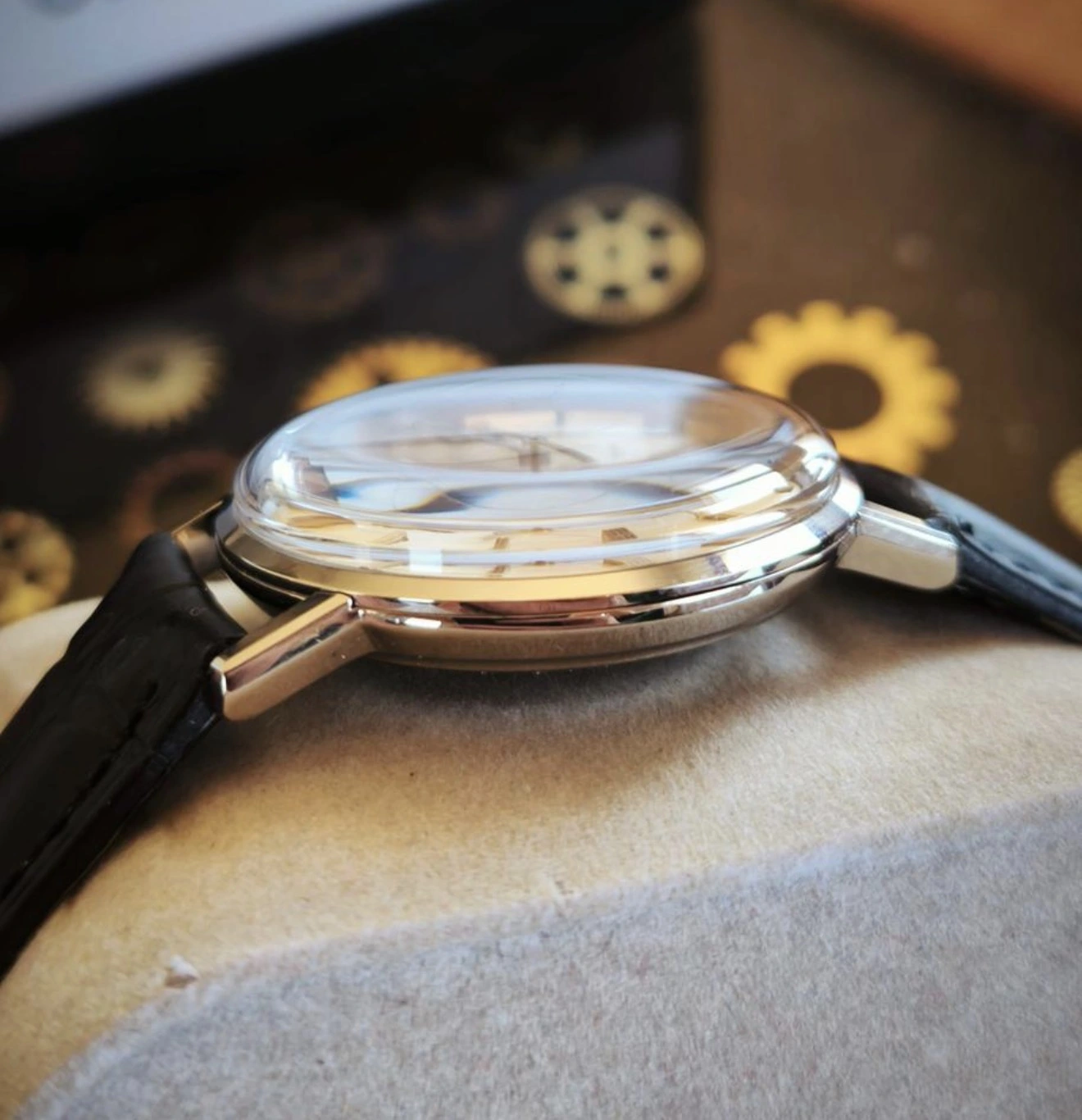

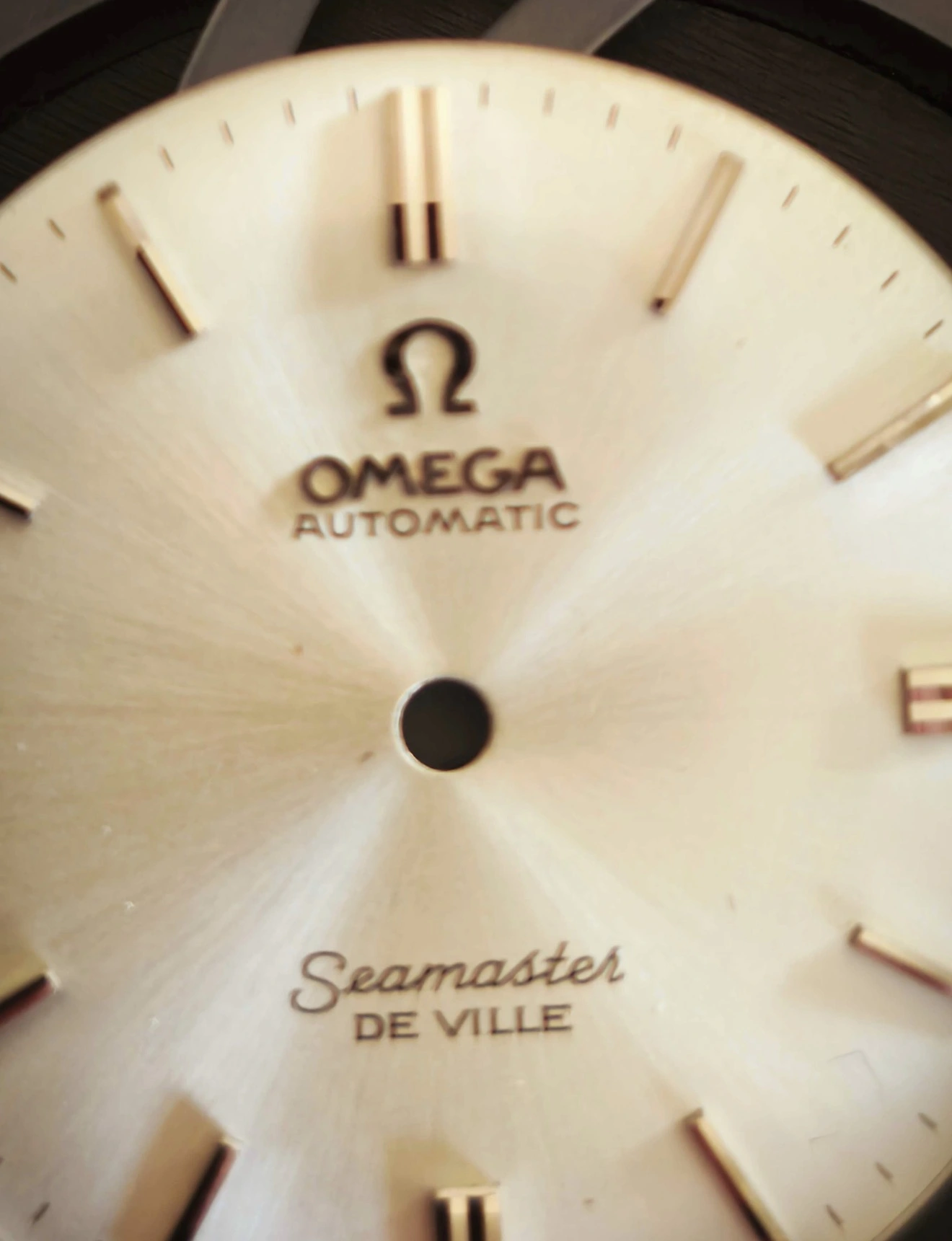

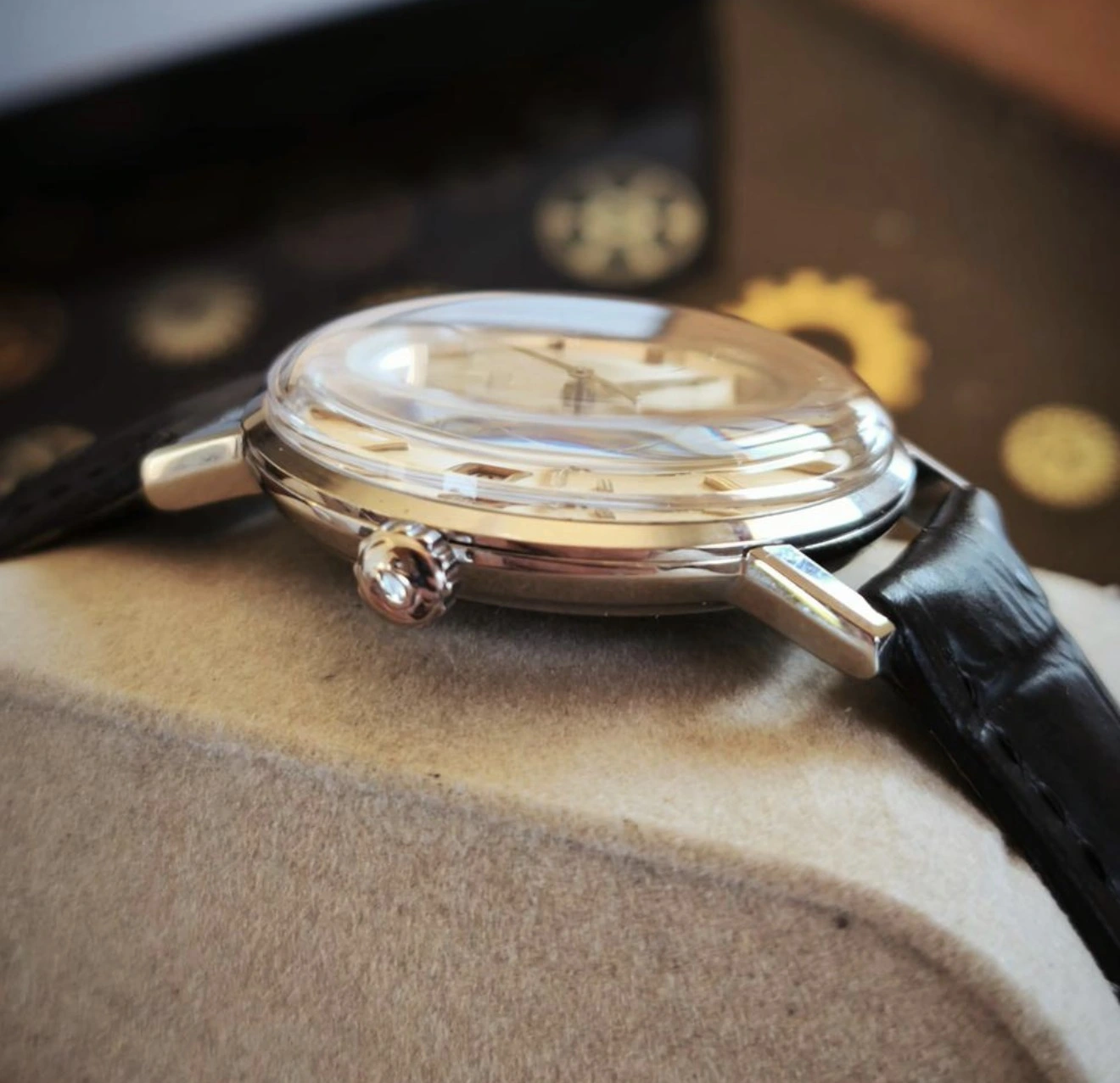

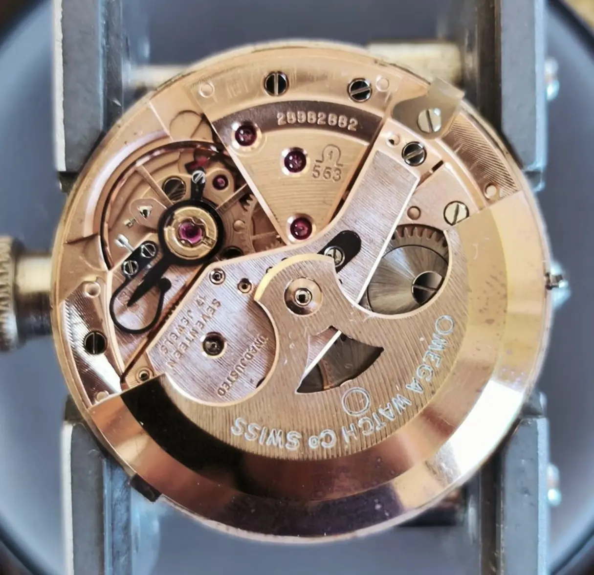

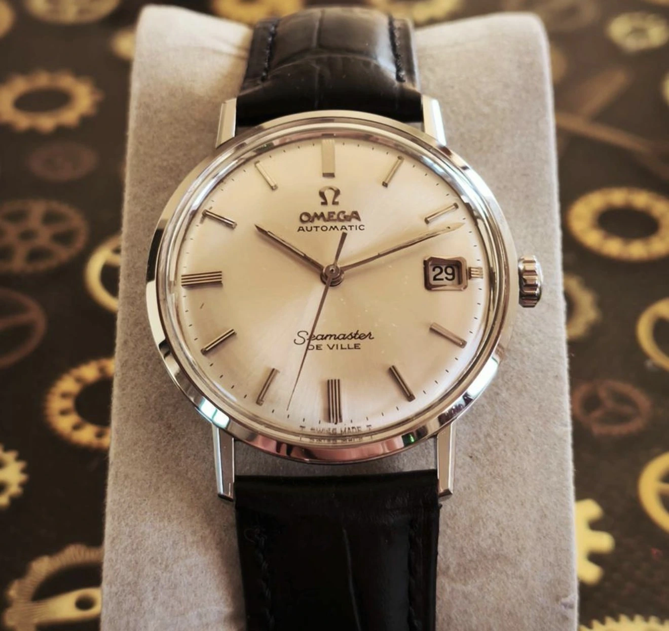

Hi all,

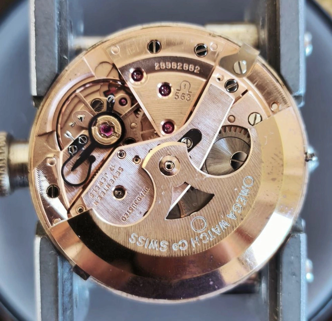

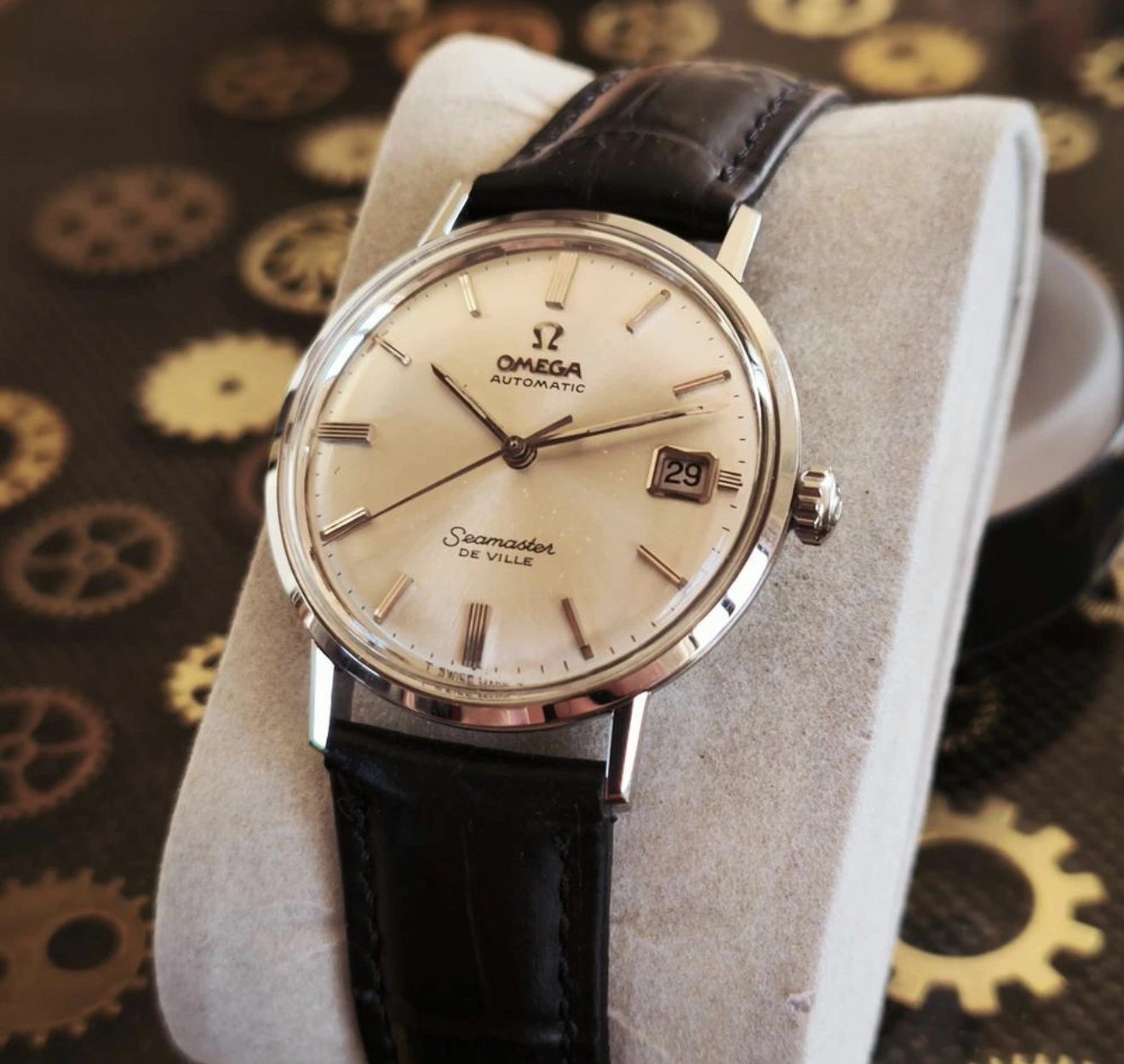

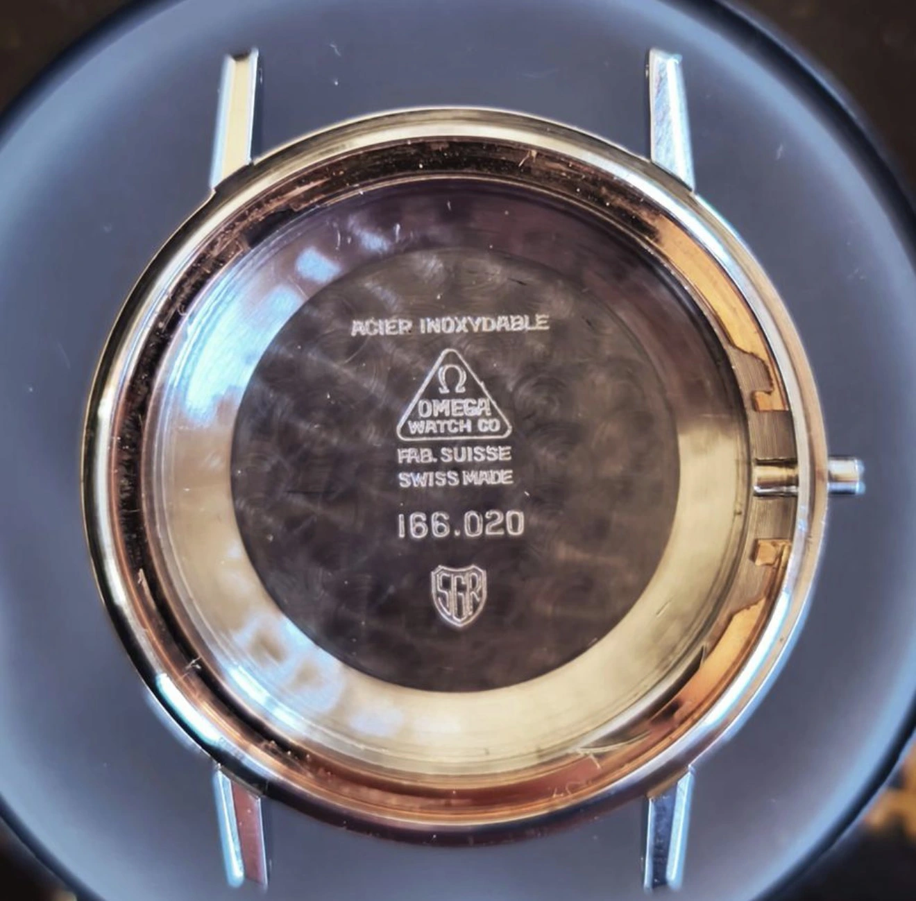

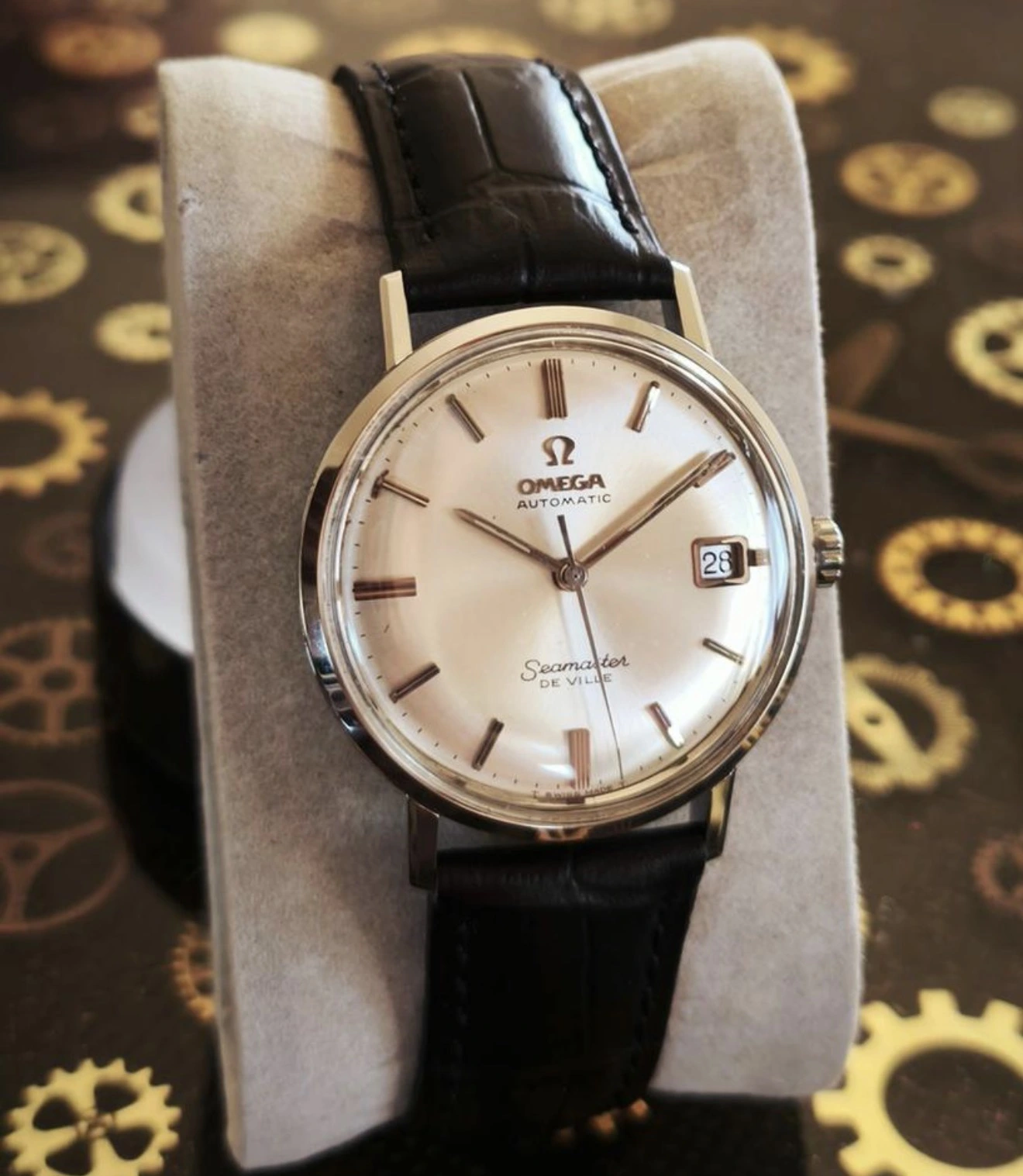

I am looking at purchasing this watch. I can’t find anything g wrong with it but would like to defer the real experts. To note, they have changed the crystal with an original omega (vs the pictures).
Any feedback is appreciated.
3,675
8,001
Hello
The case is quite polished, but original caselines are visible just a bit soft. Watch looks original and legit. What is asking price?
4
Thanks. Price is $1900 with original 1971 box and papers.
3,675
8,001
very high looks like dealers price. Box and papers add a little not much. Common watch they are avail for much less. If they say serviced need detailed watchmakers receipt as proof or consider not serviced.
4
It is serviced with proof. What would be a decent price range for it ?
3,675
8,001
Box and papers worth maybe 200, documented service (should also have watchmaker warranty) 300
Still quite high for this common reference IMO 1400-1500 with service and papers if you love it.
