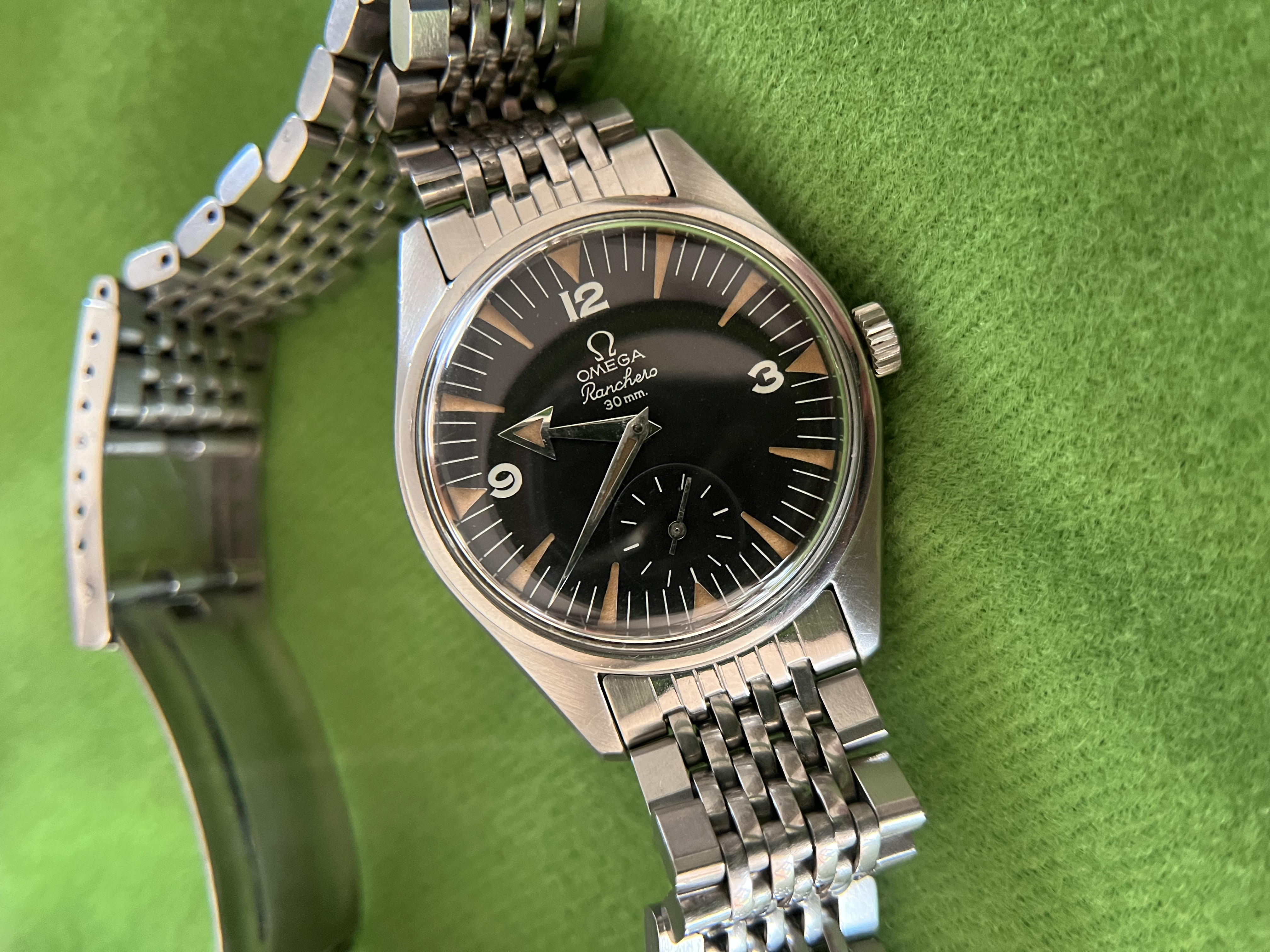

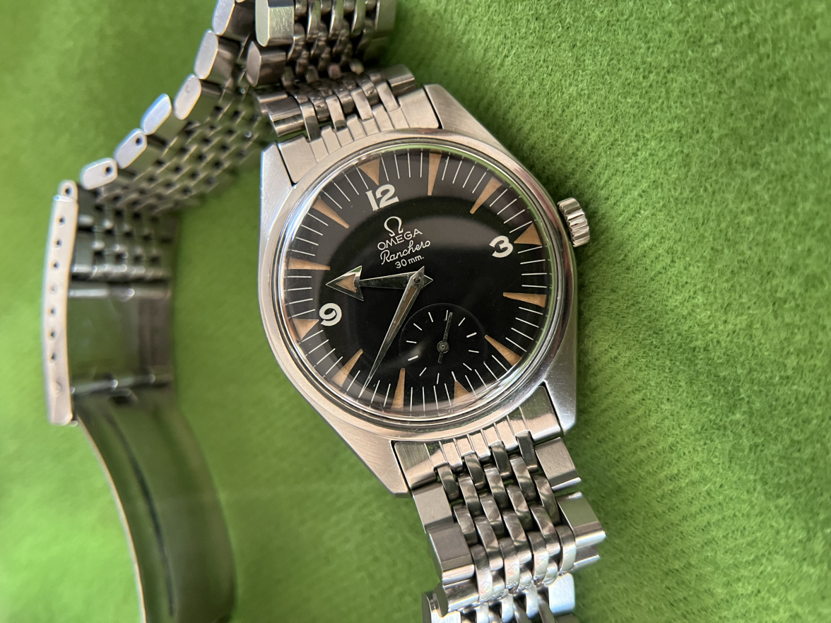

Clearly a redial. Beat up movement tells the story.

Is the bracelet a reproduction also?
Endlinks aren’t factory.
What it looks like you have here is a frankenredial. The movement is a genuine Omega movement (although looking rather abused) and that’s probably about all that is as it left Omega. It may be a factory case (need to see the inside of the case back) and the dial may have been a factory silver dial under that paint at some point. But this watch didn’t leave the factory looking like that.

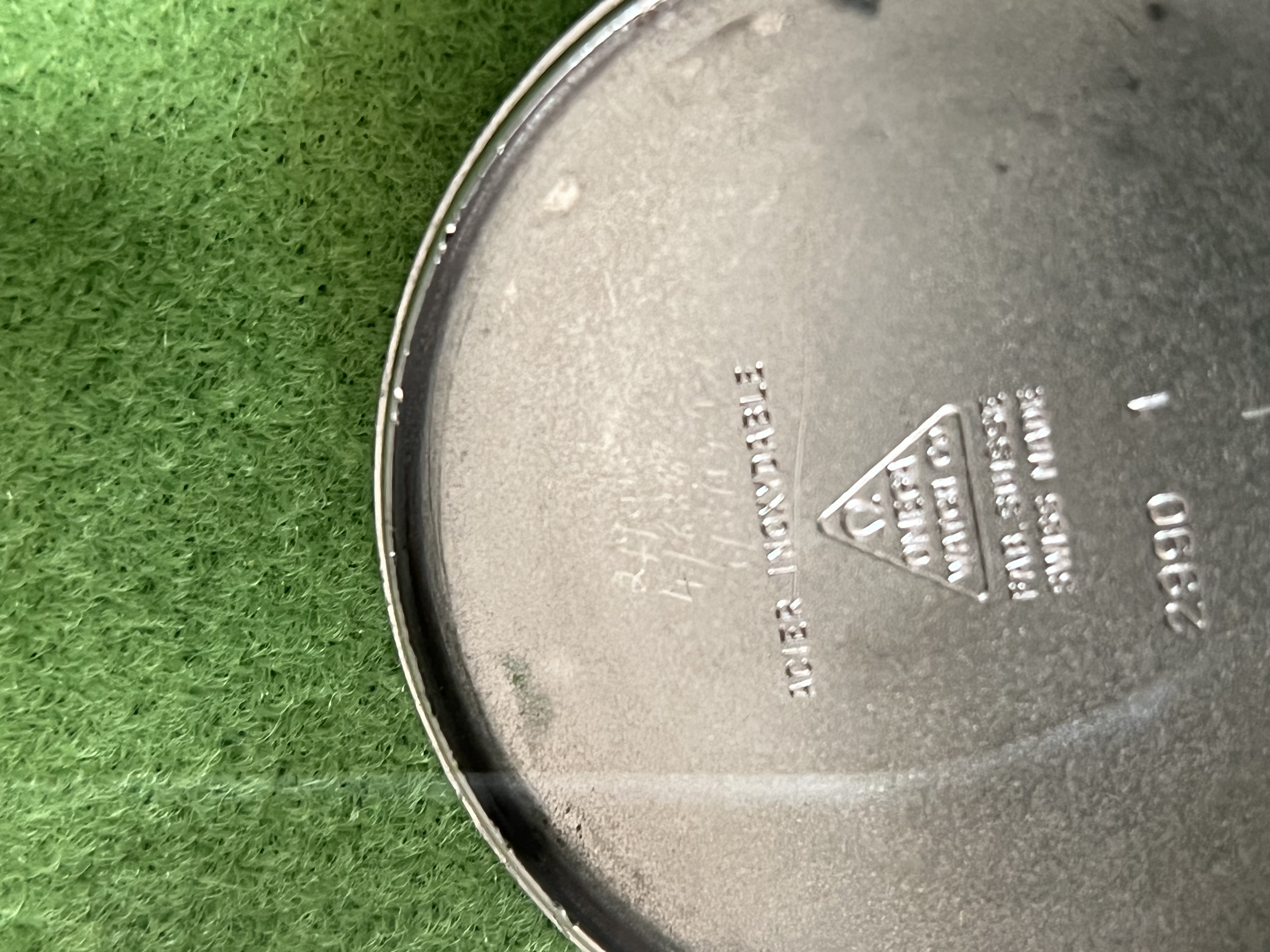

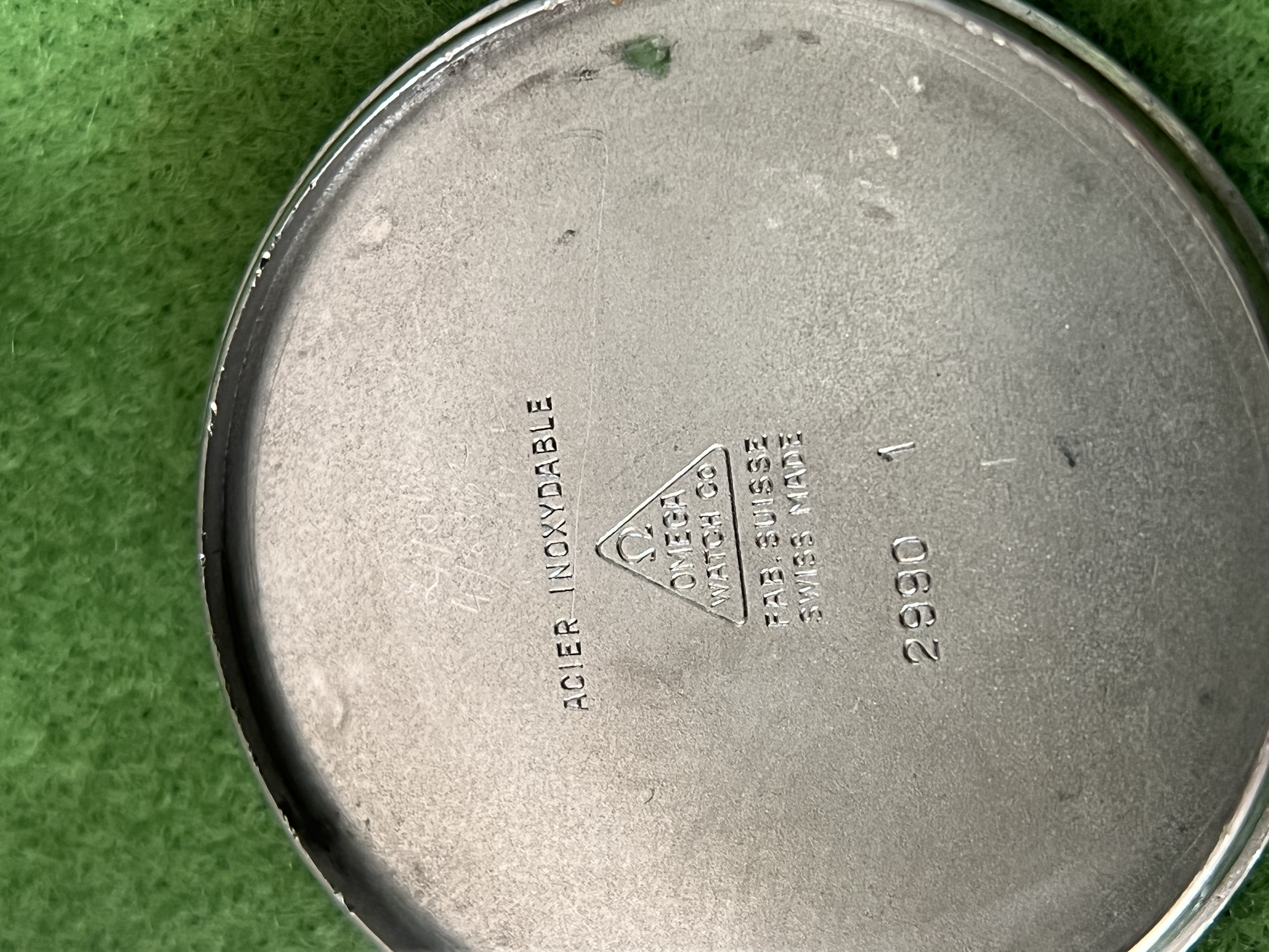

Here are the photos of the case back. There is some writing just above the wording that I tried to capture as well. Thank you

Your friend got swindled unless he knew it was dressed up to be something it wasn’t and paid very little for it. If he got it recently, and it was from a reputable “dealer” at a watch show- then I would suggest he contact them and direct them to this thread.
