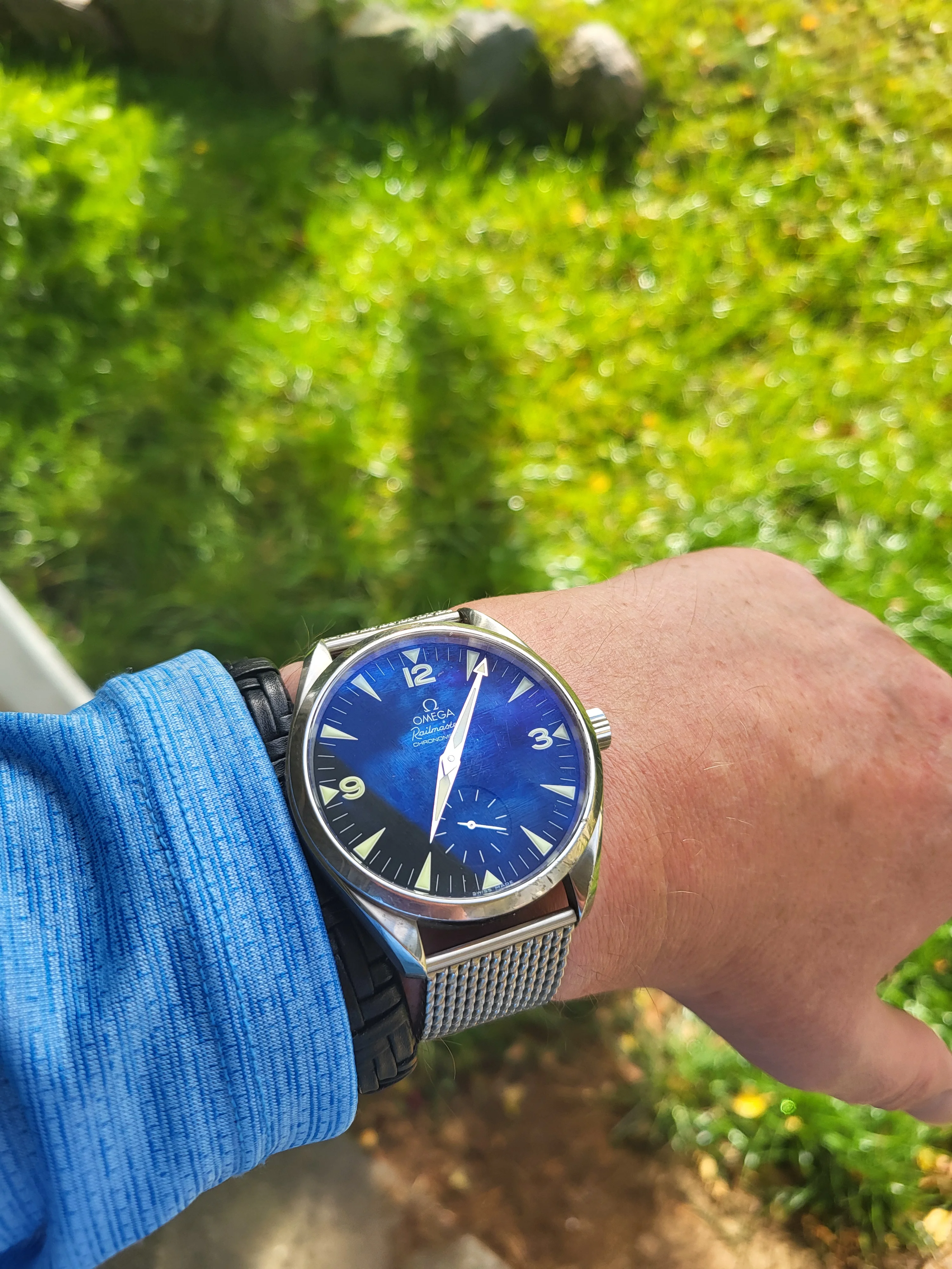

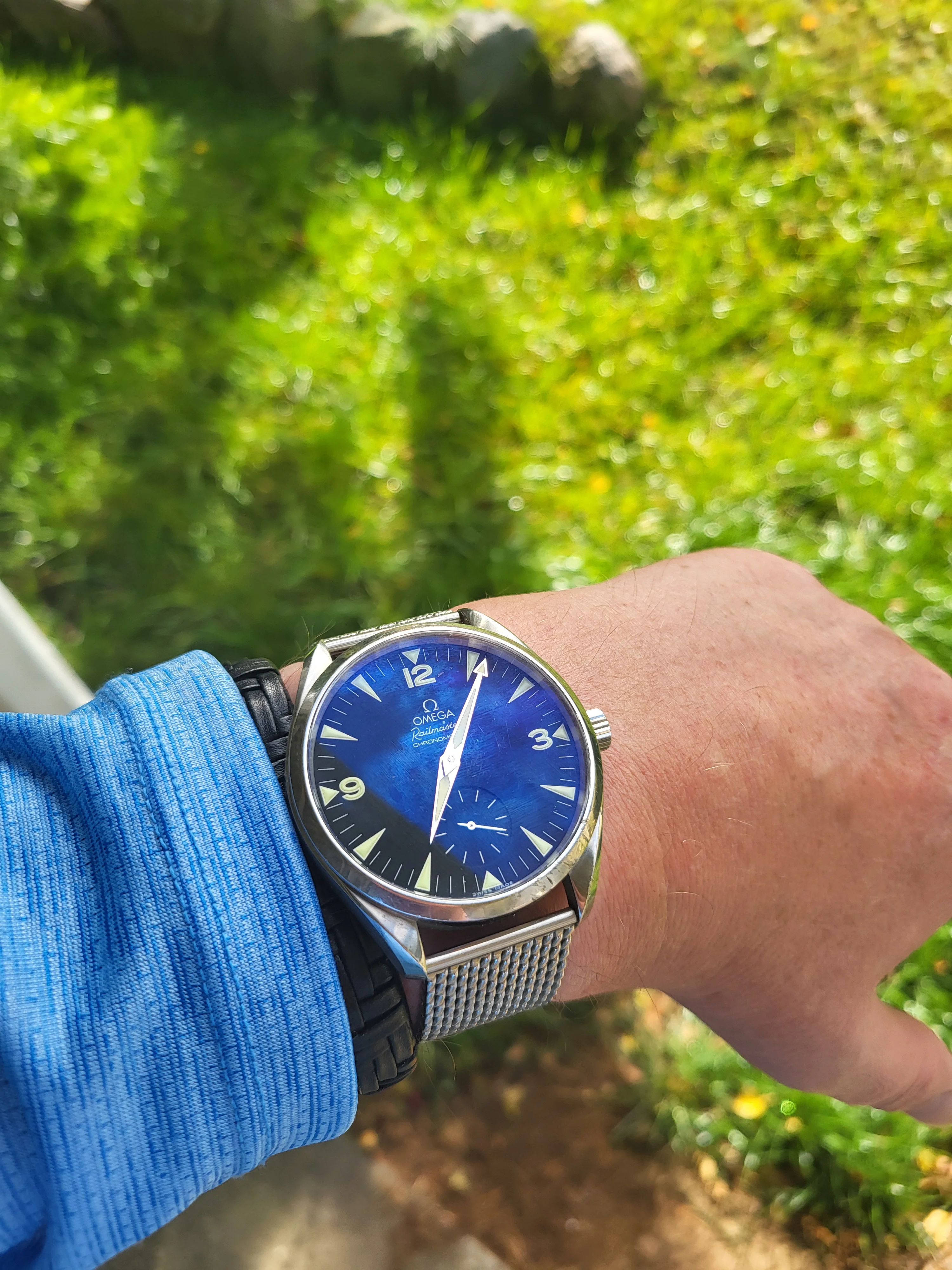

I’d love to see a wrist shot of that watch.
It's currently with my watchmaker, but I will try to accomodate your request asap

OP @Pacificodk , how is that going? Hopefully your repairs are under control. Please do post a wrist shot of your watch when you have a chance. Thanks.
8
5

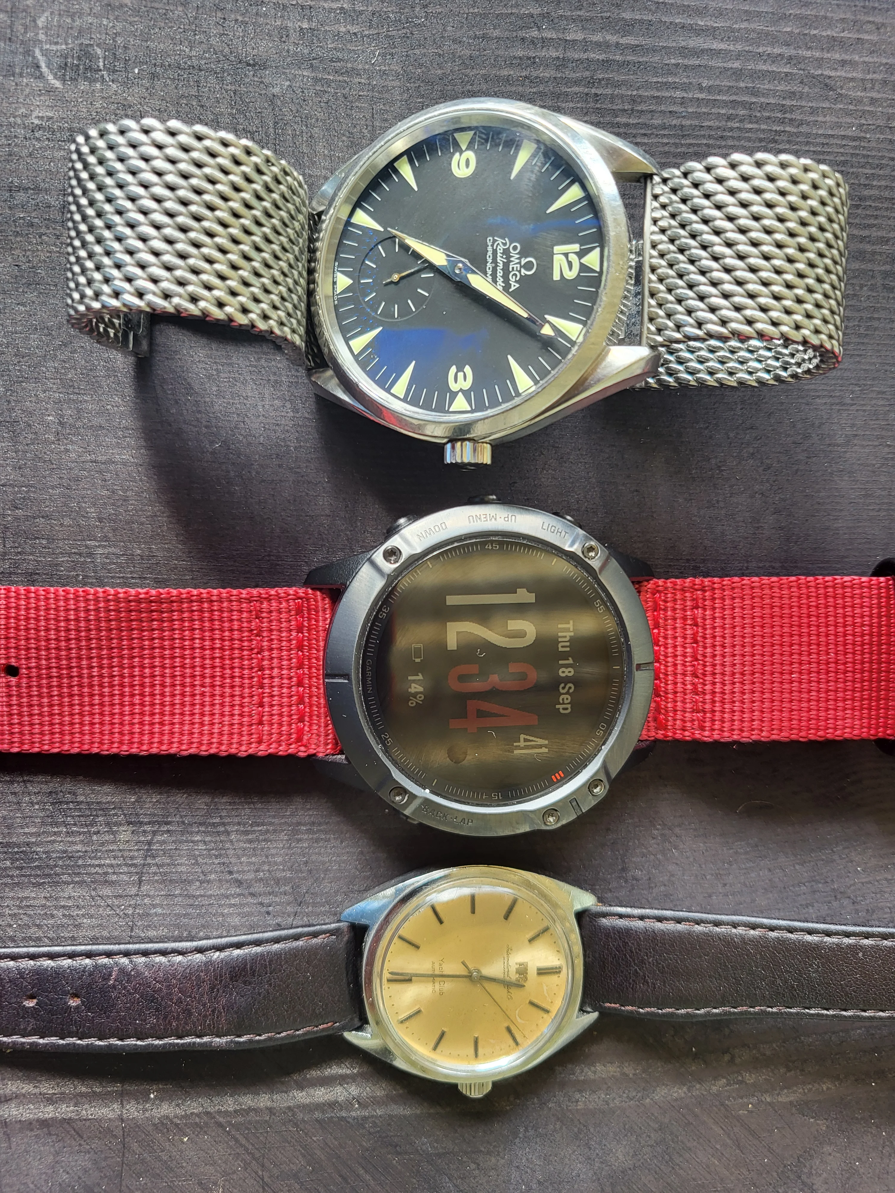

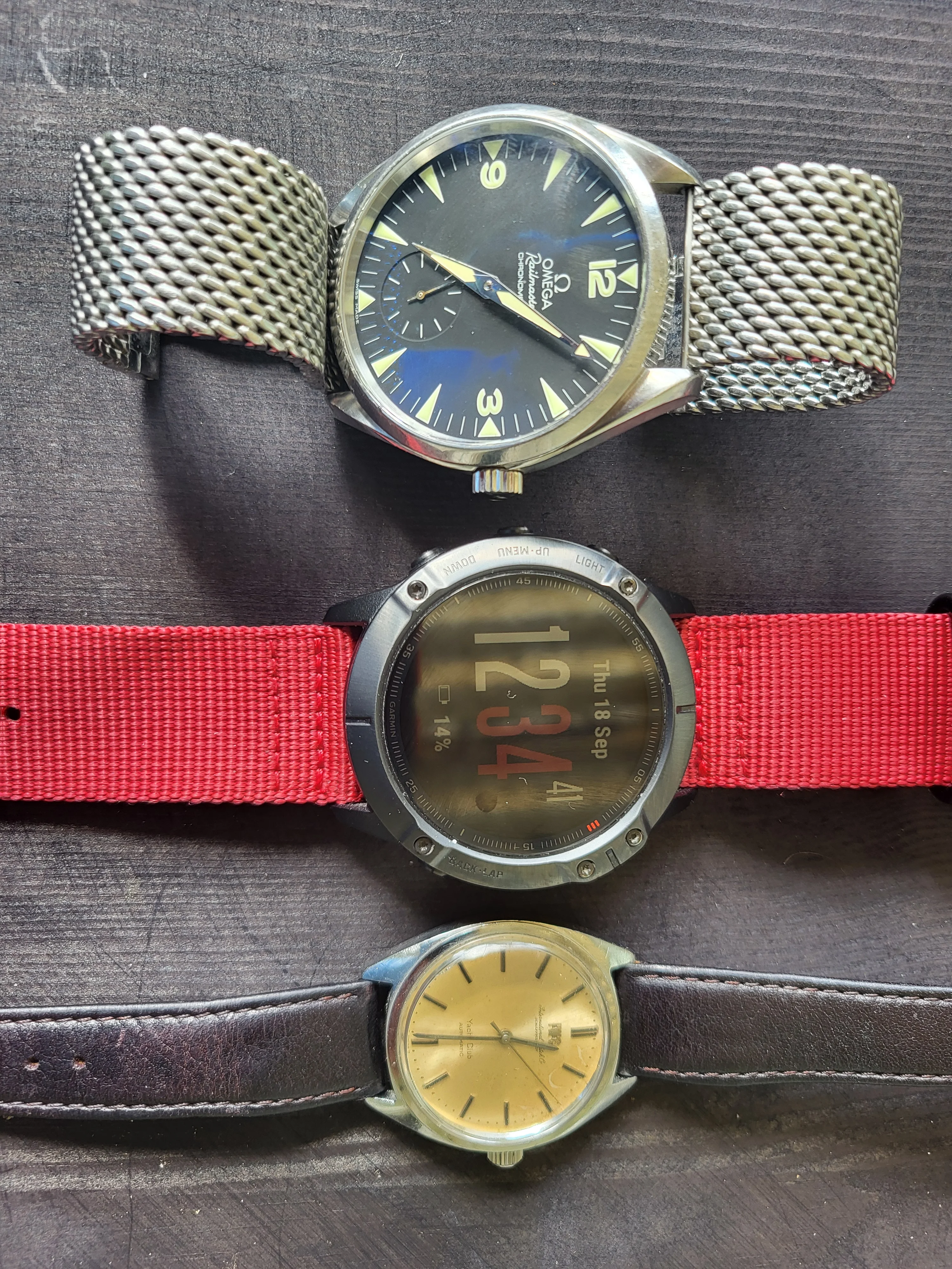

Still no luck sourcing replacement part 069ST42182, but here is a photo as some of you requested
8
5
My "tiny" watch collection just for fun (Nb! the odd one -1967 JWC Yacht club is for sale if anyone is interested)
8
5
Top to bottom. Omega Railmaster XXL - Garmin Fenix 6HR Sapphire - 1967 JWC Yacht Club
Thank you for your pictures. Surprisingly, does not look too big at all! That's a temping watch for me, for sure.
