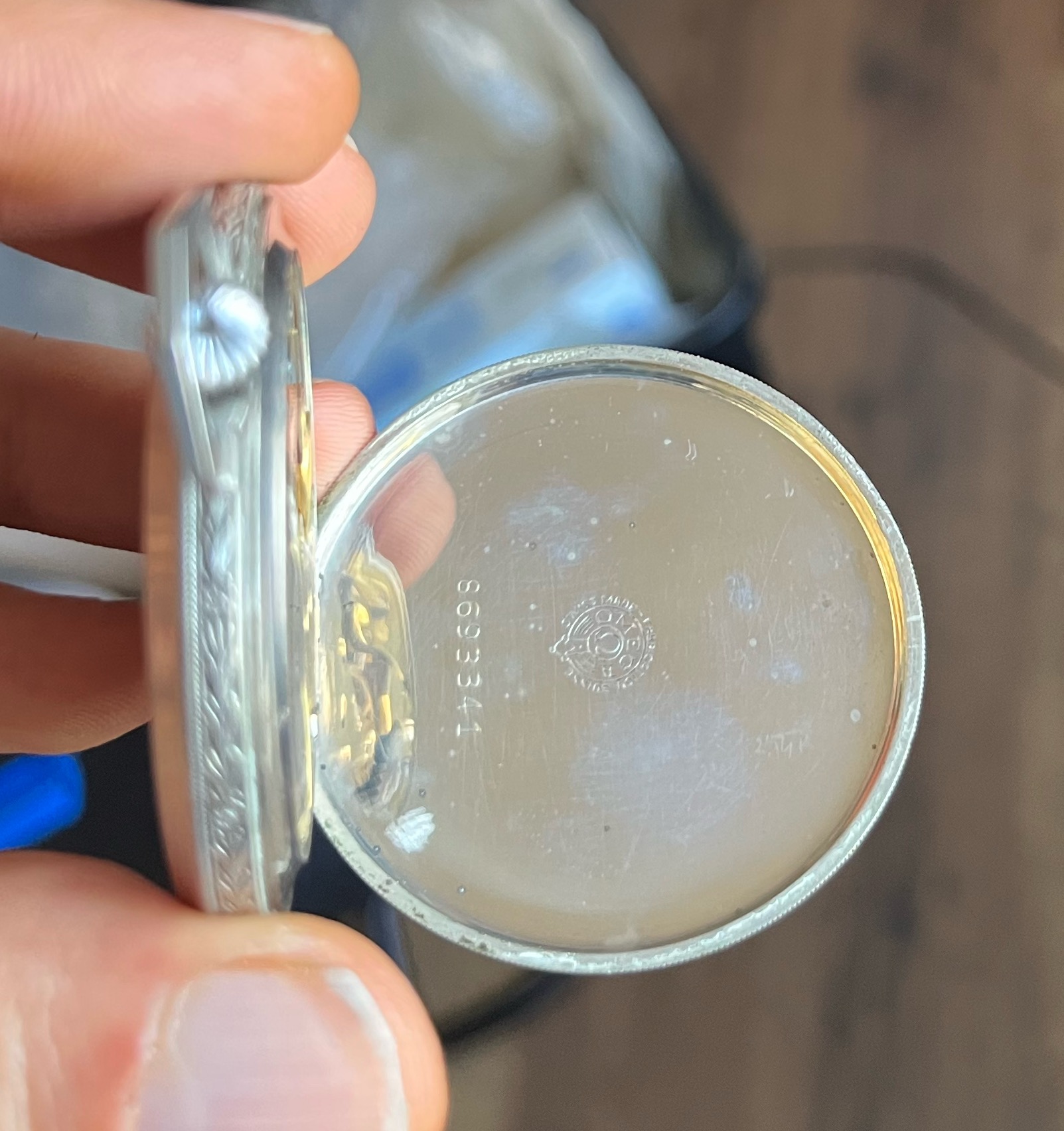

I can’t understand why the case is not marked what it is made of ?
White gold filled ?

I suspect it's an electroplated brass case, possibly nickel silver going by the sheen.
White gold would have some form of hallmark.

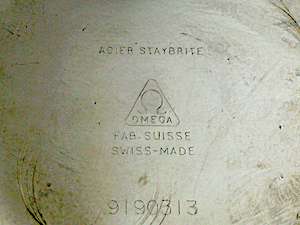

However, I would expect to see STAYBRITE markings on the caseback as manufacturers were quick to use the markings as a sales pitch.
For example:

I’ve collected for 40 years, almost all cases say what they are made of ?
Why would Omega do this ?

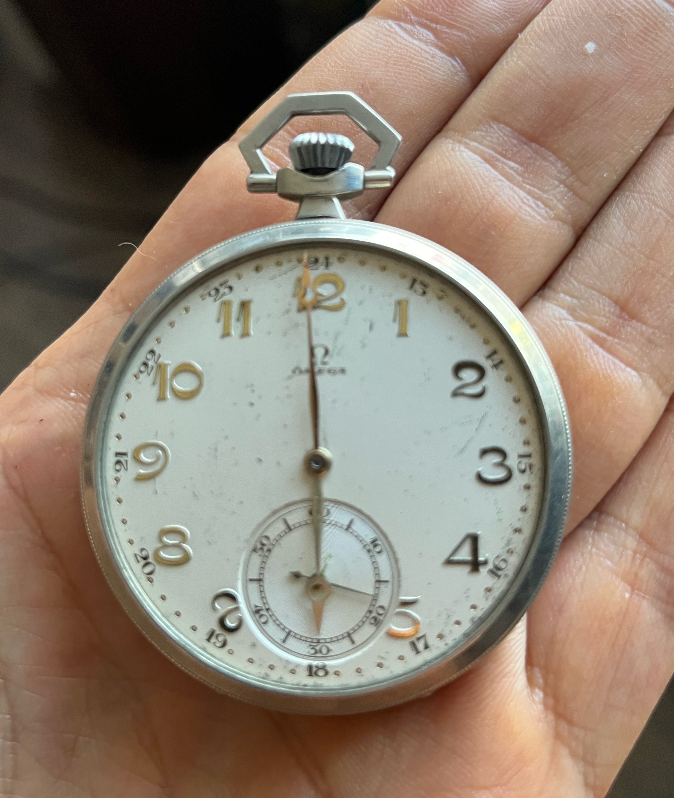

The watch is fairly solid and heavy Beautiful deco style and etching on the edges ! Very much like my Patek Philippe
with breguet Arabic applied numeral dial hour markers. This had to be a higher end watch at the time ?

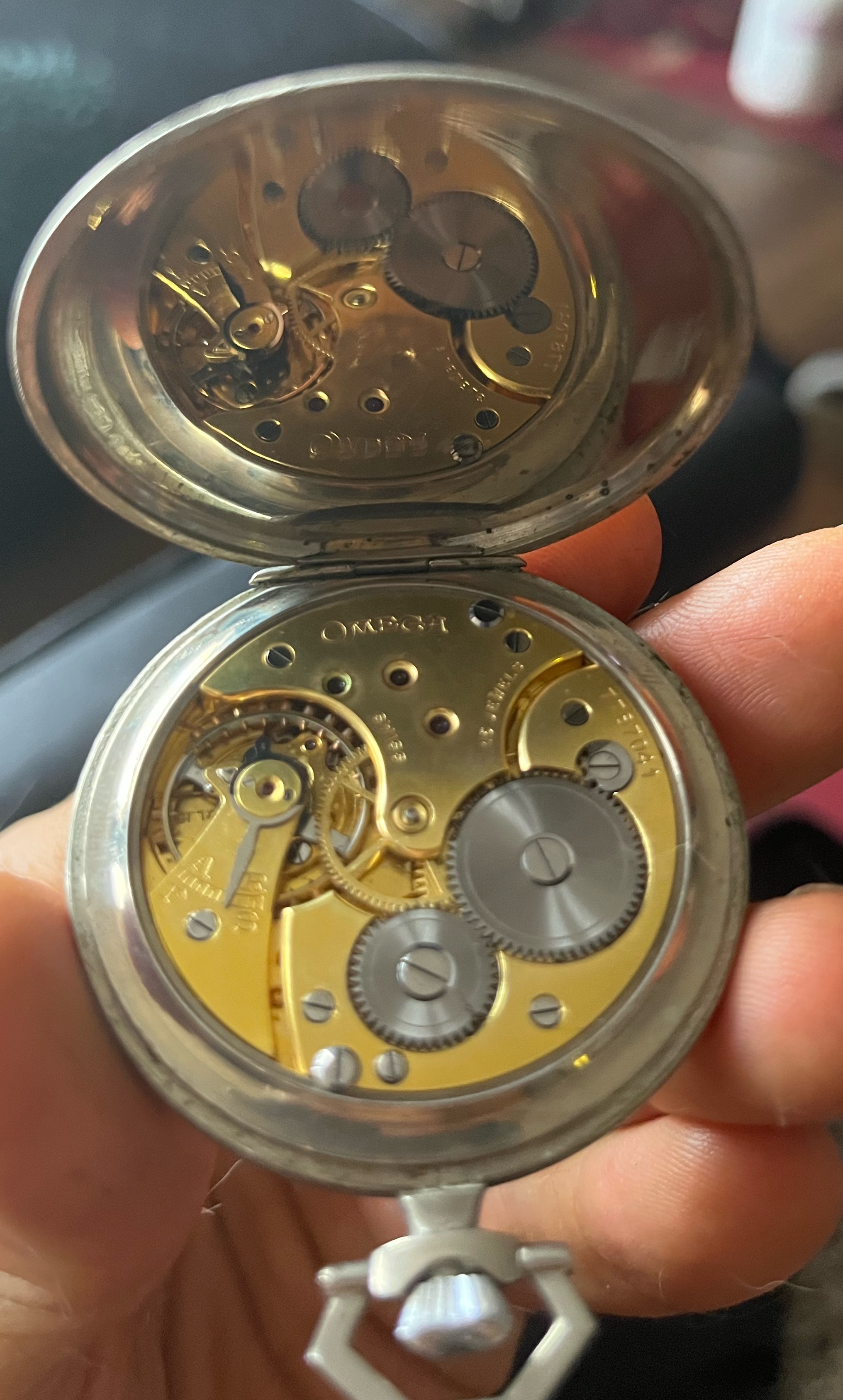

I checked the similar watch I have. It is not a ref 395 (the OP watch has an hinge, ref 395 doesn't). I don't know the exact ref for this model.
Here are pictures (dial is different than the OP's watch but we know Omega used a variety of different dials on the same references) It all the same color as the bow, the reflection of the brown support tainted the color :
Caliber 35.5L T1 inside :
