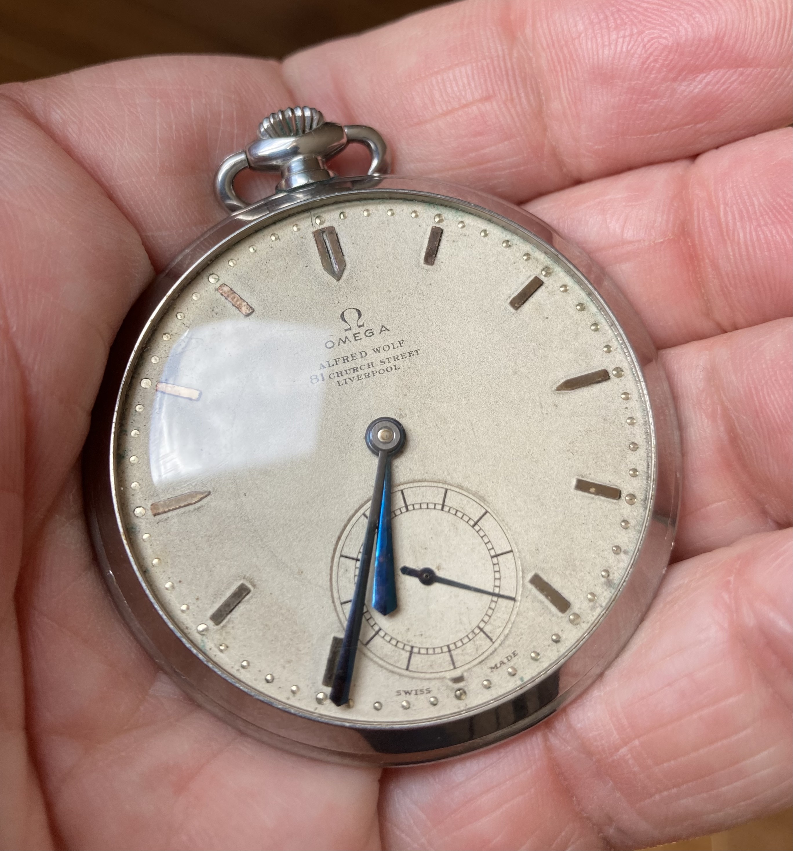

I was wondering if anyone could give me any information in relation to this Omega pocket watch I unearthed after the death of a relative -- in full working order, detail on face is Alfred Wolf, 81 Church Street Liverpool; hands are blue, no numerals, Roman or otherwise CfRvRppD7CD

Beautiful watch 😀
It will likely be a late twenties to early thirties model which can be decided by opening the caseback and looking at serial numbers. There are probably two present, one for the case and one for the movement.
Someone like @OMTOM or @Tire-comedon have extensive knowledge and often images of prewar catalogues that can sometimes help identify the reference number of the model.

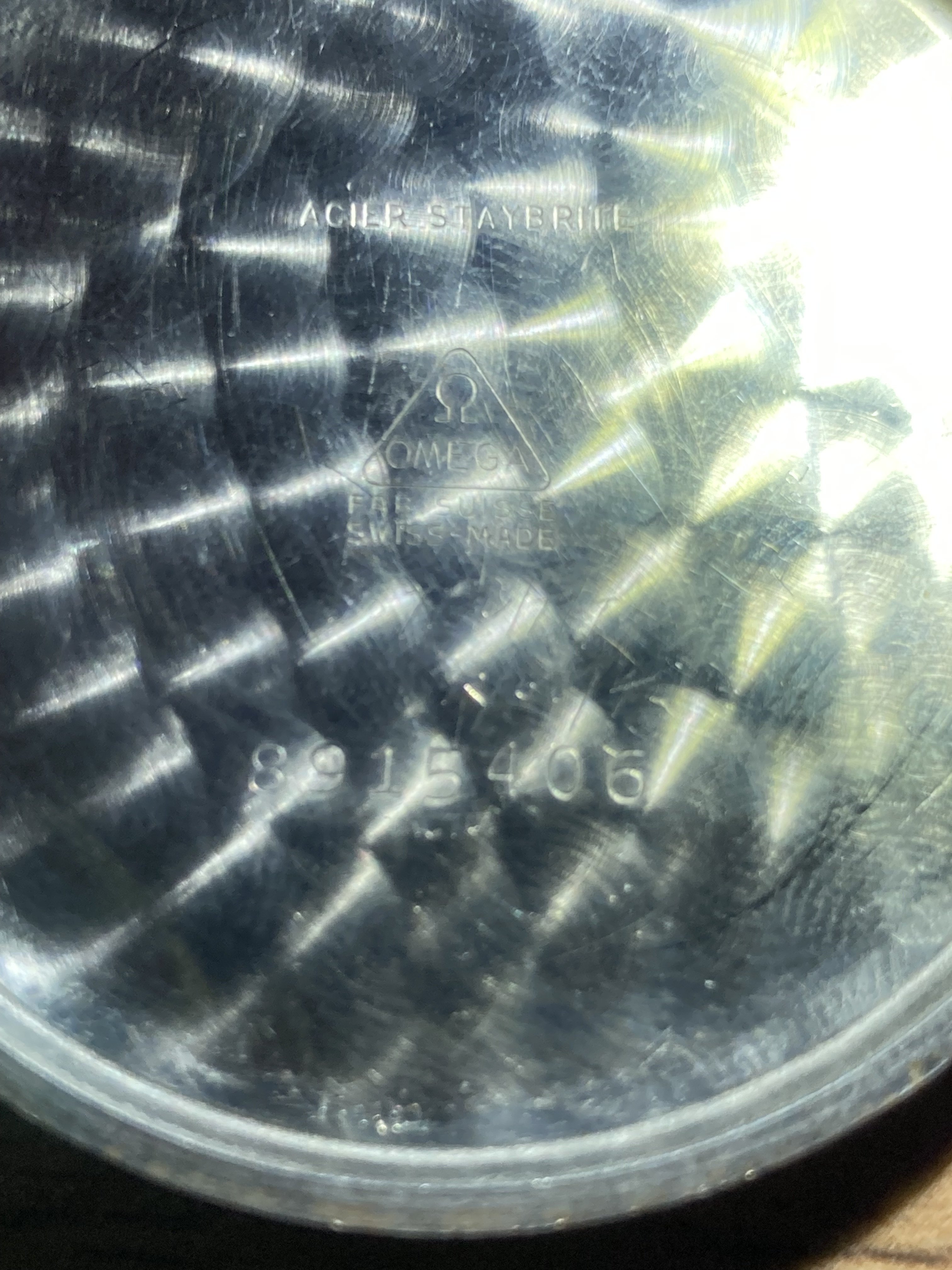

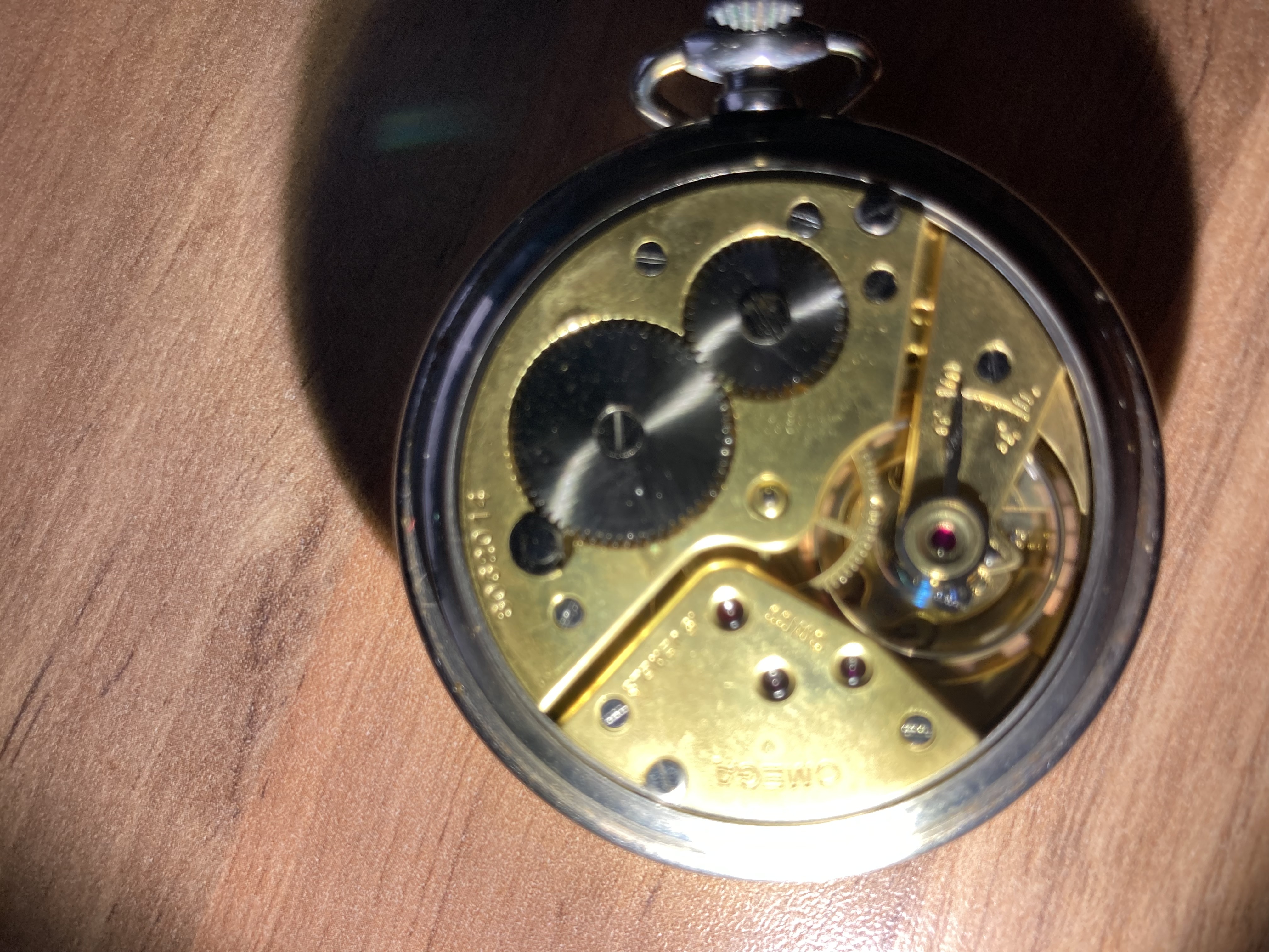

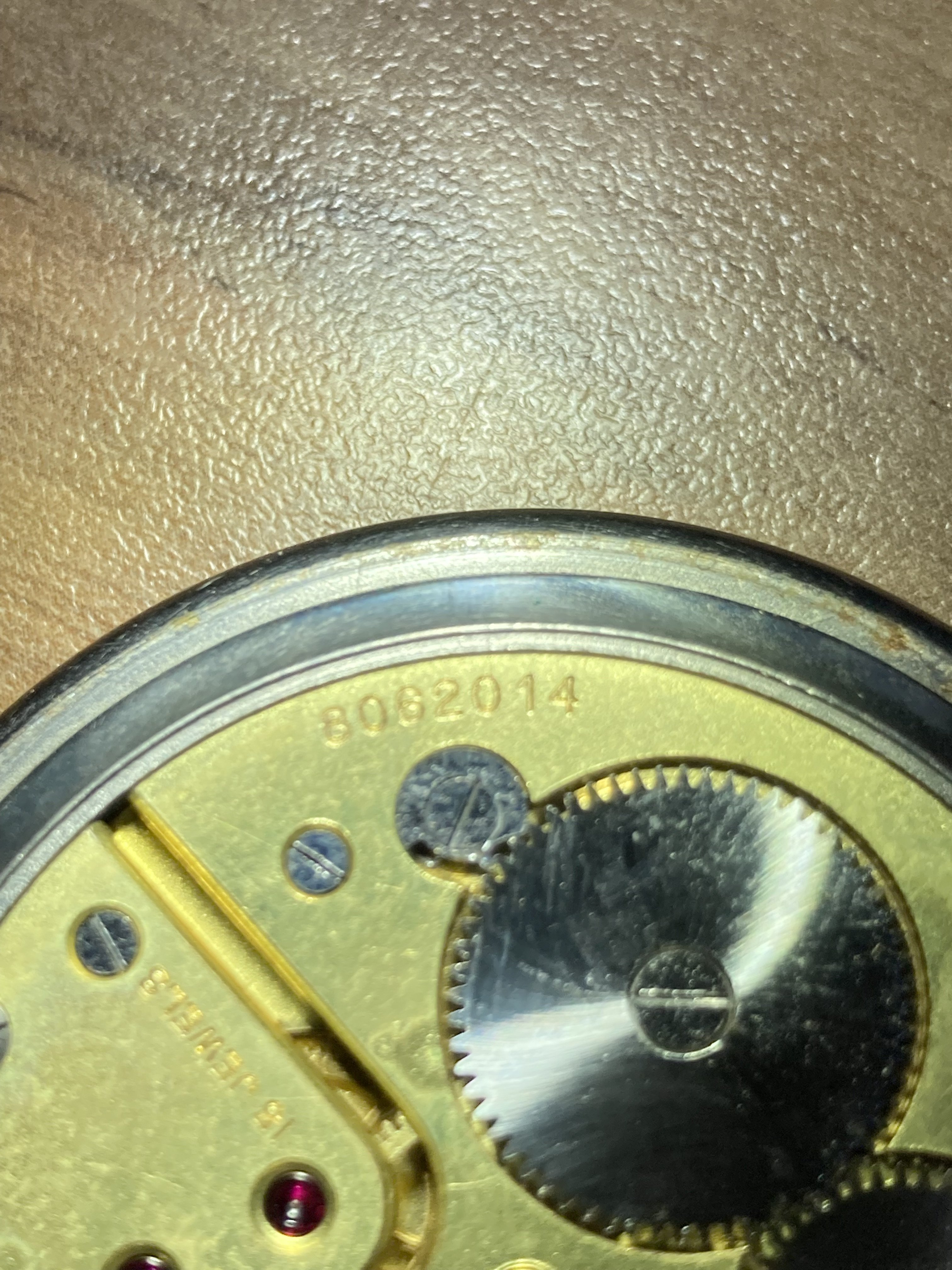

ok, on caseback, the number is 8915 406
and number on mechanism is 8062014

Just guessing here though as the photo is way out of focus.
I'd say it's a 17''' caliber 38.5L 15P which was introduced in 1932 and in production until 1966 in various formats.
17''' is the diameter of the movement in lignes (37.5mm).
L is for Lépine, or open face style.
15P is for 15 jewels (P is Pierres or "stones").
The serial numbers would date the watch to somewhere around 1935.
It has a "silvered" dial with blued steel "club" style hands.

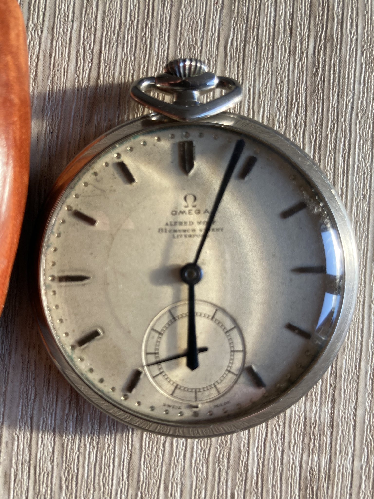

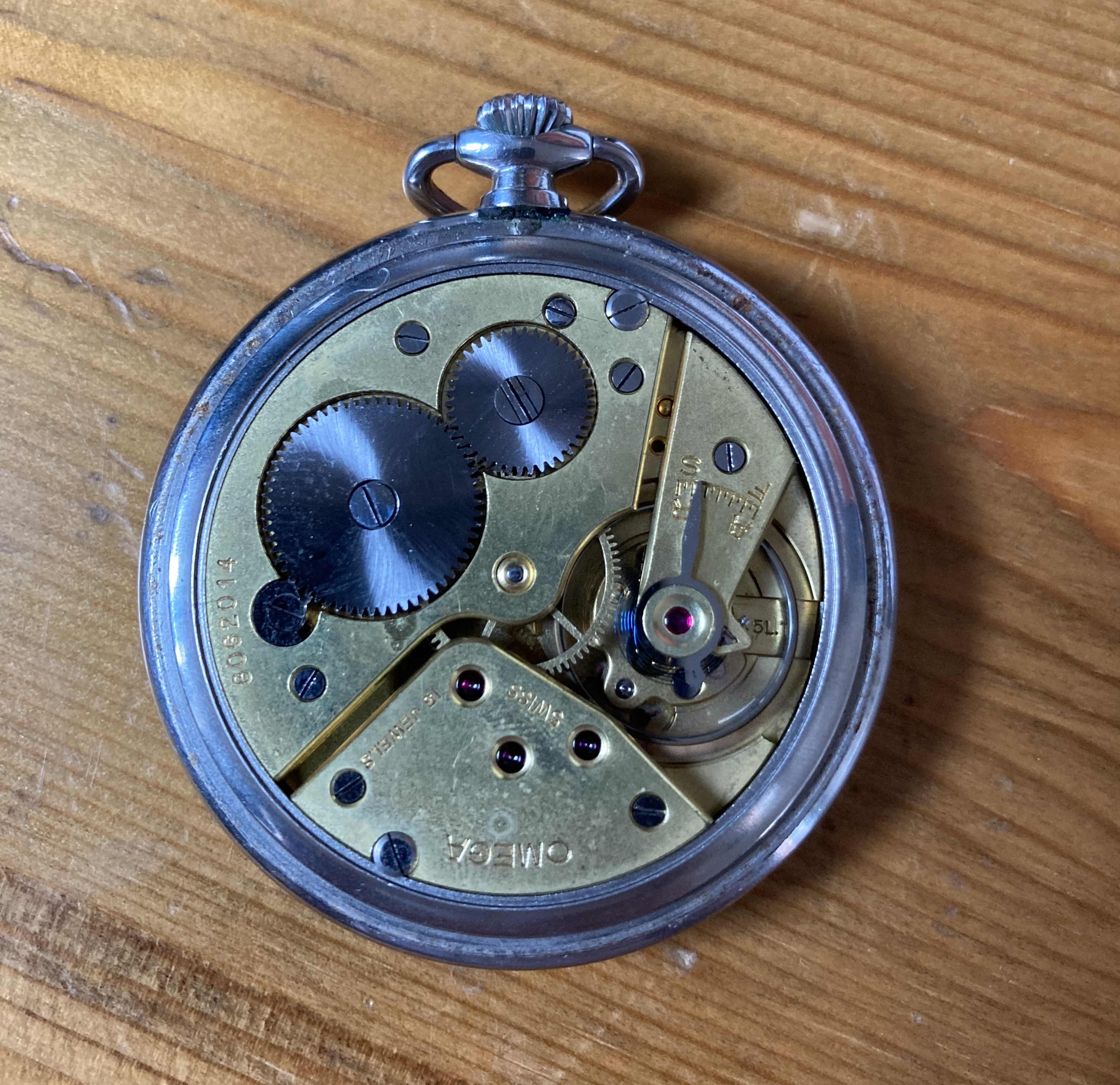

Thanks for that - 37.5mm looks about right. Slightly less blurry image here

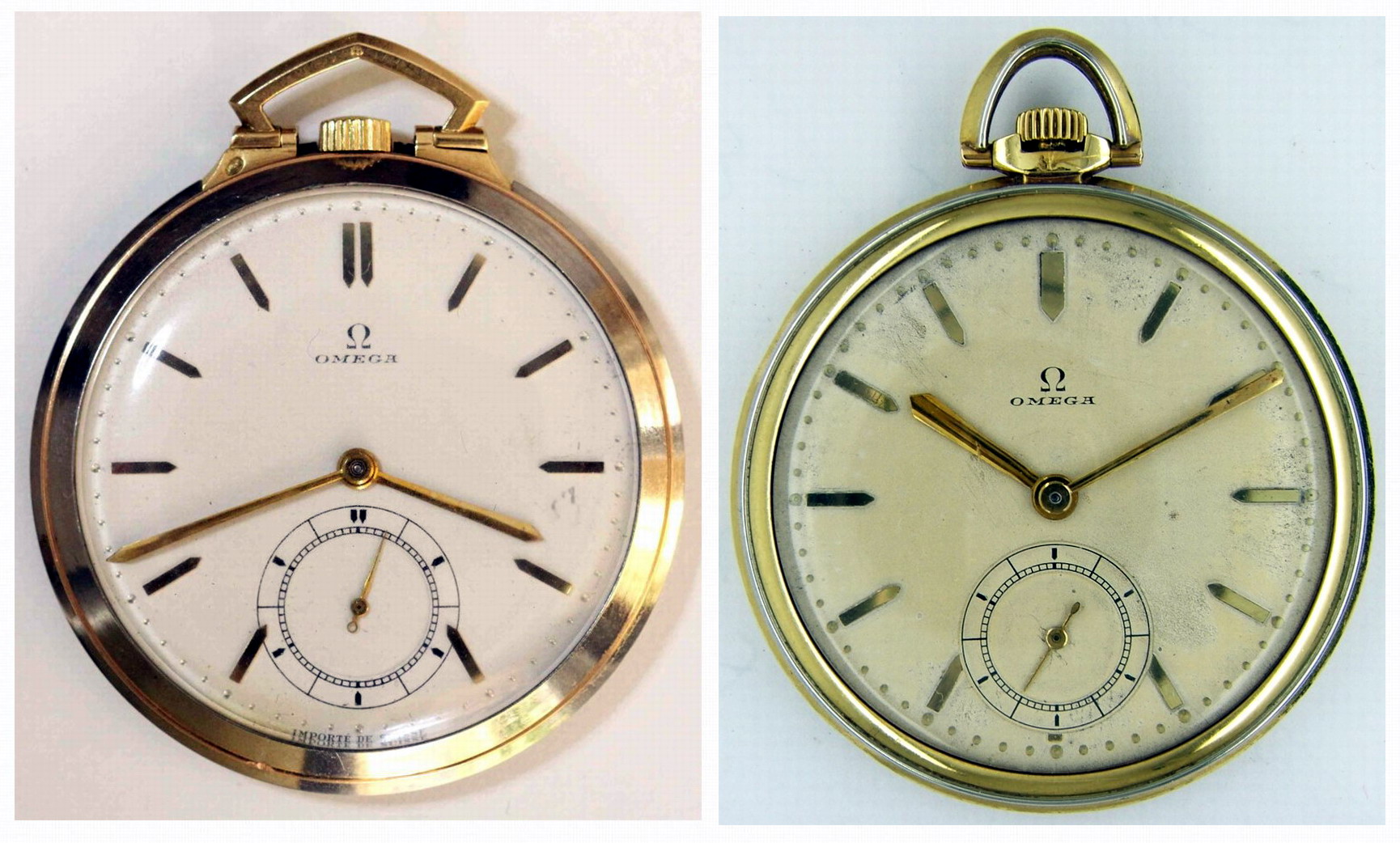

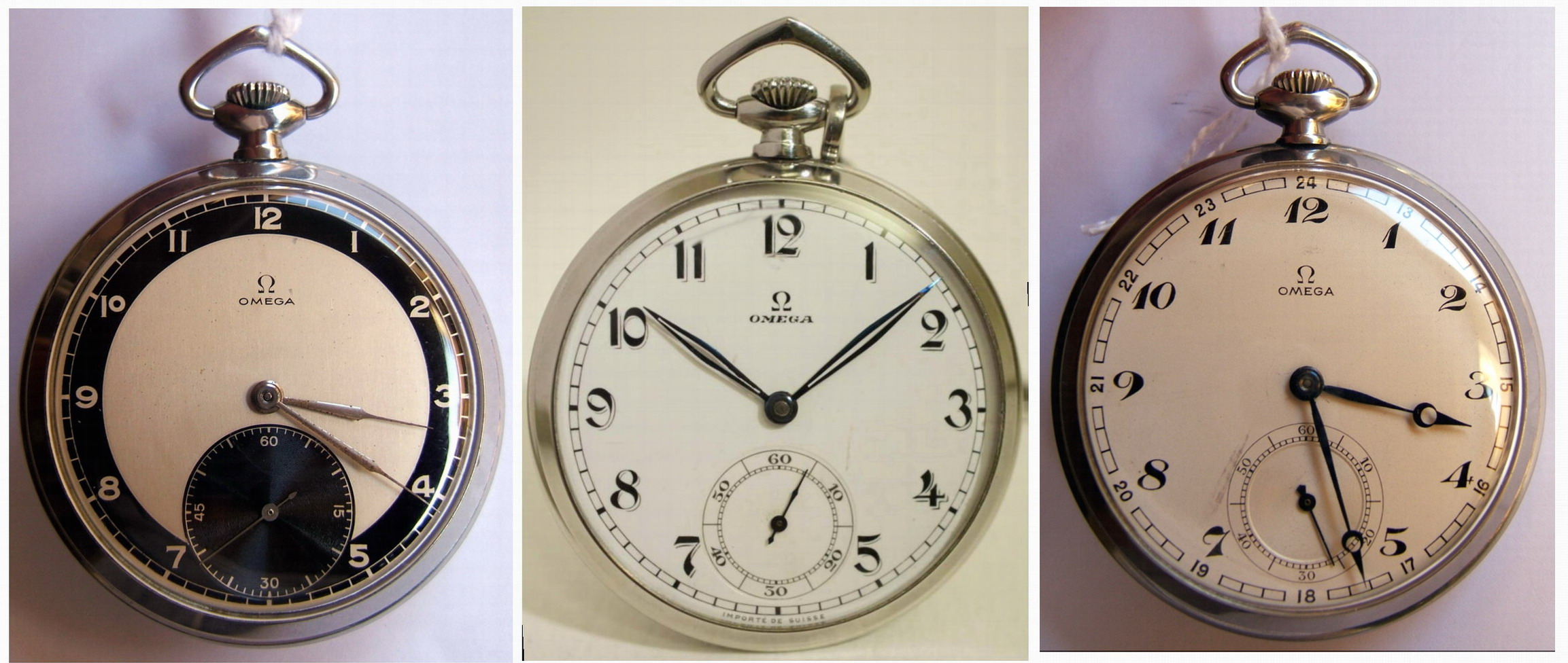

I agree with all that @JimInOz writes. I have a 38.5 watch with very similar numbers which dates 1935.
In this period, Omega used similar dials and hands on various different calibres (such as 35.5, 37.5, 37.6, 38M, 39.1 and even wrist watches).
Here are a couple of mine with similar dials/hands (not the same), both calibre 38M L:

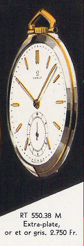

The following (38M L) is taken from a 1934 catalogue:

In summary, the style of dial and hands was used over several years in a variety of calibres. I don’t know the reference of the PM’s watch - @Tire-comedon may be able to help with a catalogue.

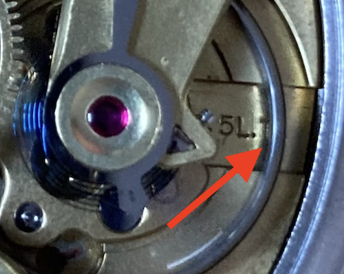

I think Tom has expanded my brief assessment with some great info. About the only detail still to be found is the exact model.
If you look under the balance you can see the caliber stamp ending in "T?". The "?" number will tell you what iteration of the movement you have.

the number after T, as best as I can tell, is 1

Looks like a CK 374... The bow is typical for the 1934-1940 era.
Here the same case / hands and a very similar (but not exactly identical) dial in a 1936 Italian catalog :
and here in a French catalog with the specific hands and dials for the model celebrating the 40th birthday of the Omega brand :
