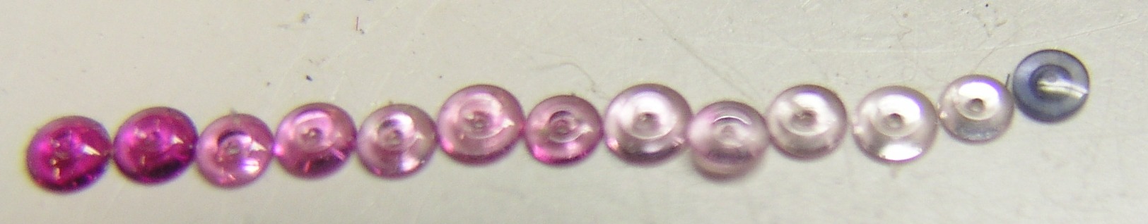

That watch is likely old enough that genuine ruby jewels were used. You may have to settle for synthetic ruby. Jewels like these. These are all genuine ruby, from red to pale, and one genuine sapphire jewel. Synthetic jewels came into use circa the 1930s. Up until then, American watches also used genuine stones.
