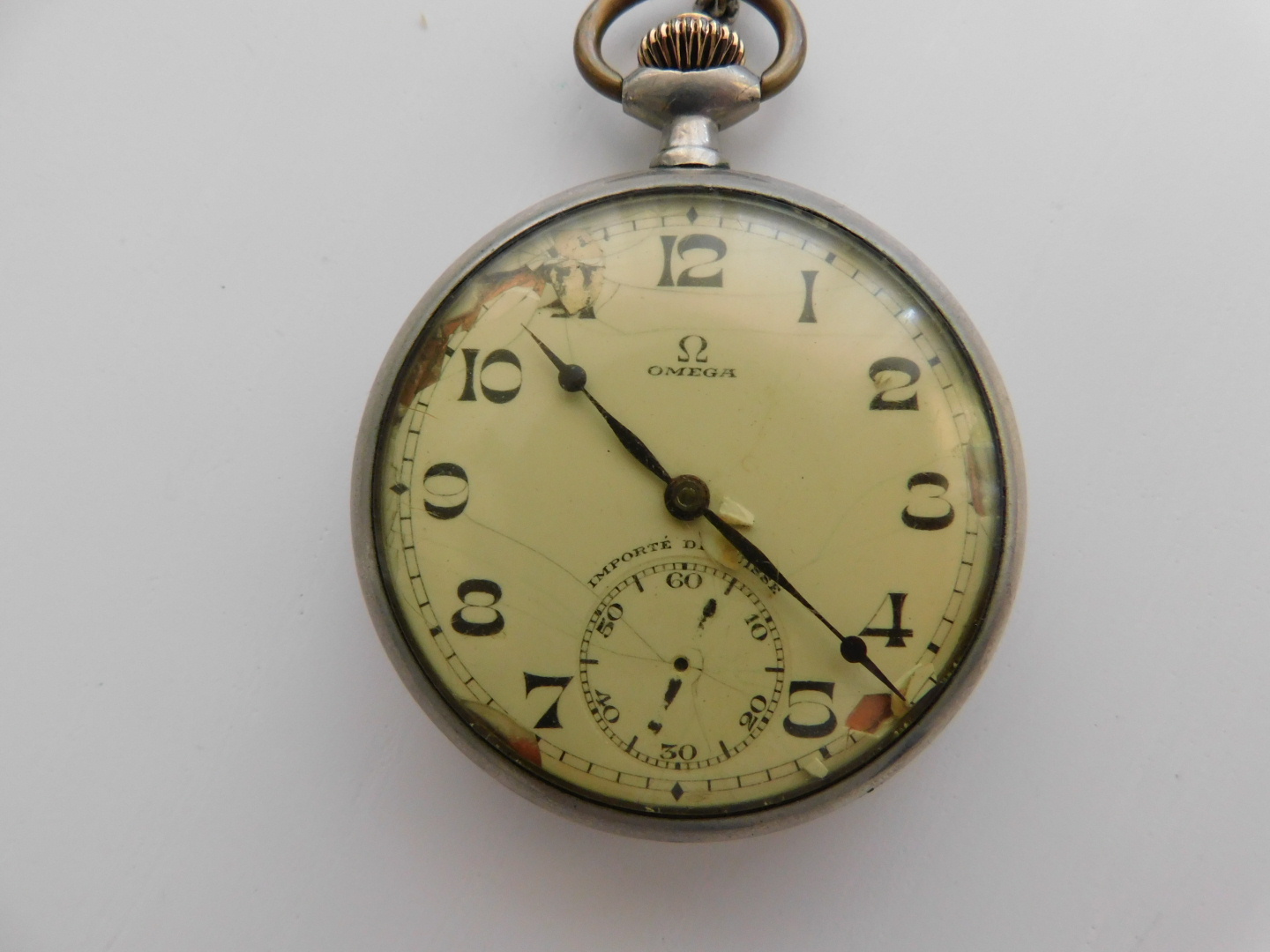

Omega pocket identification

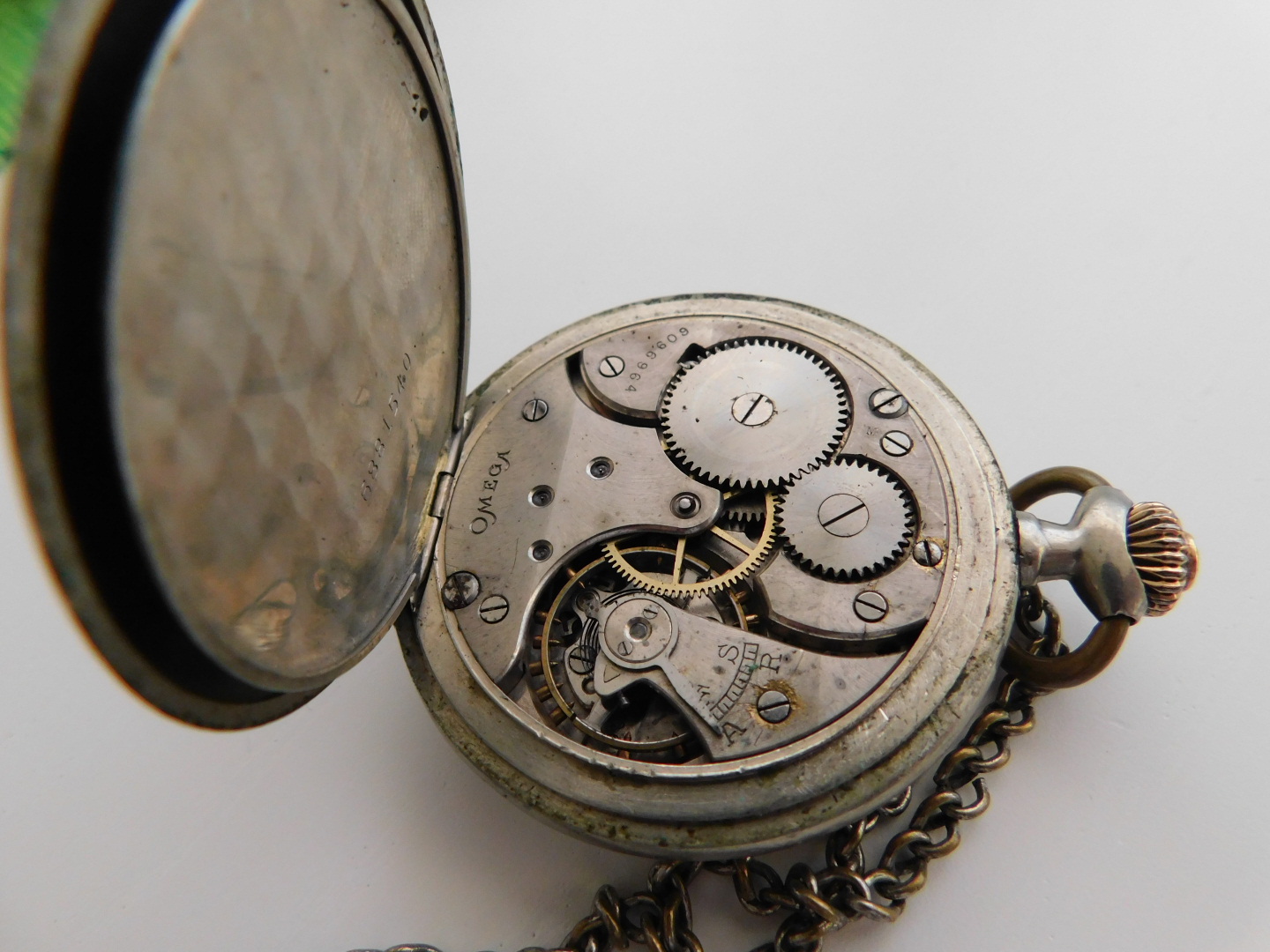

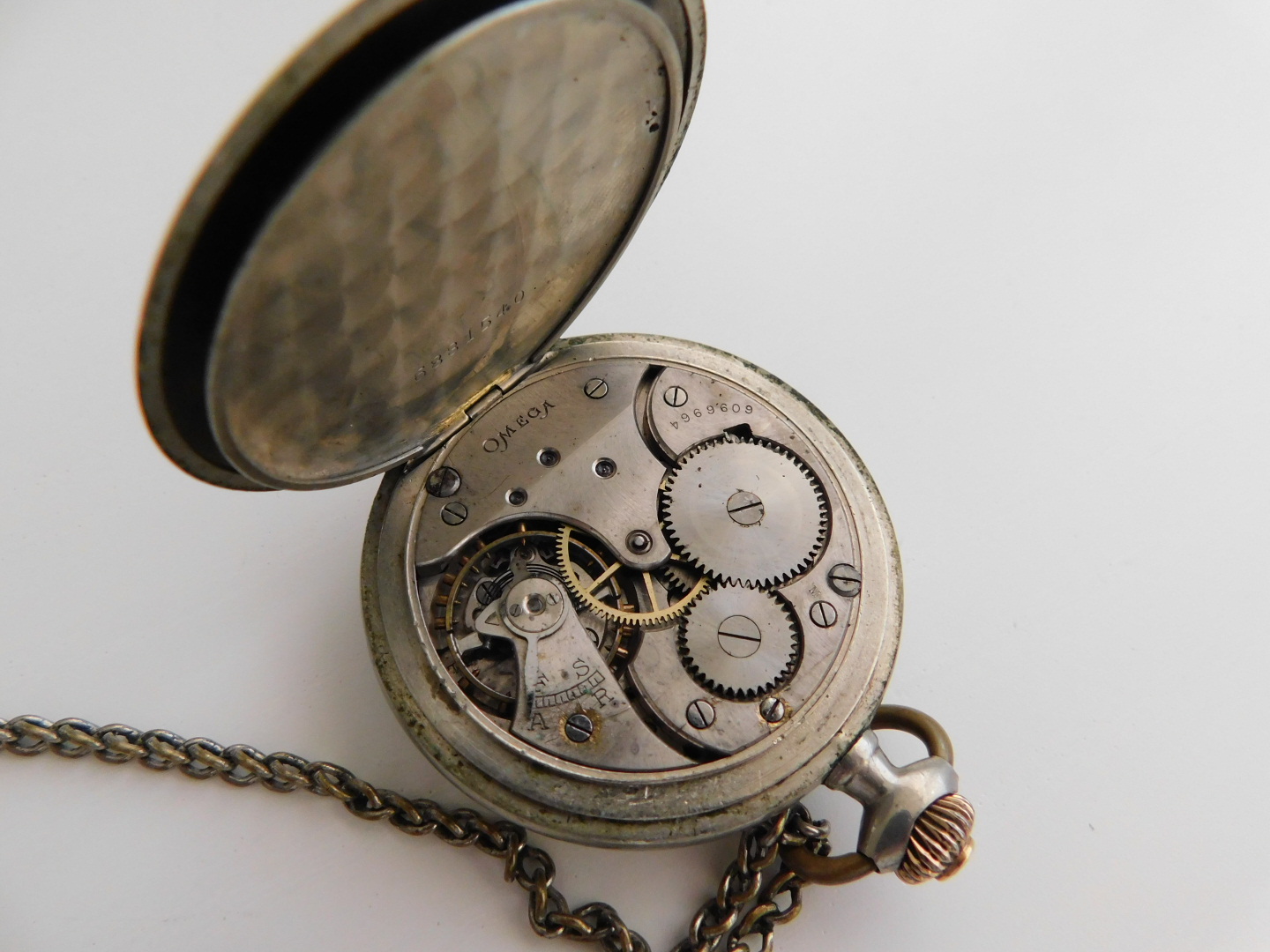

I would say that the calibre of your watch is an Omega 40.6L. It dates about 1925. It looks genuine/original! I’m afraid these are not particularly rare nor sought-after. It may have some sentimental value to you - but it has no commercial value.
I’m afraid I don’t agree with @fizz: some pocket watches are indeed valuable - but not this one.

Trashed Omega pocket watches tend to not be worth any purchase price unless there is sentimental value. We see them posted here pretty regularly where someone bought a trashed one thinking it could be easily flipped - most often they can’t. Decent Omega pocket watches have value for sure, maybe more in Europe? A tired Omega pocket watch found at a yard sale isn’t a slam dunk like an old Omega wrist watch usually is.

Base metal case, badly yellowed crystal, rusted hands, demolished dial, garden variety 15-jewel movement very tired looking and badly chewed up by clumsy mishandling. Quite an asset. Set your “must have” price quite high, then wait for the right buyer. 🍿

The numbers on the OP dial are unusual.
In the early decades of the last century, when the pocket watch was in its heyday, the products of Omega (and other manufacturers) followed the contemporary styles - such as art deco etc… Omega produced literally hundreds of different styles of dial - and these were of course given numbers and names.
Examples of those names were Arabe, Empire, Romain, Grec (and many others). Then there were derivatives, such as ‘Romain court à filets’ and ‘Arabe fort à plots’.
From time-to-time, these styles were updated, new styles were introduced. In 1924, a style was introduced with the name (simply) ‘Type 40,6’ - and that is the style used on the OP’s dial. And since the calibre is 40.6, perhaps not surprising.
