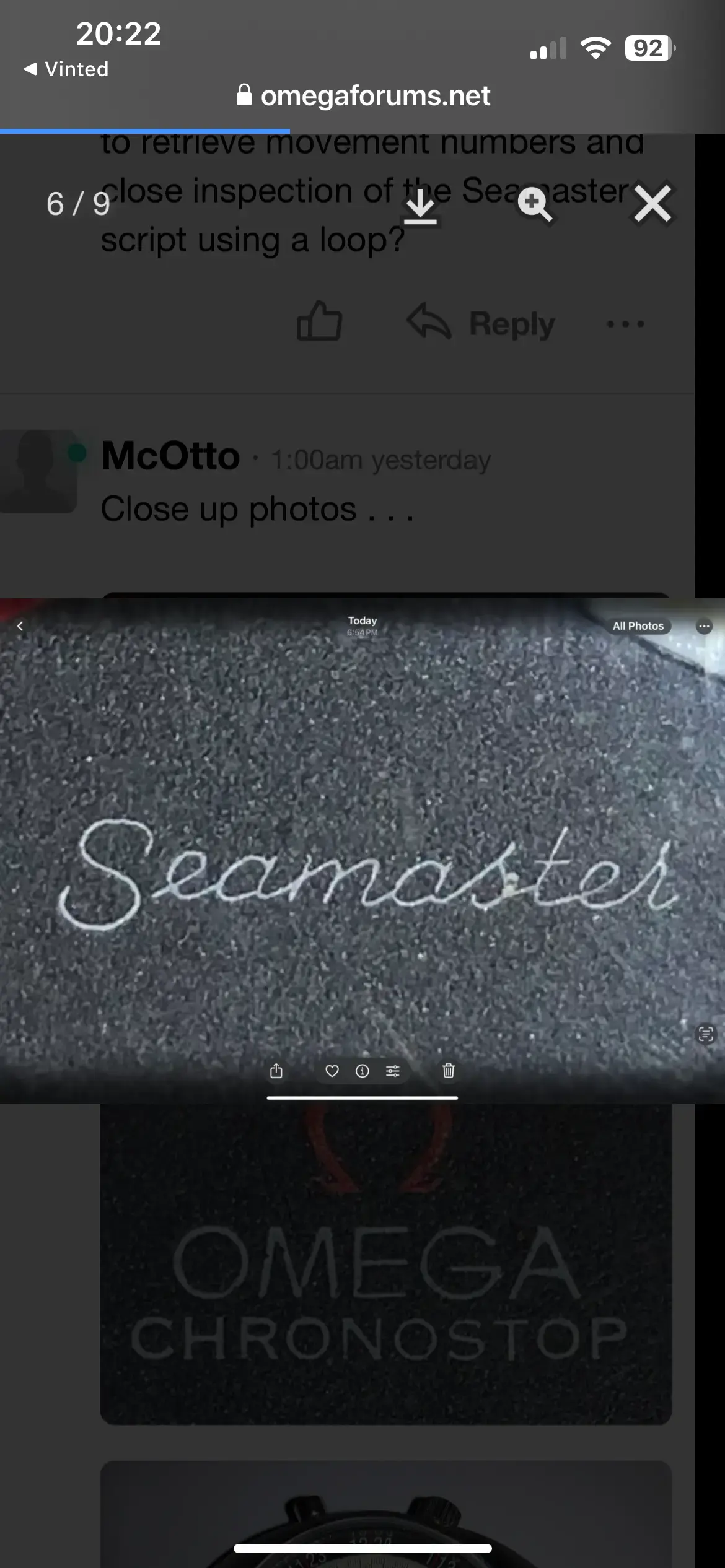

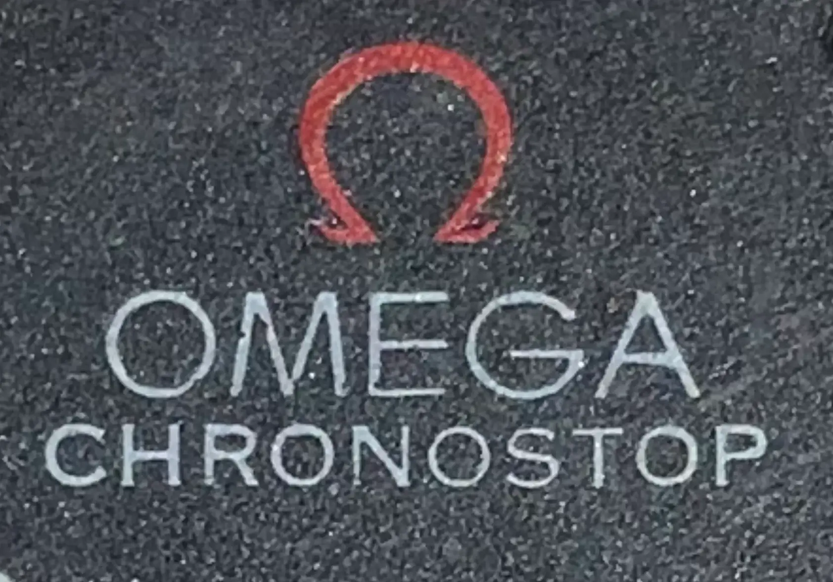

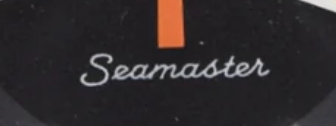

I strongly believe the dial is refinished. Also, the second hand is certainly not correct and painted red.

@masteroftime, I am not at all disputing your position (and that of others). And sincerely appreciate your time and input. However, I am hoping you might be willing to invest a little more time towards a layman’s education.
What are you seeing that has you confident the dial is refinished?

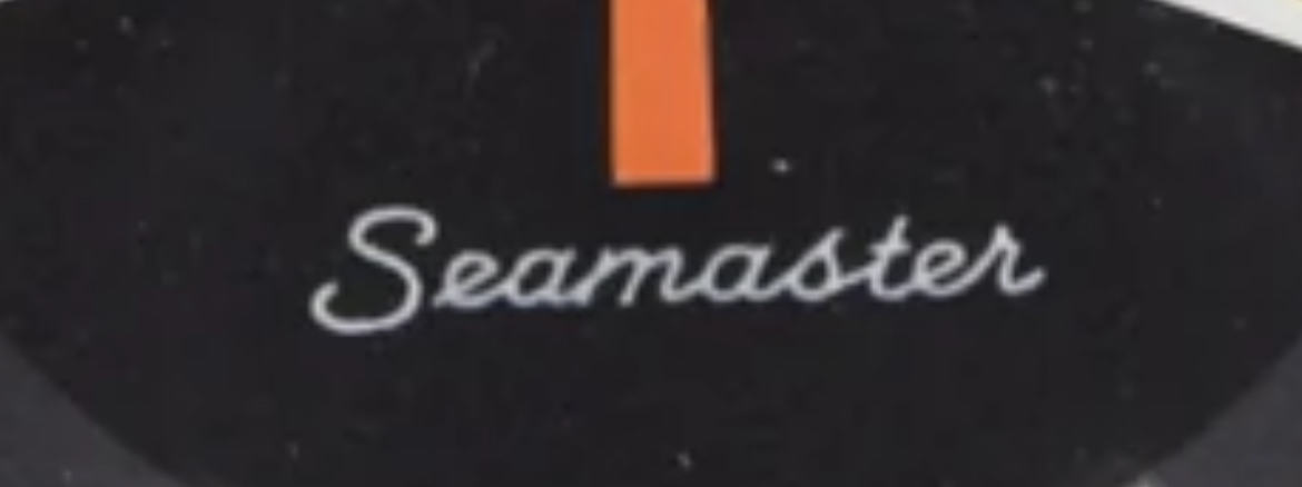

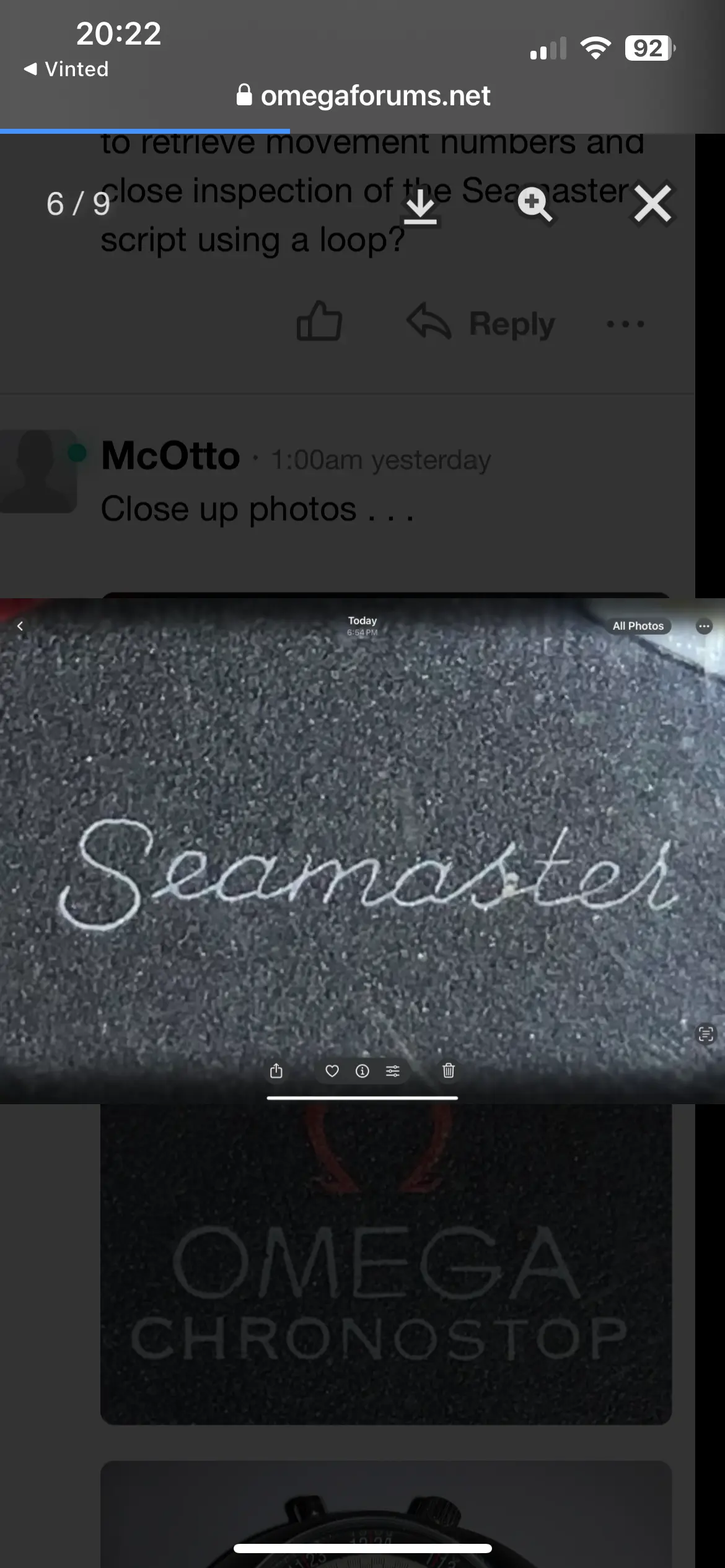

I am in @masteroftime s boat, the Seamaster part of the dial looks different to most of the dials you find on the net. Especially the „r“. Also the capital letter „S“.
kind regards Max
I noticed this as well, but thought it might be an artifact of the photography

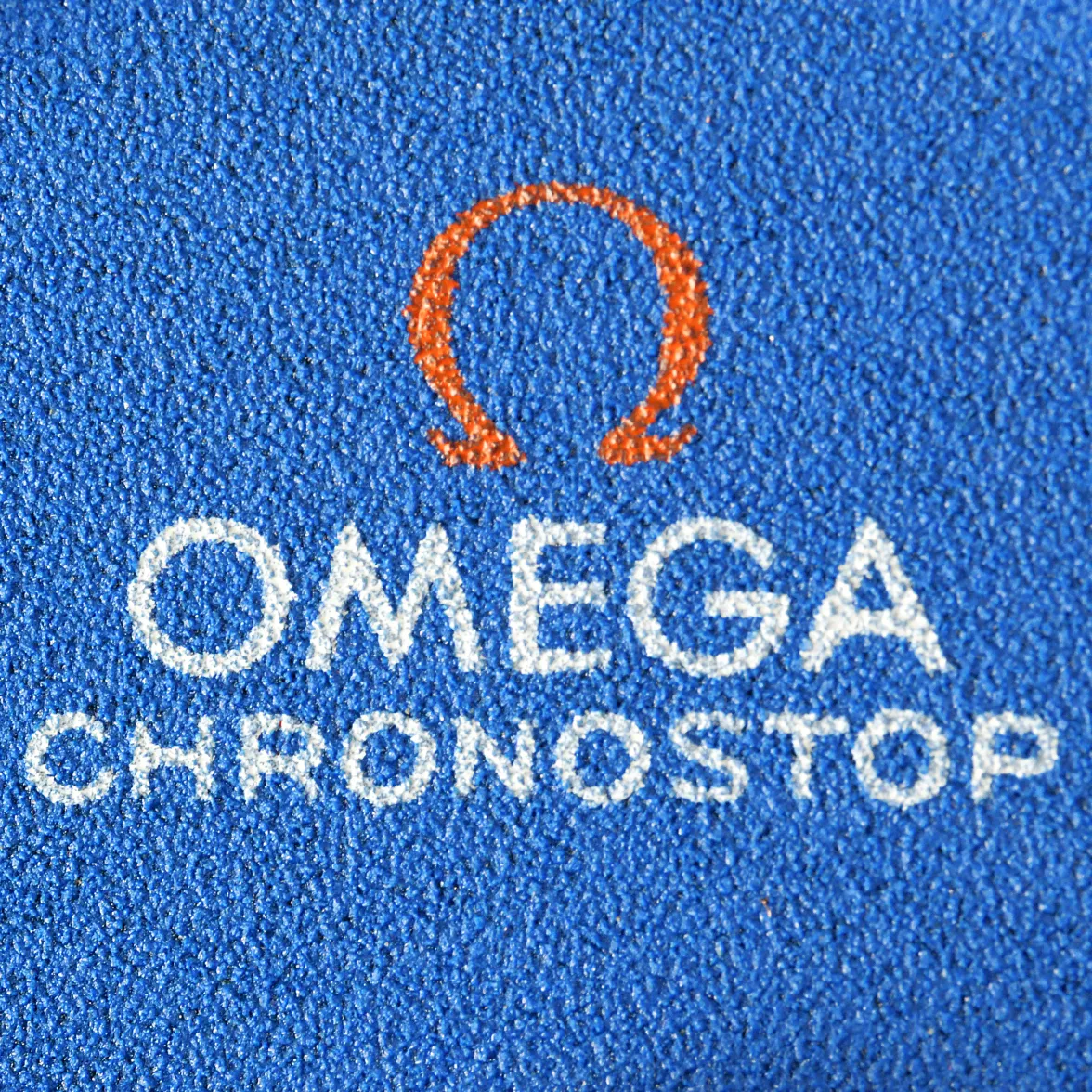

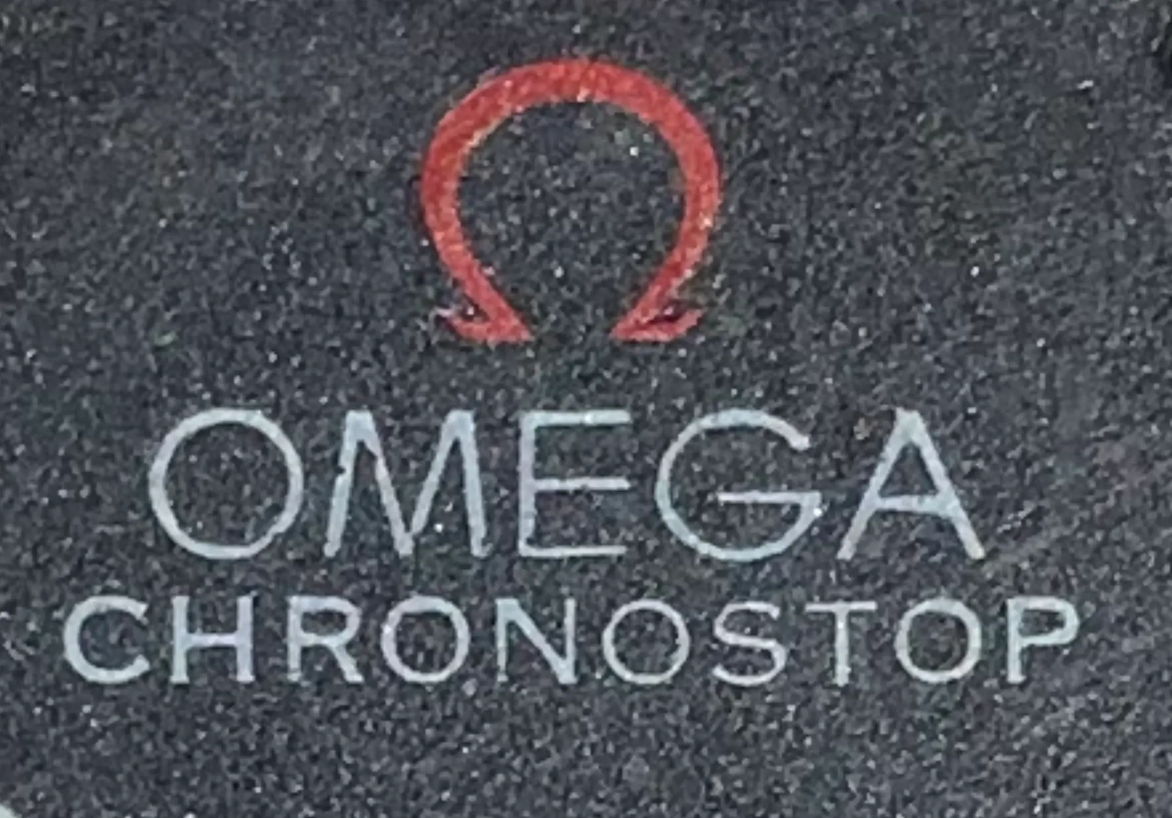

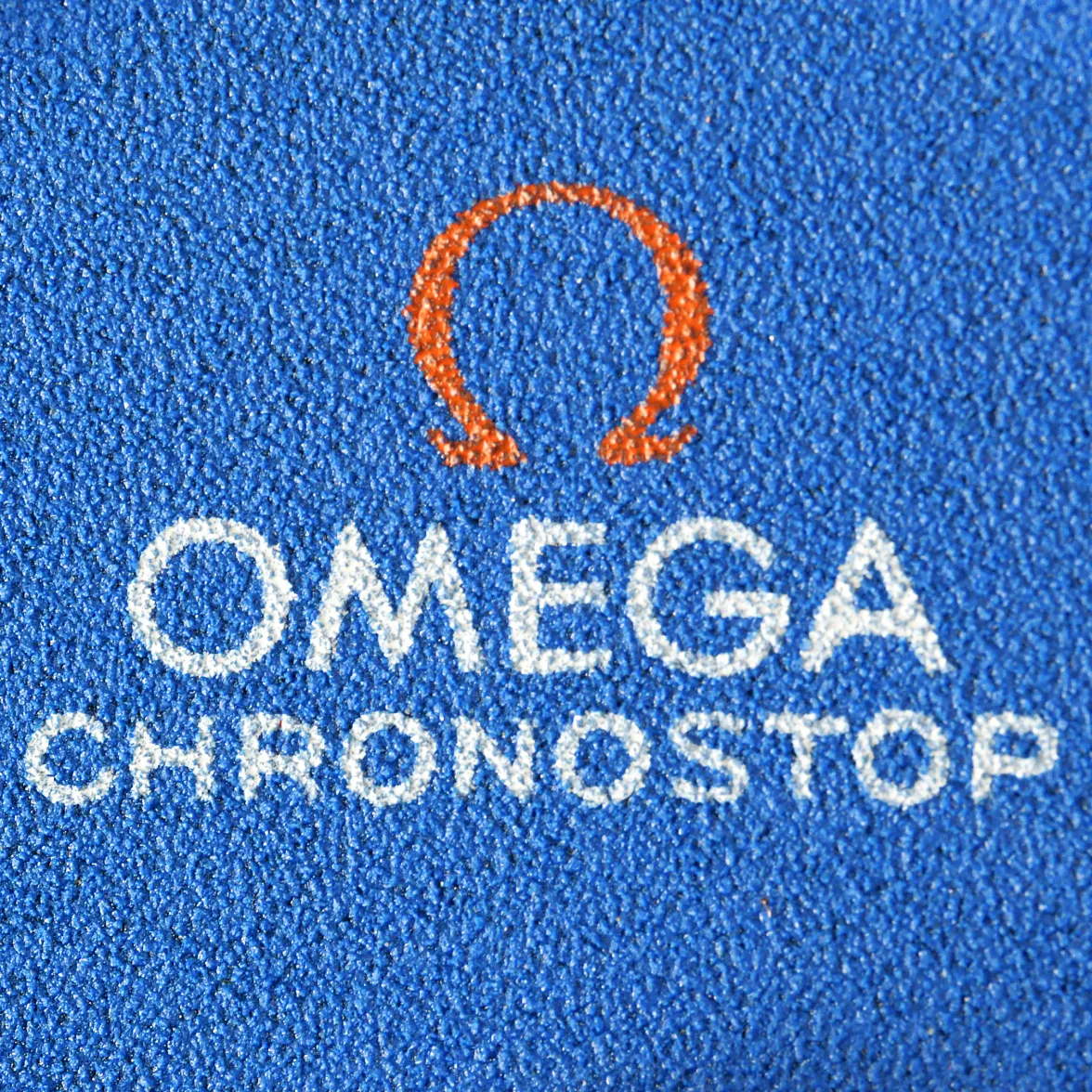

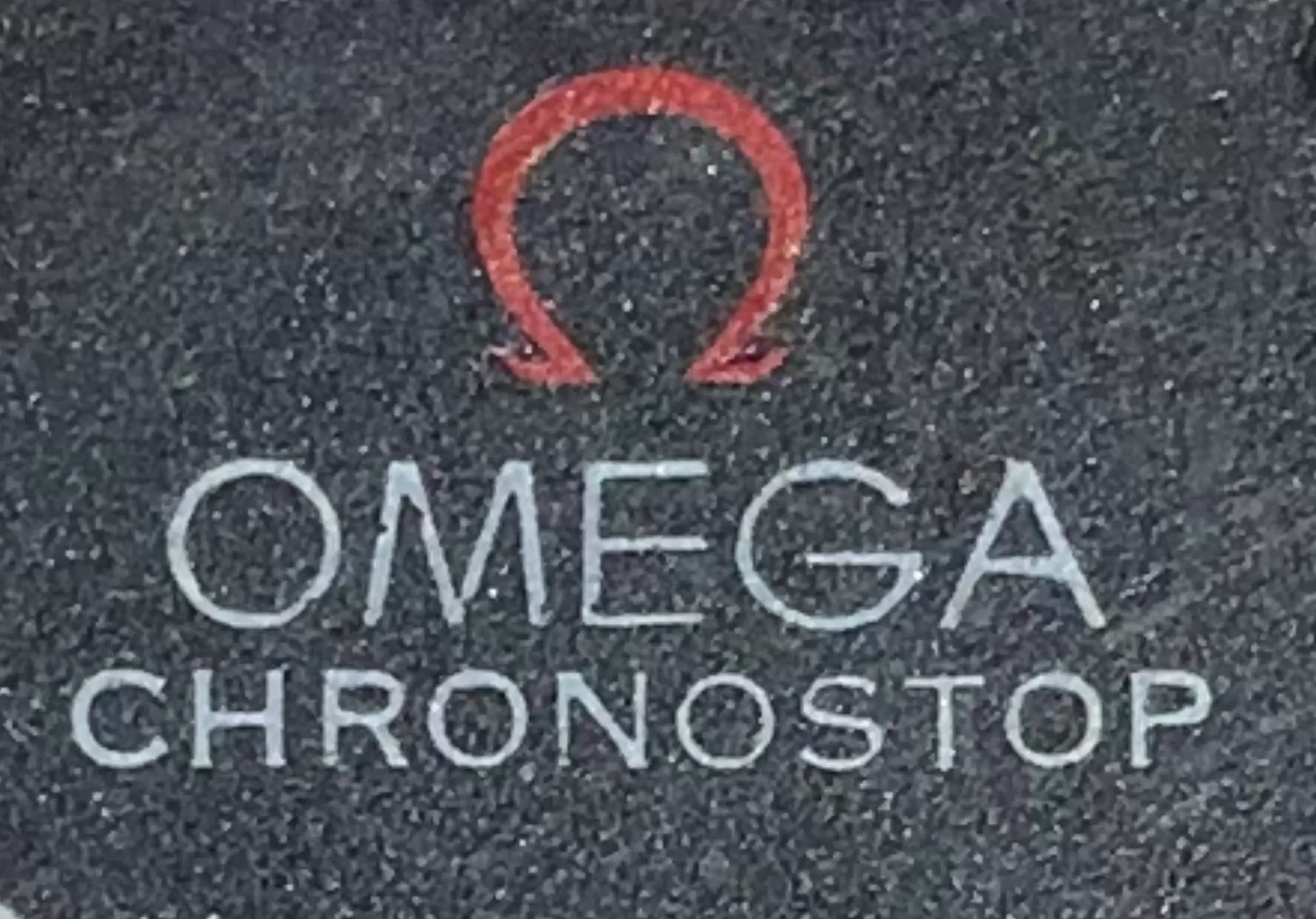

  • The print and script on the subject watch dial is unique and clearly different than dozens of Seamaster Chronostop high resolution photography examples readily available on the internet, as well as in the aforementioned published articles.

  • The evidence strongly points to the conclusion that the subject watch is a Seamaster case, transplanted 146.010 Geneve Calibre 920 movement, and older refinished, patinated Geneve Chronostop dial with forged Seamaster script.

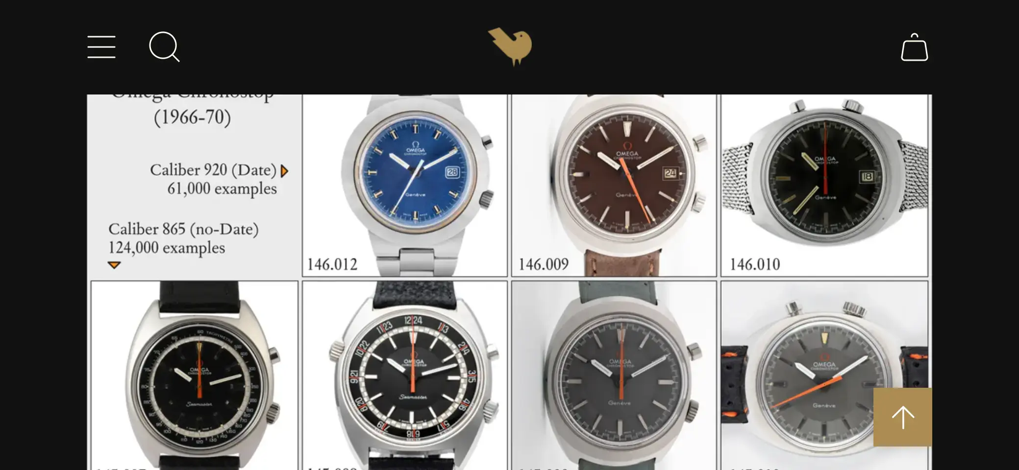

261
767

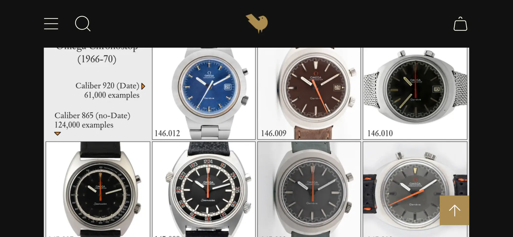

I’ve recently picked up a 145.009 and did a lot of research. I physically picked up my watch from a vintage watch dealer and one of the topics we discussed was how there’s a growing number of watches that are the 09 variant but have had the dials rotated to look like the .10 variant as these command more money even though the dial feet don’t fit the case correctly. It looks like your watch could be a similar example although I’ve never seen this tried with a 145.008
Here’s a good visual ref
Edit: just realised from your pictures that you have a date window so not sure where that dial was sourced from

Thanks @Bernardino. Great suggestions. Being new to the forum, I need to figure out how to make the changes you recommend. However, your visual put me on another great reference. With my previous list, I should have included “Omega Chronostop Reference Guide - The Monopusher Chronograph” by Marcus Siems: https://goldammer.me/blogs/articles/omega-chronostop-reference-guide
