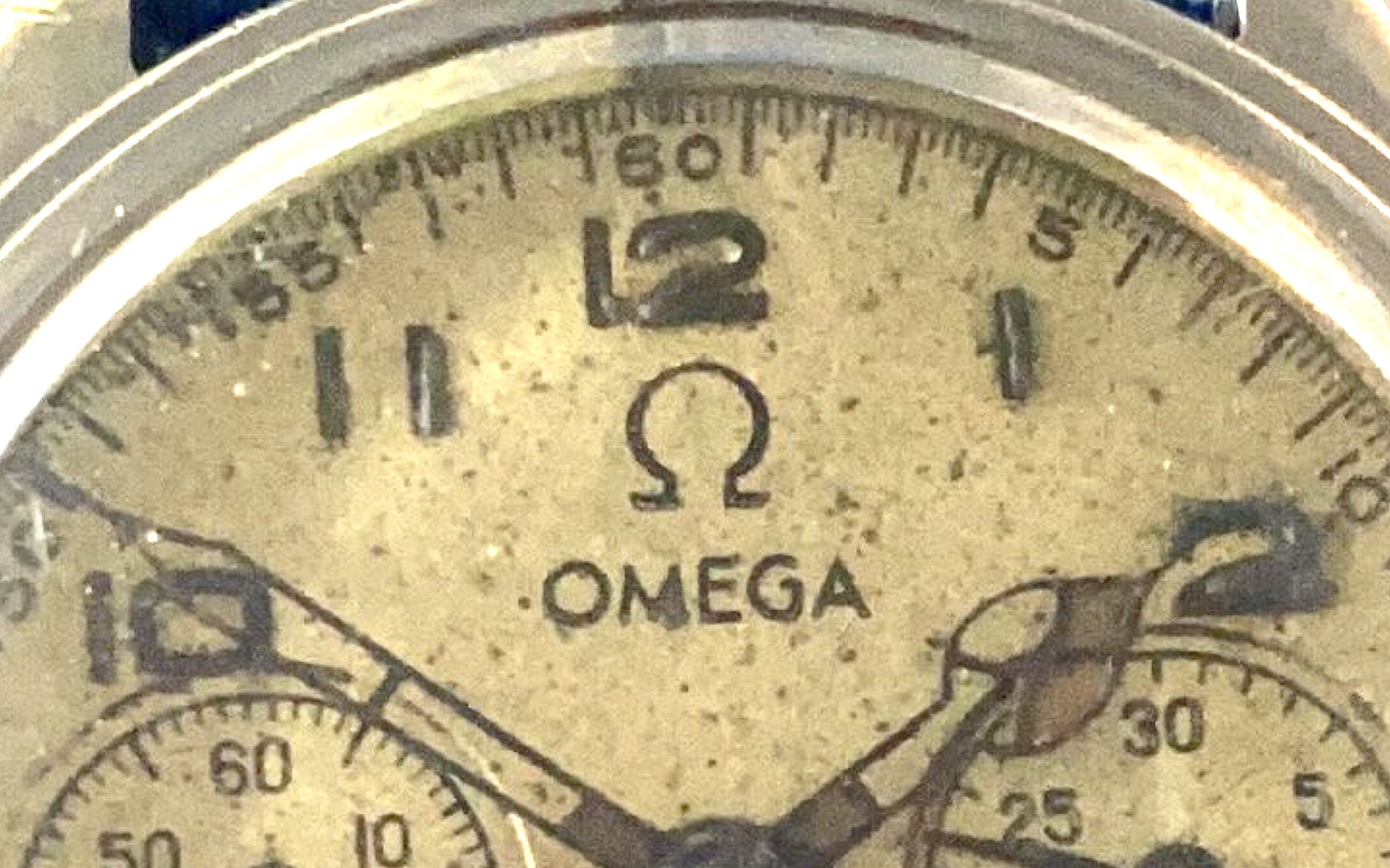

Приветствую всех. Хочу спросить вашего совета. Думаю купить винтажные часы. На циферблате надпись omega, механизм не подписан omega. На нем надпись lemania. На задней крышке тоже нет подписи omega. Фотографии именно такие. К сожалению, фото механизма нет.

It's a Lemania one pusher chrono. Maybe Base caliber 15 TL or if small, another Lemania caliber. Dial very ugly with a Fantasy Omega repaint. If cheap and working correctly, it might be worth finding an Lemania Dial and make it correct. If the chrono section is not working, levers are very hard to find....

Maybe someone has catalogs . I think the dial has not been repainted . Since the figures are filled with a luminous composition in factory conditions . I think that previously there was no technical opportunity to do so qualitatively from watch jewelers

100% repainted Dial.

You've been advised by someone with as much experience as anyone on the planet about what the watch is. Feel free to keep asking questions, but you've already been given the correct answer (also: why ask for advice if you don't accept it when it's offered by an expert? I don't mean to be rude, just honestly curious).

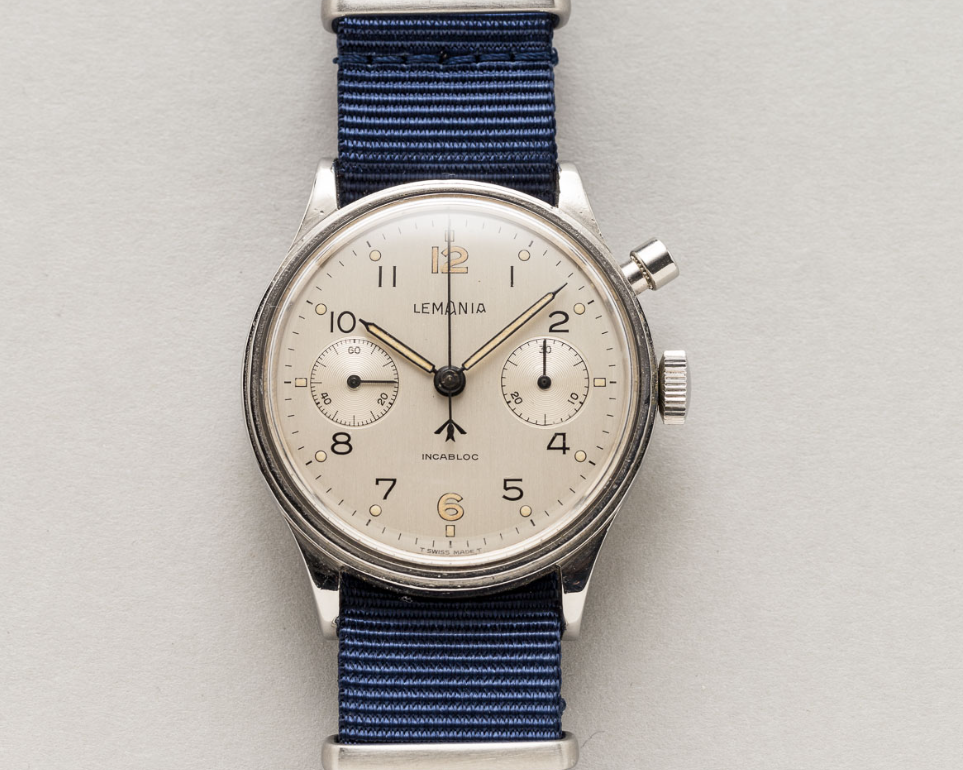

If the dial would look anything closer to this, then there might be questions. But, in this case, it's really very bad redial 100%.

Greetings to all. I want to ask your advice. I'm thinking about buying a vintage watch. The dial has the inscription omega, the mechanism is not signed omega. It has the inscription lemania. caseback also does not have an omega signature . The photos are just like that. unfortunately, there is no photo of the movement.
What’s the diameter of the case?
The dial has been repainted at some point. Could be quite some time since.
This is a +75year old watch. Depending on case size we might be able to say if it’s a cal 13 or 15.
Based on the case design I would guess 15. The case should then be 37-39mm without the crown.
