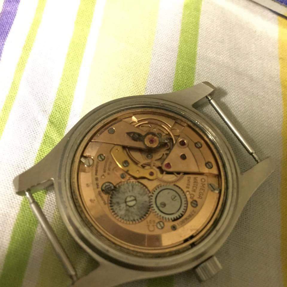

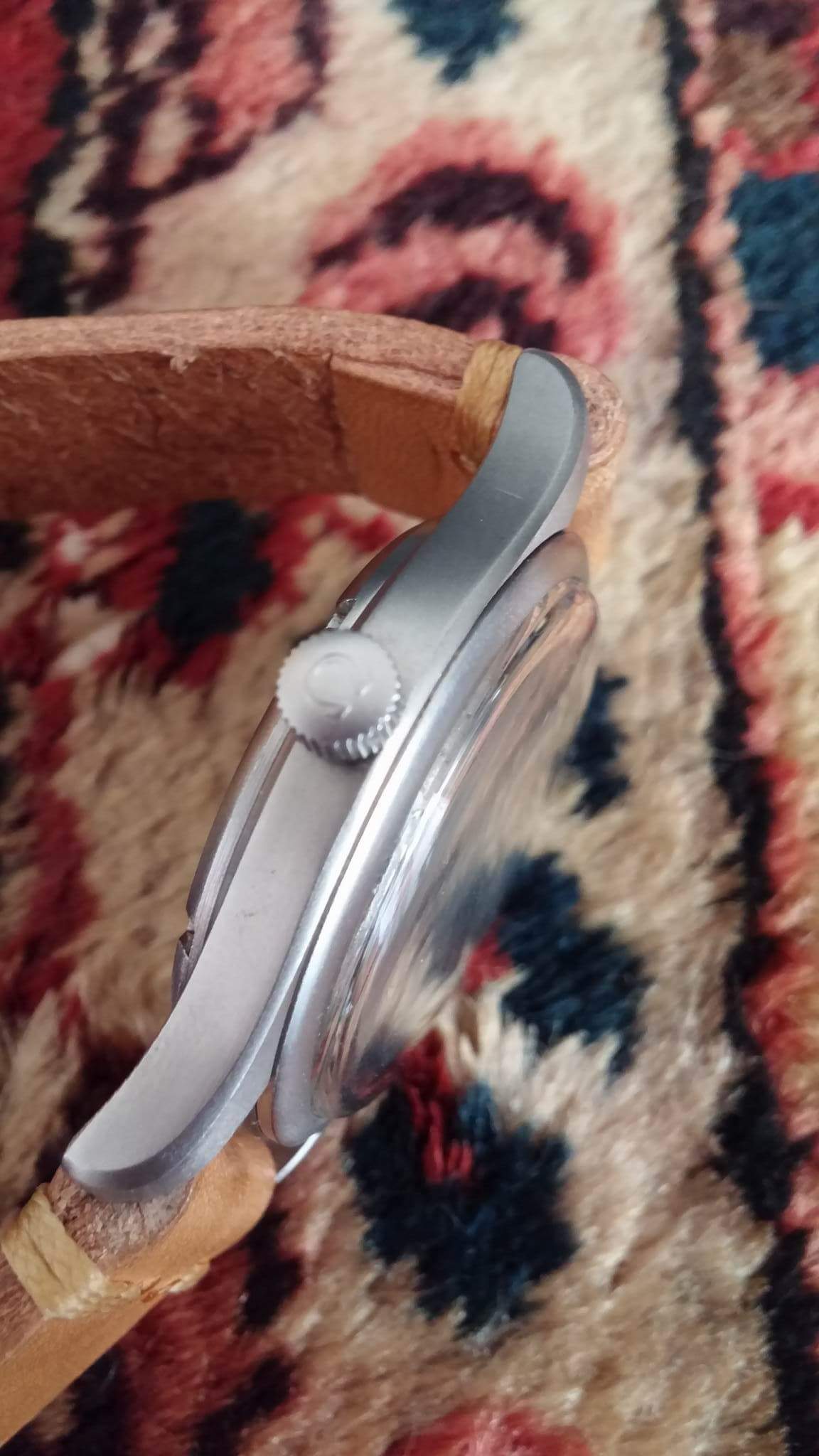

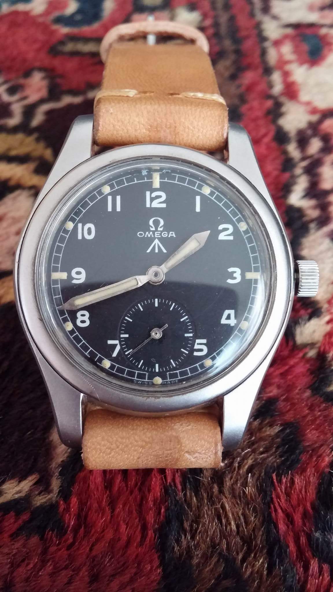

    obviously missing double dots at 12hour mark and some damages on the chapter ring. However, no idea whether it is a repainted dial or not (a bit weird on the font-type of the "OMEGA" for me.

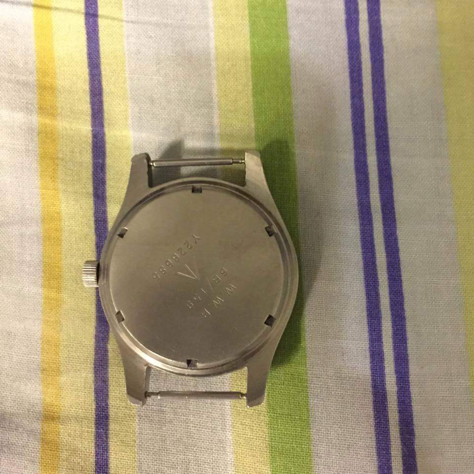

    Spring bar is another issue. Also, the serial number from the black cover... 7 digits only (actually 1 character plus 6 digits), not 8.
    Thanks a lot.

    V hard to see but is that a 27m serial? If so, 1968 is rather late for one of these, about 15 years too late so it is probably a bitsa.

    All around fake. Fake case, wrong movement, fake dial.
