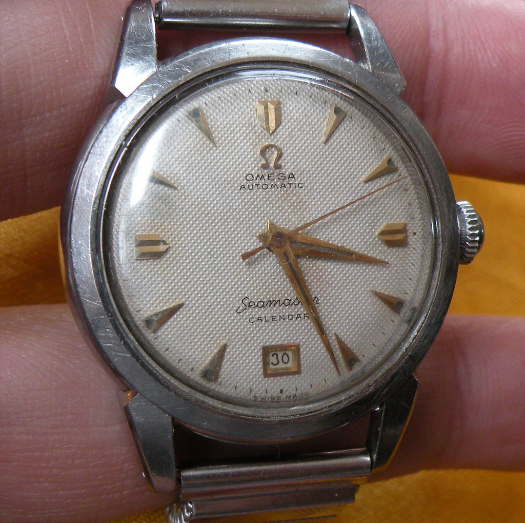

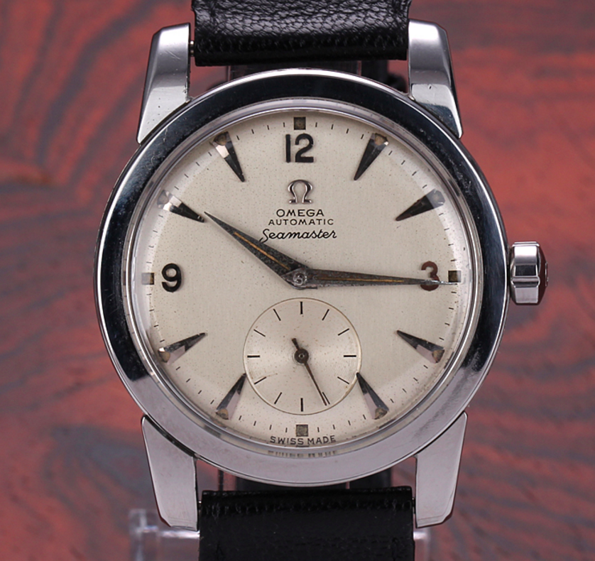

    Hi All,
    After having thoroughly enjoyed @ConElPueblo 's thread on crowns ( https://omegaforums.net/threads/the-curious-case-of-controversial-constellation-crowns.54568/ ), and esp. his take on the 'it would be great if we knew more about it' :thumbsup:,
    Why not have an alike discussion on the Omega logo on the dial. Unless there is a lot already written / published about that, in which case I will gladly be corrected.
    Anyway: these 2 Seamasters are 6 digits apart at 13,89M. One might call them 'twins' as far as I know.
    Which might date them at around 1953.
    There is no reason to believe that they have had some kind of redial, looking at the pics.
    And: look at the crowns...:p:p
    However: the Omega logo is different.
    It appears to be that around '52-'54 the logo changed.
    So what to think of this??
    BTW: either way, I love them!

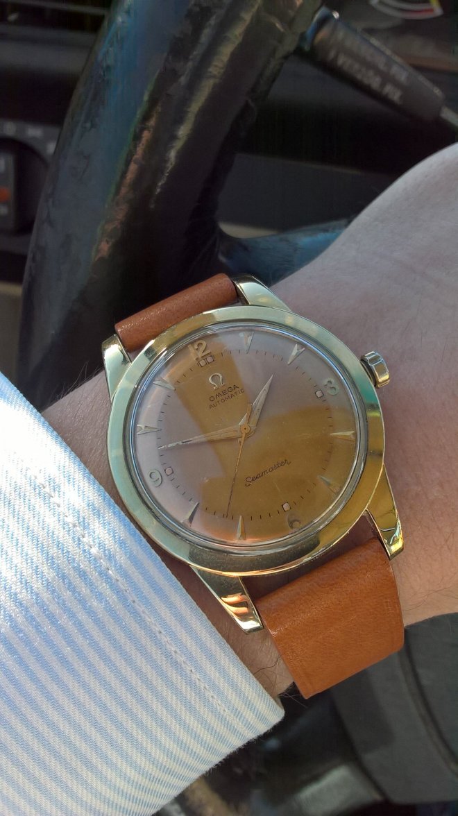

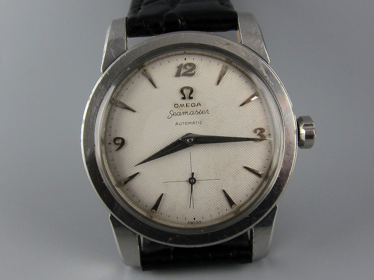

    Here are my three '53 vintage Omegas:
    I realise that they aren't the same reference, but it could look as if the logo might have changed during that year... For the record, the Constellation featuring the "modern" logo is a very late 1953 production, going by serial numbers.
    TNTwatch, Edward53 and Willem023 like this.

    Dial outsourcing - different suppliers both correct.
    gatorcpa and Willem023 like this.

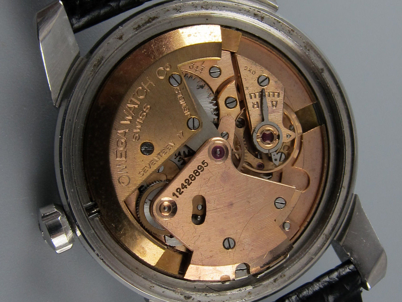

    Not a Seamaster, here's a 1954 Omega with a 344 movement.
    [​IMG]
    Seller's photo of the movement pre-serviced.
    [​IMG]
    Willem023 and TNTwatch like this.
