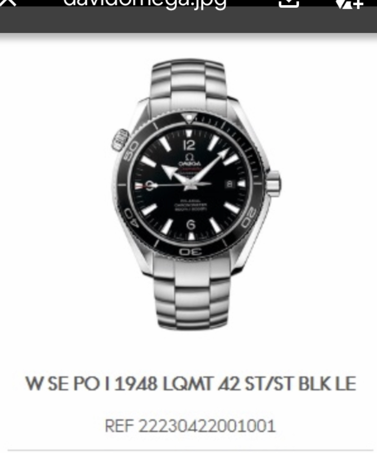

Hi Archer, the model is the Seamaster Planet Ocean LiquidMetal Limited Edition 222.30.42.20.01.001

Okay the bezel for this watch is still available, and isn't something that requires you to send the old part back to get a new one.
Did they give you an invoice for the part they are trying to charge you for? If so, it should list the part number of the bezel, and this is the part number for the bezel that should be on your watch:
082CC2102 | STEEL BEZ.CERAMIC RING LQMT
So unless the invoice has the part 082CC2102 on it, they are trying to pull something by the looks of it. If you have photos of the watch with the new bezel, please post them.

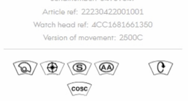

I have attached the detail they sent me. I do not have the watch but I will go back into the jewellers and take a photo. Thanks again for the help.
