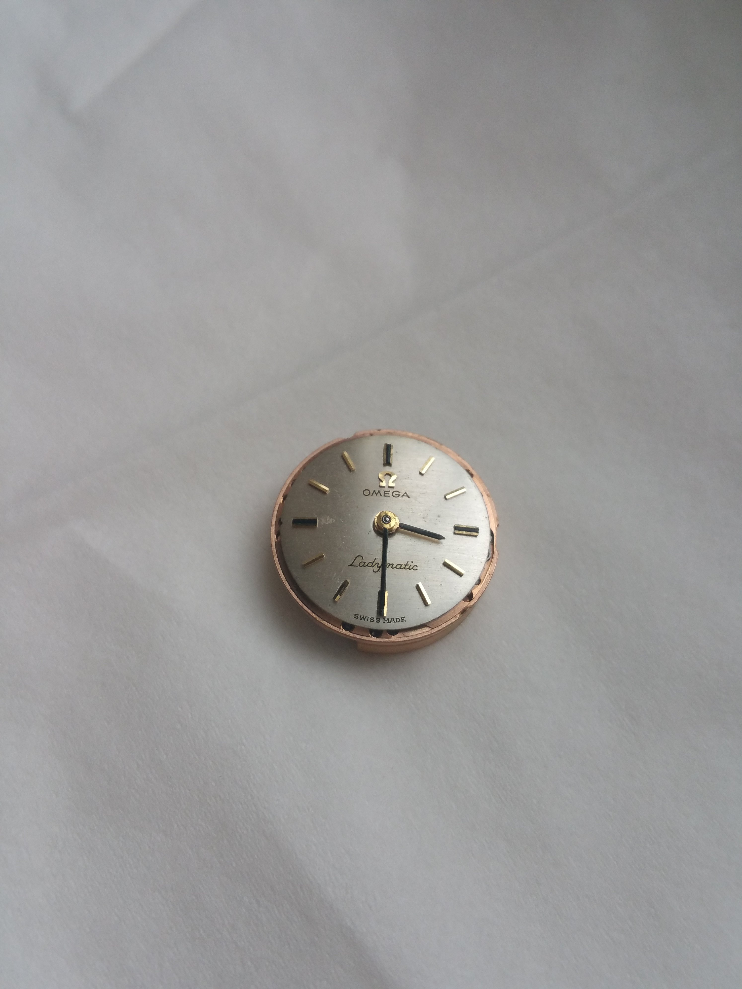

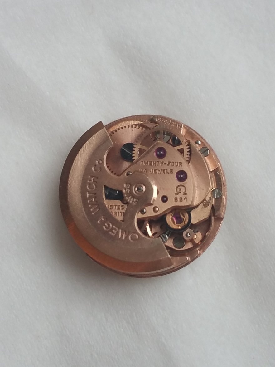

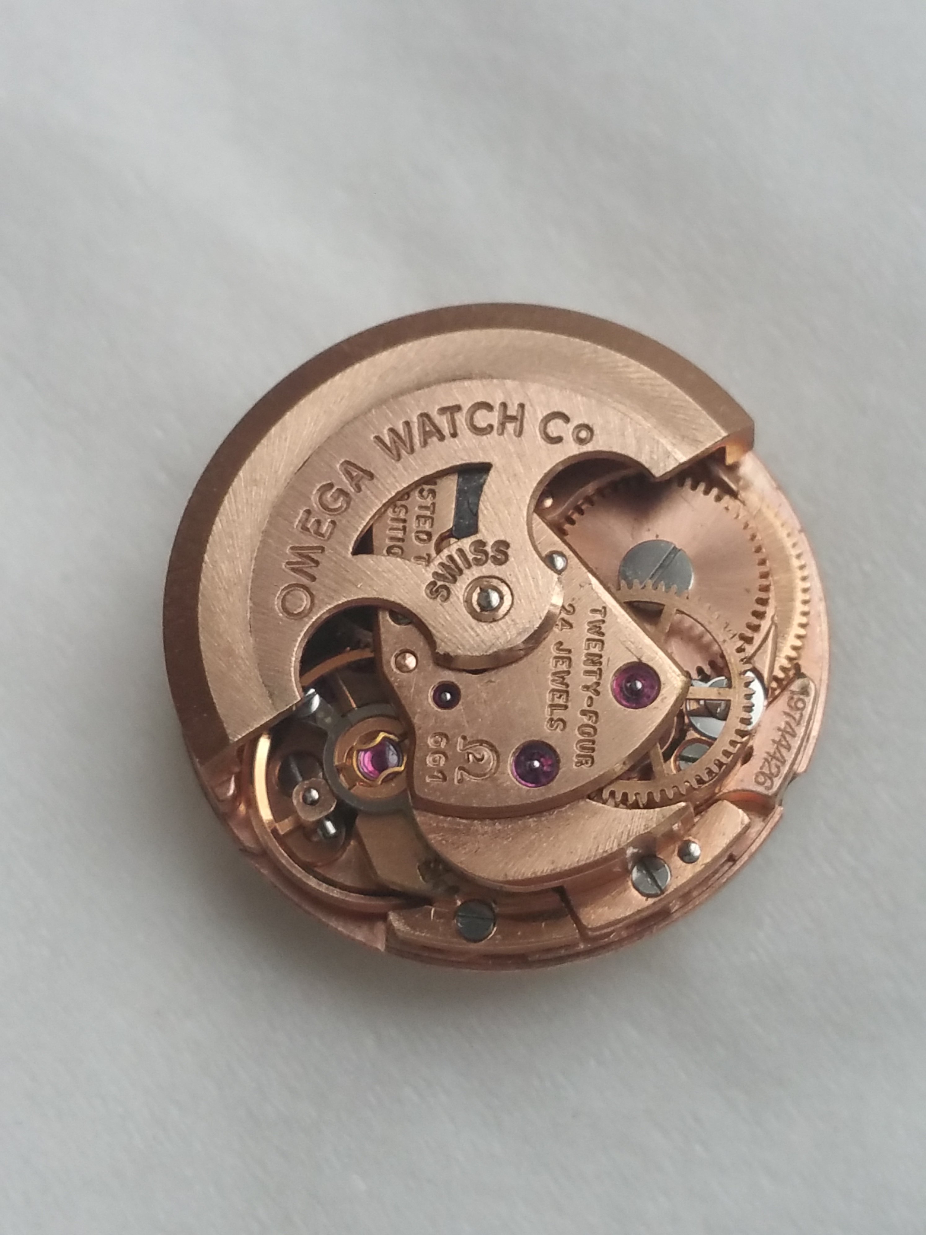

    Hello and thank you for having me on this forum!
    I recently bought a mechanism cal 661 I posted photoes of it. I got it because it was in very good condition and since my old watch is not moving anymore I decided to start a project.
    I've read a lot about this watch but what I got from the seller was :
    I have for sale a watch movement and dial made by Omega . On the movement is stamped 24 jewels and Omega watch Co. it is an automatic and measures16mm across.It is in working cond. but requires a winder.
    Now I've kept on looking on ebay for a case first of all and I found http://m.ebay.com/itm/381629089647Purchases made through these links may earn this site a commission from the eBay Partner Network
    And another one
    http://m.ebay.com/itm/262651322628Purchases made through these links may earn this site a commission from the eBay Partner Network
    I hope I've got them wright.
    My question is regarding the winder. Might be silly but if I get the first case would I need to get
    http://m.ebay.com/itm/311706859492Purchases made through these links may earn this site a commission from the eBay Partner Network ?
    If I got the cases wrong please advice on what to look for.
    This is my first project so please bare in mind that I am a novice at watches, even tho I had a passion for them I couldn't afford one.

    When I reverse search cases for the 661 there are 9 pages, so lots of cases fit this movement...
    However your first linked eBay sale, ref. 2940, is for a Cal. 455, not a 661. The 455 is a 7 ligne movement, where the 661 is a 6 3/4 ligne movement, and the heights are different by over a mm.
    The second case, ref. 555003 is fine for a 661.
    The winding stem you linked to is correct, as the 450 and 660 share the same stem. The case doesn't come with a crown by the looks of it, so you will need to find one - these are no longer available through Omega so you may just have to find one with the right tap size and dimensions.
    Cheers, Al

    I found as references so far 555003 and 551004 under this particular watch. It would help me imensly if you could tell me what to look for.
    I know now first 5=lady's watch second 5=self winding without second and the 3rd digit represents the water resistance.
    Would any case that starts with reference 55 work or do I need to question the seller about the cal as well?
    Thank you again.
