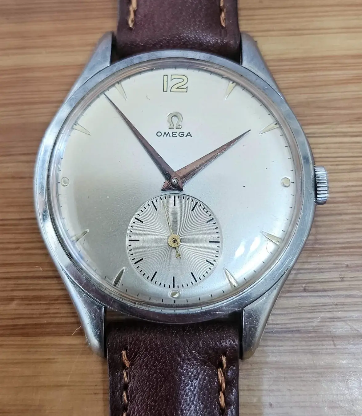

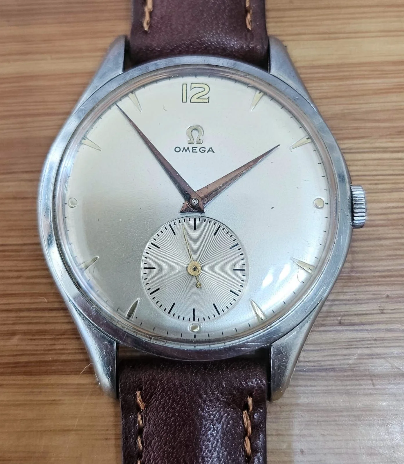

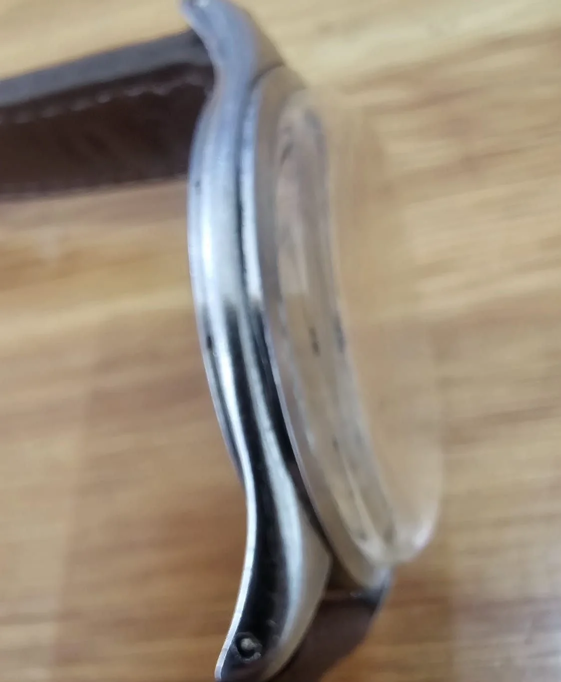

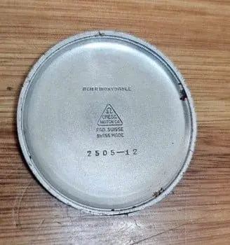

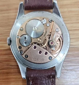

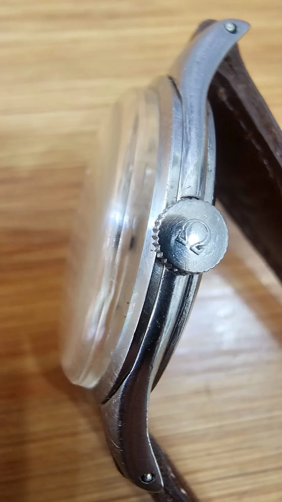

Posts 2 Likes 0 dmrc ·Jul 12, 2026 SOG53 Google is your friend try Omega 2505 Thanks for the reply, but I was wondering if it's original or not, or if you can tell me if the dial was repainted. Thanks in advance
Posts 3,424 Likes 7,579 SOG53 ·Jul 12, 2026 A bit of introduction and context is better than merely asking for “insights”. Here is guide that will help you get better responses. https://omegaforums.net/threads/vintage-omega-posting-guide.383/ Thread 'Vintage Omega Posting Guide' · When you have a vintage Omega that you would like to get some information about, whether you've found something you like on eBay or for sale locally, have had it for 50 years, or recently... dsio · Feb 6, 2012
Posts 24,723 Likes 54,916 Dan S ·Jul 12, 2026 dmrc Thanks for the reply, but I was wondering if it's original or not, or if you can tell me if the dial was repainted. Thanks in advance The dead giveaway is the tick marks painted on top of the applied markers. The hands are all replacements as well.
Posts 35,251 Likes 39,675 dsio ·Jul 12, 2026·Ash @ ΩF Quite a rough example that has had a lot of refinishing work done, not one you want to own
