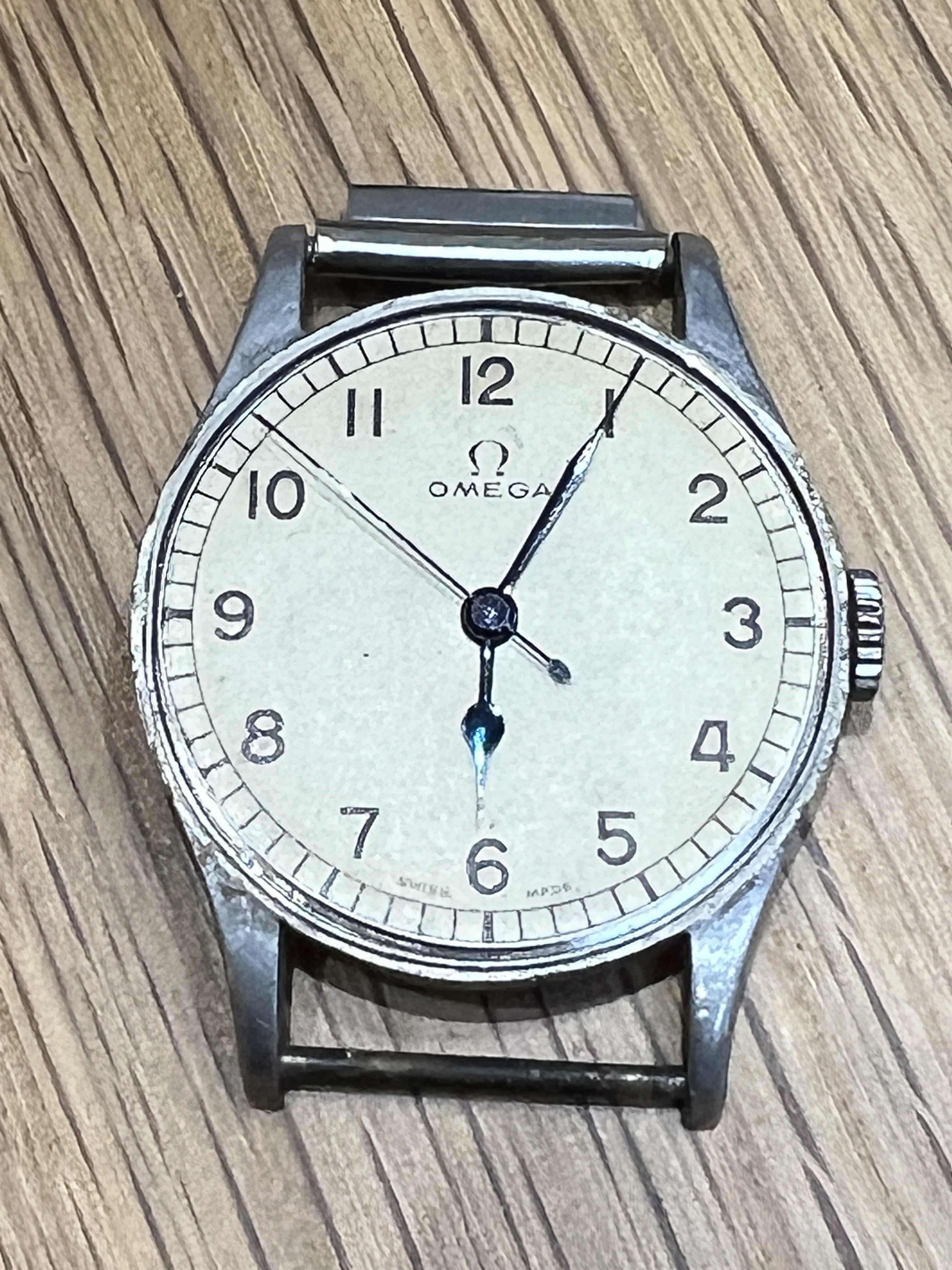

What do you mean by lugs not modified at all? It should be a UK2292 so should have spring bars. Dial is wrong as stated. It should be alloy cased
The spring bar part of your answer is incorrect. Over there at MWR military forum , some members did research that question extensively. That should answer most questions. This 1940's mil. Omega never left the factory in brass cases. Plenty of modifications later( cut lugs, reshaped,drilled and more....), to keep them running. Kind regards. Achim

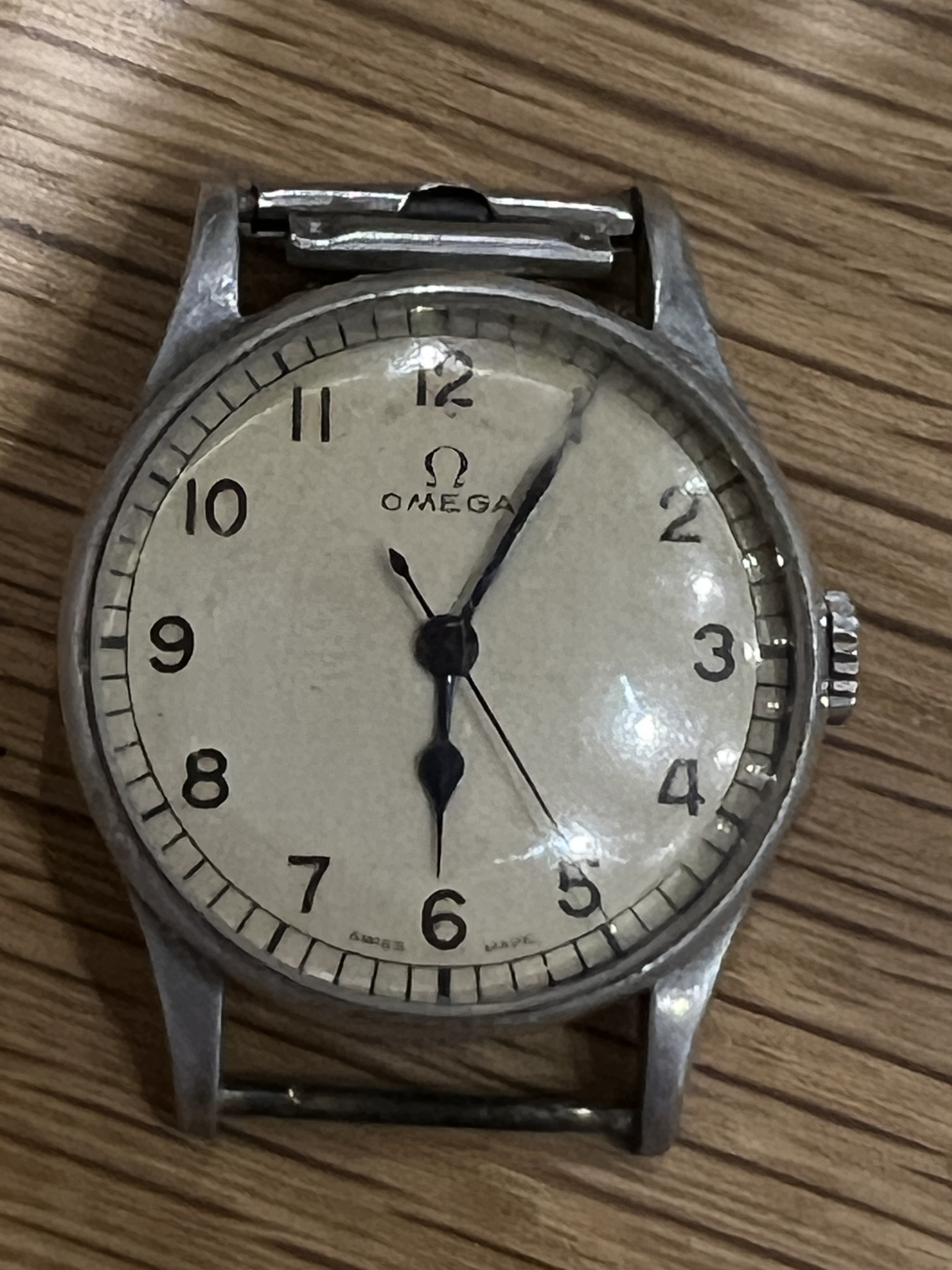

The generally accepted understanding (and let's be honest when it comes to military watches from this era no-one can be 100% sure) is that the majority of HS8 2292's were supplied with non-drilled lugs and springs bars. This was not a modification but was how they were supplied implying that there were differences from the 6Bs. The watch I posted above is not modified in any way and has spring bars. The lug shapes and lengths of the 6Bs and HS8s are different. As you say there is plenty of discussion about this on MWR. I agree about brass cases and I hadn't seen that had been raised here as an issue - they should be duralumin

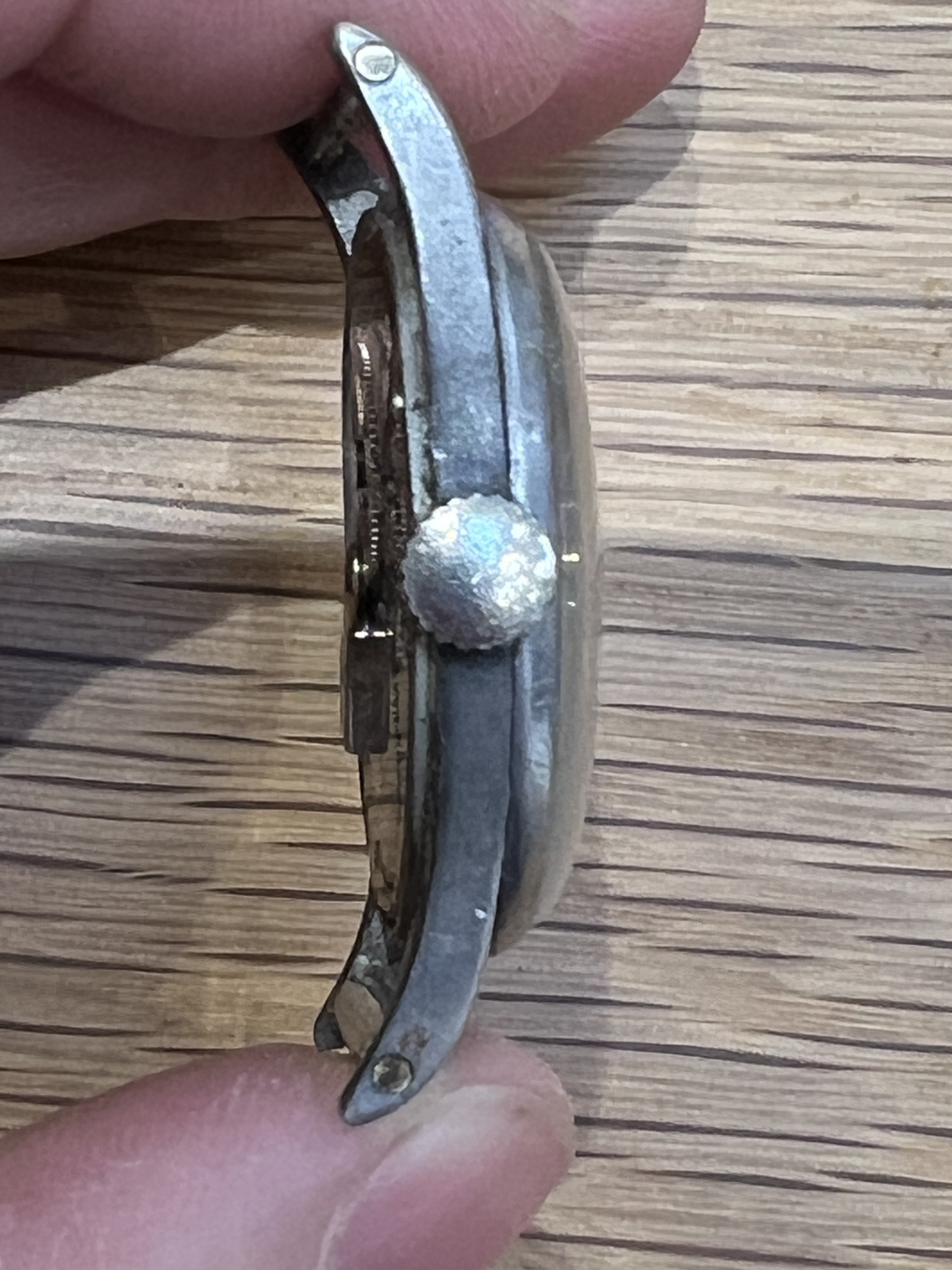

I think the long thin lugged watches are certainly Duralumin whereas the shorter lugged cases do have some copper in them but are not brass. I have several worn Dennison Aquatite cases, which are plated brass and the metal looks quite different from the HS8. It is a copper containing alloy.

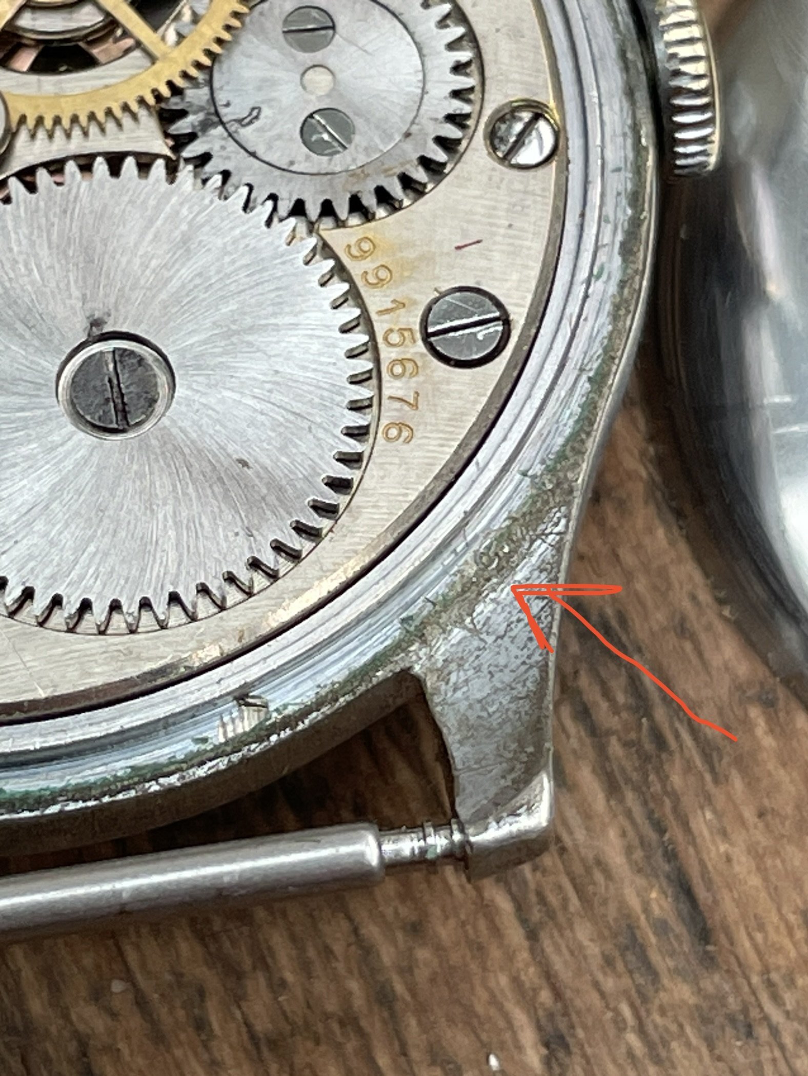

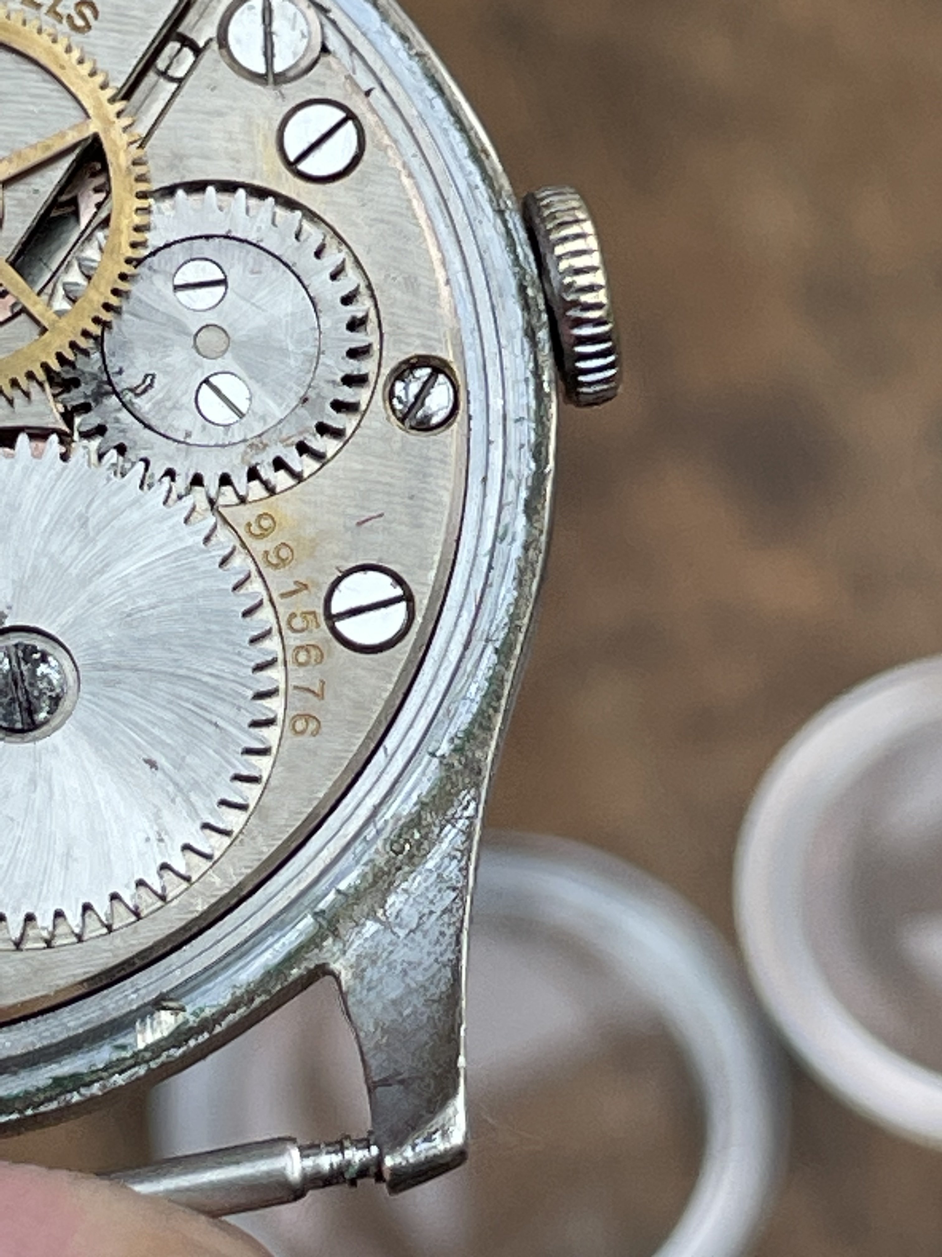

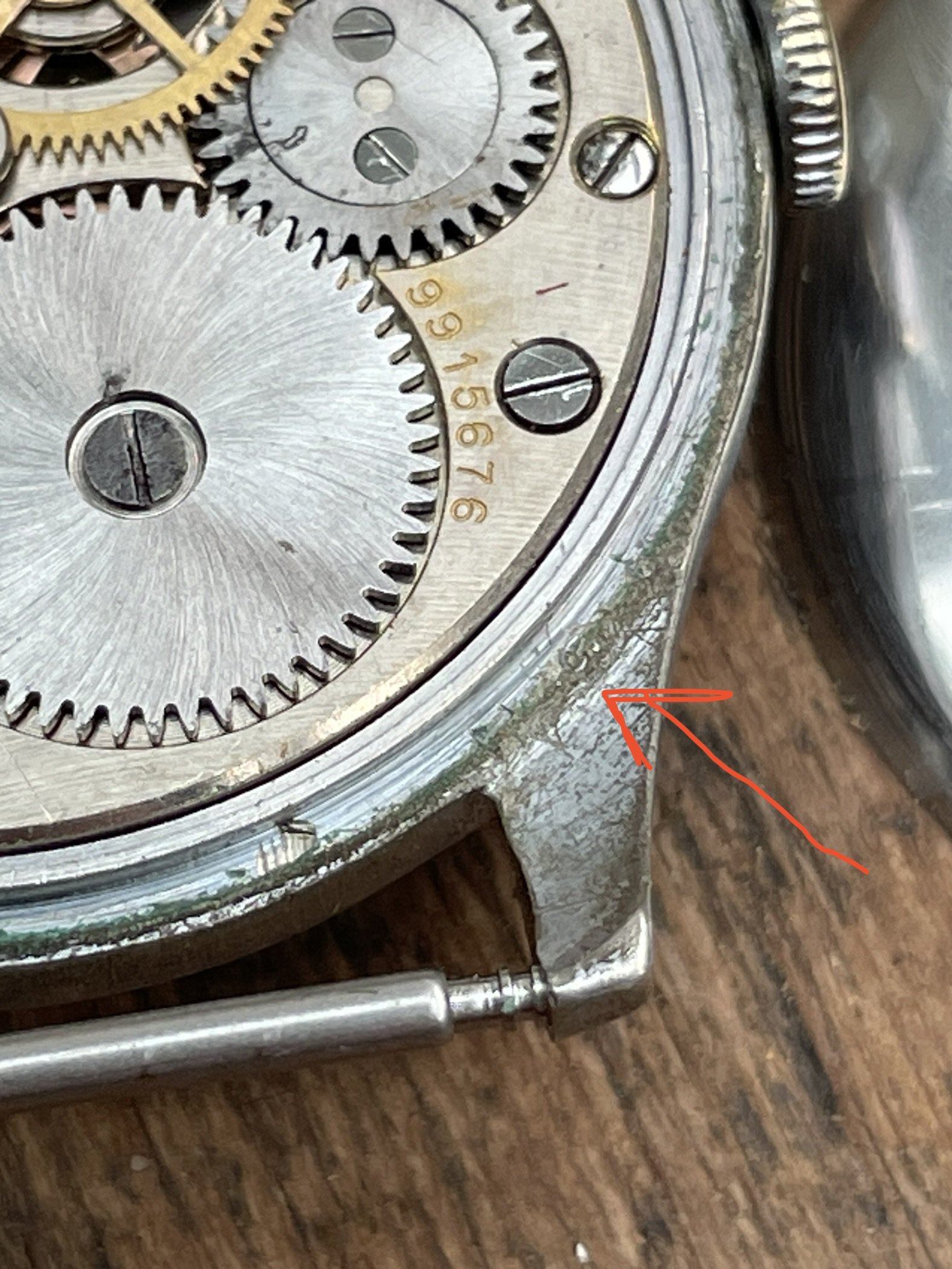

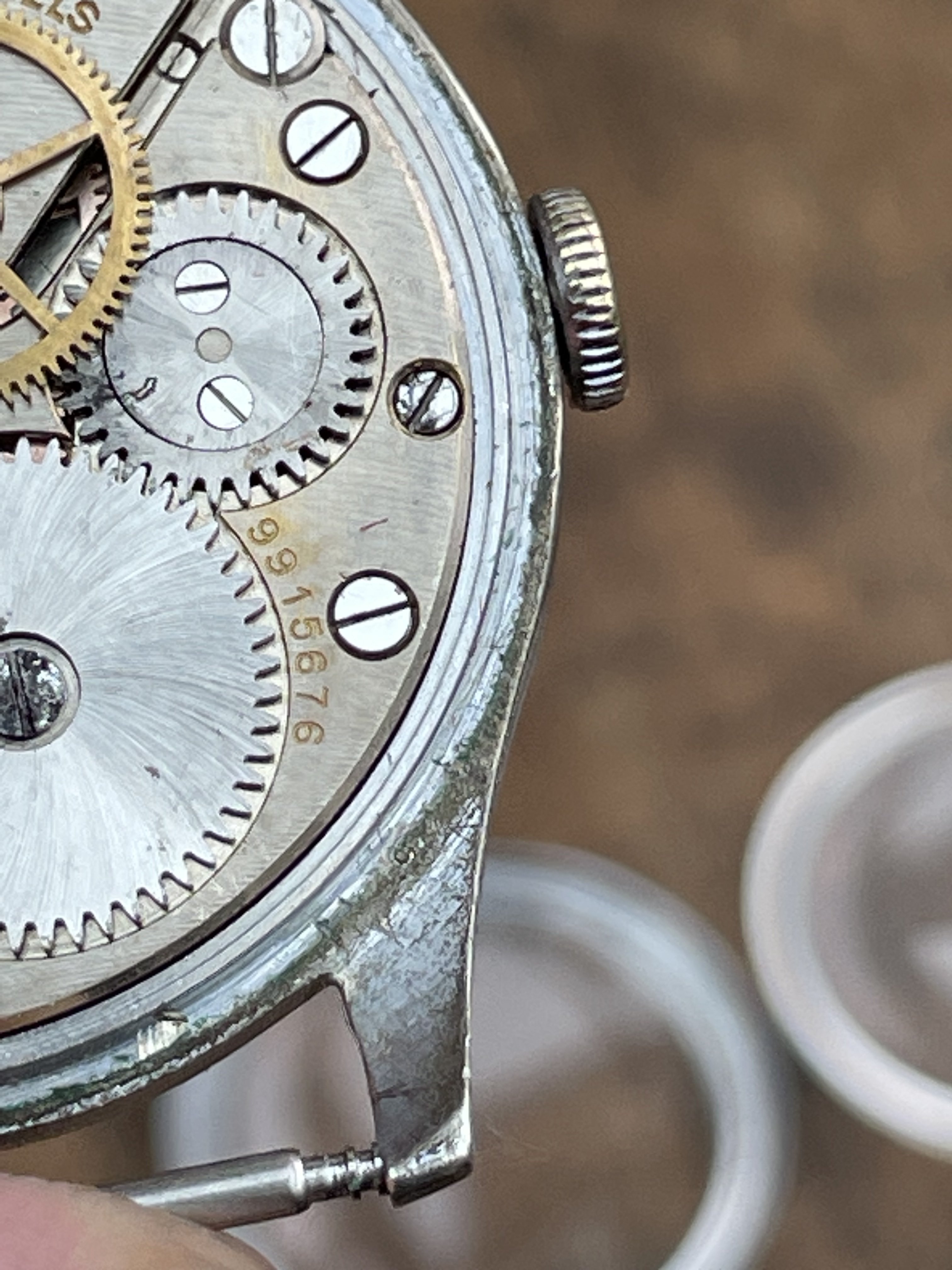

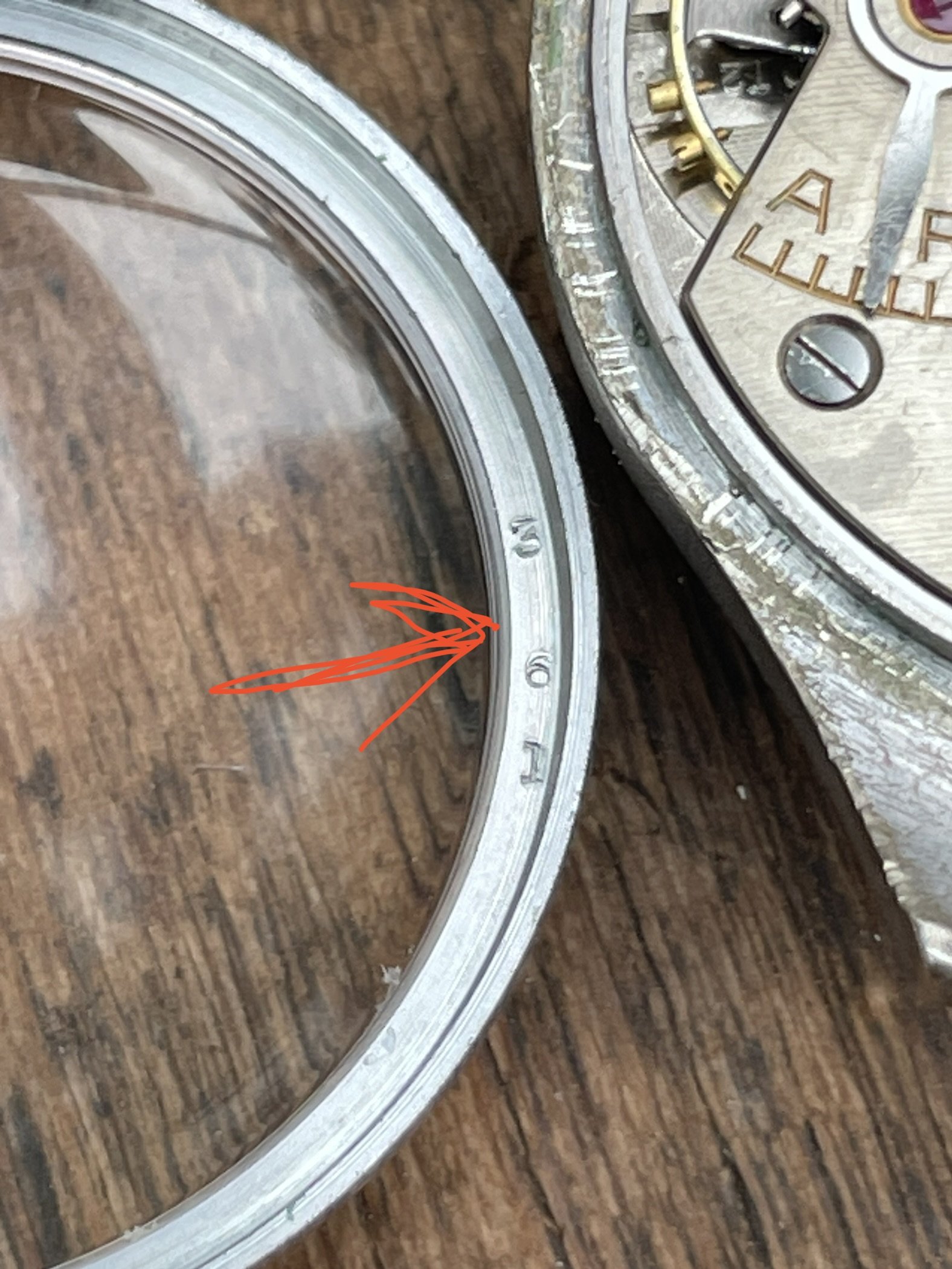

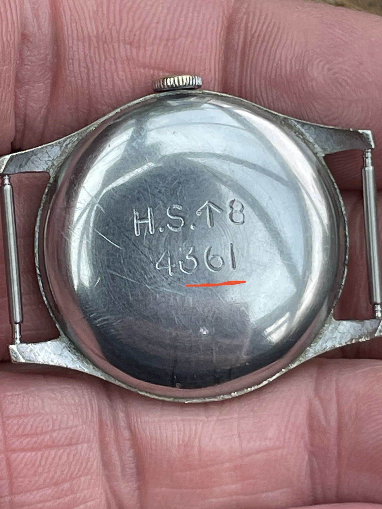

The HS-8 is very easy to check if you know what to look for.
These short lug cases are indeed correct and are totally different from the alloy ones, the HS-8 is a much tougher mid case, which I am sure has something to do with Dennison because the location of the numbers on the inside of the case near the lug is very much like Dennison did.
The last 3 digits on the Omega signed outer case back should also be stamped near the bottom right lug (crown right) and also inside the inner bezel too.
My number 361 is matching all the way through, you might find mismatched watches but it isn’t a worry because these are military watches which were probably serviced en masse, so it wouldn’t bother me either way. But, look out for these numbers in those locations. Cheers, Michael
804
1,474
I can confirm, though my photographs aren't the clearest:
781
1,340
Hi Michael, the ref 2292 HS8 I had was very close to yours, issue number 4727 on the outer case back with 727 on the midcase, mvt serial 9915011. Short lugs and spring bars.👍

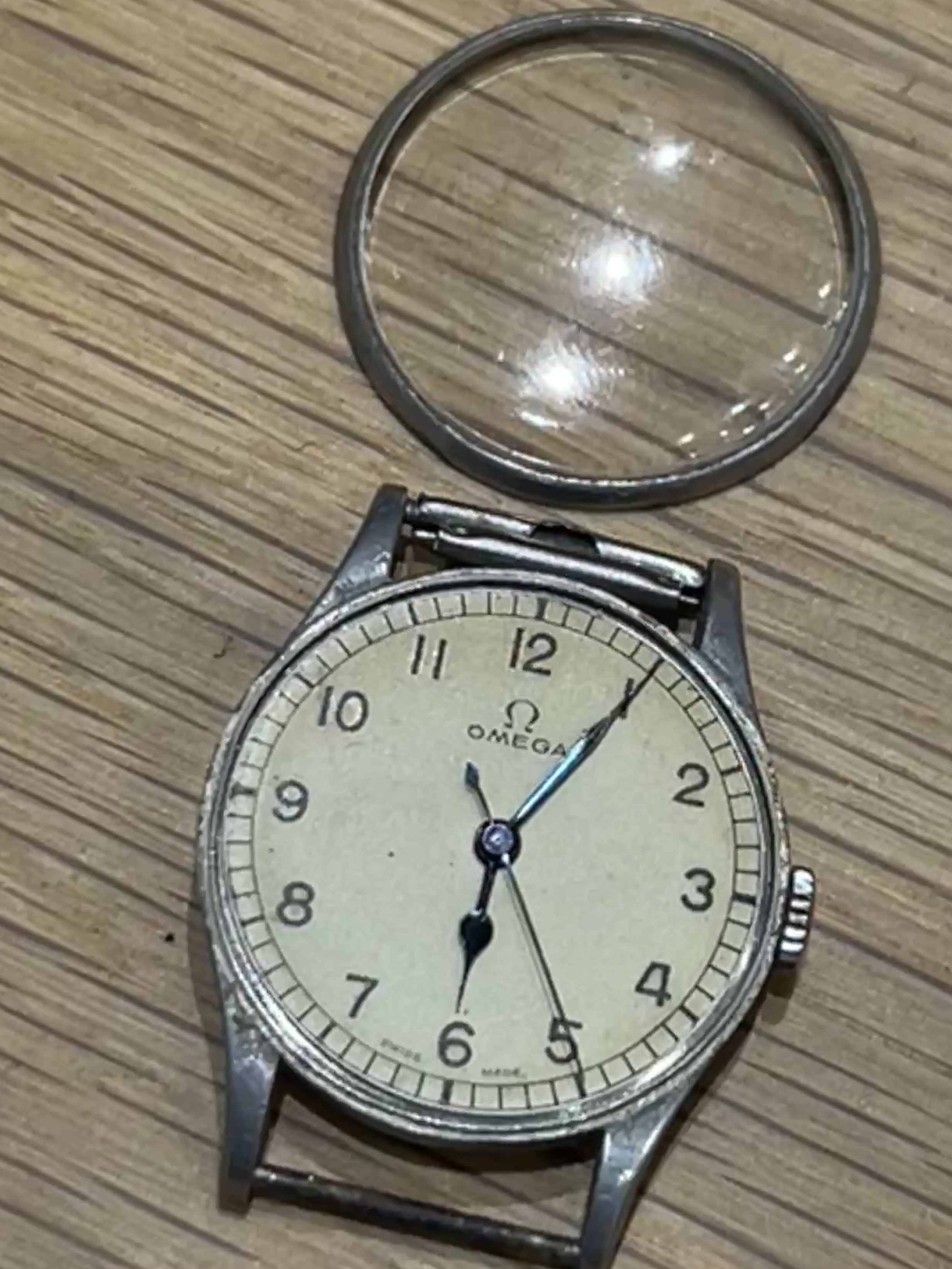

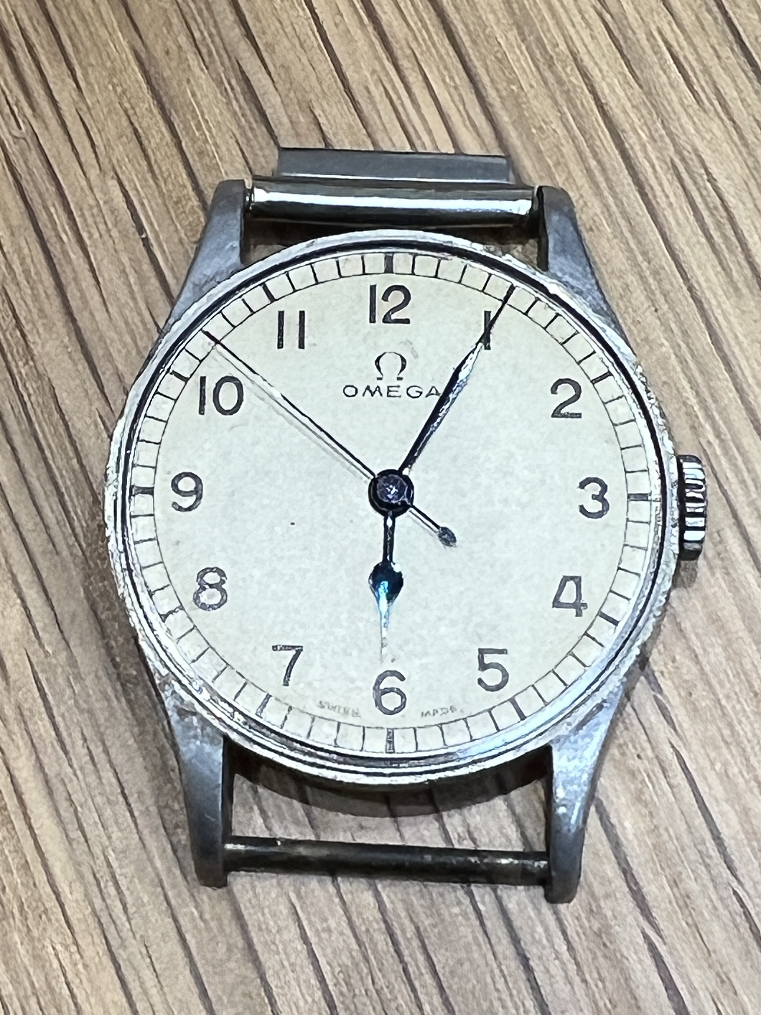

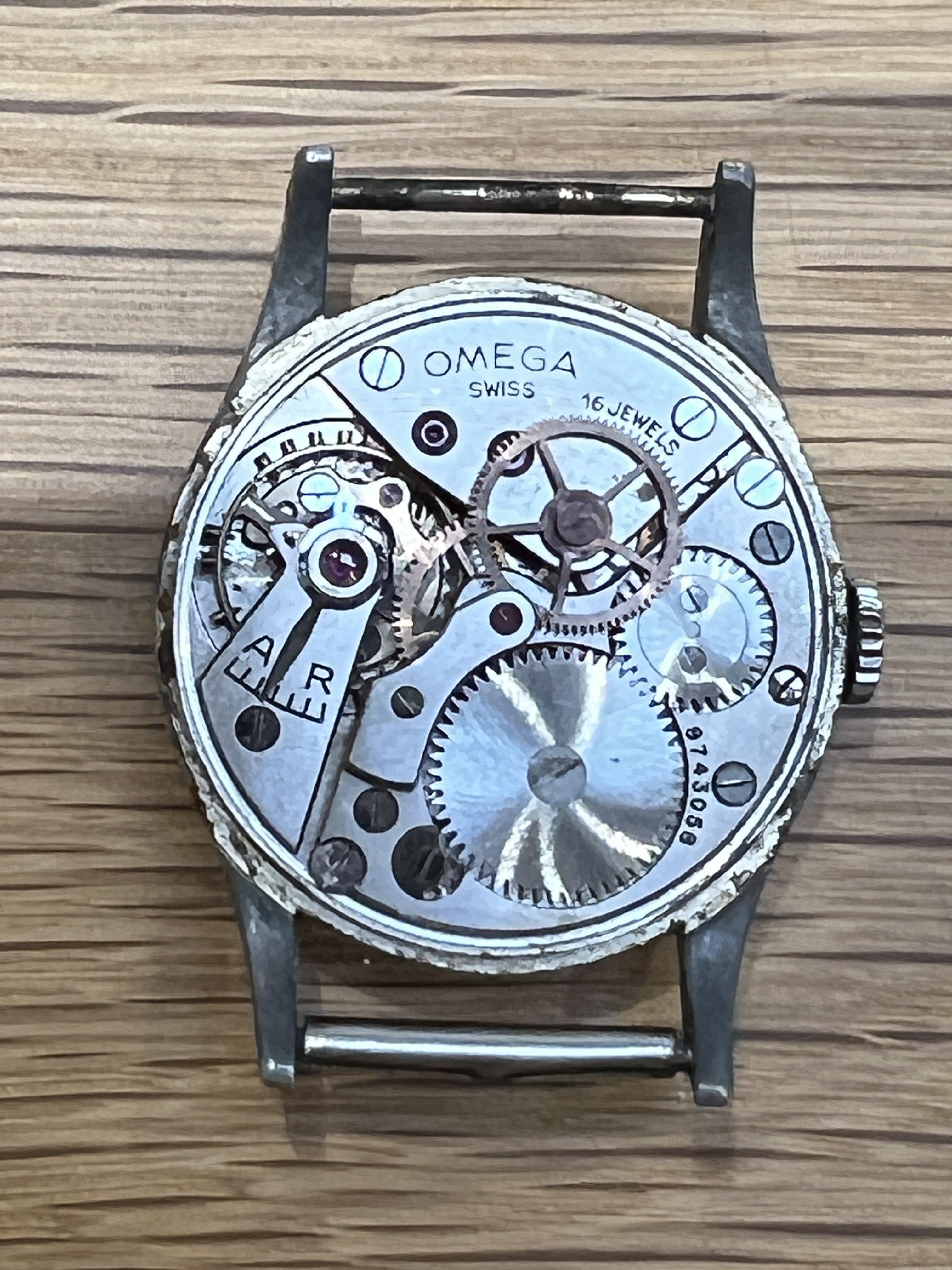

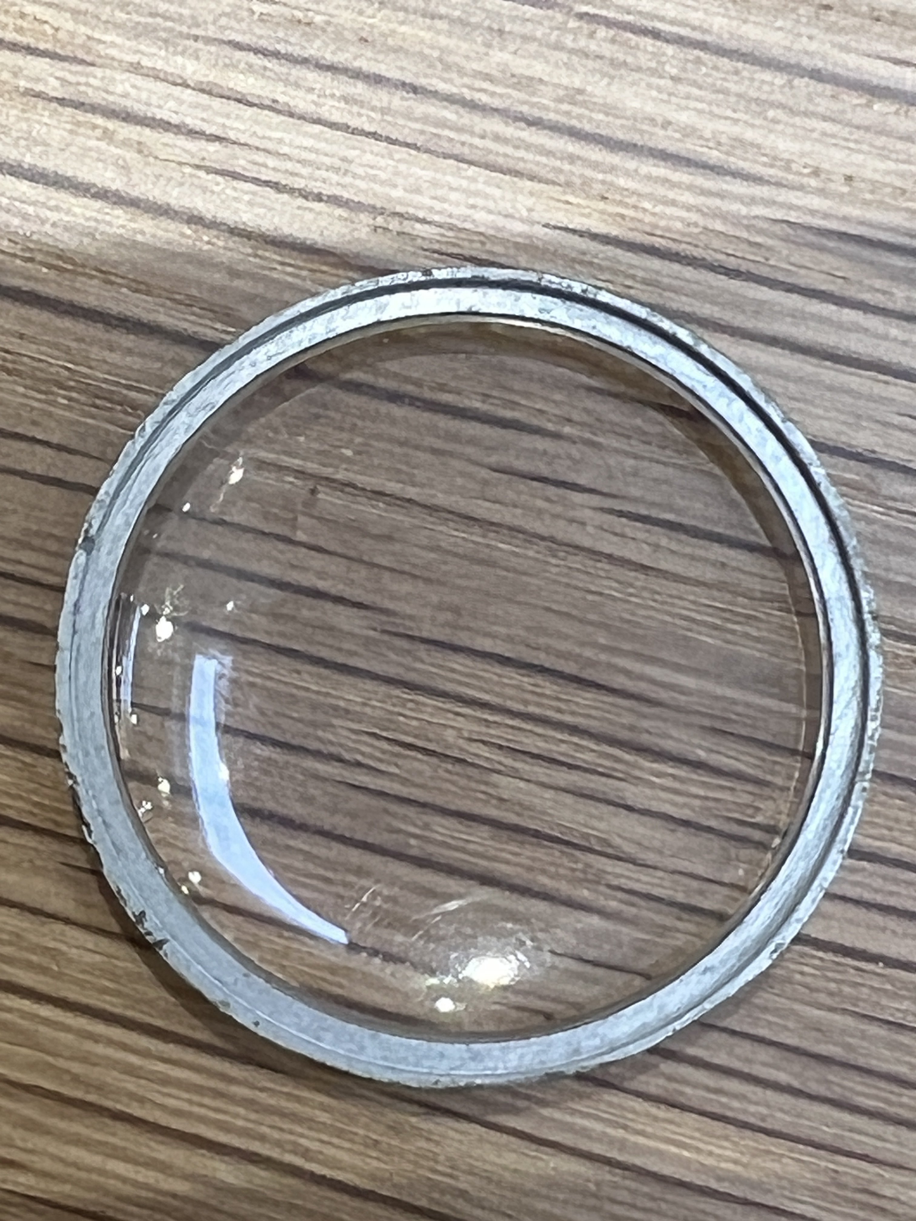

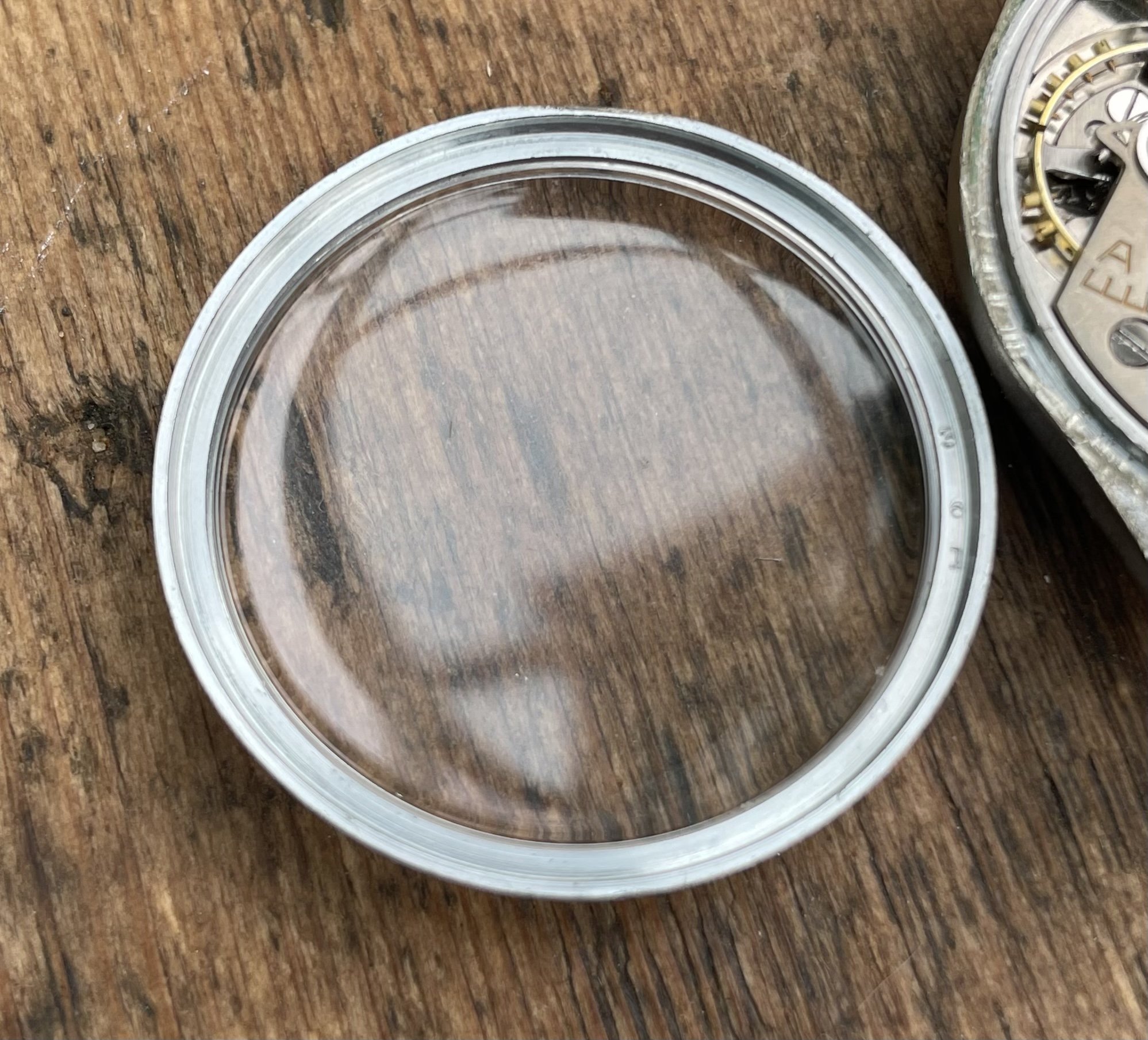

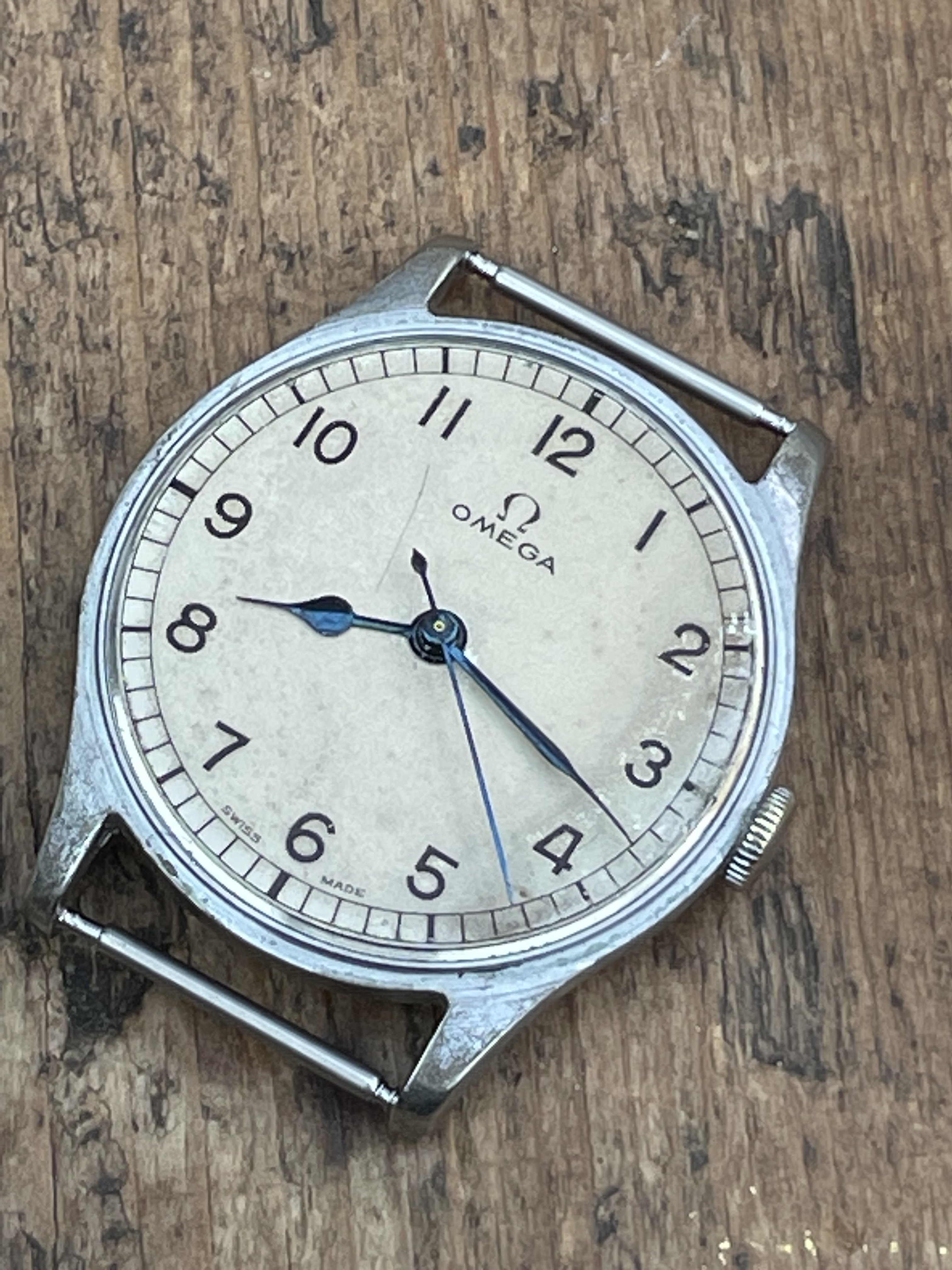

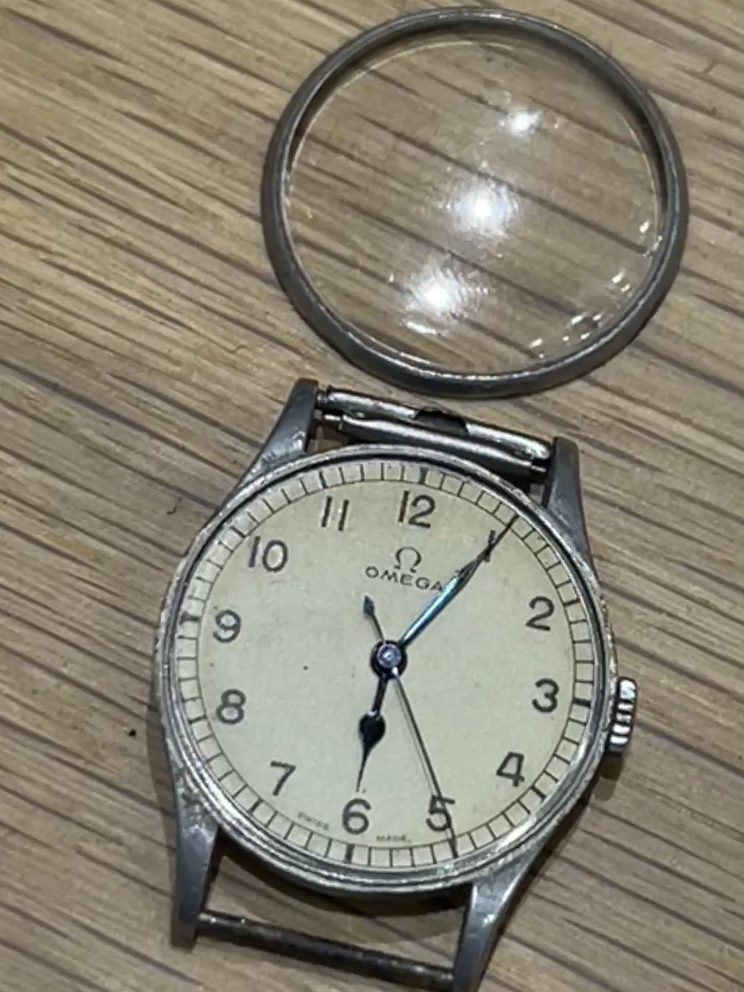

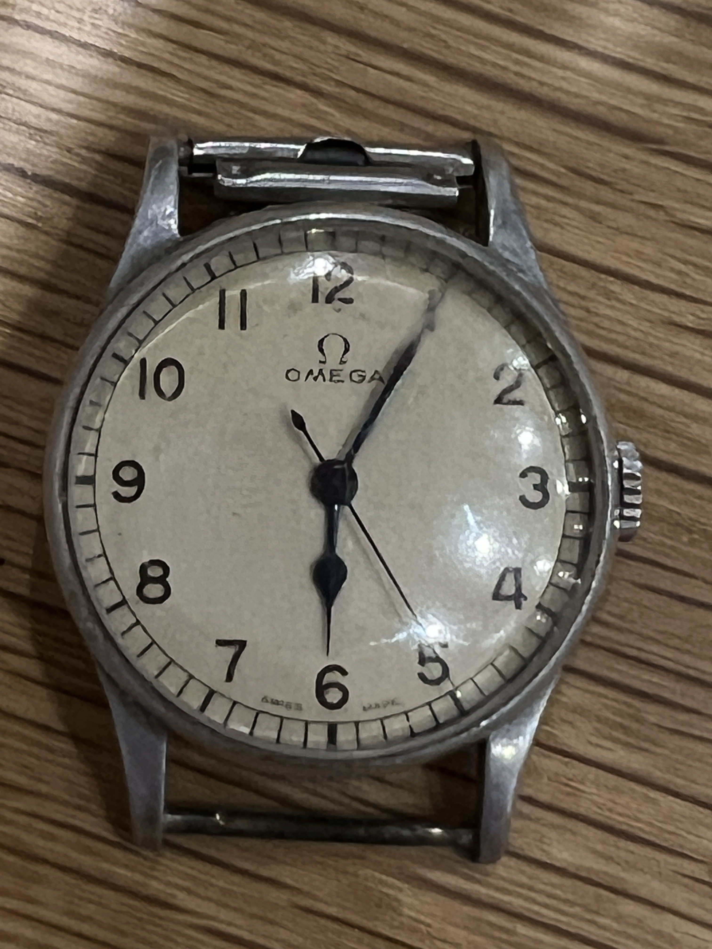

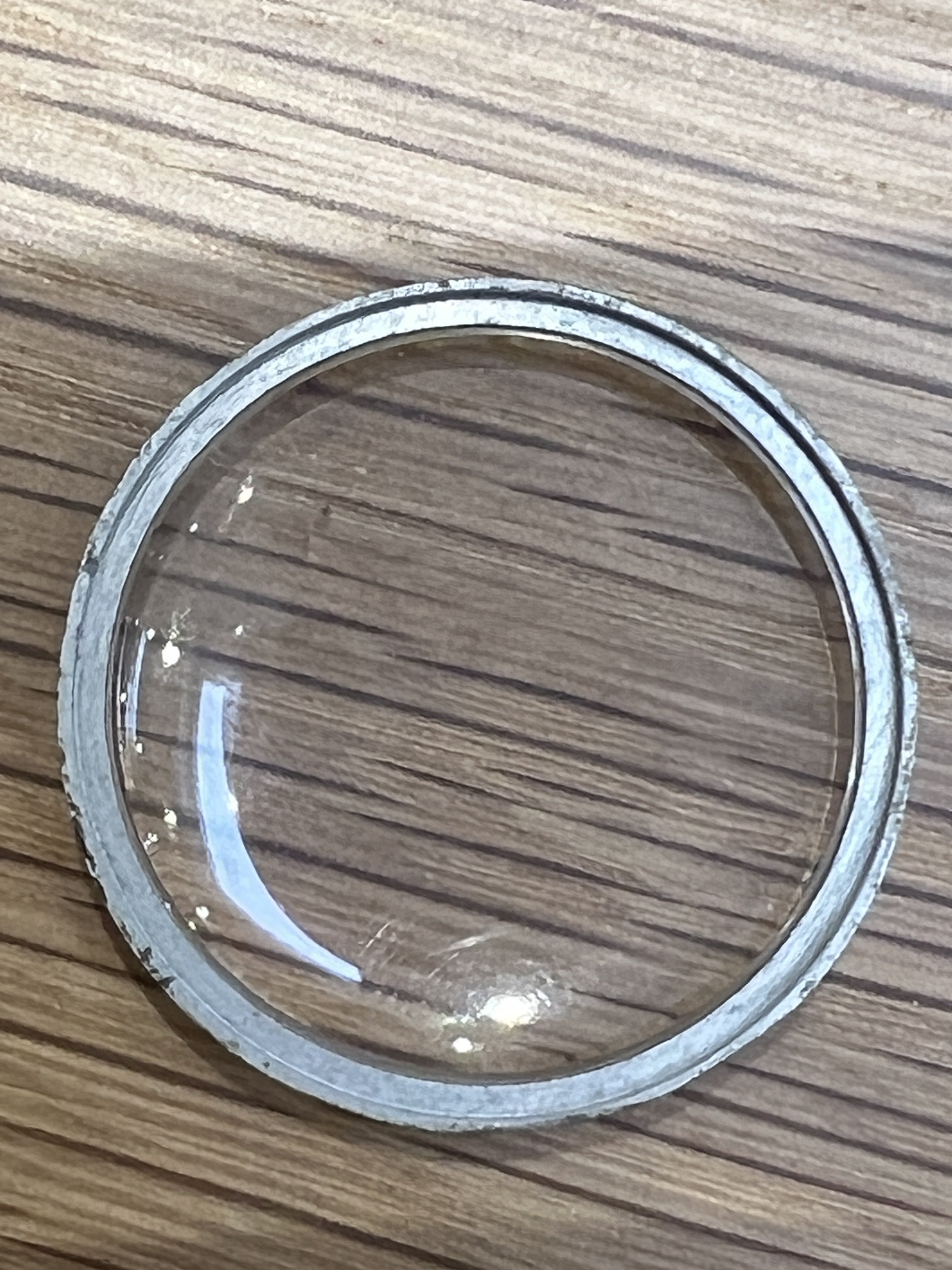

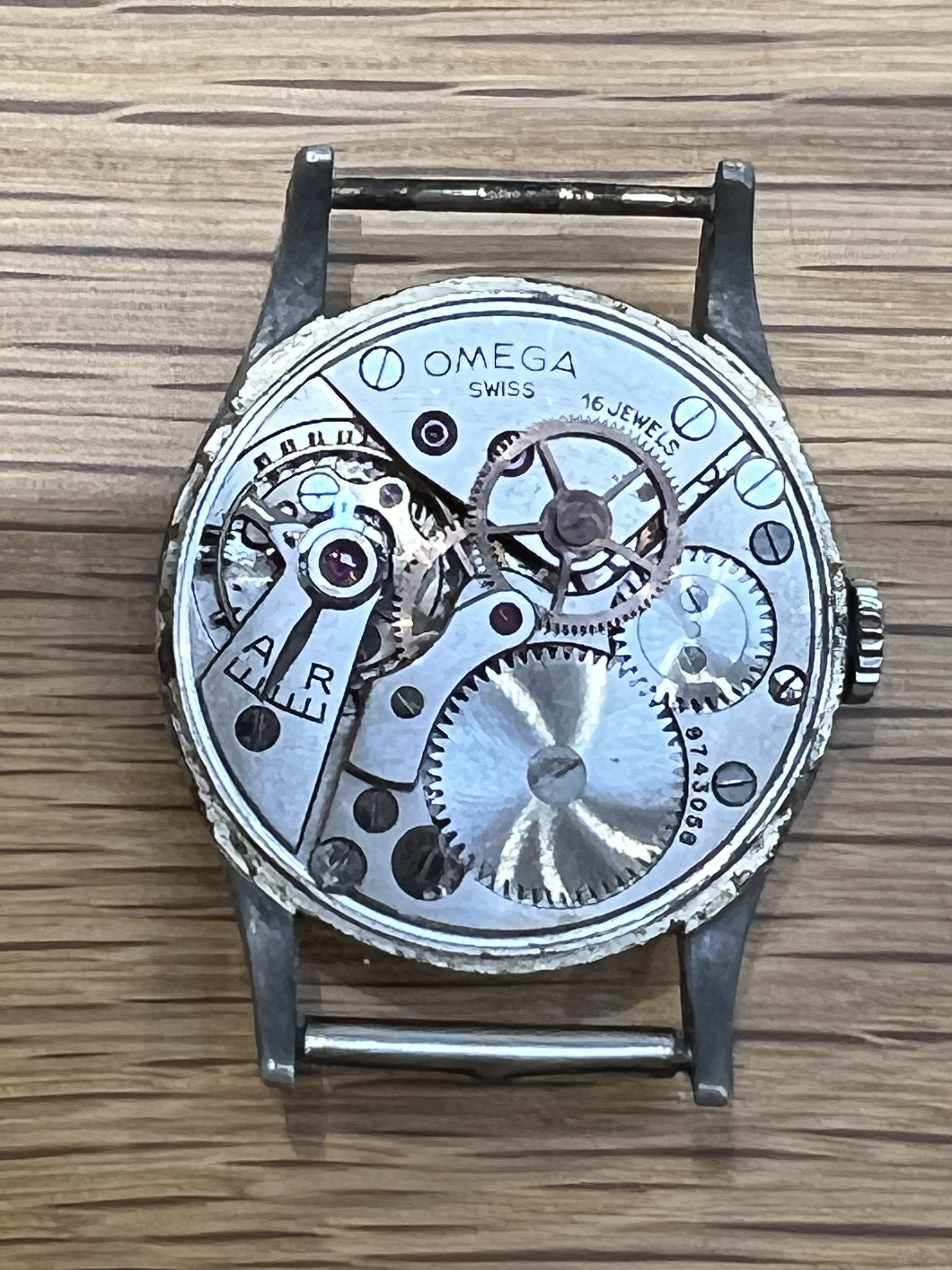

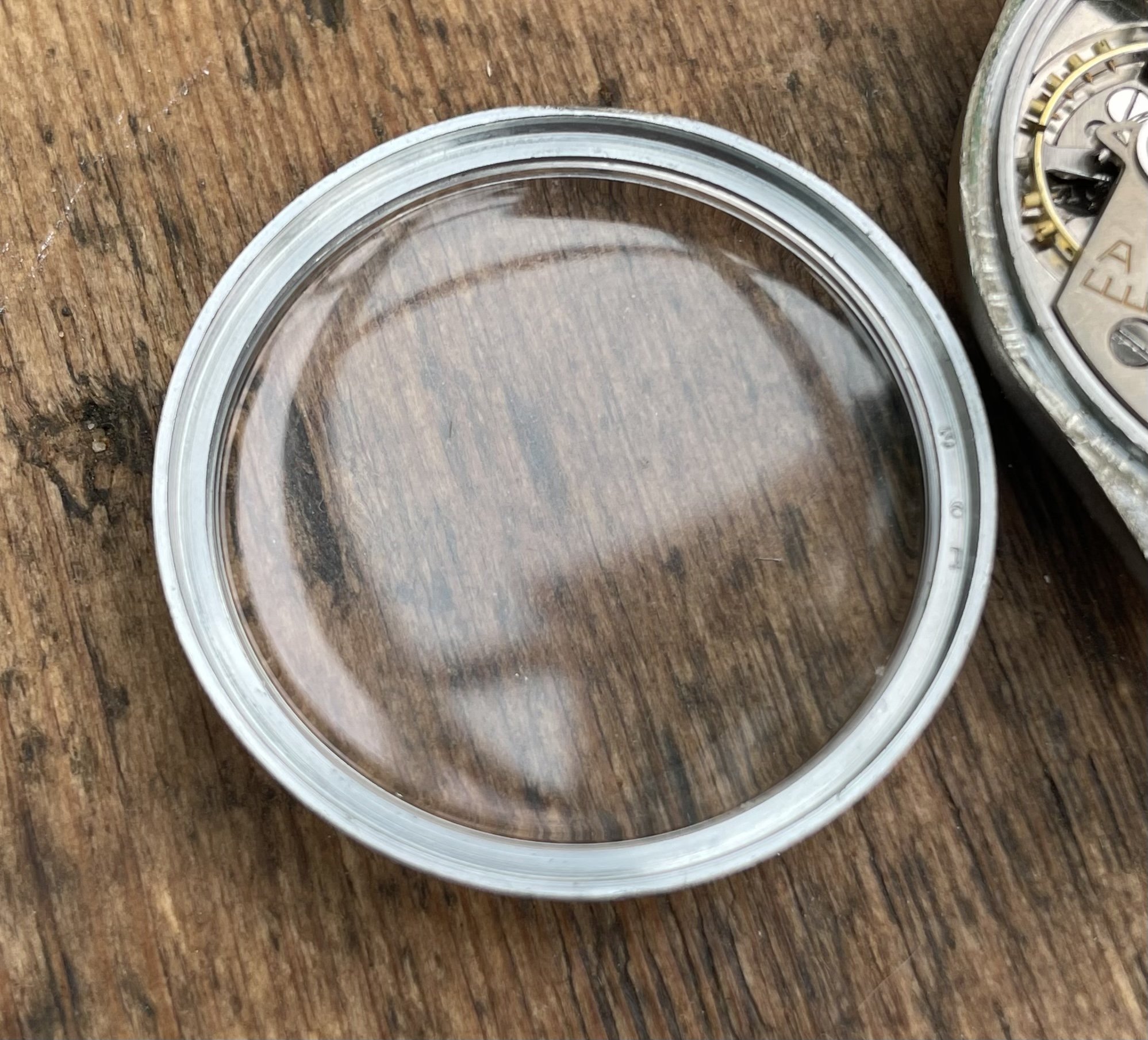

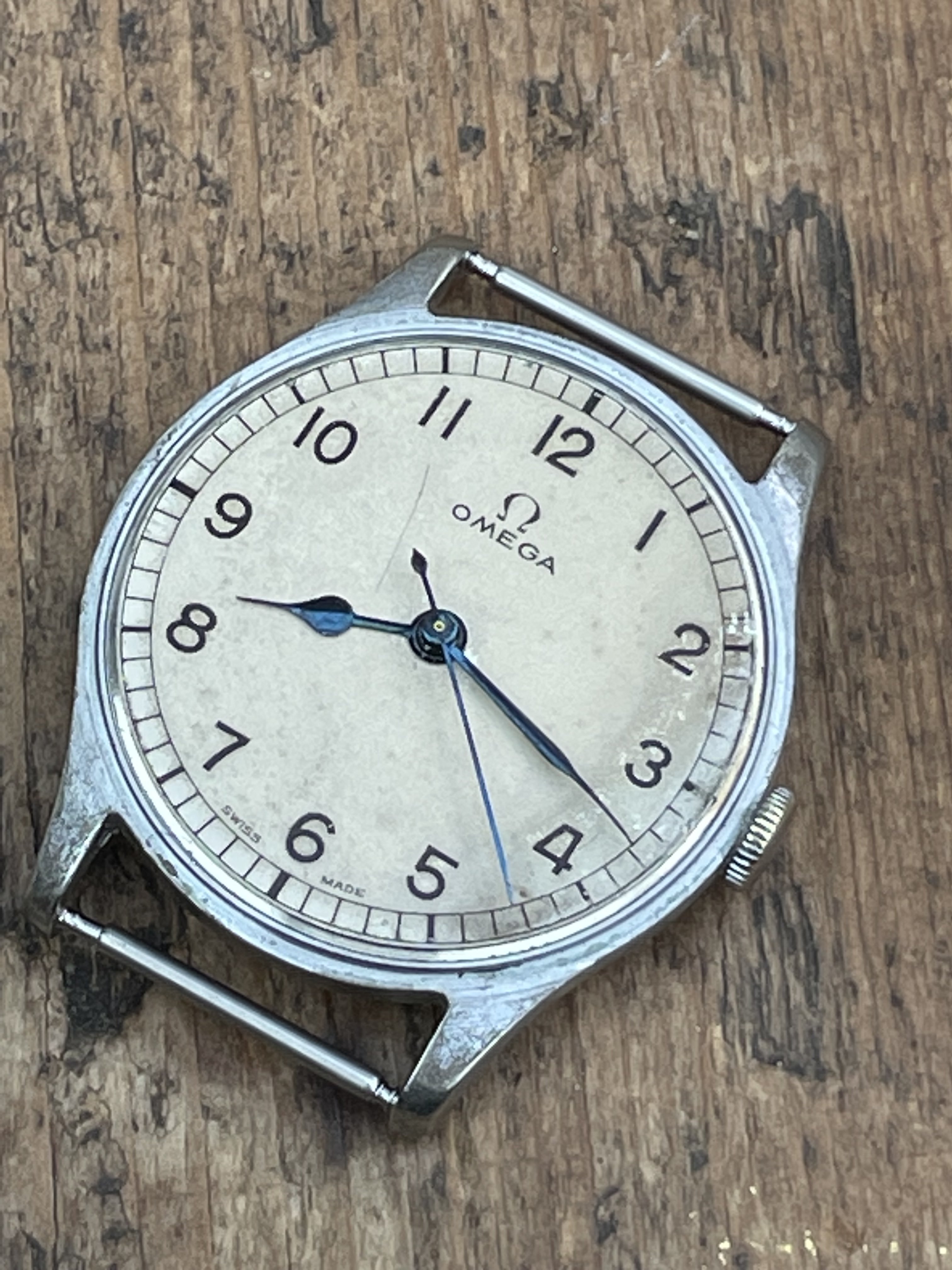

This came to me a few weeks ago, it has no caseback so other than it appears to be an Air Ministry style military Omega using the 30T2 I have no idea what I actually have. The case has no digits stamped on either mid case or bezel and I think it is alloy with fixed long lugs so based on what is written above I assume this is a 6B 2292 then? I'm not sure what to do with it. Without a caseback it is a bit useless but the dial is tidy.
1,522
4,785
Try find a case back, the mid case looks good, these are usually broken. The dial and hands are great too!
Will make a great watch.
