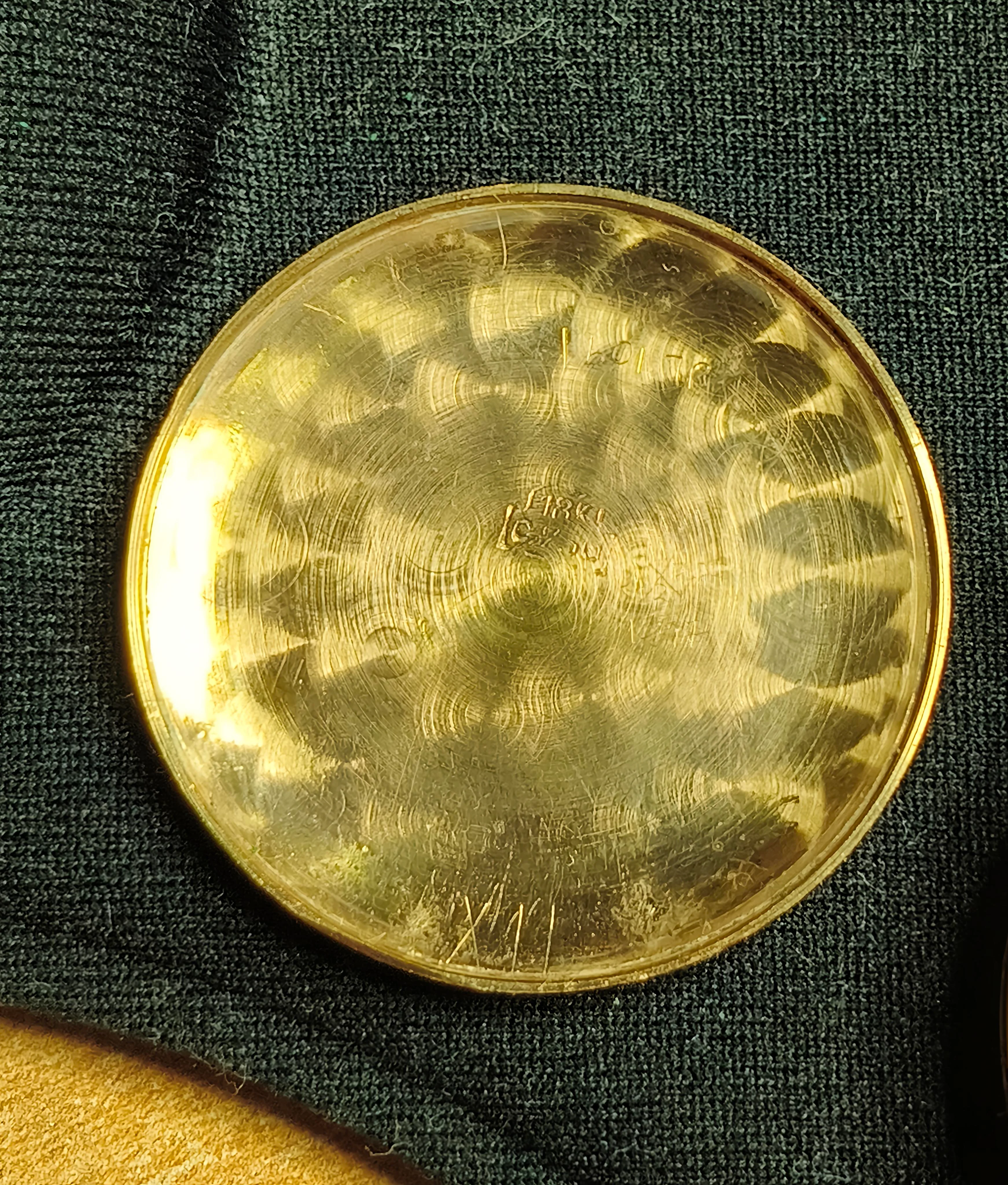

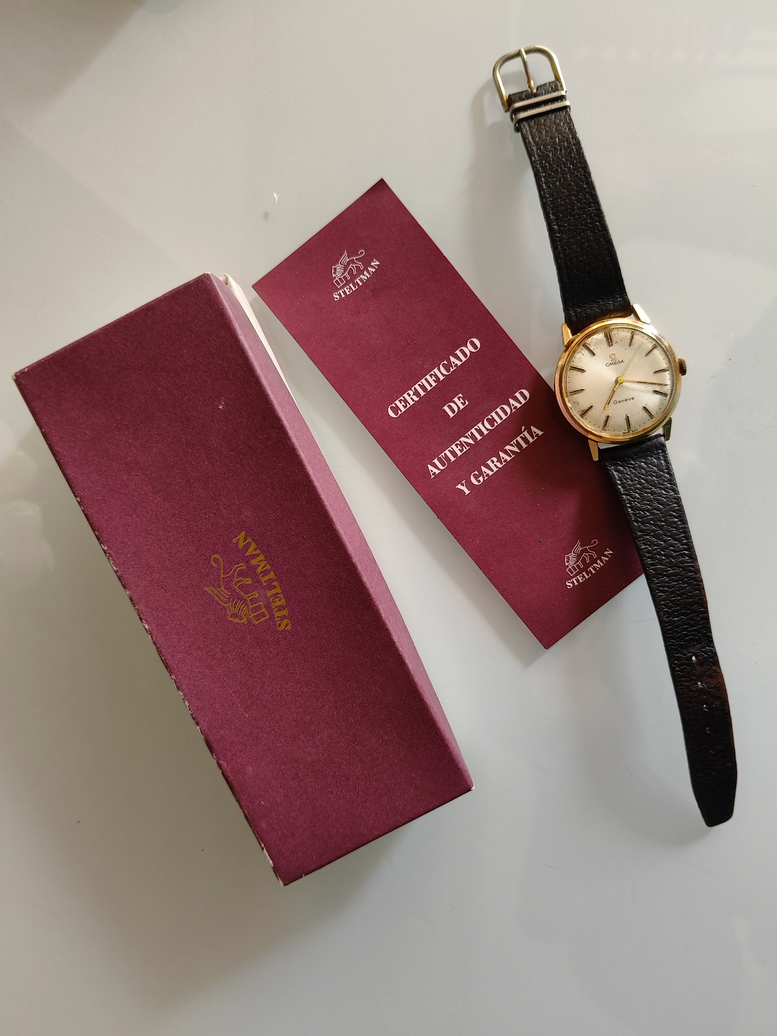

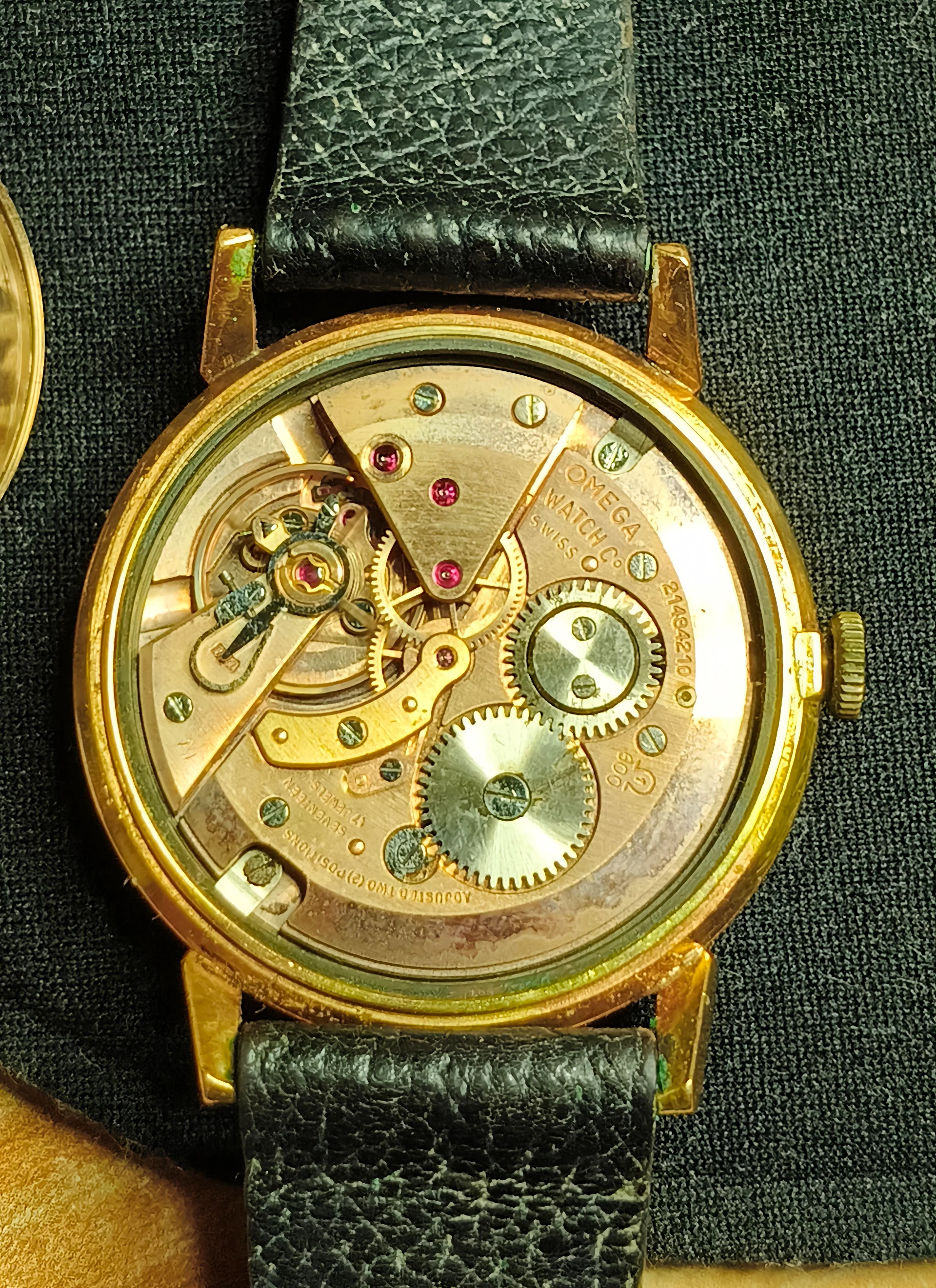

Omega Geneve Ref. 131019 Cal. 600 18kt Gold ID Help

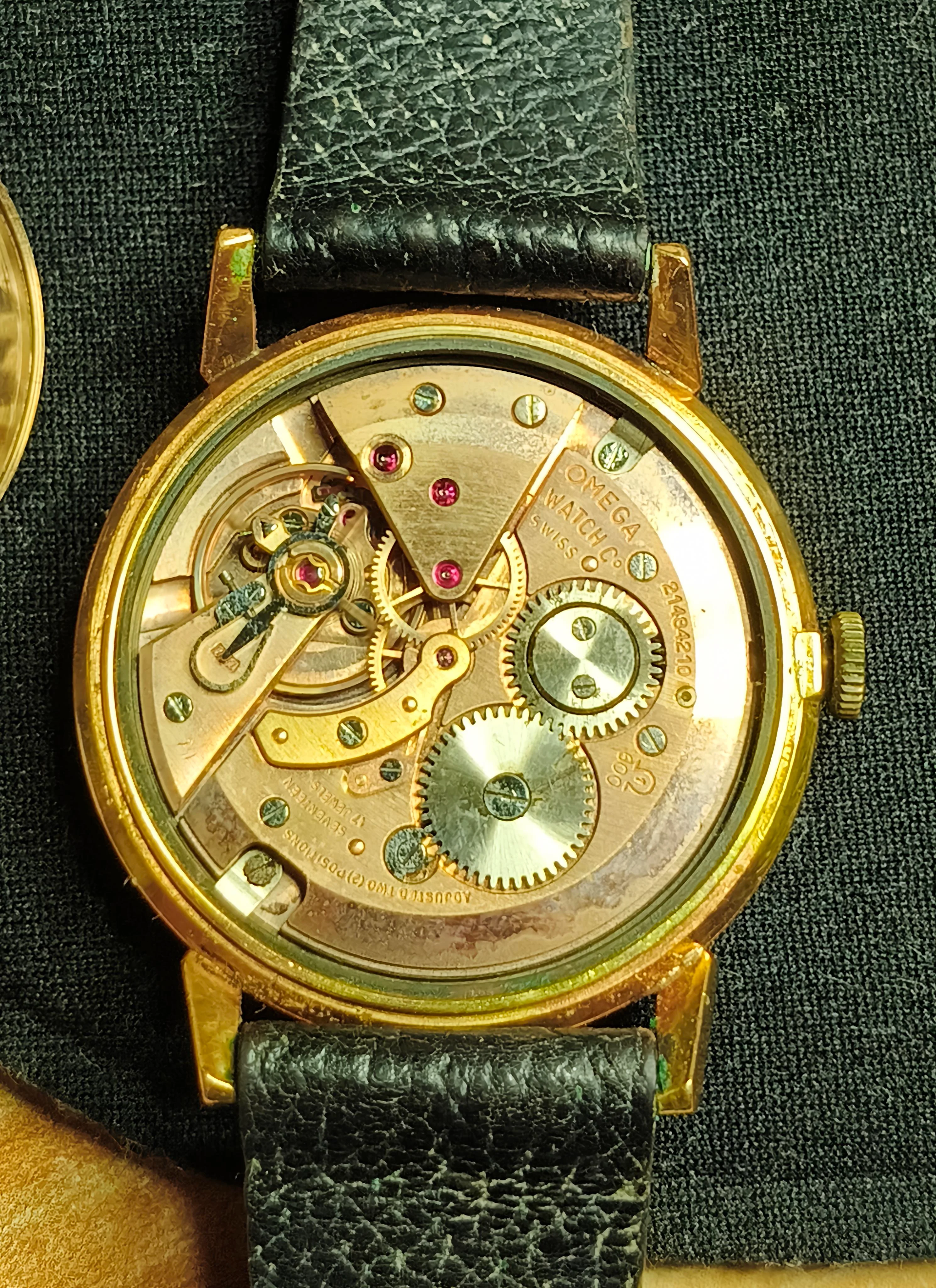

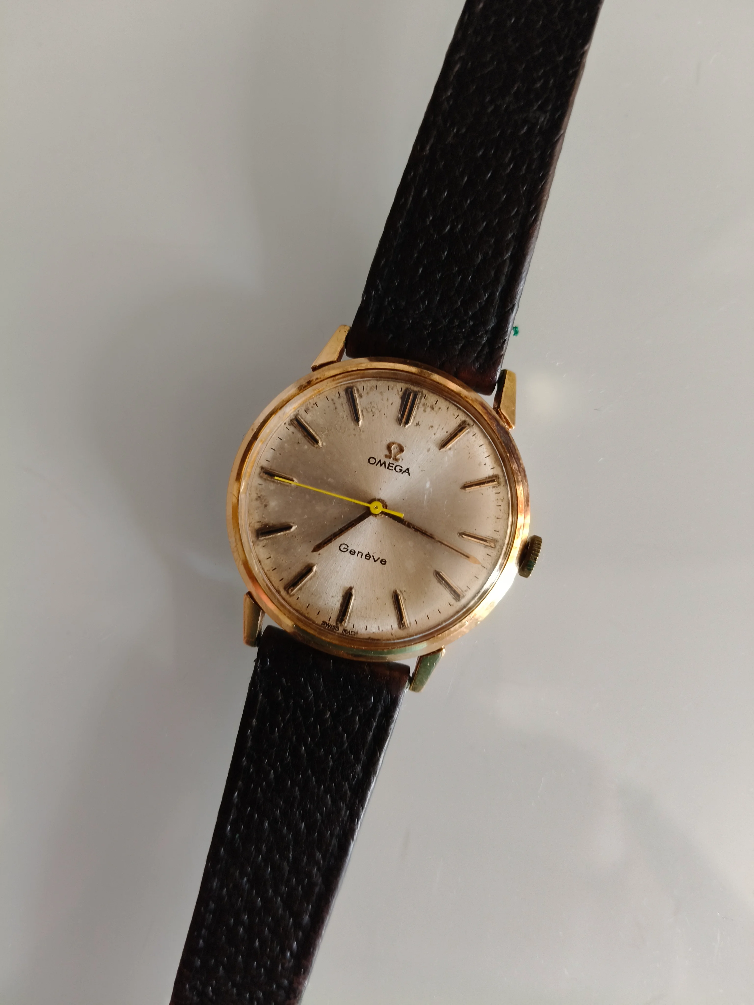

Tengo este modelo Omega Geneve calibre 600,17 joyas,ref,131019,oro 18kt,swiss made.
¿Es original?. Que tal para coleccionista.
Que precio puede alcanzar en el mercado actual.

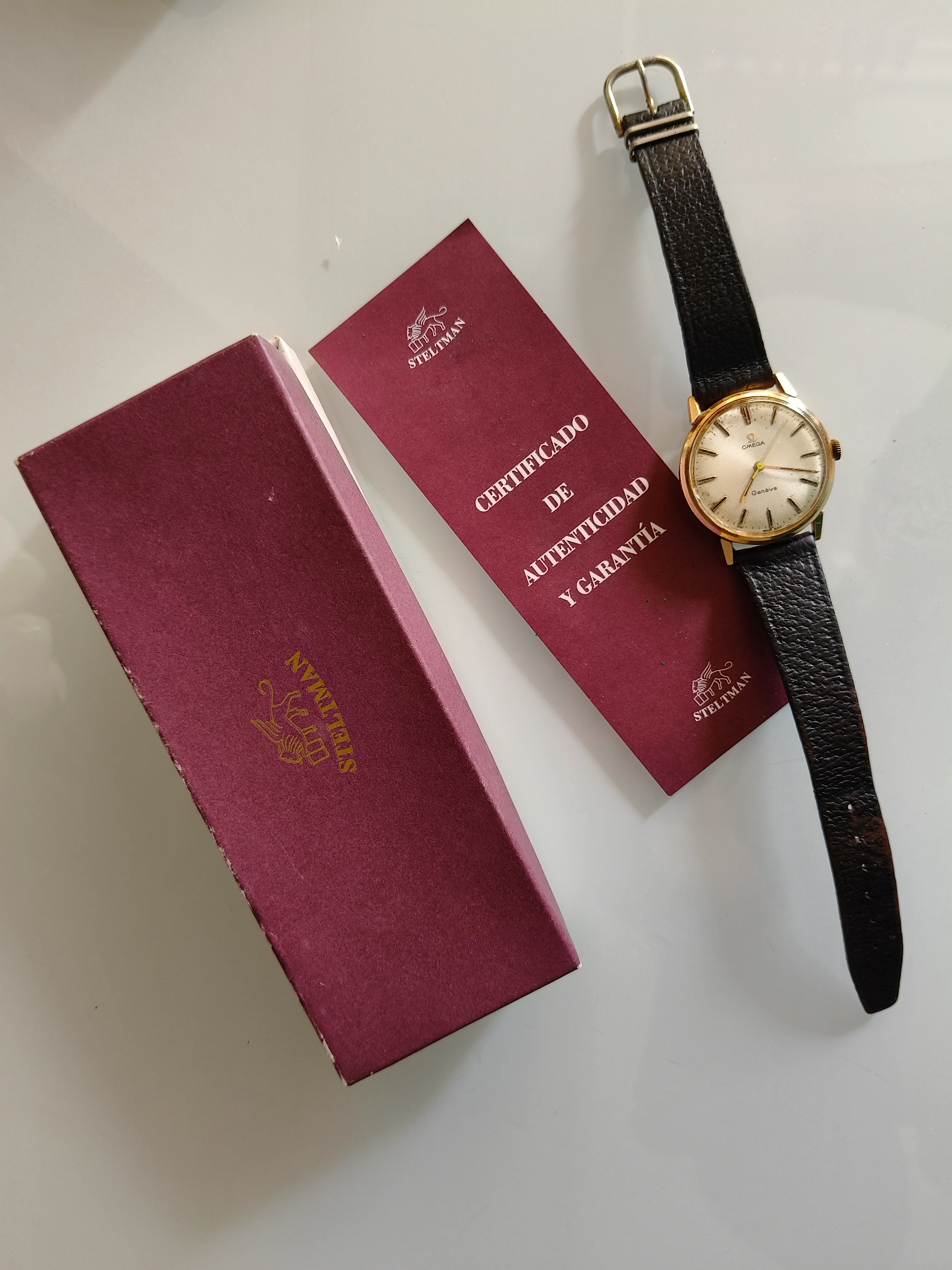

La caja es la que tenia de esa joyeria.
Fue un regalo de un cliente a mi padre.
Gracias
13,646
19,010
I have this model Omega Geneve caliber 600,17 jewels, ref,131019, 18kt gold,swiss made.
Is it original? How about for collector.
What price can it reach in the current market?
The box is the one I had from that jewelry store.
It was a gift from a customer to my father.
Thank you

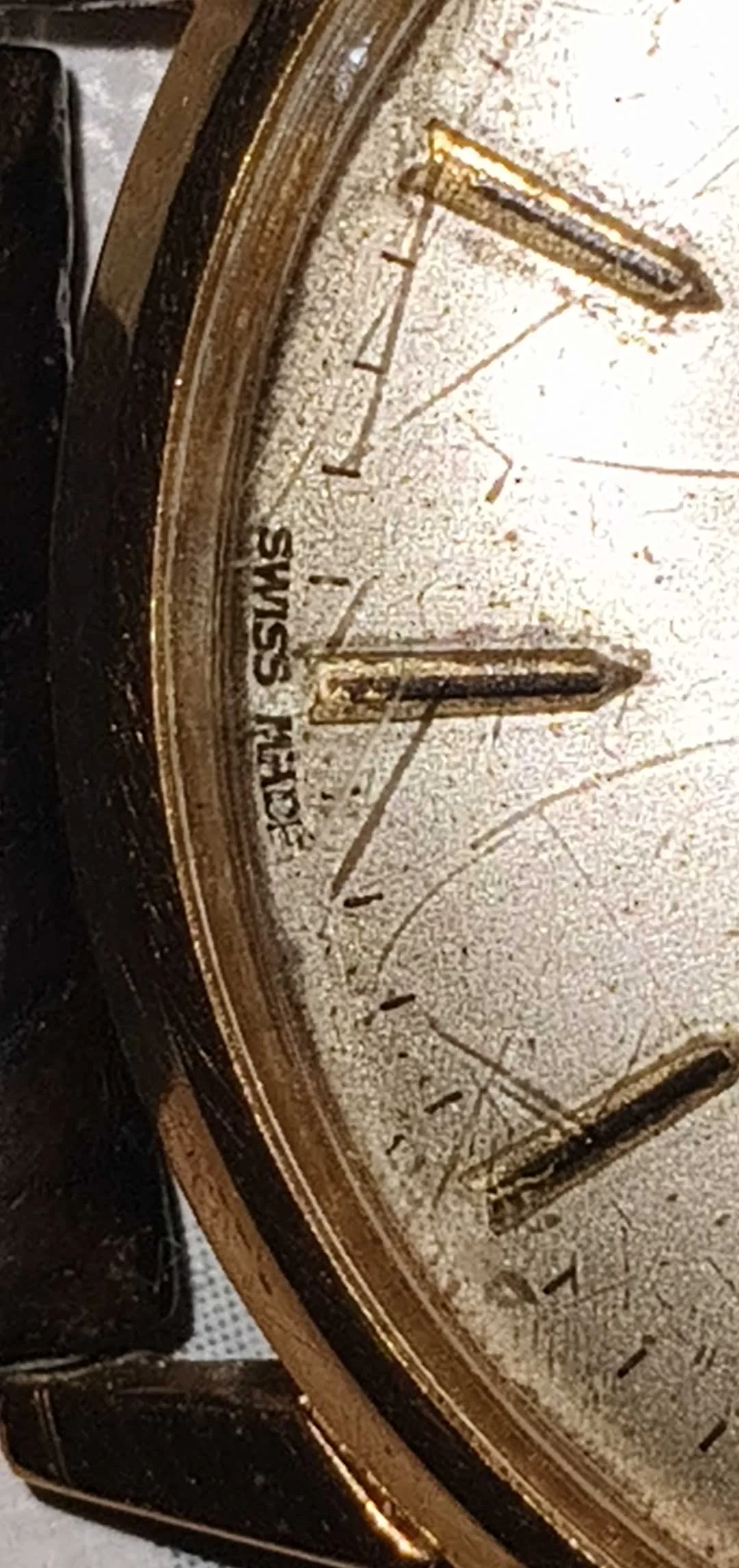

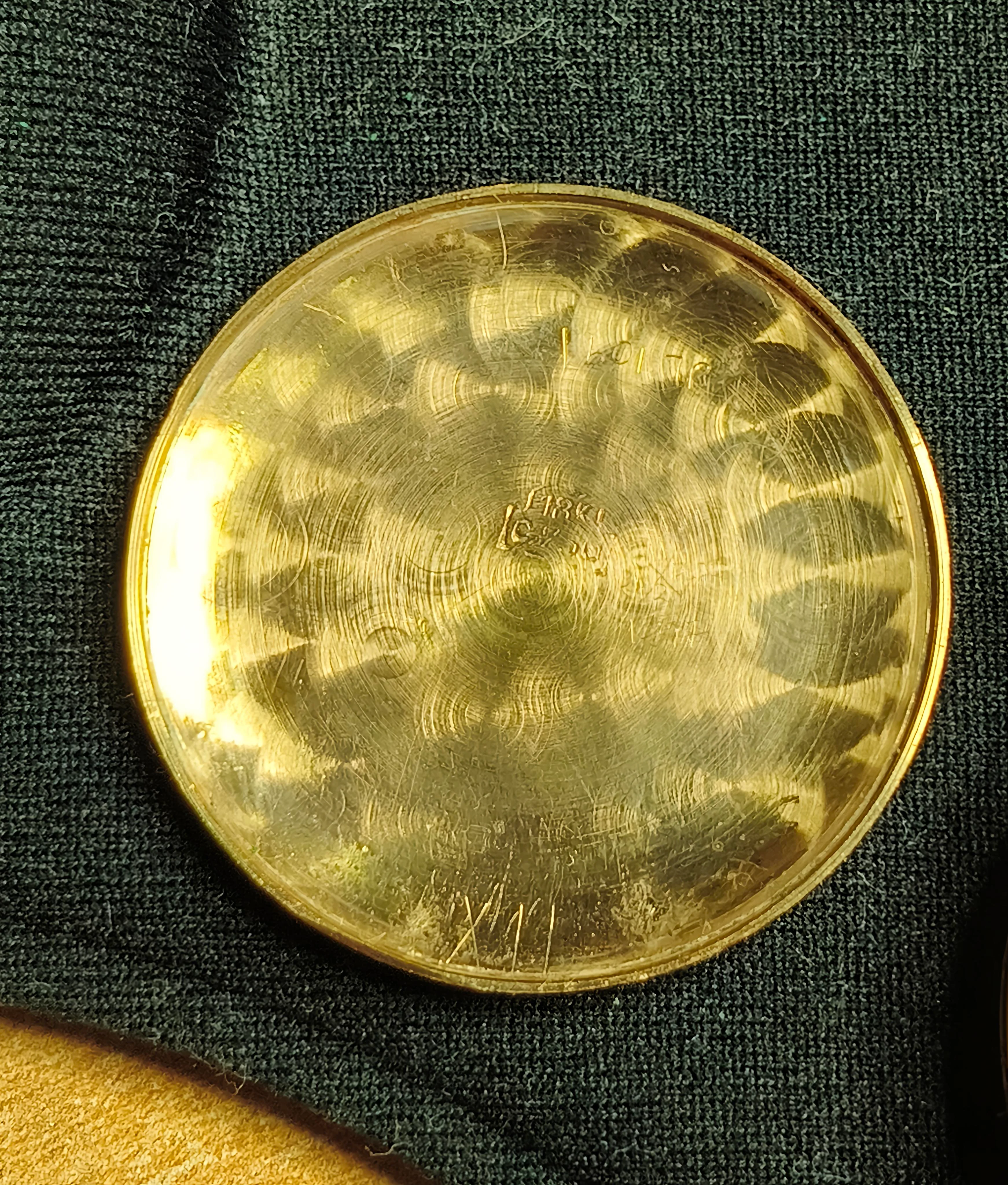

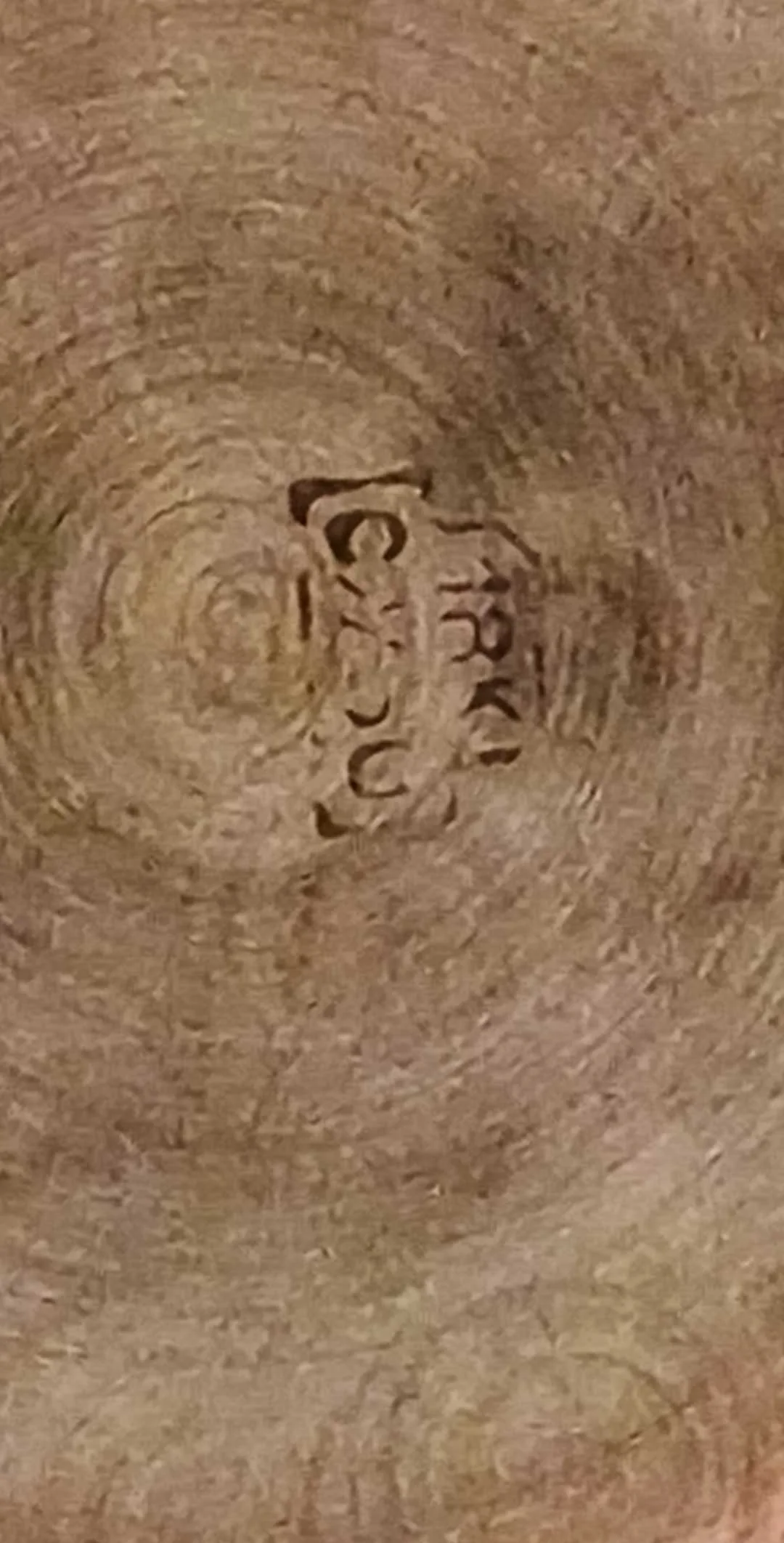

You will get far more responses if you use Google Translate to help you write your question in English.

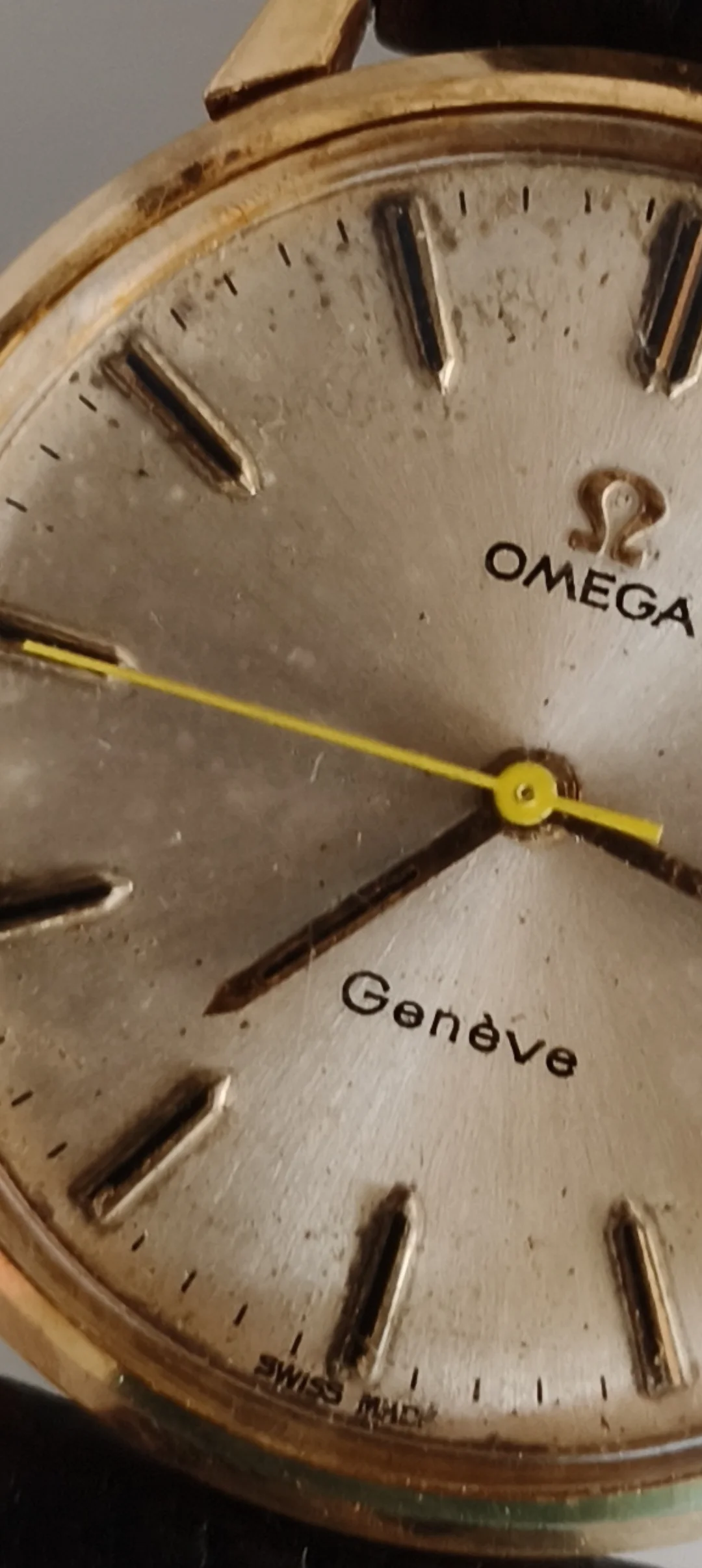

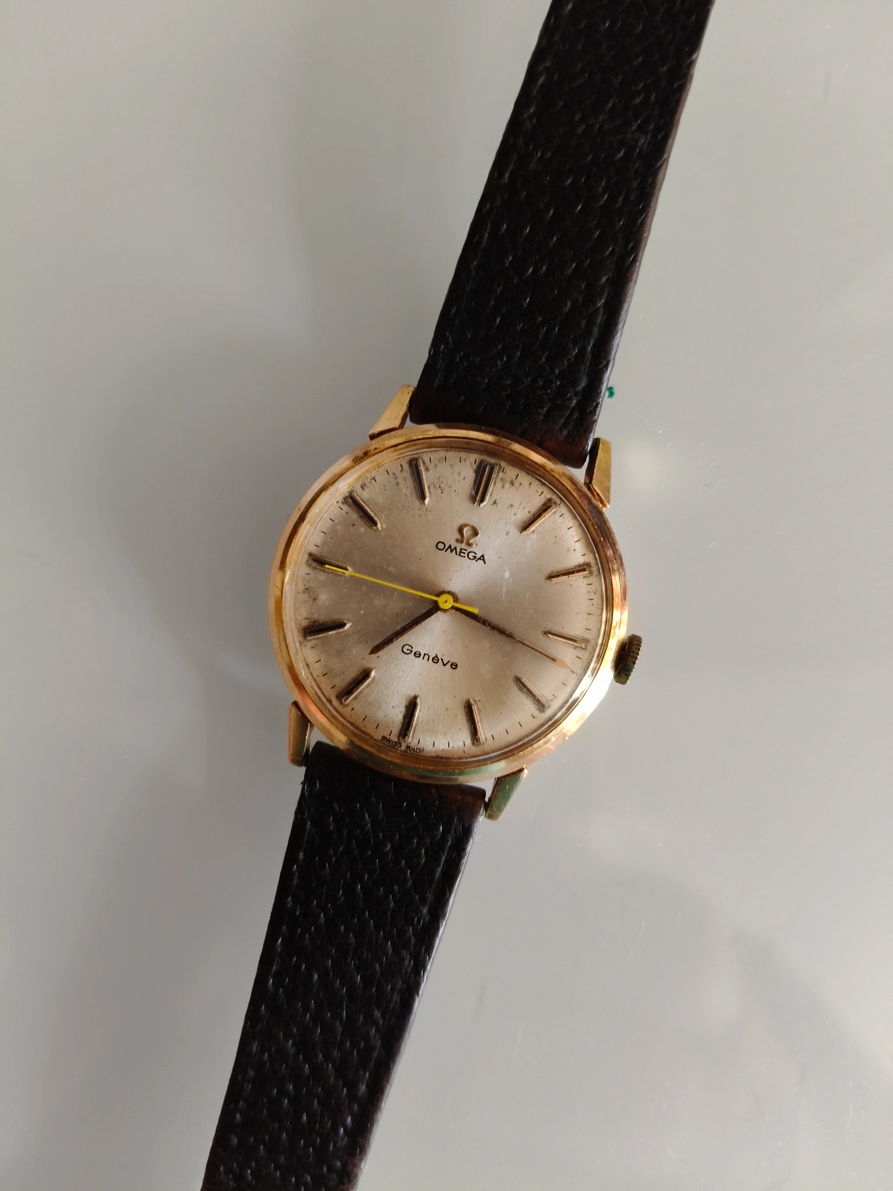

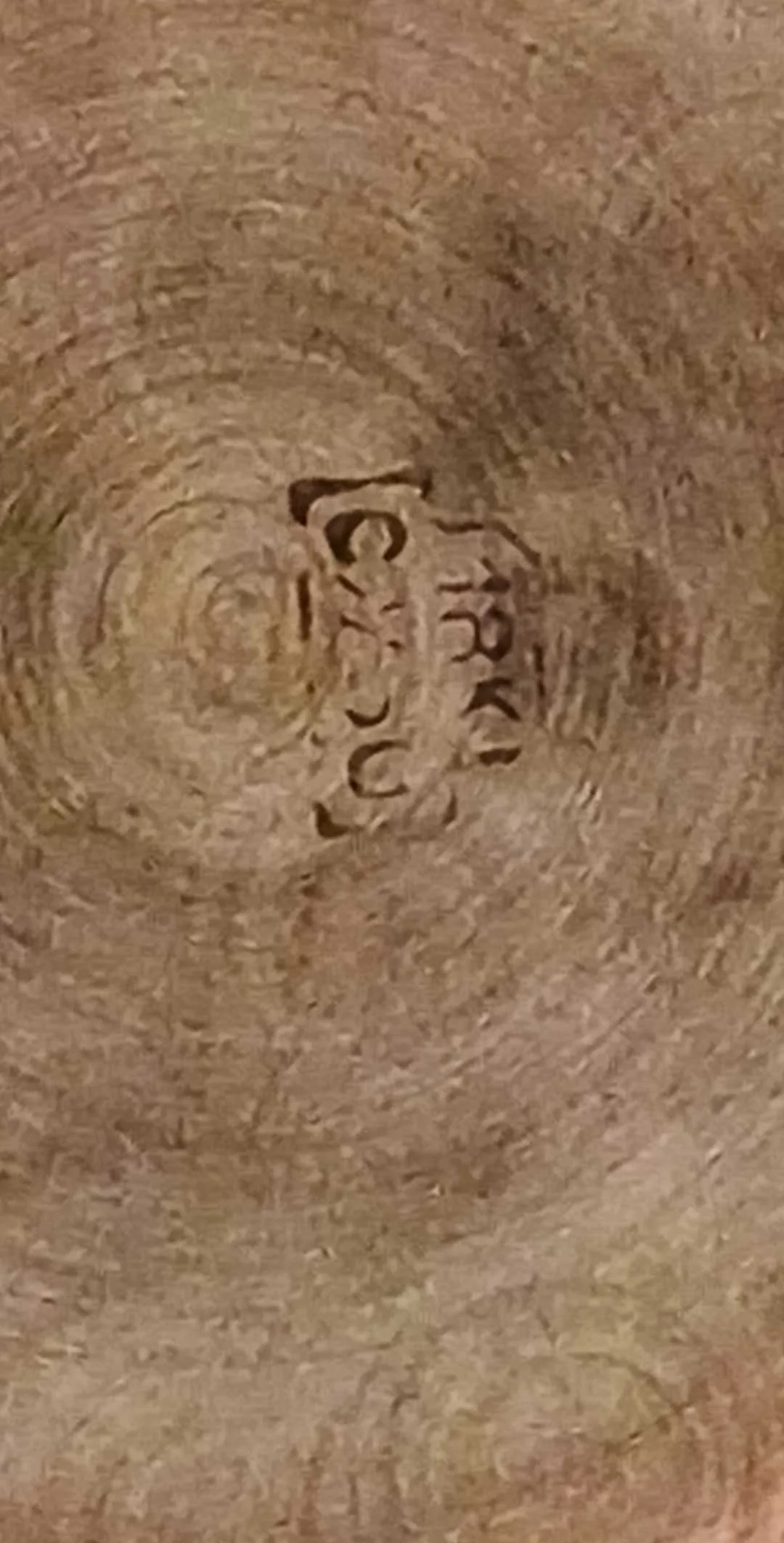

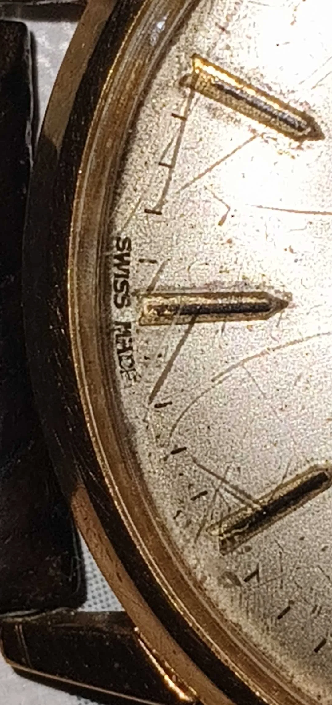

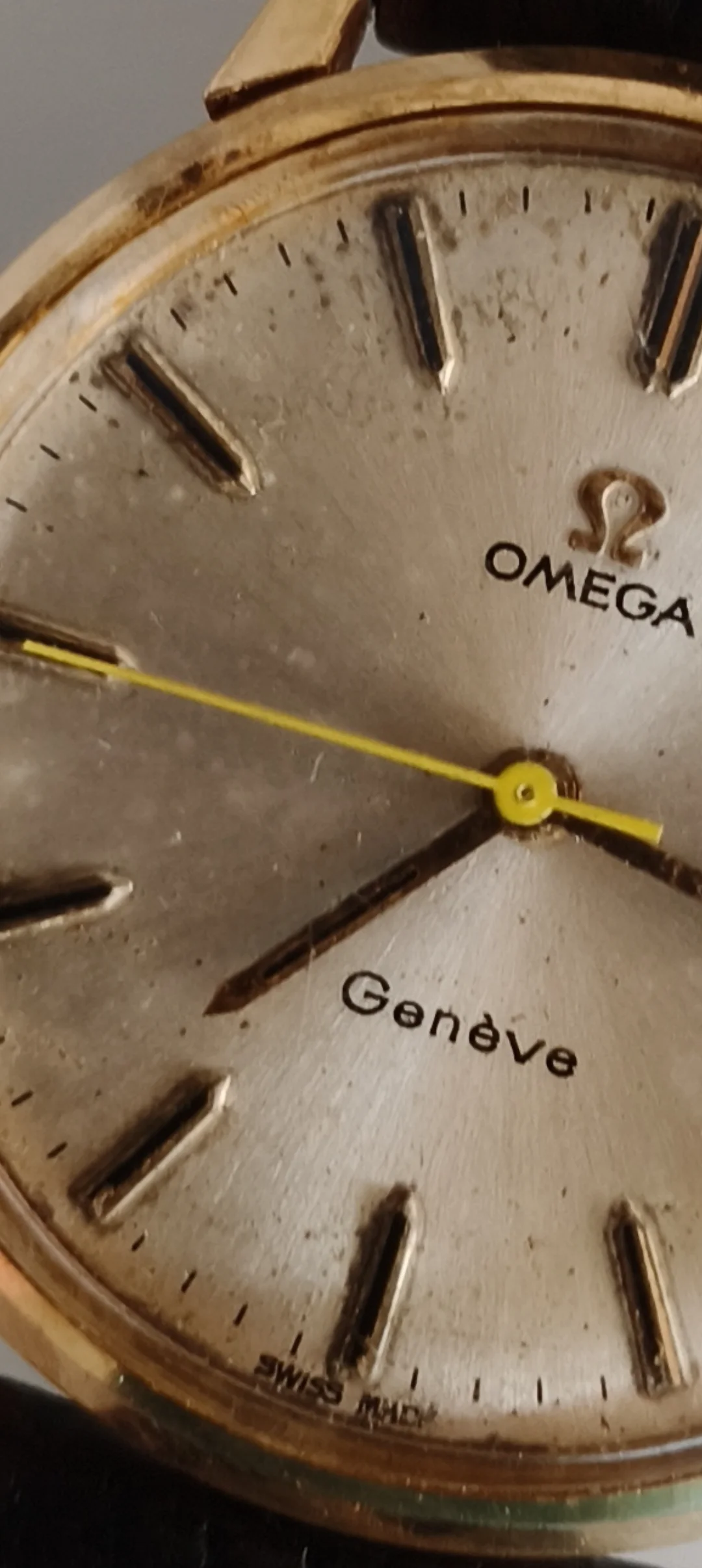

Your watch has a genuine Omega movement and what looks to be a South American (probably from Argentina) made gold case.
It was very common for jewelers to import used Omegas from other countries and recase them in locally made gold cases to avoid high tariffs. That’s what I think you have here.
The watch looks very dirty and the crystal is in poor condition. This can be repaired, but because it is not a fully Swiss made watch, it has very little collector value other than the value of the gold case.
Hope this helps,
gatorcpa
