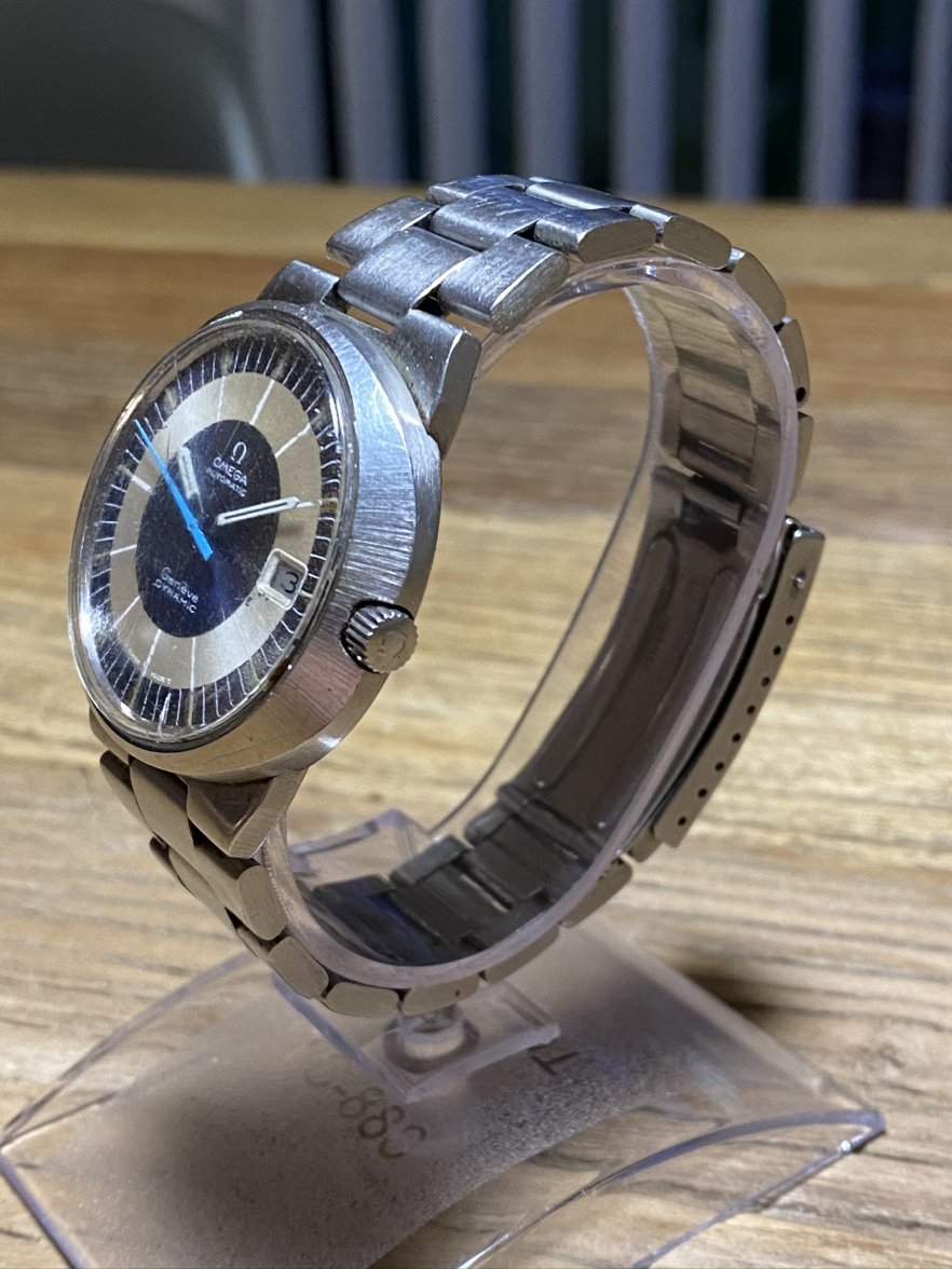

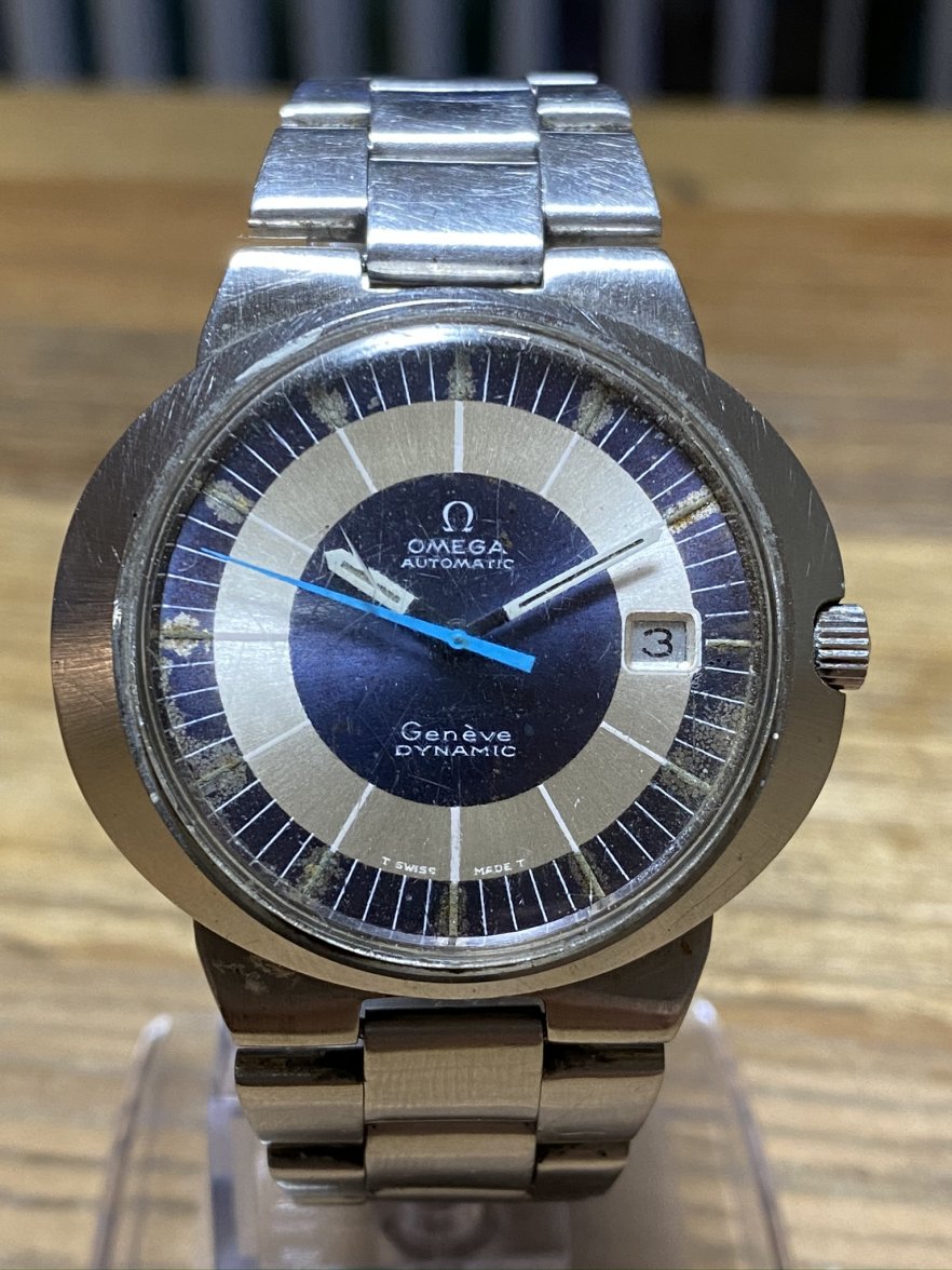

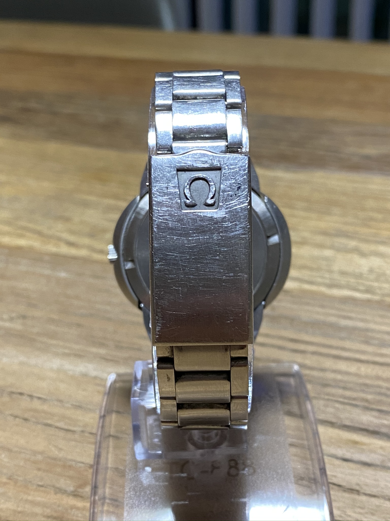

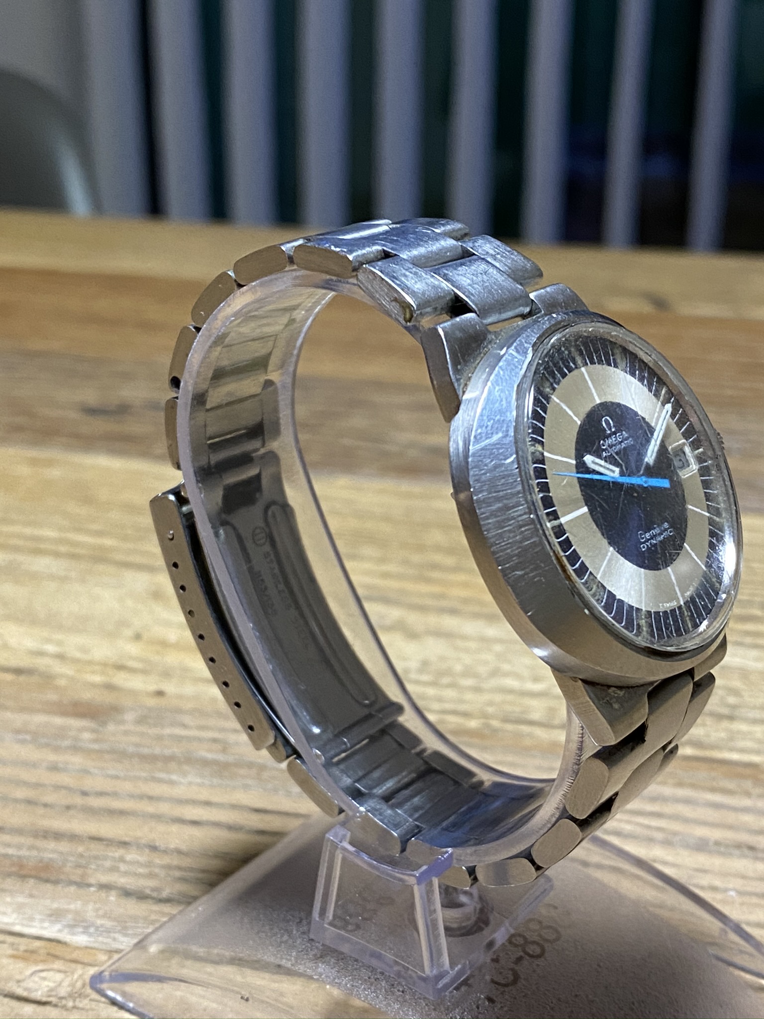

I inherited an Omega Geneve Dynamic from my dad.
The watch has great affection value for me and I therefore plan to have it refurbished.
Are there any, who have experience/good advice on where to start and where to end? I think the dial should be changed, maybe the glass should be plastered/changed and then a new strap.
I have been told by a watchmaker that it is a cal. 562/565 watch, so the parts I get should fit this. Do you know any places, online, where this can be purchased. Links and suggestions are received with great gratitude.

Hi Mikkel
It's a very nice memento and deserves to be brought back to life.
If you want it to look like new, then your best bet is probably to send it to Omega.
Other independent watchmakers can source the dial and crystal plus a bracelet/strap so, if you want some control over what is done, then say where you are and someone will suggest a watchmaker you can use. Don't try to buy parts, leave that to the person who will work on the watch.
It does look like a 550 series to me as well and these are well supported for movement parts so, it should be possible to bring it back to working well for everyday use.
Good luck, Chris

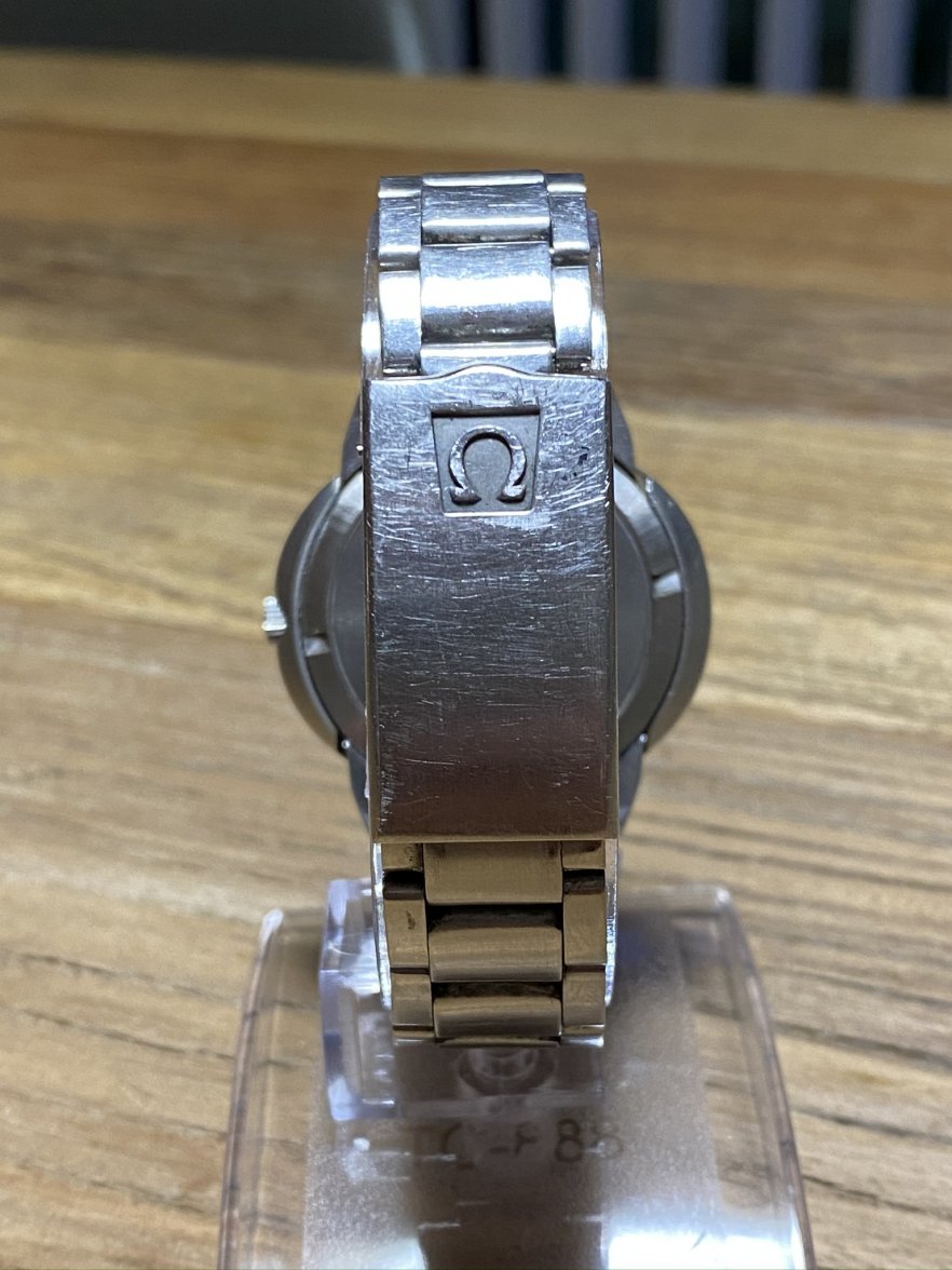

Why change the bracelet?
These watches need a special kind of bracelet which Omega doesn't supply anymore.
Finding a good aftermarket one is not going to be easy, especially a steel one.
11,076
55,570
You can find them everywhere but it seems 98% are fake.
Omega sells a bracelet that will fit this watch (and the adapter ring if you want to put a leather strap on it) but it's slightly different than the original version in that the center of the link is slightly wider. So you can't mix old and new bracelet parts 🙁
11,076
55,570

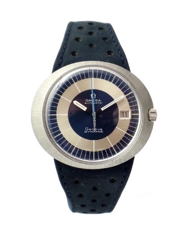

Dear All
You've given me a lot to think about. Initially, I had imagined something like the attached image.
But as I wrote, it is an heirloom so I would also like it as I remember it from my childhood.
If I send it to Omega, the minimum price is $ 1,834.90 😲

But do you think an independent watchmaker can make the dial look nice again? That is my biggest concern.
206
164
First of all have your watchmaker open the case and verify the calibre inside and the size of the dial and postion of the feet.
Then look in the for sale section of the forum and on the bay for a replacement dial. They can be found.
There's a seller in Italy who has two dials for sale right now. But just going for them without knowing what you need is not the right way of doing things.
They look OK to me but I'll leave it to the Dynamic experts to shed their light.
https://www.ebay.de/itm/Quadrante-O...256323?hash=item1f00bb3a43:g:as4AAOSwqwddaiMK
And it is possible to make an offer.
And as for sending it to Omega: forget the price and look around on the forum what people think of sending watches to Omega.
The consensus seems to be that watches usually come back from Omega with non period correct parts and heavily polished so they may look nice but have lost all their collectors charm and value.

As others have said, your most cost effective bet would be to find a donor dial from a parts watch or a seller with a minty stand alone dial. The dial on your watch would need to be fully refinished (which is probably a large chunk of the estimate from Omega).

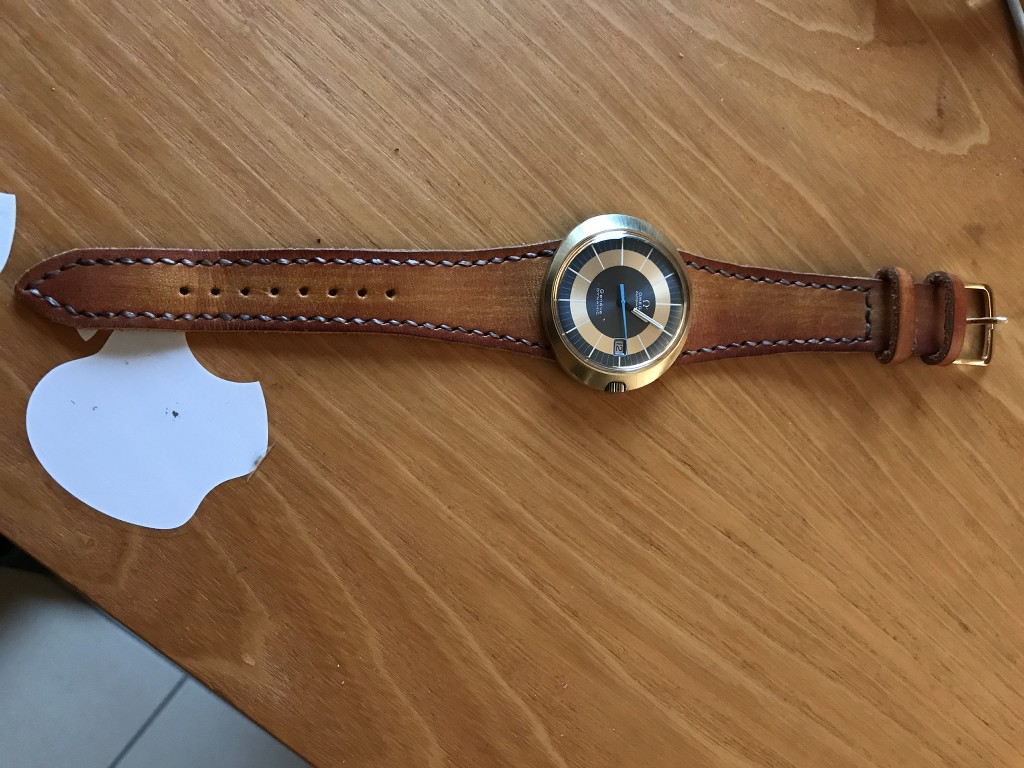

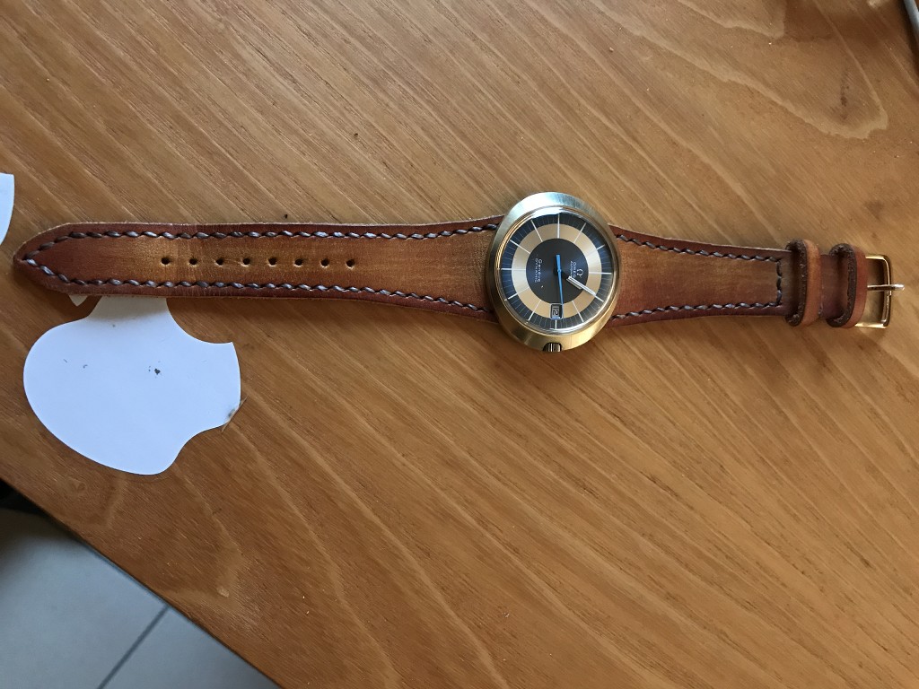

Hello !
Any competent watch smith should be able to service the movement, no problem !
To find a replacement dial is very possible, see eBay proposals. To replace or repolish the crystal is easy.
As to the leather band, it's true that the original corfam material bands from Omega are long gone .. but you can easily find a leather band for the Dynamic on eBay again (cheap .. something like 30.€) or you could go the way I choose and get a band made by MartuLeather :
