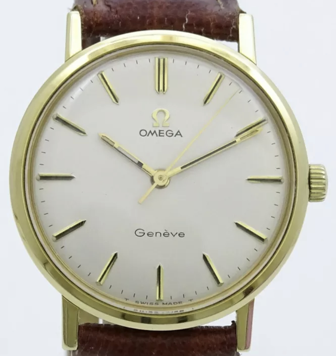

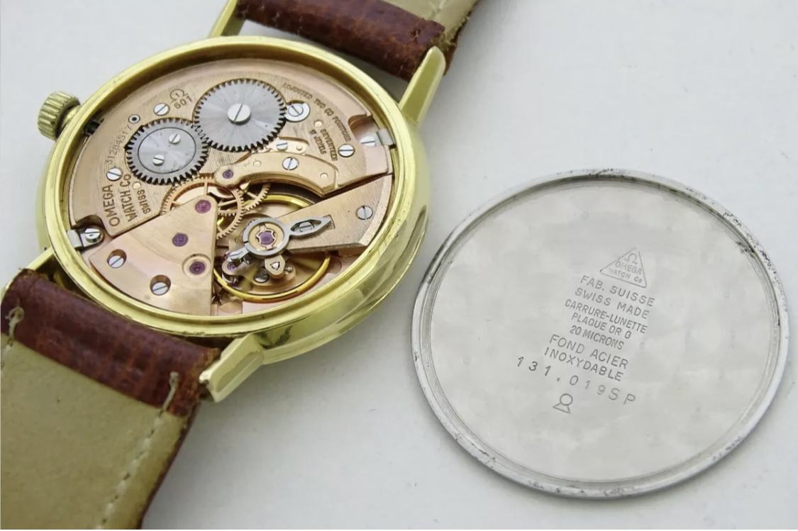

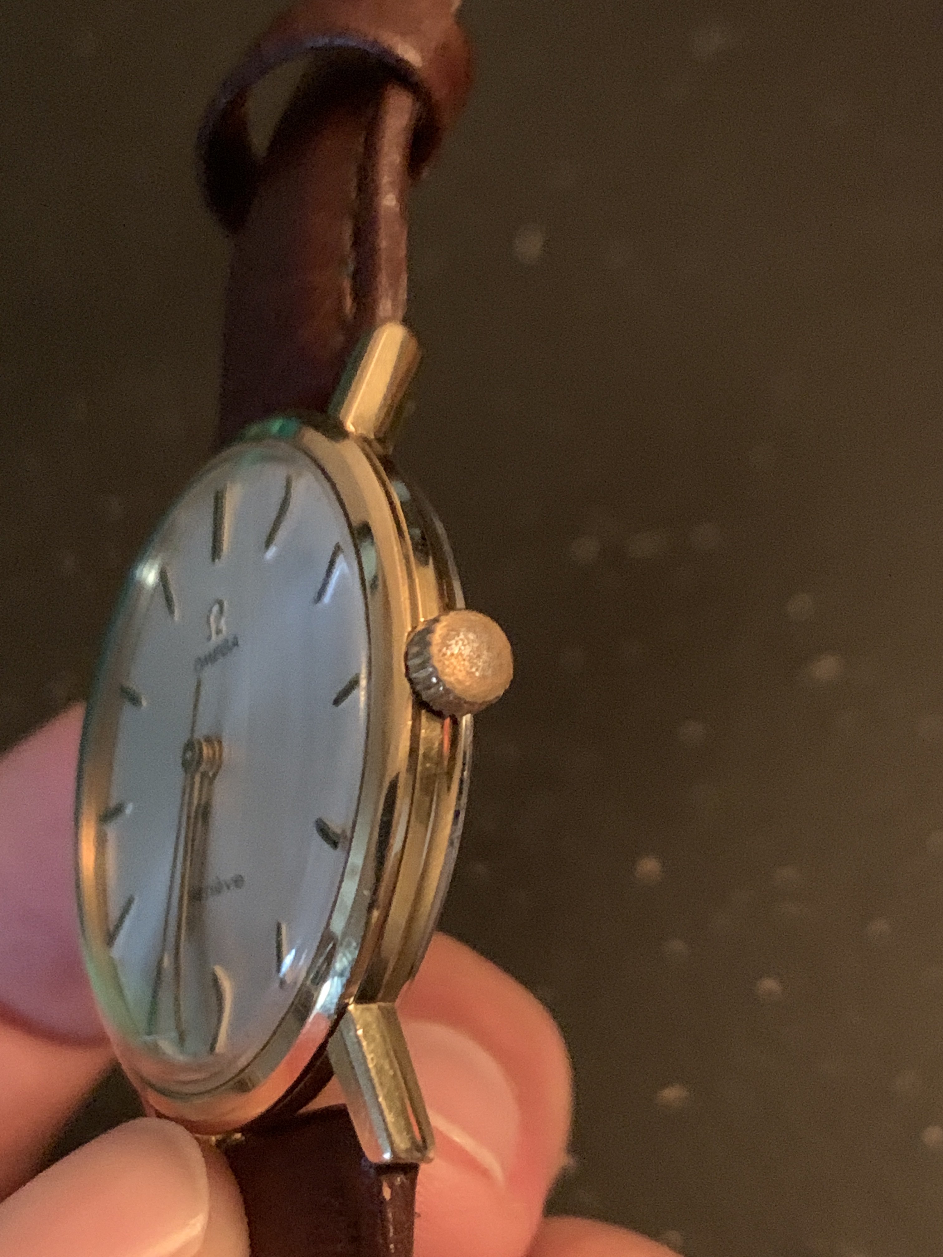

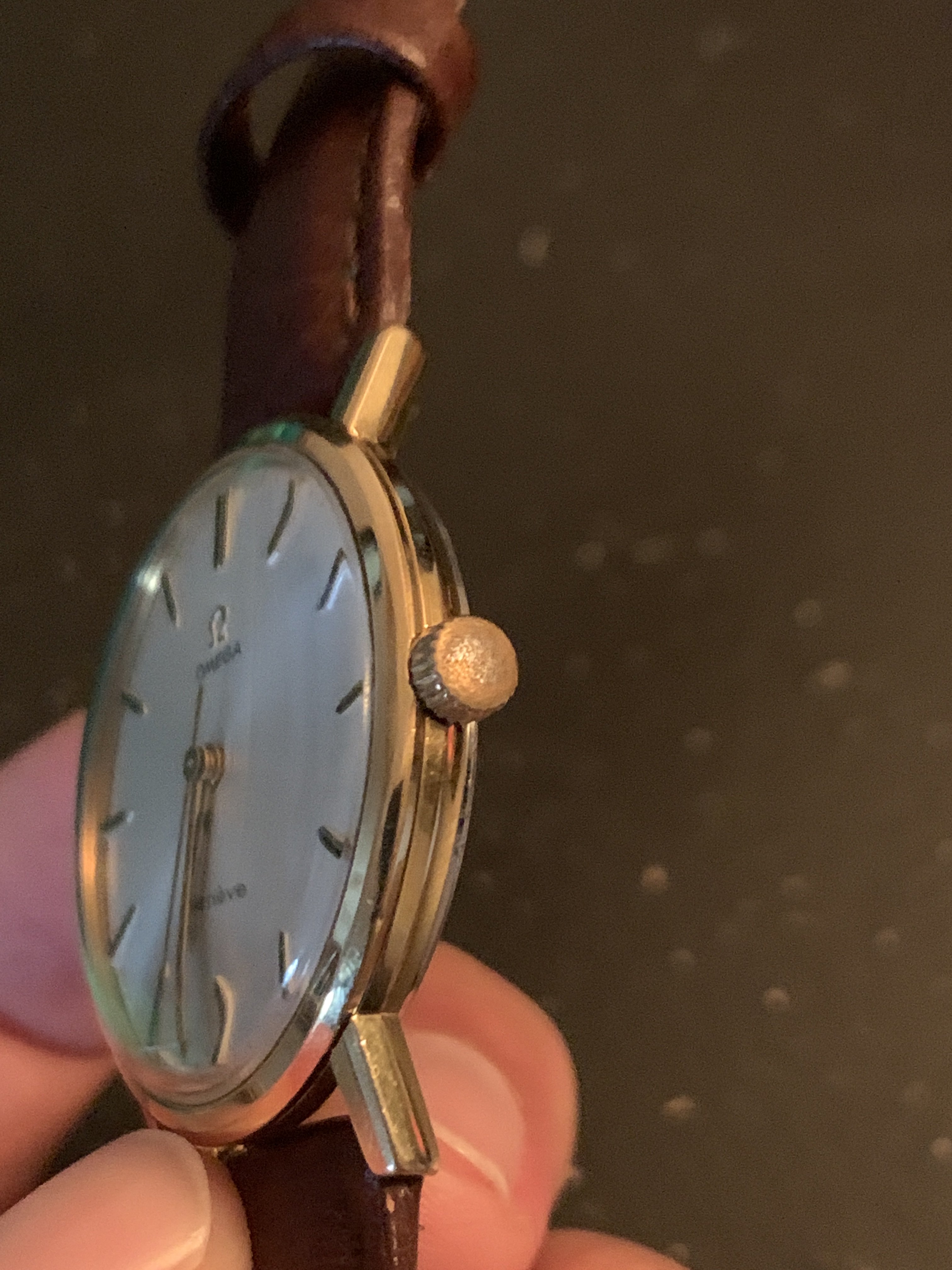

Hi guys I recently purchased a Geneve Cal. 601 Ref. 131.019SP overall good condition and running! The only thing I want to “fix” is the crown. Does anyone know the size, part number or variety from the time that would be a direct replacement? Thanks In advance!
195
493
The Omega Extranet shows 069NA32003 as the part number.
3
Thank you! Your awesome, It’s a little hard trying to get the exact part number on these. What’s the stem part number that would fit this watch? I found 1106. Is that correct? Again thank you!
195
493
1106 is the correct stem; full number:
72206001106
