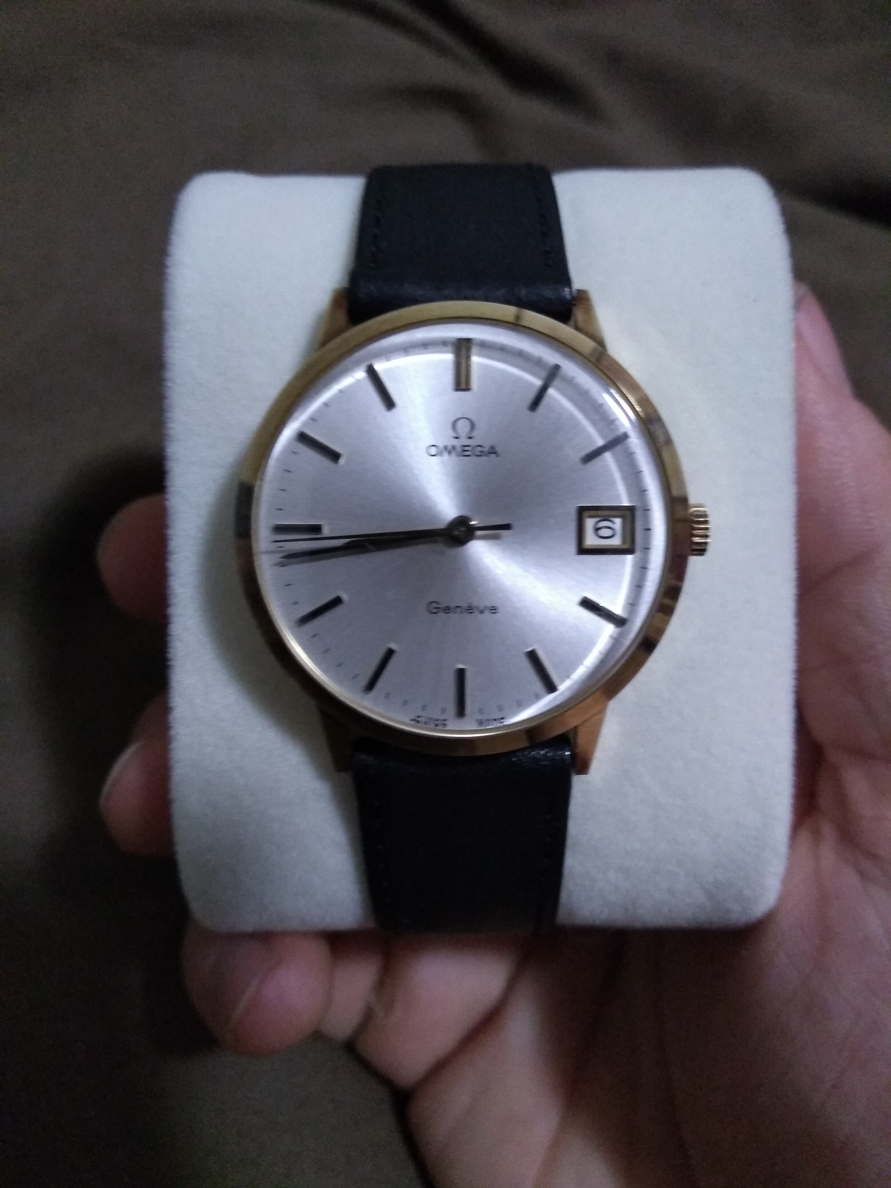

    Omega geneve from early 70s found in vault in original box with tags. Never worn. When I wind this watch it runs smoothly, winds smoothly, but the crown never gets tight. Essentially it feels as if I could wind this watch forever. Is this normal? Most of my manual winding watches will get taught on the crown telling me that I do not need to wind anymore

    I would guess a broken mainspring if the watch isn't an automatic, and I can't see anything on the dial to indicate automatic.
    What are the reference numbers in the paperwork?
  3. Logangoldfish Jun 23, 2019
    15
    The watch winds just fine. The crown just doesn't get tight like most watches. I wouldn't think it's a broken mainspring. The caliber I believe is 1481

    Caliber 1030 is a manual wind, and unless Omega retained an automatic mainspring from the parent 1020 caliber, and if the watch winds continuously without resistance, I would say it's a broken mainspring.
    I think I have a 1030 somewhere, I'll check it out.

    Thank you. It winds with resistance, what o mean is that it doesn't max out. Like with another watch I can wind it and eventually it'll want to stop. This one however seems to act like an automatic wind. I'll wind and wind and it'll tick and click hard and strong.
