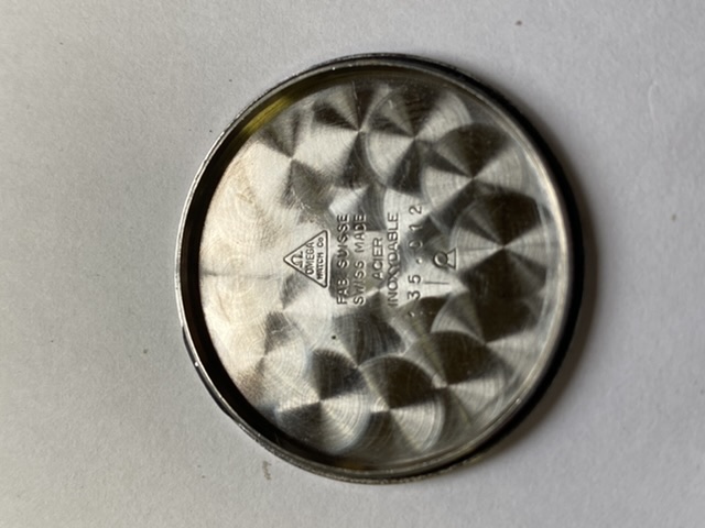

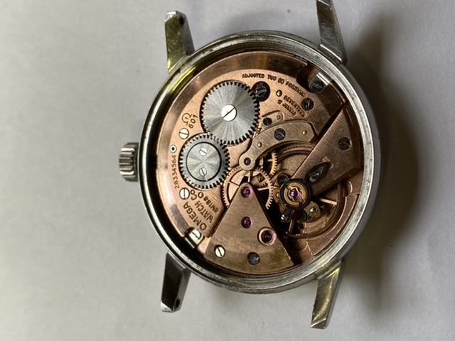

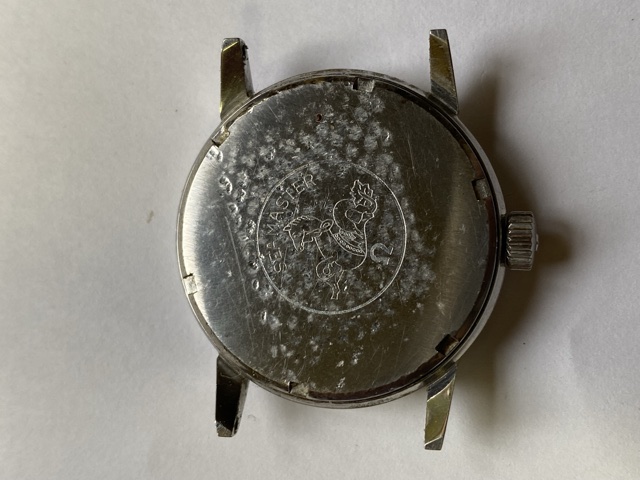

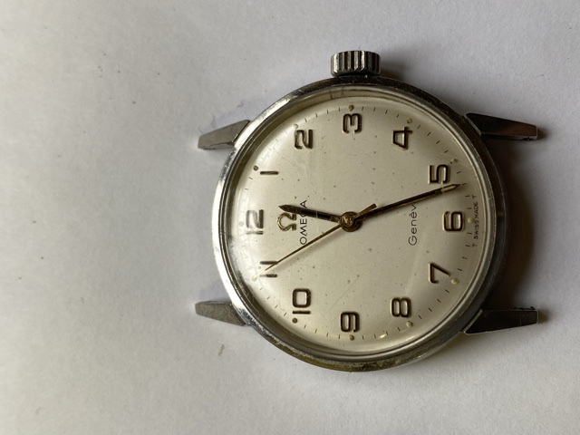

Have tried to find a similar watch online, know it is a 1969 with cal 601 bougth new by owner i got it from, has had the seamaster backlid whole time can seem to find mutch info on this has had a nylon strap that has made marks on the back lid all info apritiated

We can’t really give you much more information than that stamped on the inside of the caseback. The reference number 135.012 only refers to the specific case so there are many different dial variants to be found for that reference. All Arabic numeral dials are uncommon but not rare and it’s not unkommon not to be able to find an exact dial match on the internet.
Valuewise: the caseback is well worn but the rest of the case seems somewhat unpolished. Later but original Omega crown and perhaps Omega signed crystal (hard to tell). The dial is of course the real drawback at it is quite heavily patinated (or damaged depending on if you are asking the buyer or the seller). Your name would suggest that you live in Norway so we have to price according to that. I would say around 350 euro (maybe 400 with good pictures) if it runs and keeps time.

"Runs good" has me worried here. It is a genuinely decent watch and the dial is reasonable. Likely it deserves a service.
Watches will run with dried out oils. That does not mean they should be, and damage often results.
