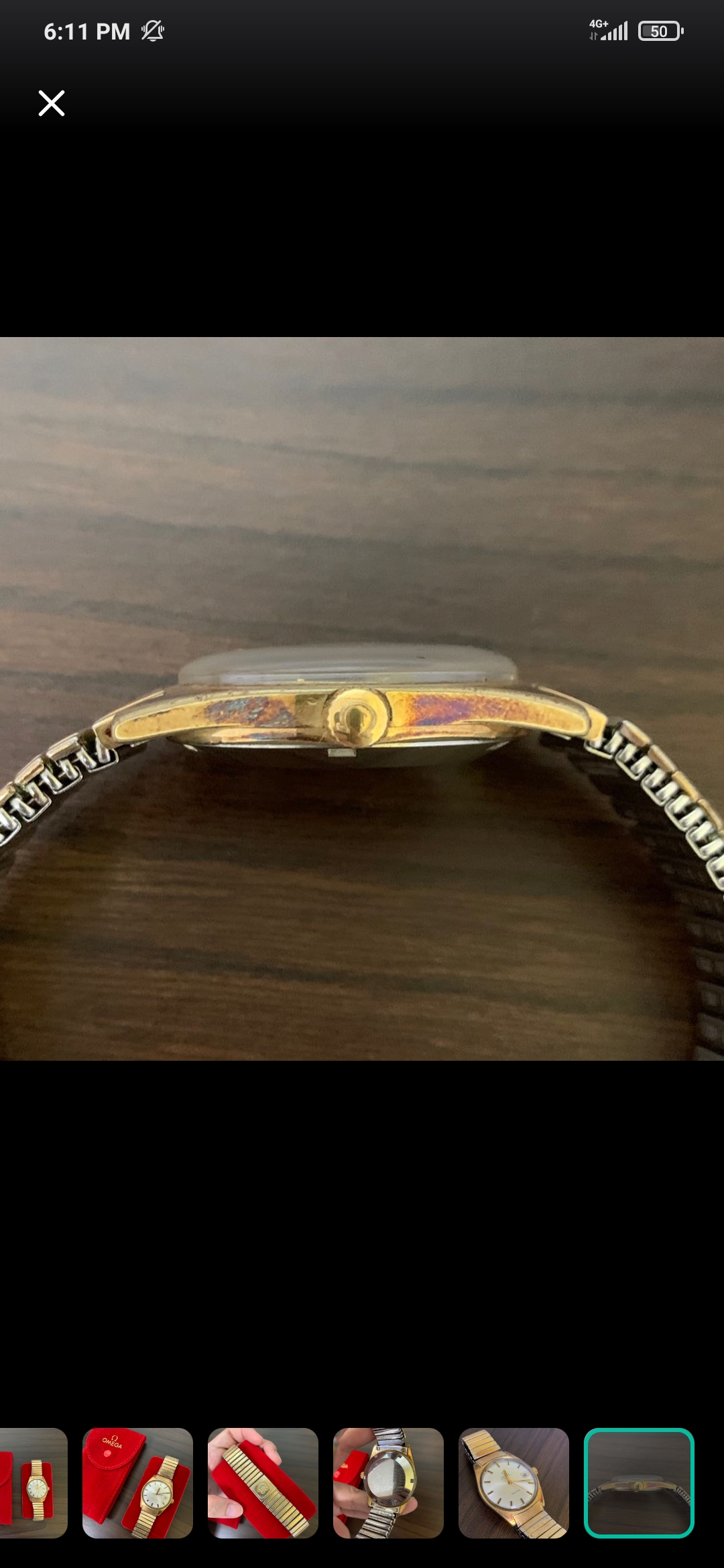

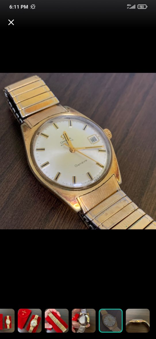

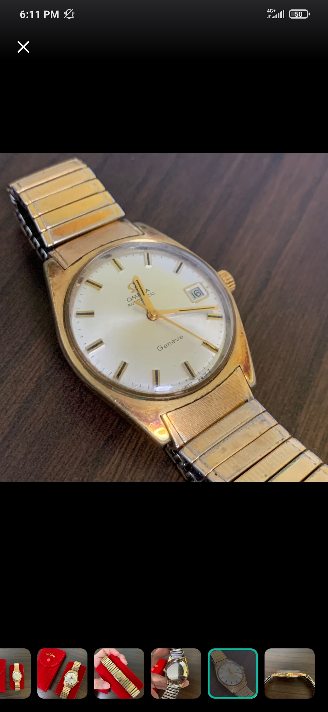

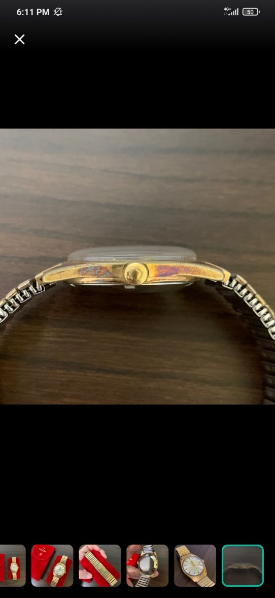

Should I get this omega? Seller provided photo
Reference: 166.041 with OEM Omega Fixo-Flex bracelet (558 end-links)
Case Material : Stainless Steel
Case Size : 34mm w/o crown, 37mm with crown.
Movement Caliber : Cal. 565 automatic w/date
Movement Serial : 30,XXX,XXX
Year of Production : ~1970
Functionality : Winds, sets, and runs and keeps time for vintage piece.
9,365
78,383
The photos are very poor and there are no photos of the movement. You should post more and better photos. Also it helps if you disclose the price. Frankly, looking at the photos you have posted, no one here will be interested in beating you to this watch.
The dial may be okay but hard to say with your photos. The gold plated case is, at best, very tarnished. The hands and crown may be okay.
If the seller has taken as much care of the watch as he has of his photos, you’ll need to factor in £100-130 for a service.
So, if the seller is asking £200 or less, it might be worth taking a chance and buying it.
A perfect example, and yours doesn’t look it, might be worth in pristine condition, about £350, £400 tops.

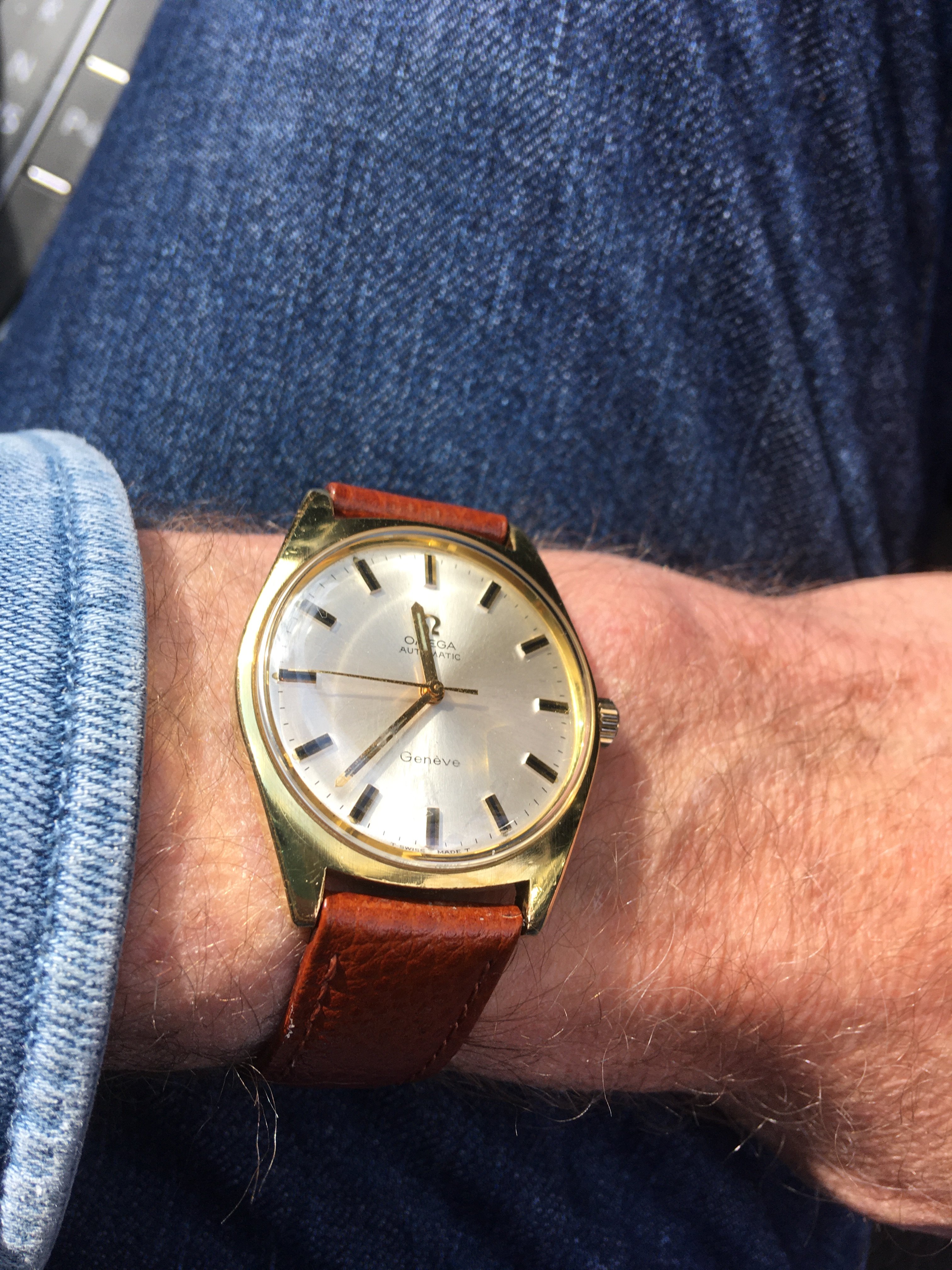

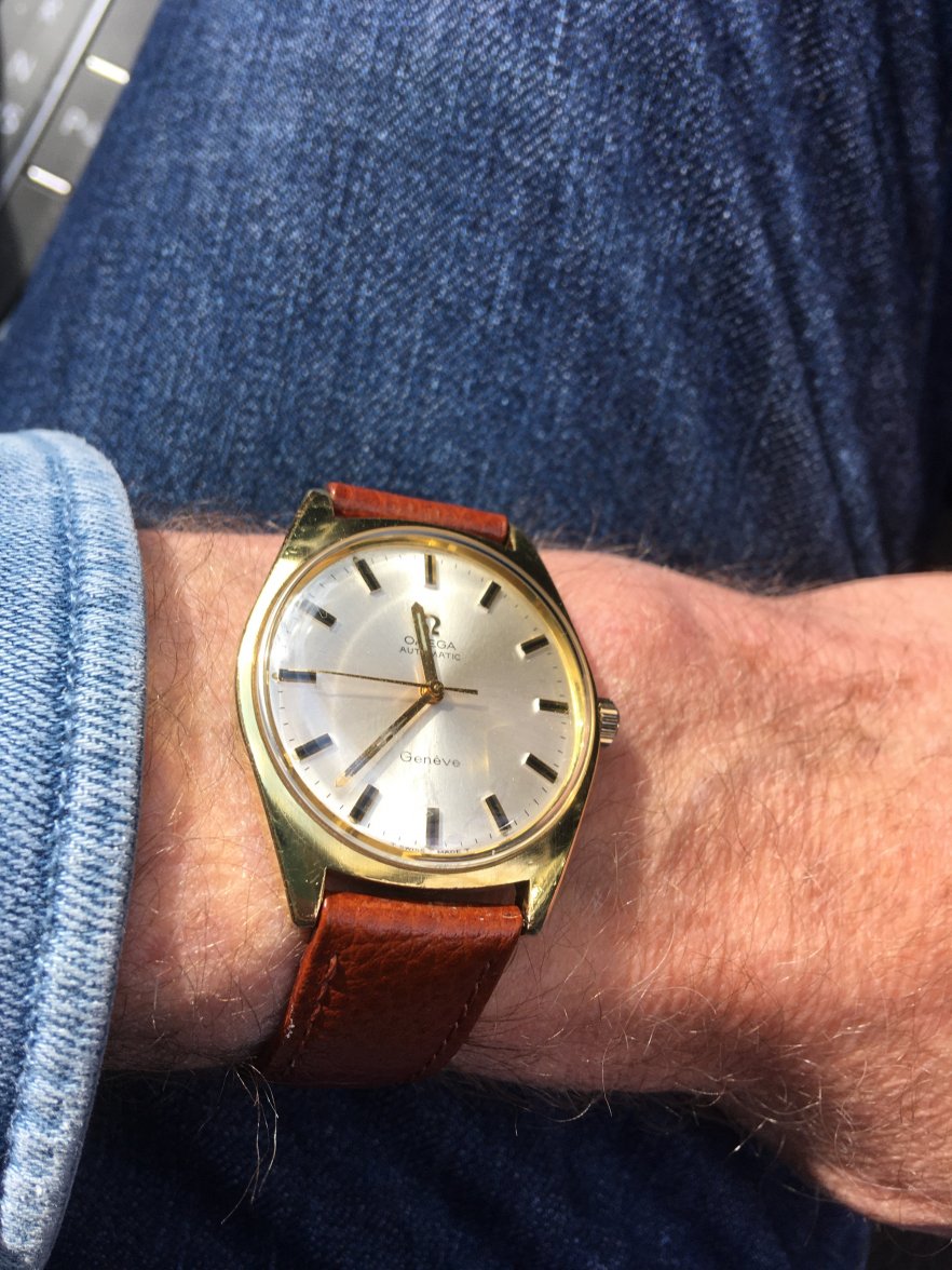

This is mine, for you to compare, with a 552 movement and serviced within the last year or so, probably worth £400

Thanks, you have answered my queries! Lovely watch you've got!
