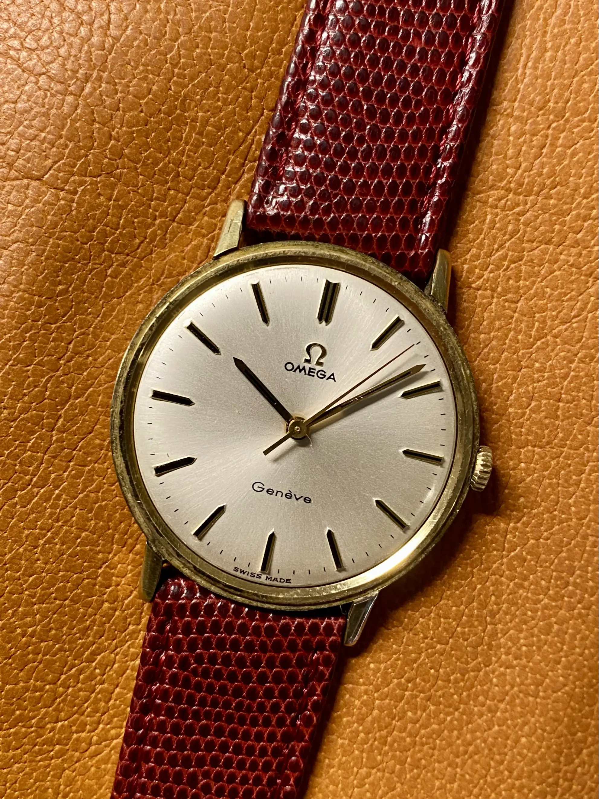

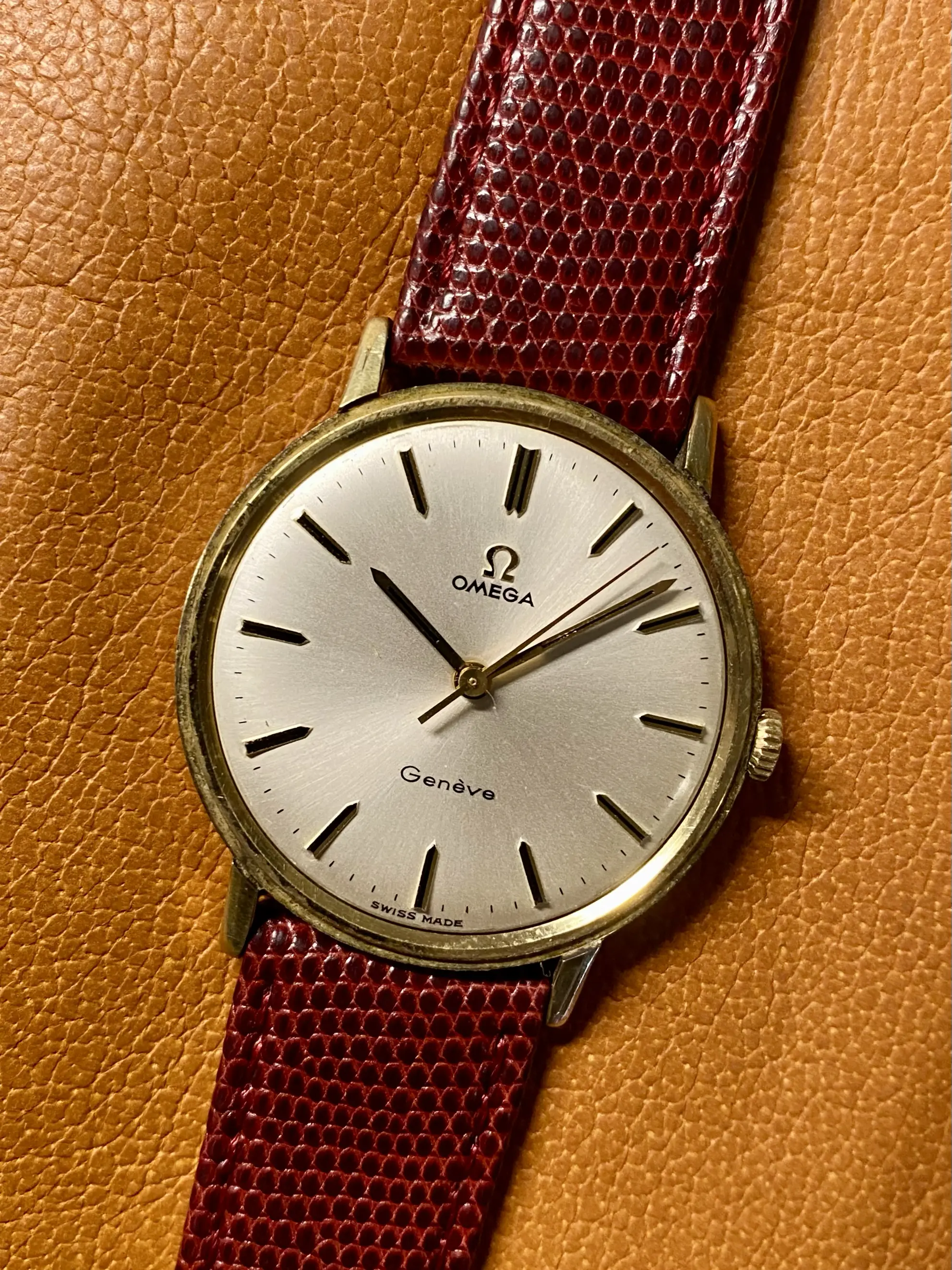

Anyway, I was asked today for my opinion on the Omega Geneve 131.019 SP that is the subject of this thread. I’ve never owned aGeneve, but I was able to compare certain aspects with some Seamaster De Ville and Cosmic (or similar) models I own.
Right away, I labeled this watch as a fake, thoughcertain elements still catched my curiosity. Here are my initial impressions and assessments:

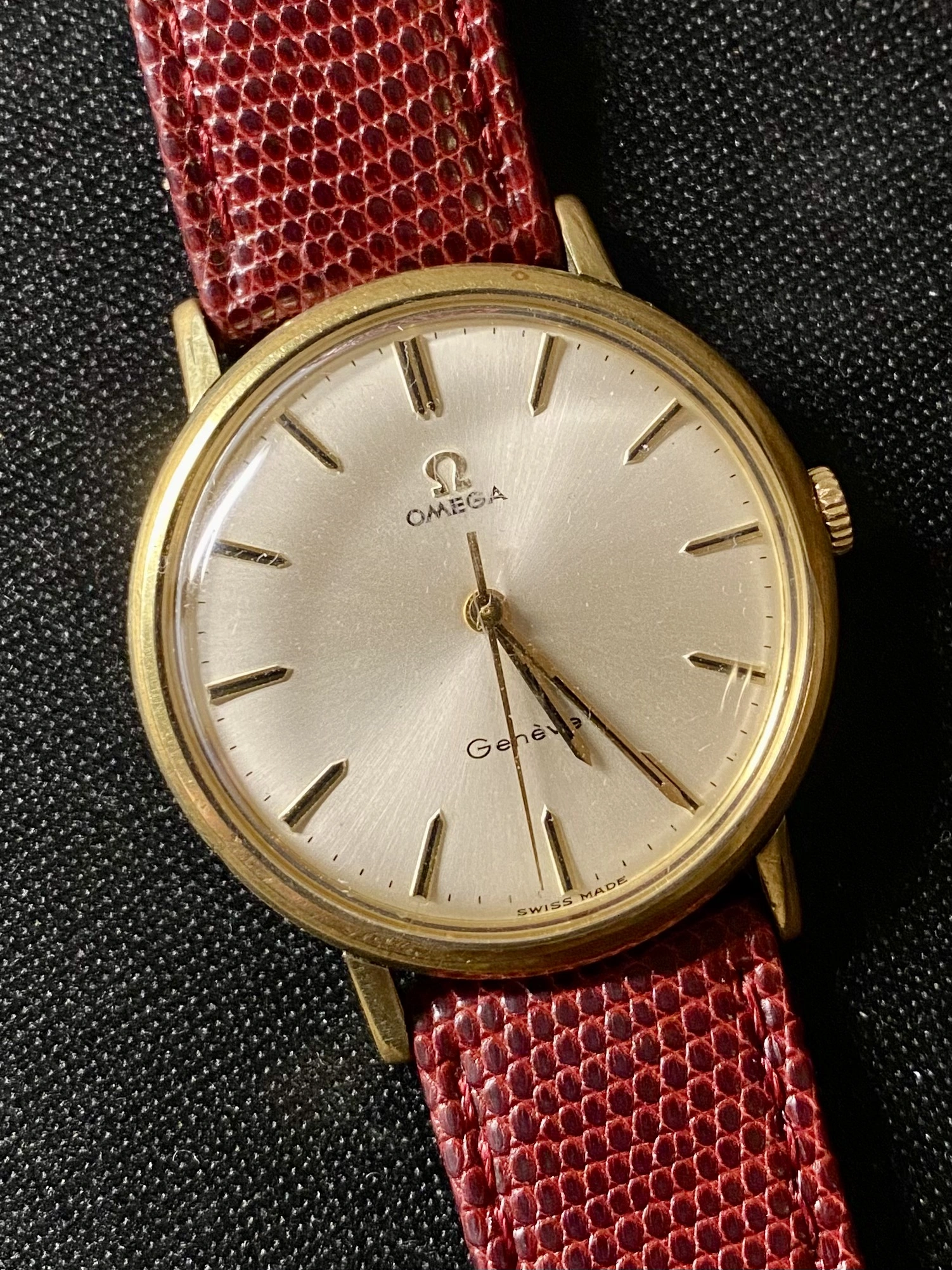

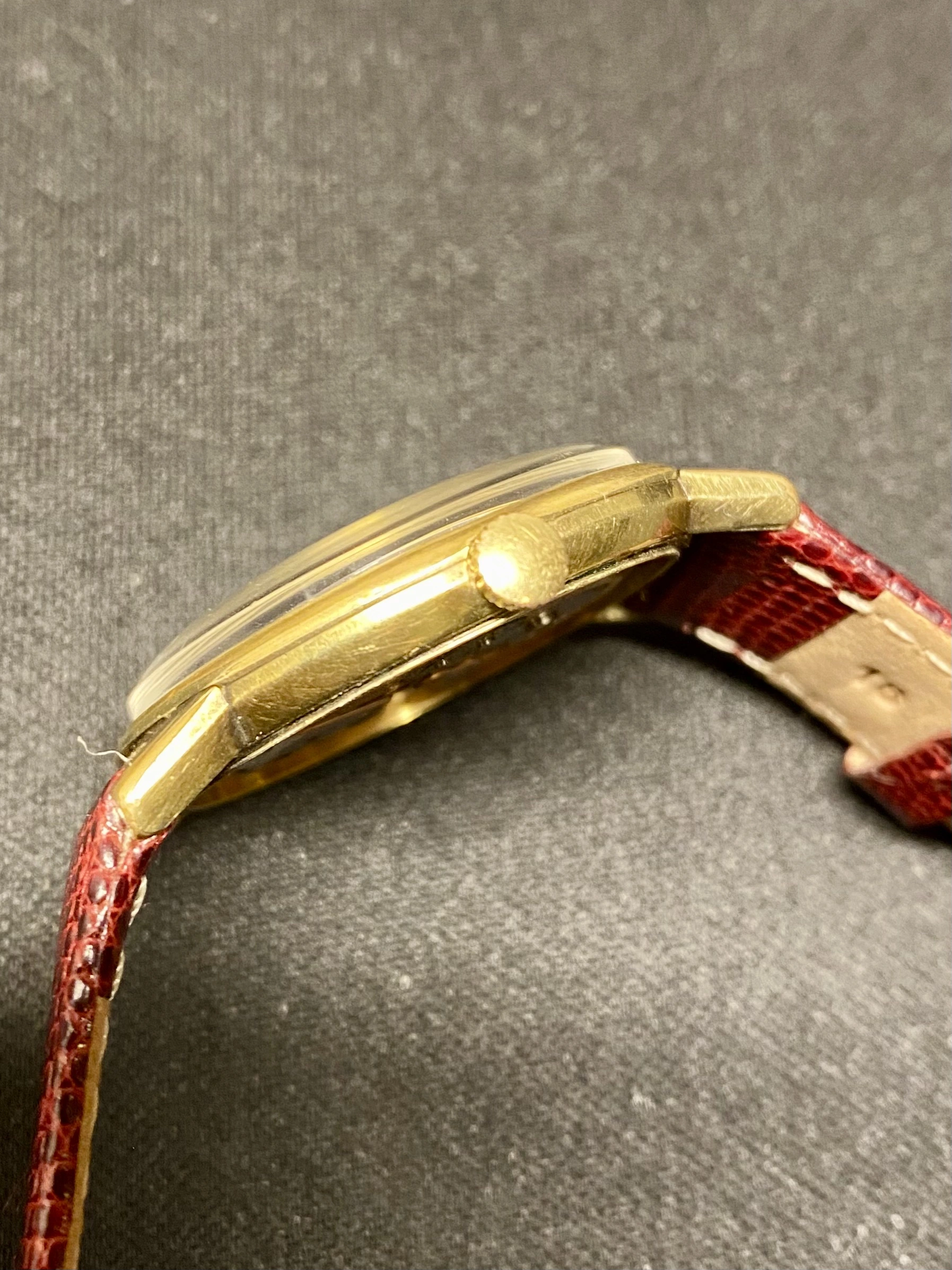

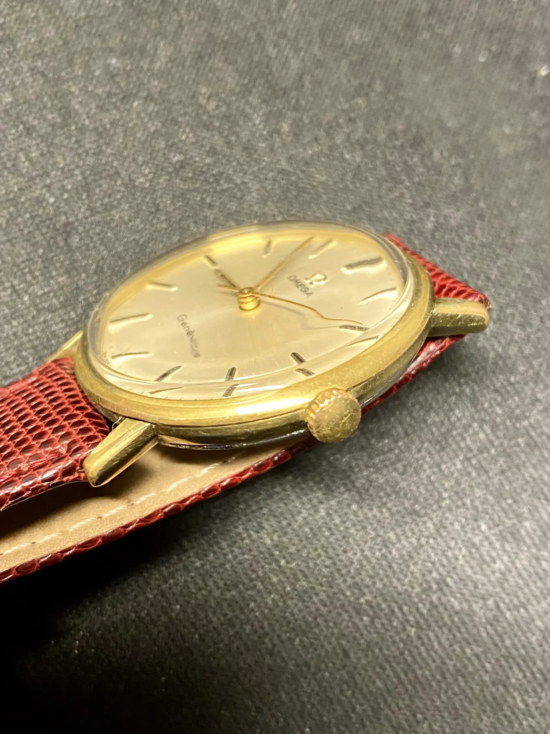

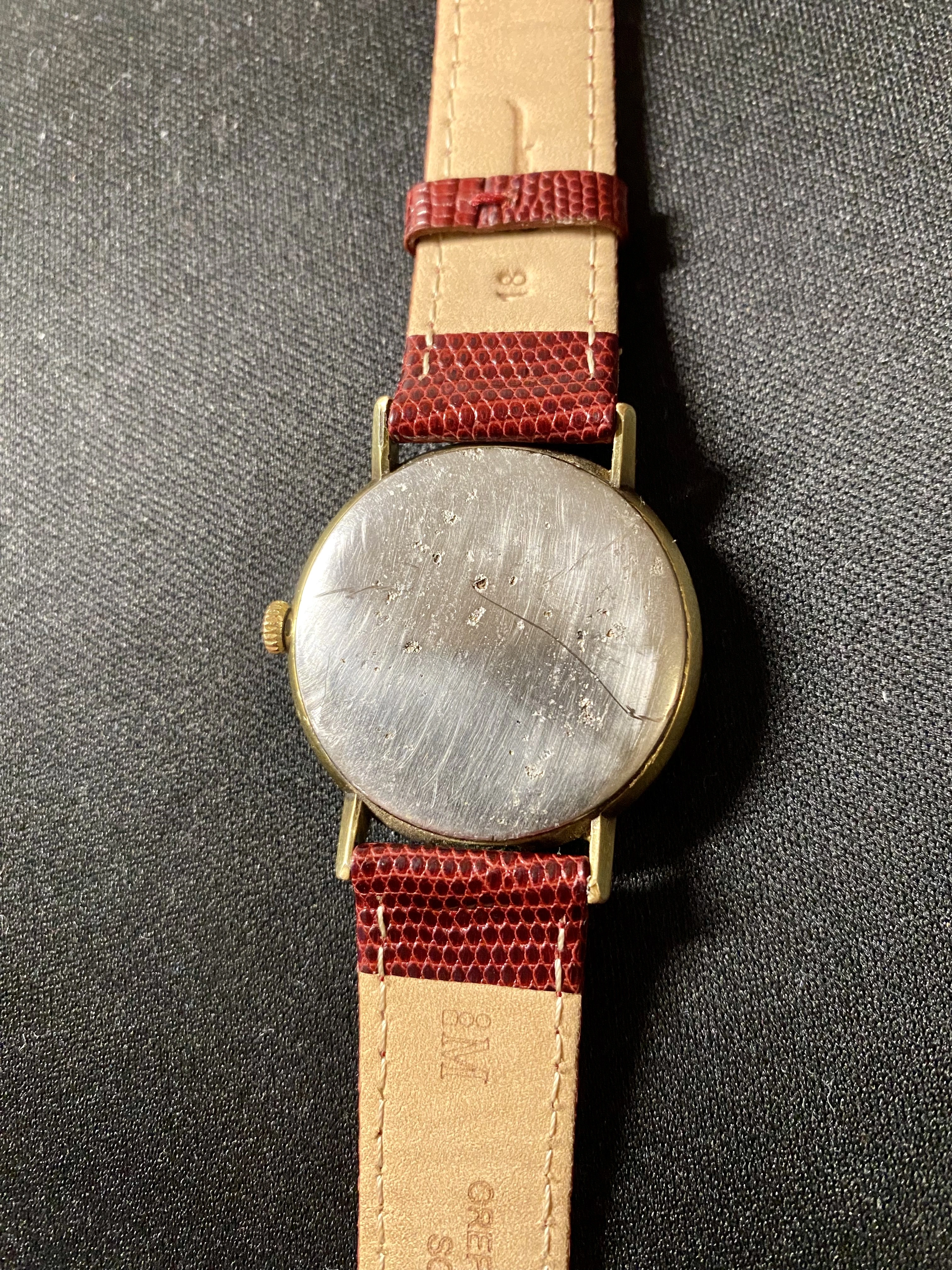

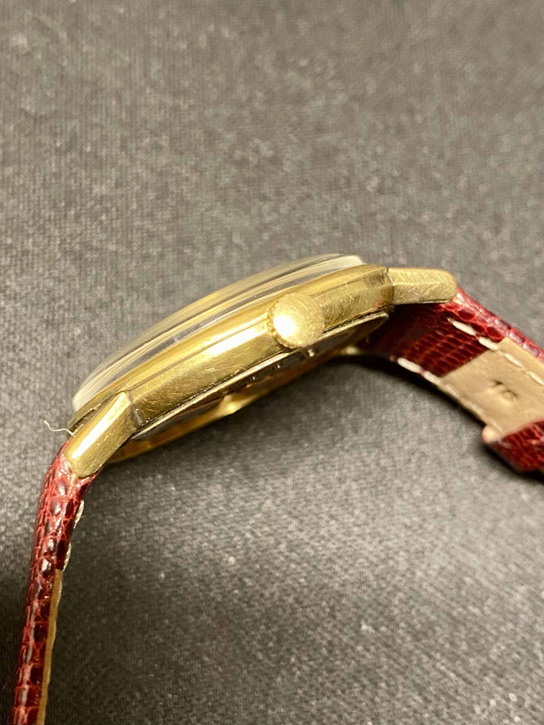

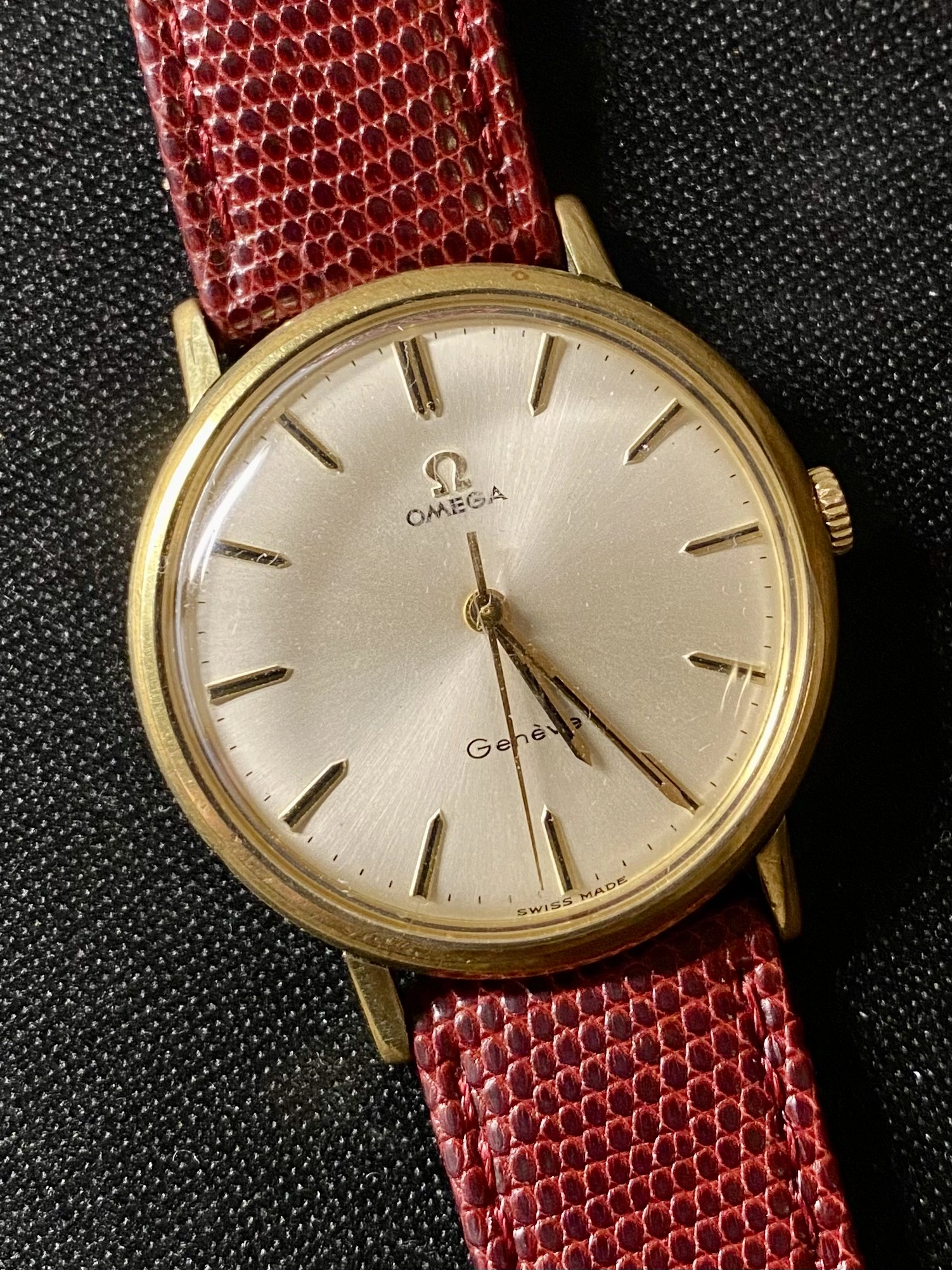

First, the watch feels very much cheaply made compared to the other Omega I own. The shape of the case looks quite odd, especially regarding the ring where the plexiglass (which isn’t signed) fits in. The case has also has obviously been mistreated and poorly polished, removing quite few material here and there, and from the lugs especially. (The crown is not signed either).

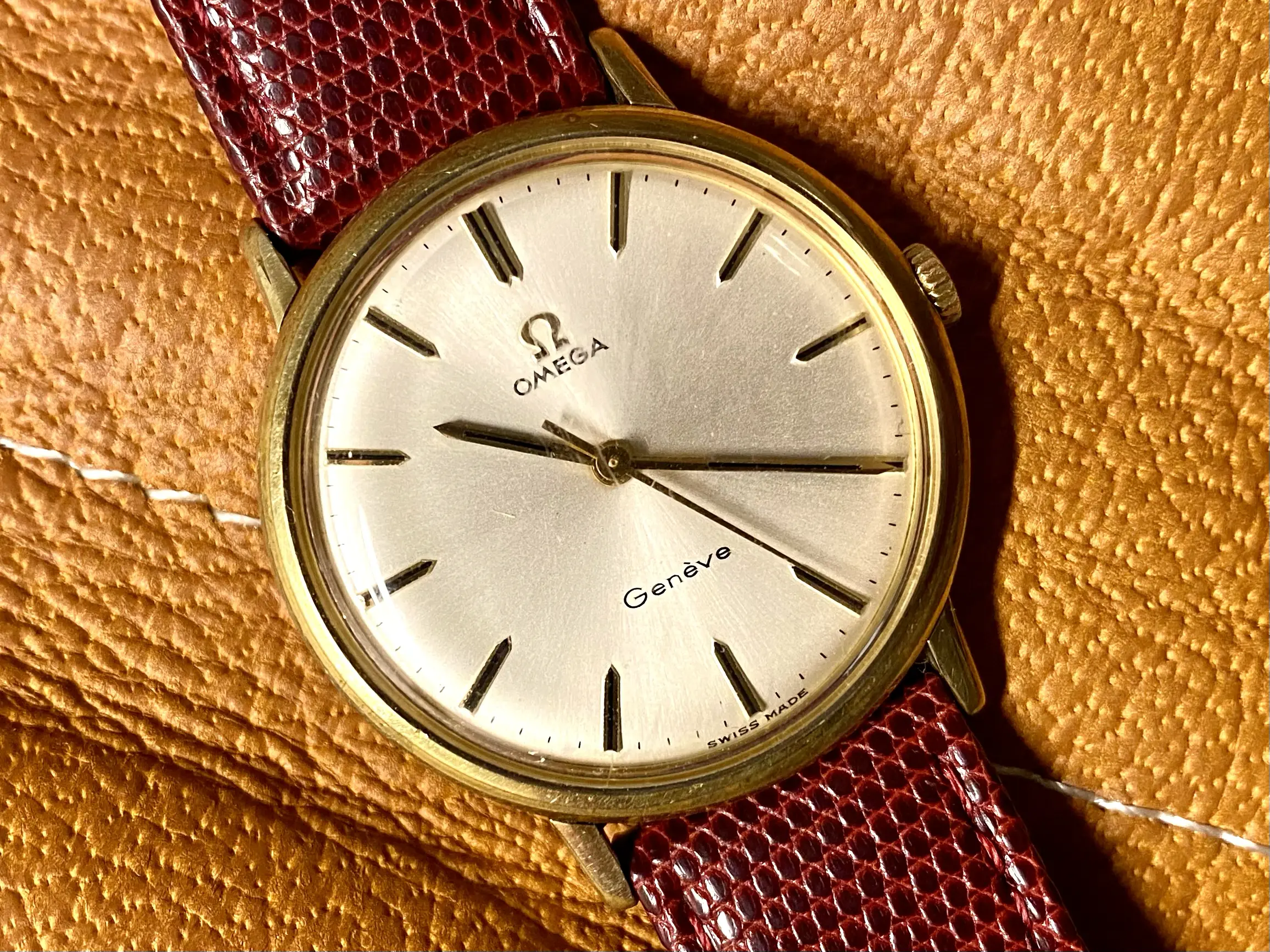

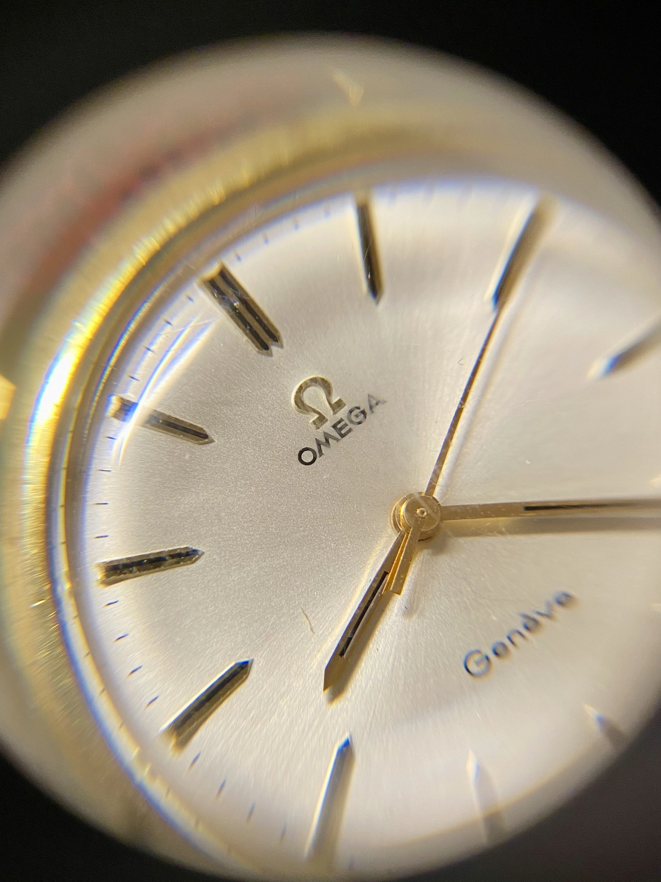

The dial also appears to be a reproduction/reprint, as it’s much too clean possibly considering the condition of the case and caseback. The “Omega” text looks a bit too thick and a crispy, and the indices—where on other watches I’ve seen onyx inserts—are simply drawn or printed on and poorly centered. (They do, however, match the style of the hands and the absence of the “T” marking on the dial).

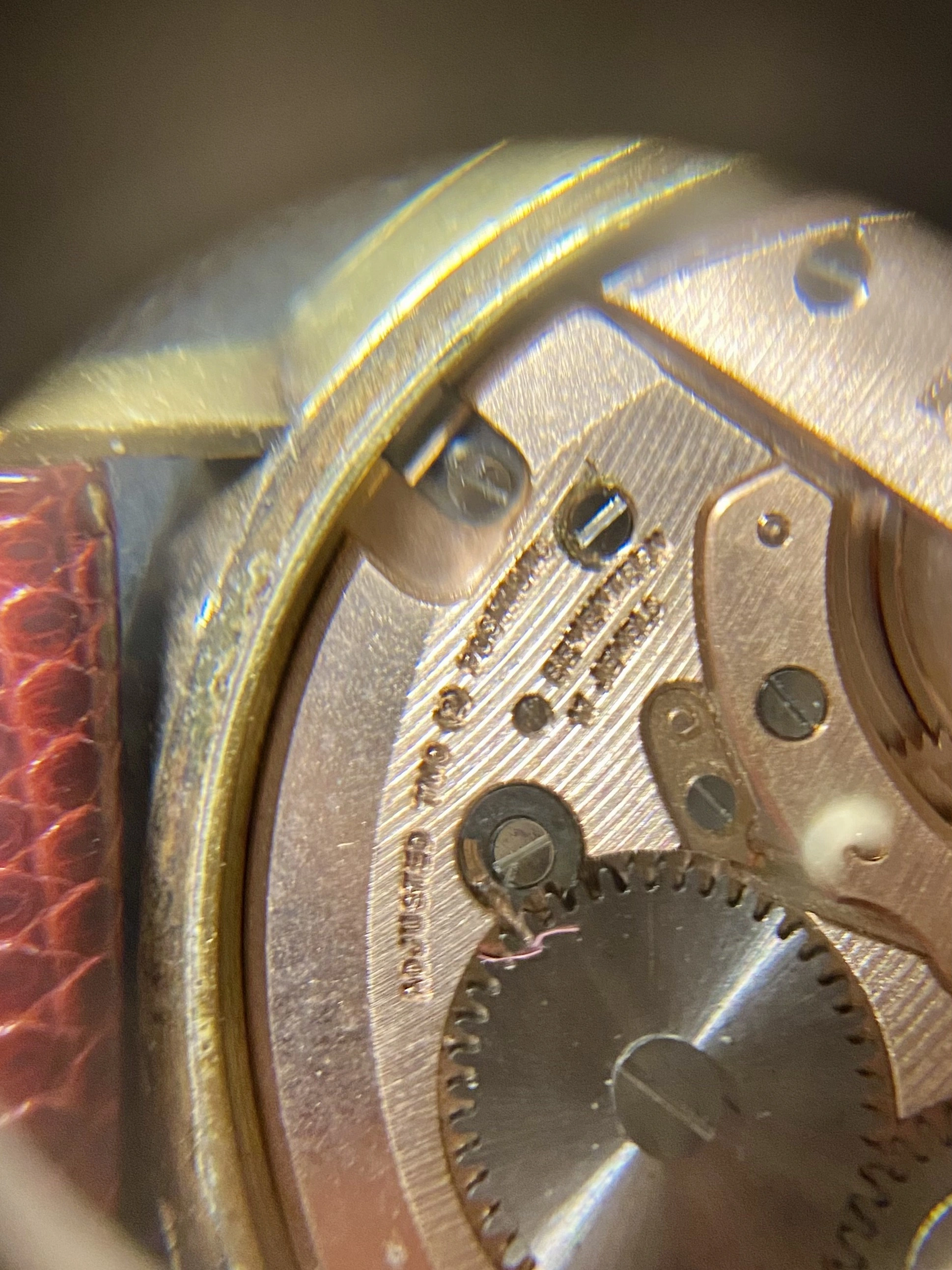

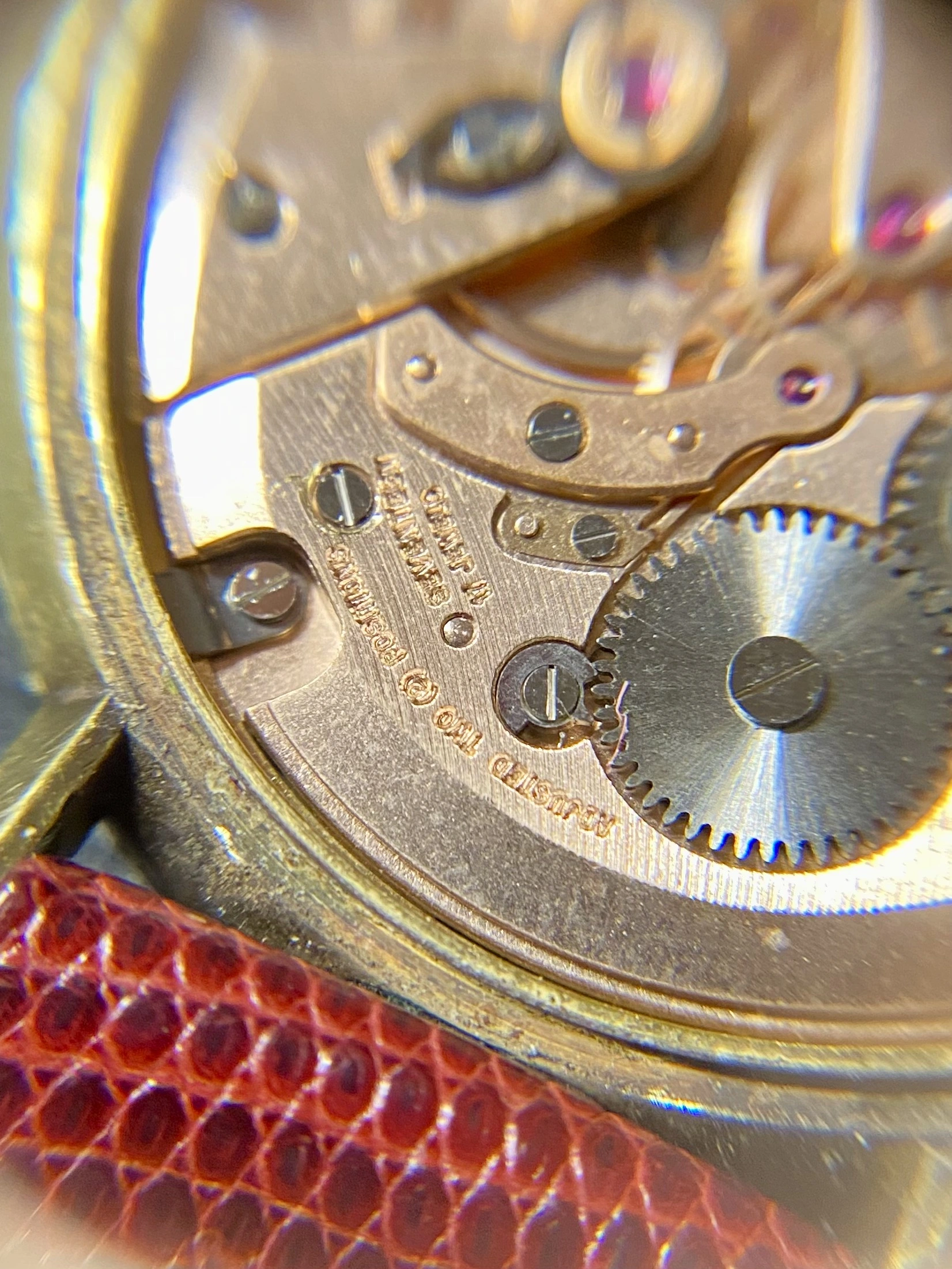

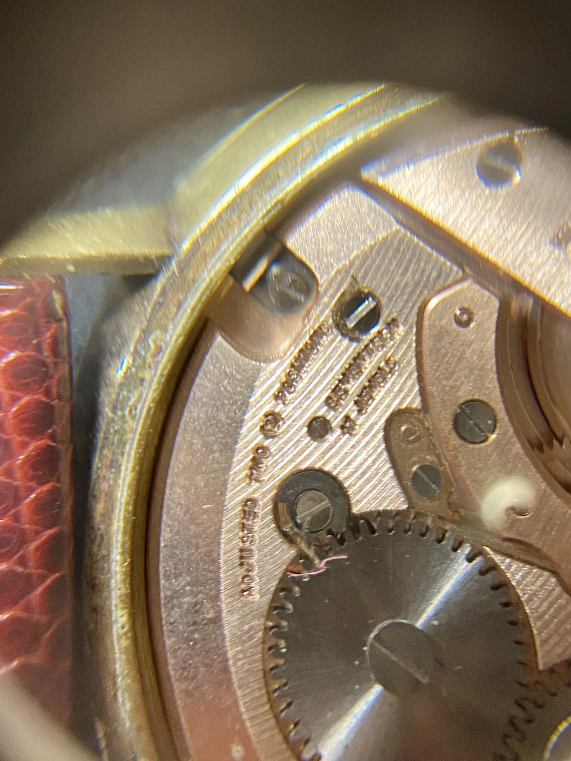

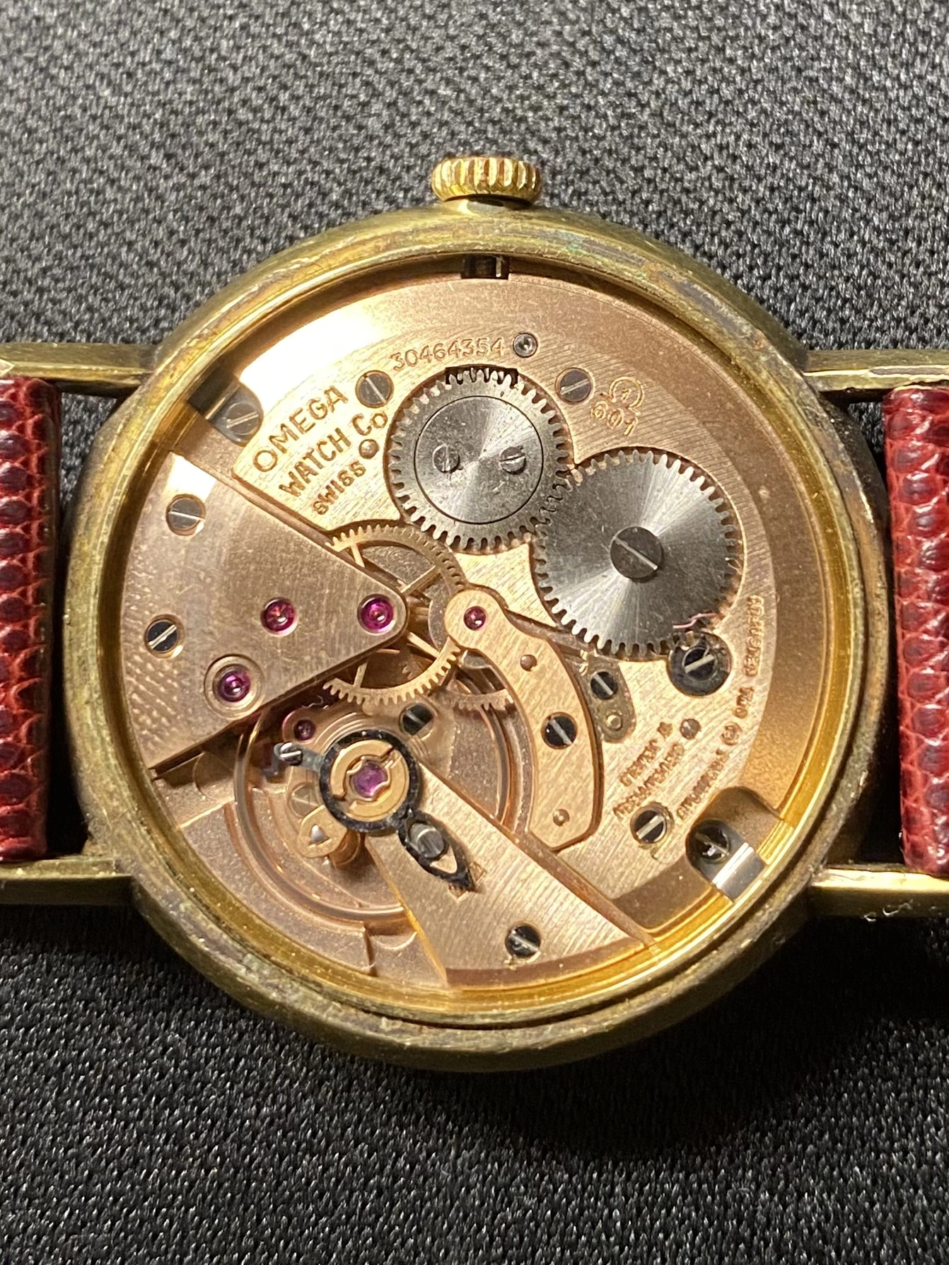

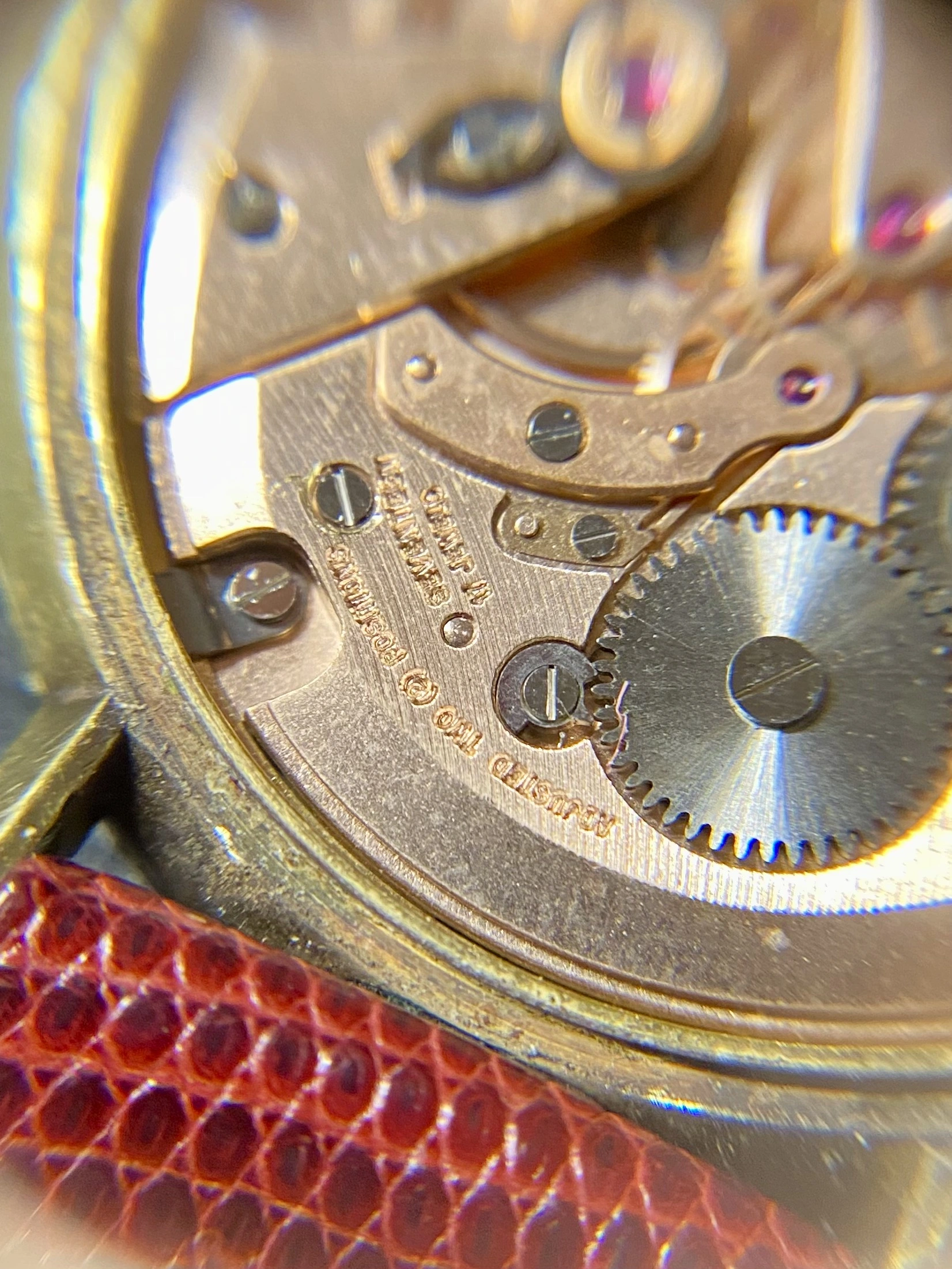

Moving on to the Caliber 601: at first glance, in terms of its shape and plating, it seems correct. However, the quality of the engravings and the surface finish is way lower than other 601 calibers I own. Especially the text "adjusted two (2) position" and "seventy 17 jewels" is almost unreadable even using a loupe (pictures make it look better than in reality), whereas I can easily read it on other calibers without any effort.
So, should I call it an interesting replica created with a fair amount of effort or not?
According to the original owner, this watch belongedto his now-deceased father for many years. If it is indeed a fake (and I’d likeyour confirmation, along with any additional observations you might have), I’msurprised by how much work went into recreating the movement that’s extremelyclose to the original—especially if it truly dates back to that era. However, Iwonder if it might be a even a more recent replica that just was passed off asa family heirloom.
Thank you in advance for any opinions or usefulfeedback! In the meantime, I wish you all a great weekend!

Looks genuine to me although it probably needs a new crown and some TLC and the worn plating is the sort of feature that you can either live with or not.

I think the watch is genuine. Am not certain about the hands. Is that lume or intended as an accent line down the center of the hands?
The photos are a bit blurry and almost too close. I will also admit that I have no particular knowledge about the model.
I don't think it is an Omega model much counterfeited. It might be a franken-watch.
The movement markings appear to be double struck. I am guessing they are applied by stamping rather than roll marking.

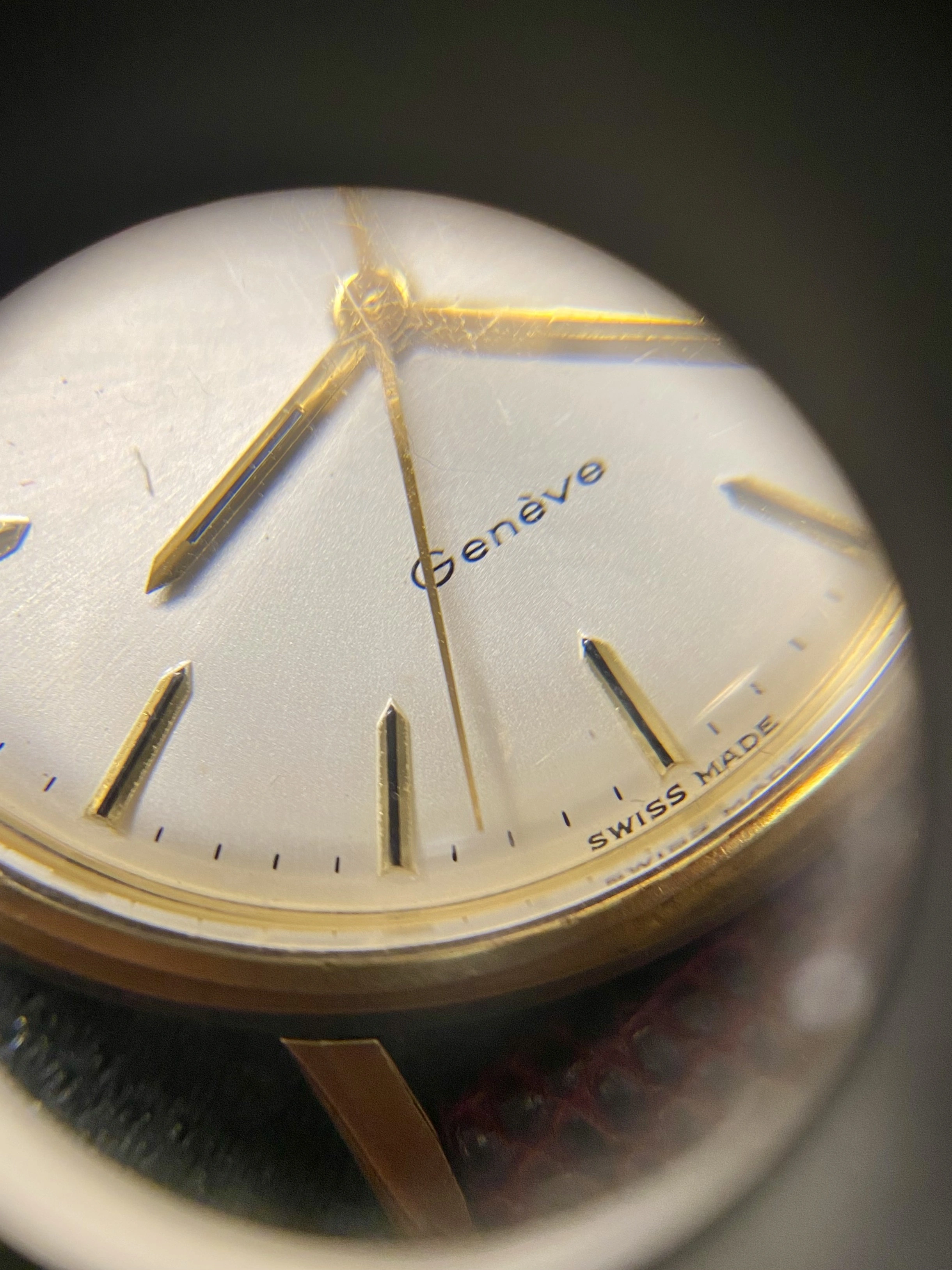

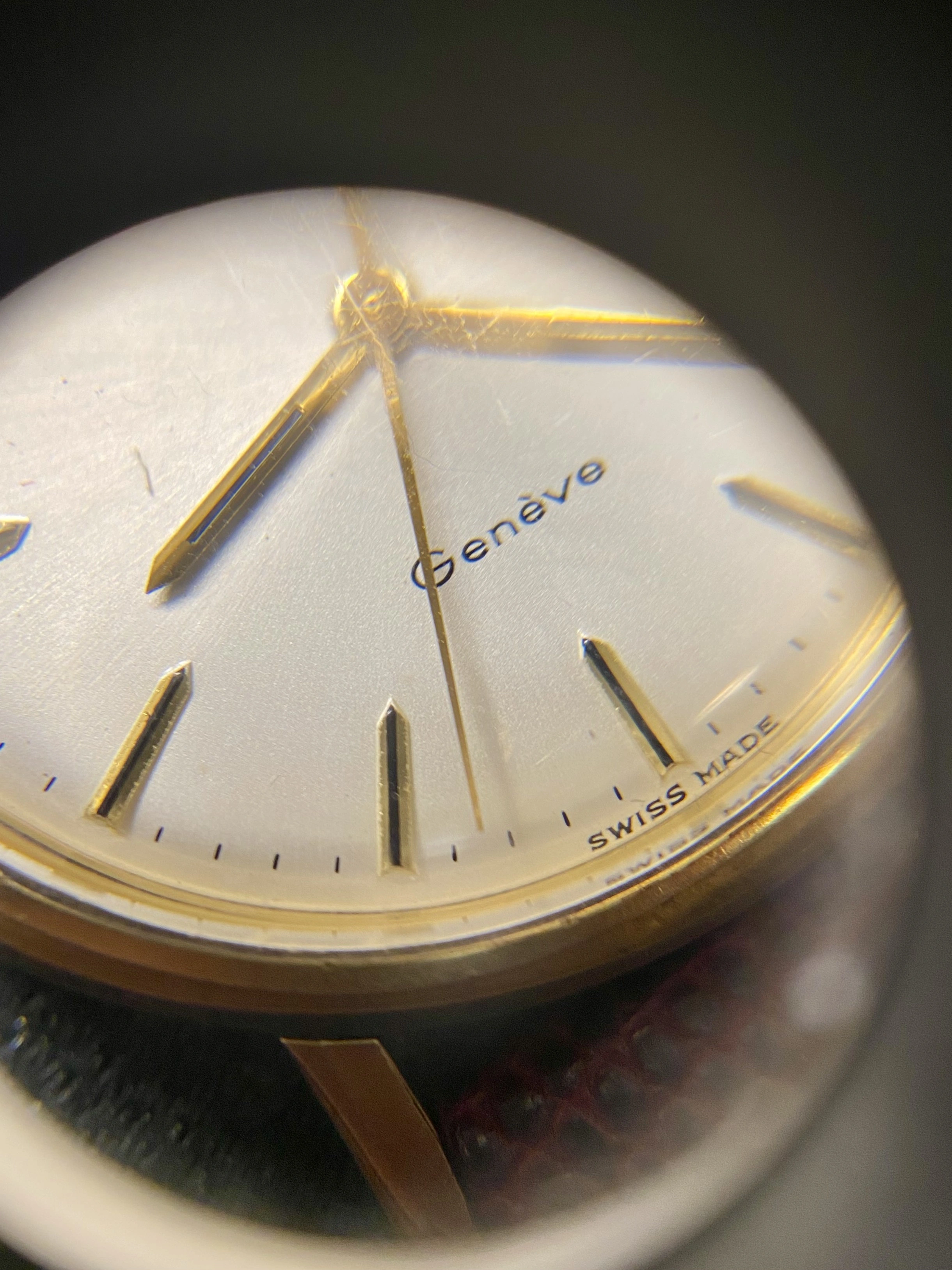

Thank you both for your reply. The hands don’t have lume but just black lines, consistent with the markers. I’m sorry for the close-up photos, I tried to take them using a loupe to provide more detail🙄.
These are actually engraved and are usually nice and clear. If the engraving machine (pantograph) had a worn stylus, or if that particular movement had not been secured properly in the bed then it could result in the engraving seen here.
I have no doubt the movement is genuine and the watch is not a franken, the dial however, I would say it's been "restored" due to the heavy Omega, the wonky Genève and the positioning of the Swiss Made.

Thank you very much, here it is possibly a better picture for the hands
Thanks for the note and the great explanation about the engraving. I’ve just removed the plexi, and indeed the dial appears quite clearly to be reprinted.

Well, I have to say that the dial looks original to me
42
147
thanks for the reply! Even if the character in OMEGA text are a bit uneven?
9,378
78,494
The text doesn’t look uneven to me. Sometimes photos distort.
