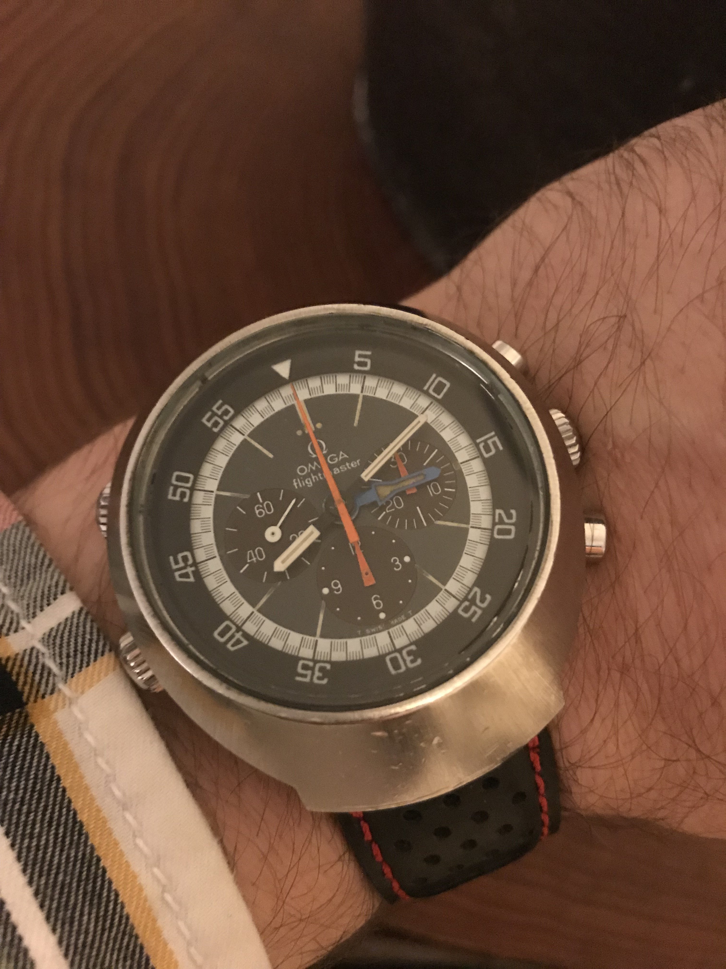

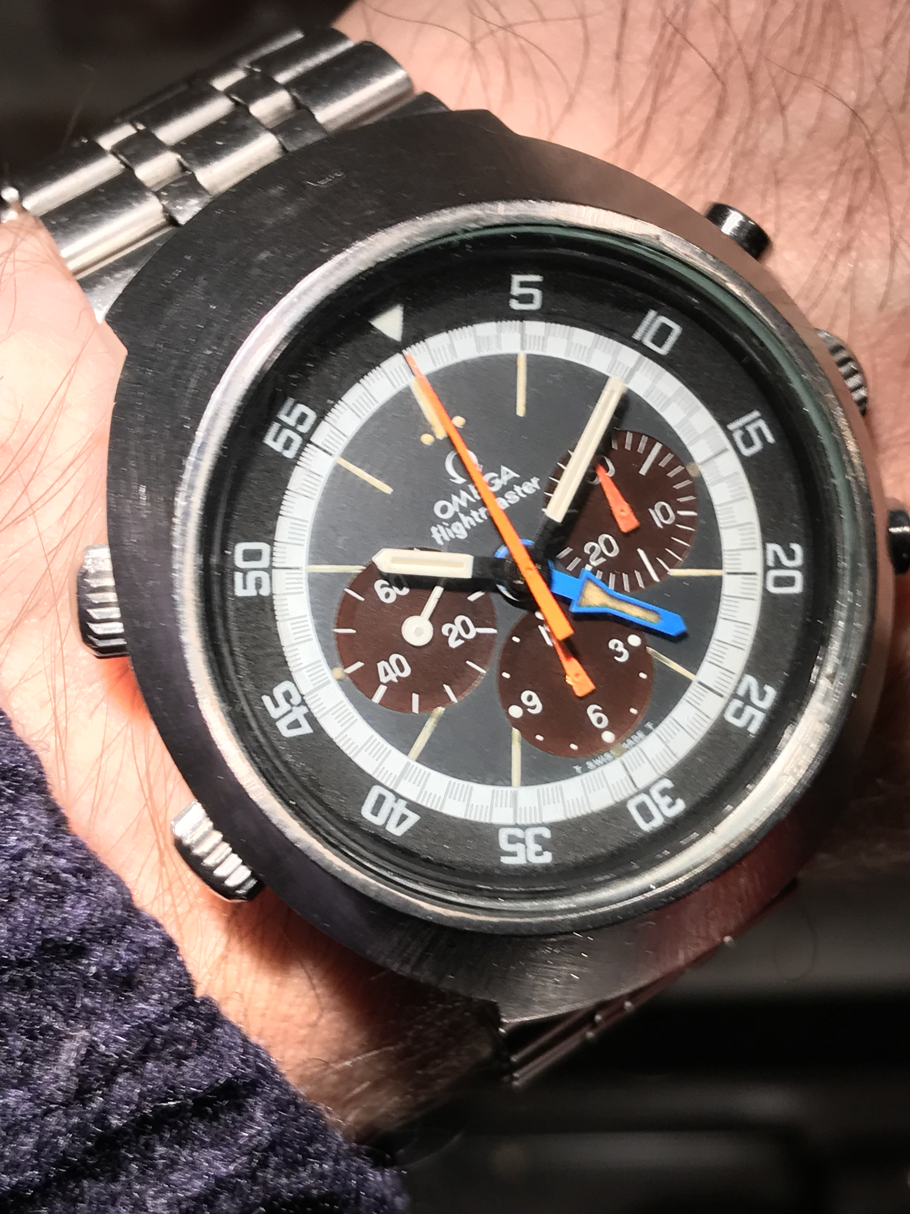

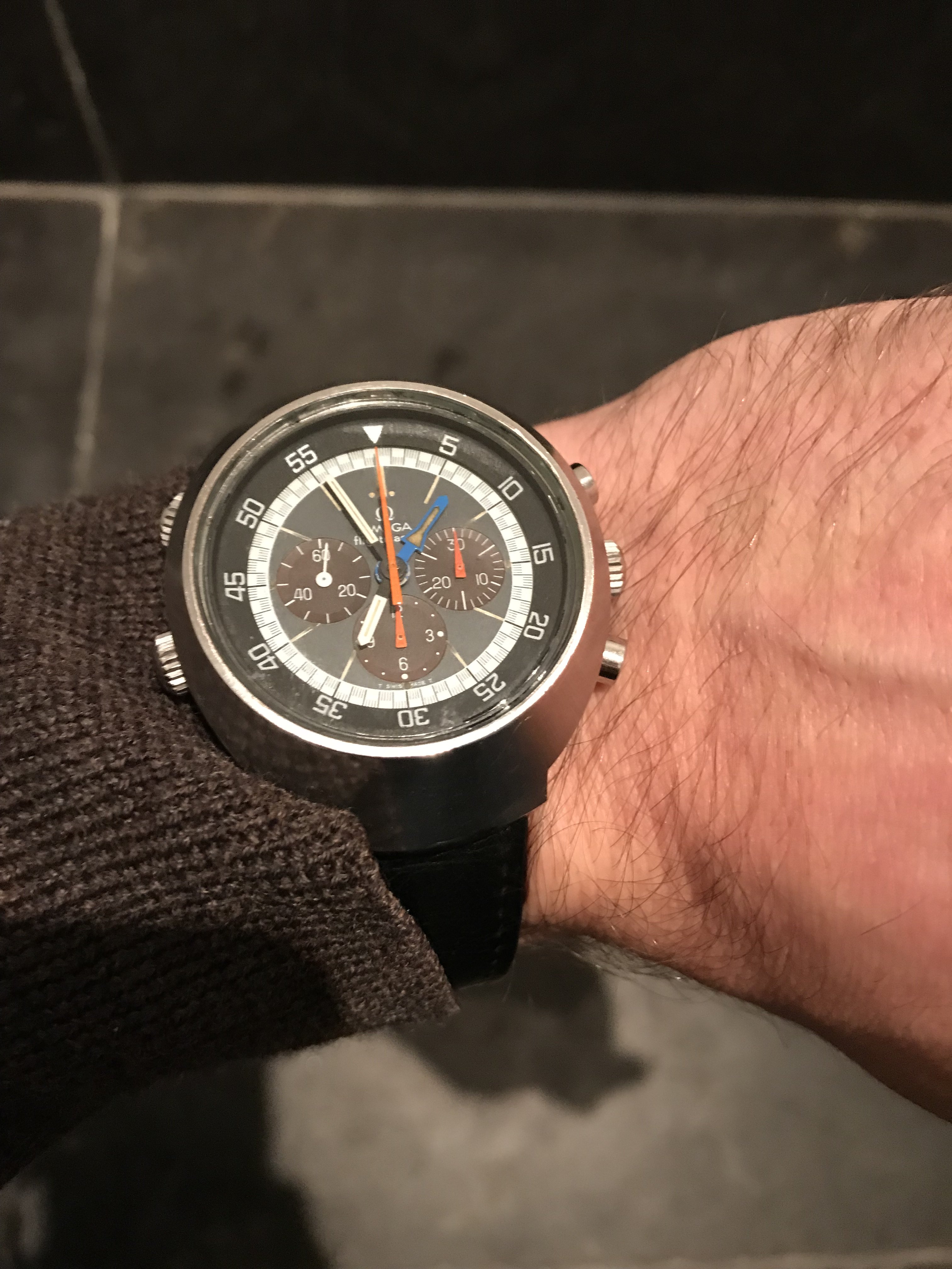

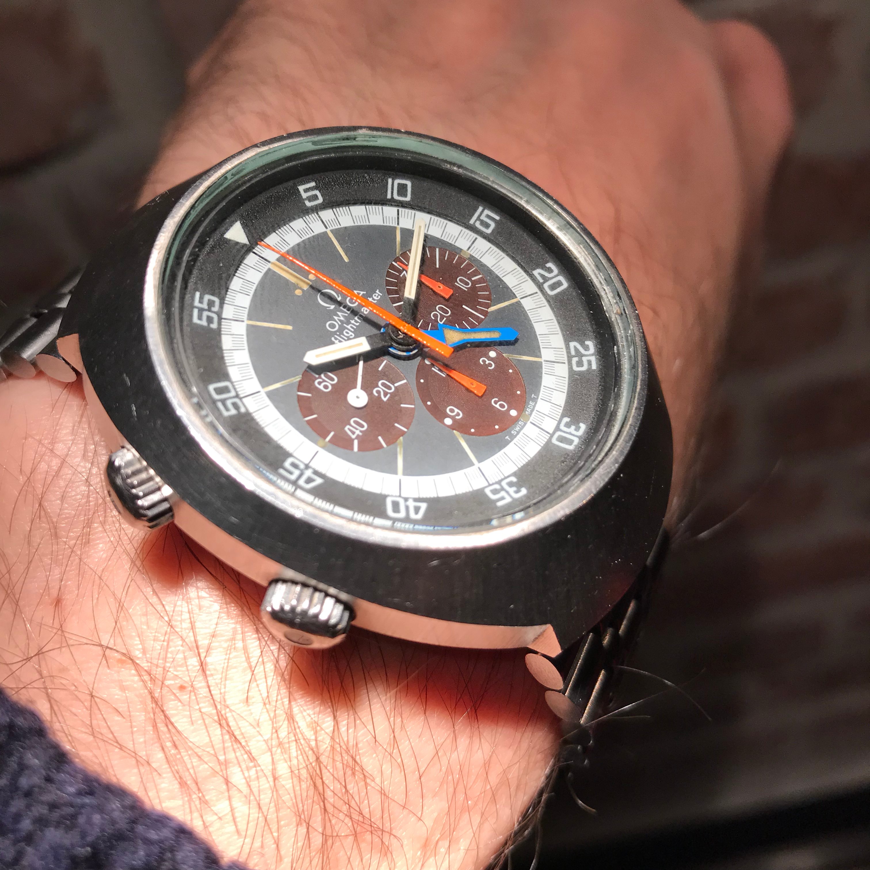

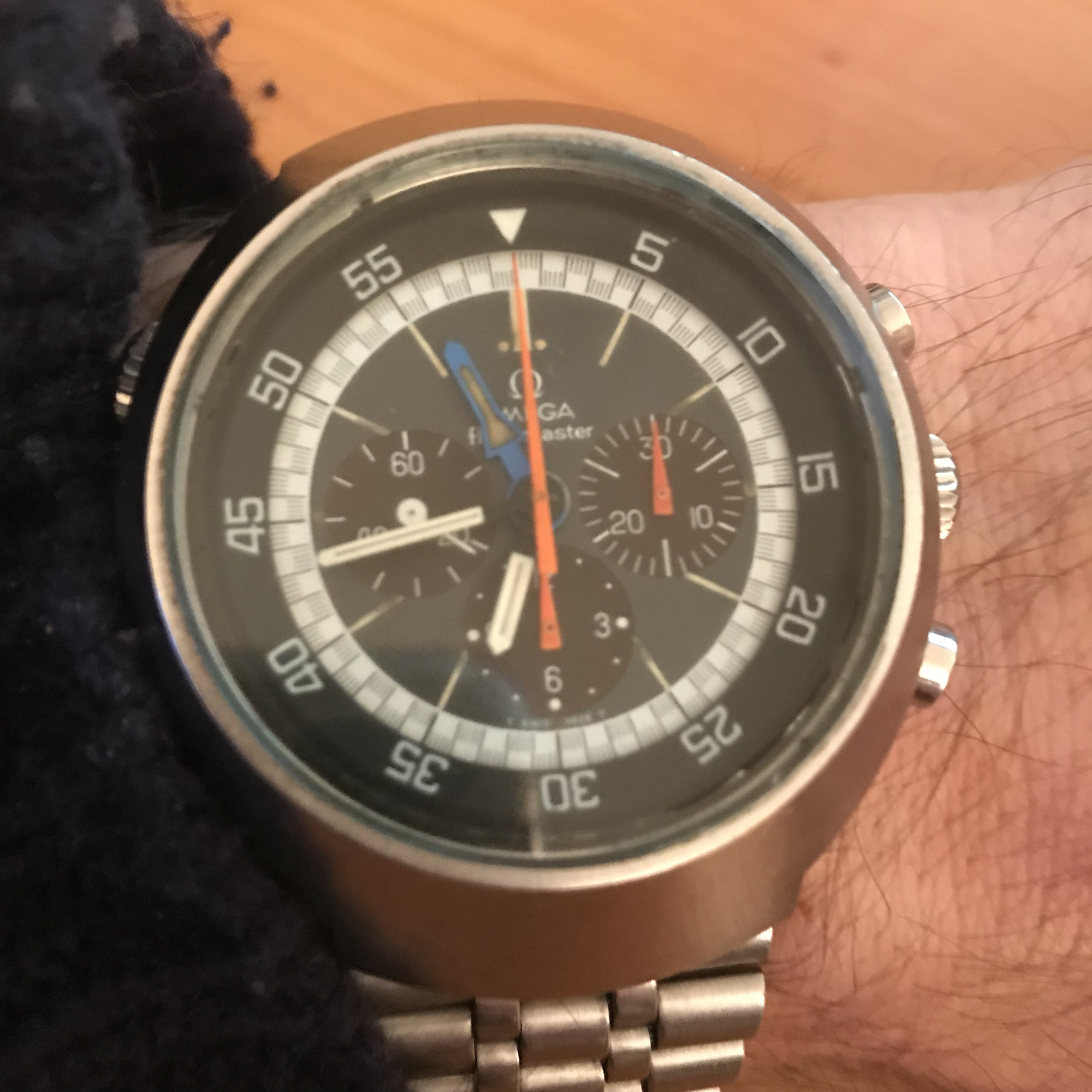

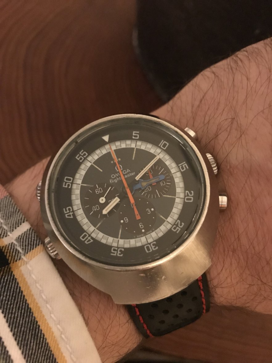

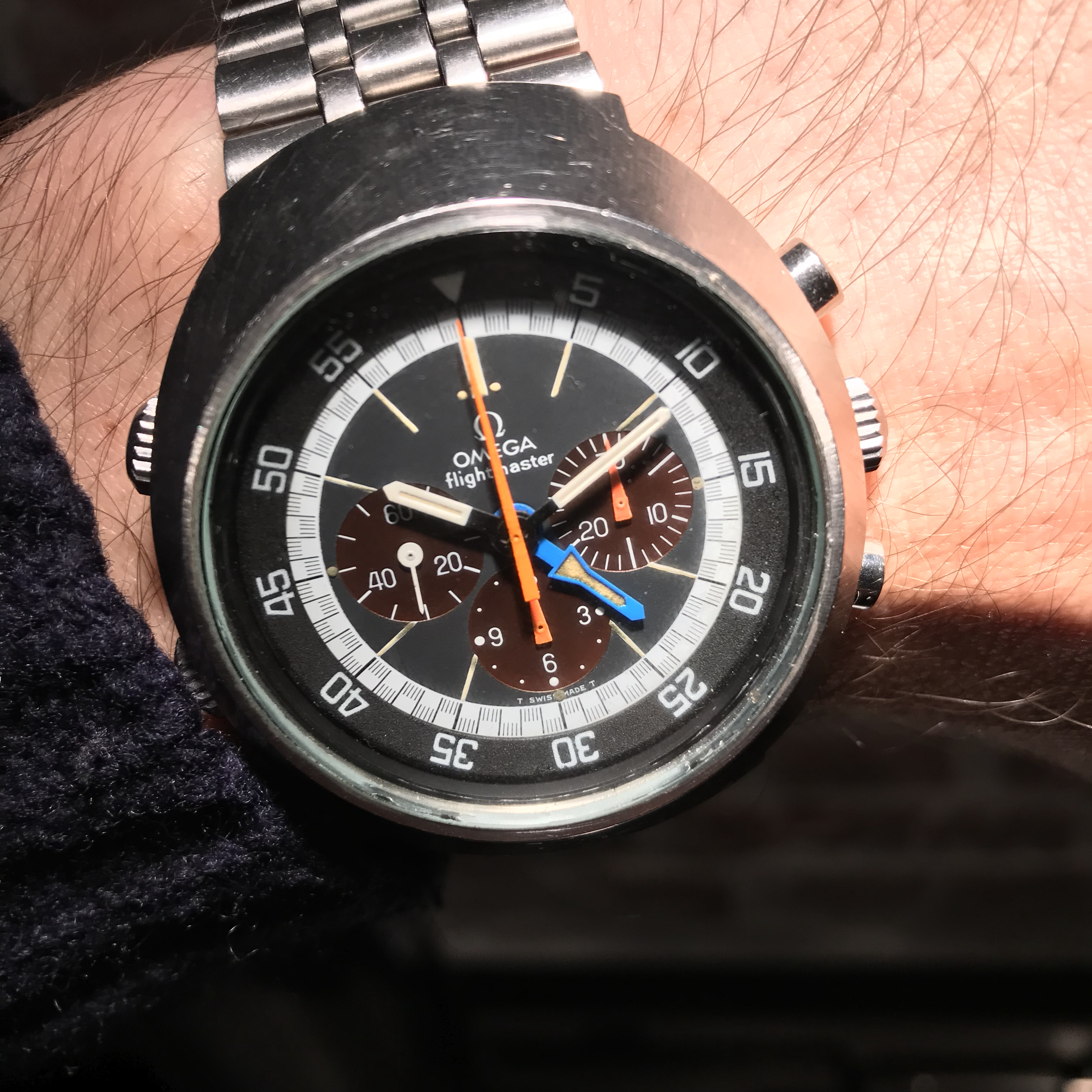

    Hi Guys,
    Mid Novemer 2017 I went to visit a vintage Omega dealer who is in the business for more than 20 years to check out a Speedmaster 125 and trade in my 2016 Speemaster Professional. The new luminova Speemaster Professional did not give me the buzz since I prefer the more warm vintage look.
    I allready knew that the 125 is a big watch and it looked the part, but it did not convince me. I only have 2 watches and I want to wear my vintage watches on a daily basis. So the dealer showed me also a stunning blue Omega Speedmaster TV dial ref. 176.0014.
    But at the table I also asked him if he had some Flightmasters. I just love the 70s big cased funky look combined with 2 cool complications (Chronograpgh and GMT). He first showed his own ones from his collection. One of it NOS with B&P...He also just had received to new ones that would fit my own budget. I fell in love with one at the table since the 145.0026 caliber 911 had brownish sub registers. So we closed the deal. I got €2615 for my Speedmaster Professional and I had to pay an extra €500, since the Speedmaster Professional box had some water stains and the watch case had to get polished. I think it was a quite reasonable deal. On the Multifunction Timegrapher at the dealer the watch had a delay of 23 sec/day. I asked i fit was an acceptable tolerance, and the dealer told me it was OK and that he would give me his standard one year guantee and i fit would become worse I could send the watch back.

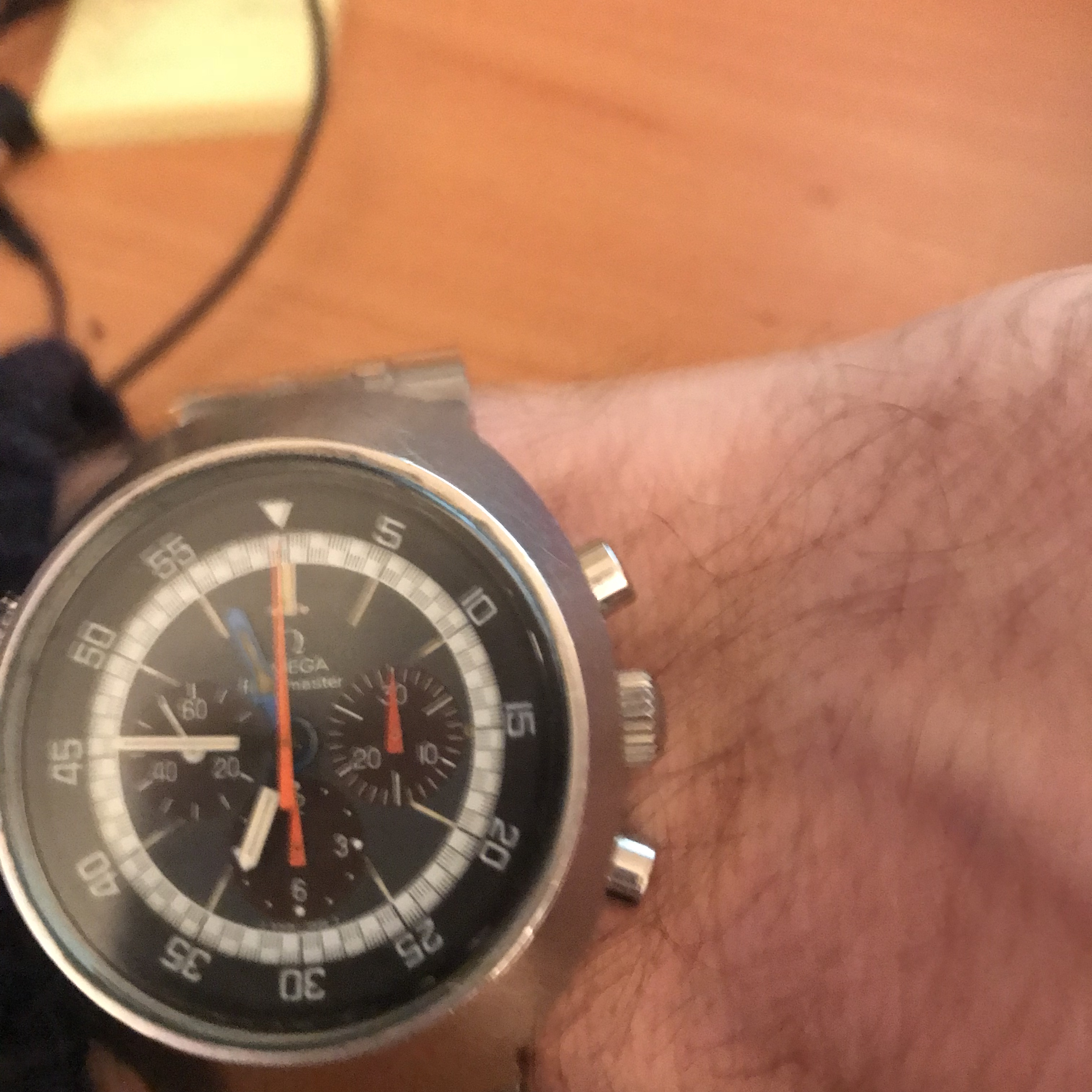

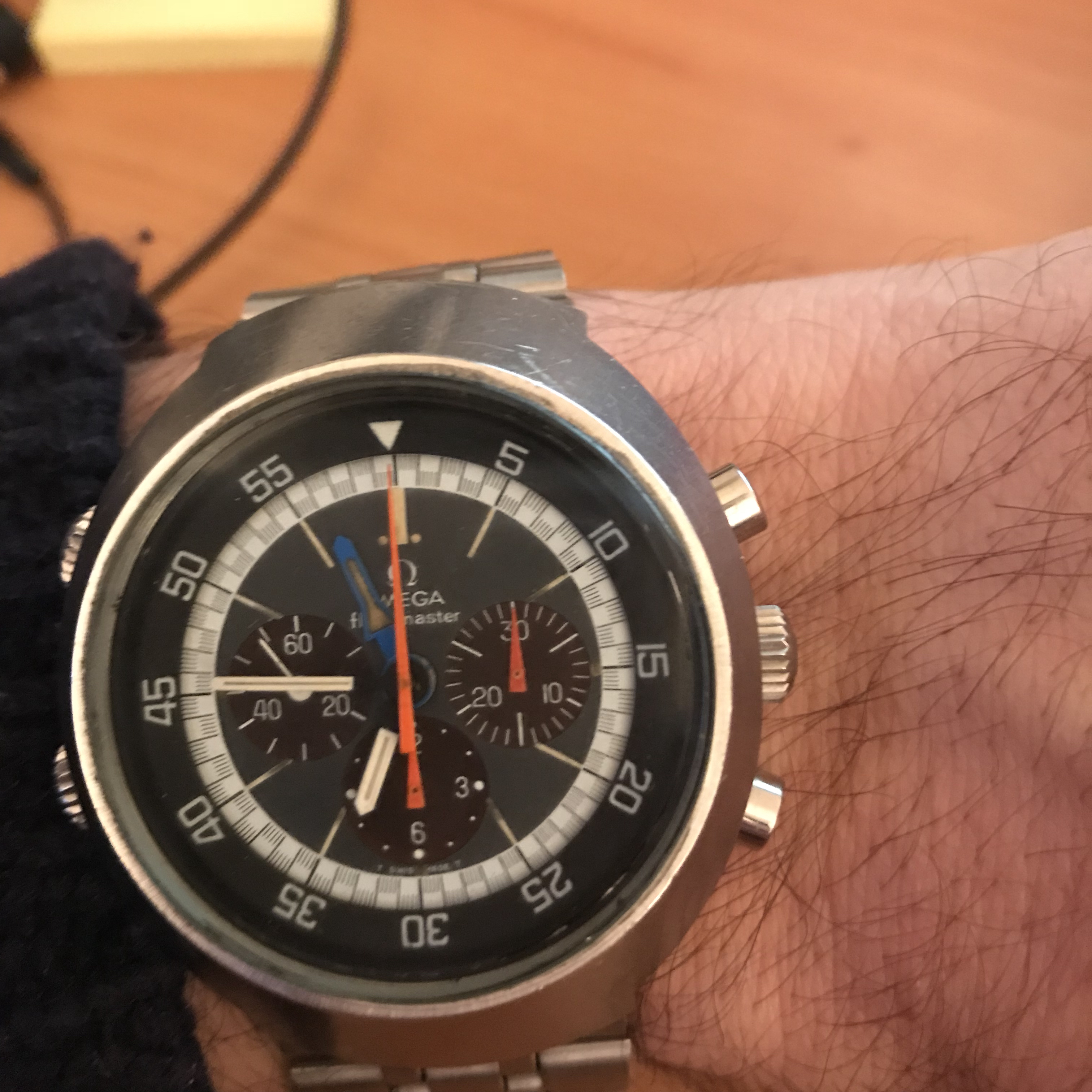

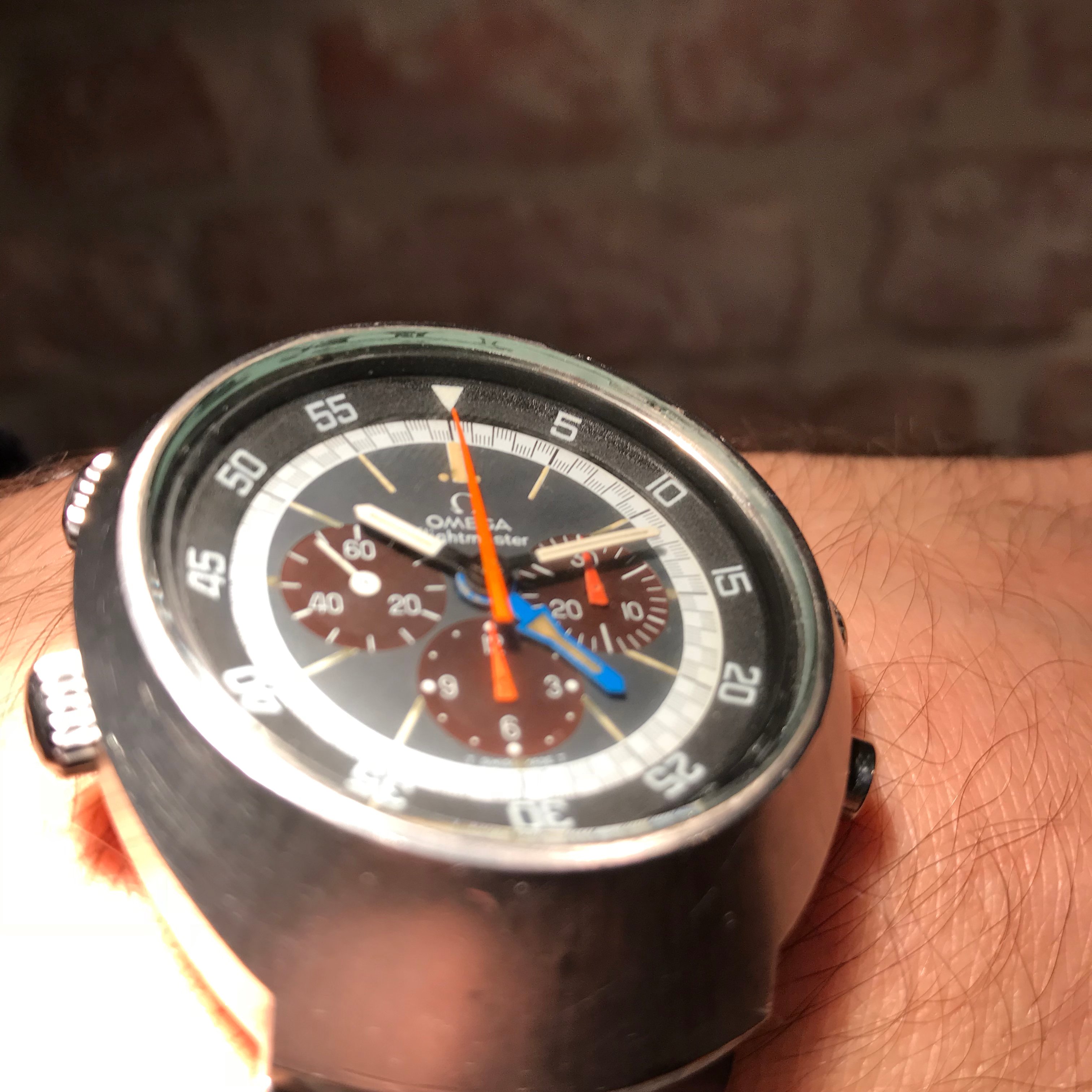

    After ten days wearing the watch I contacted the dealer with the following questions:

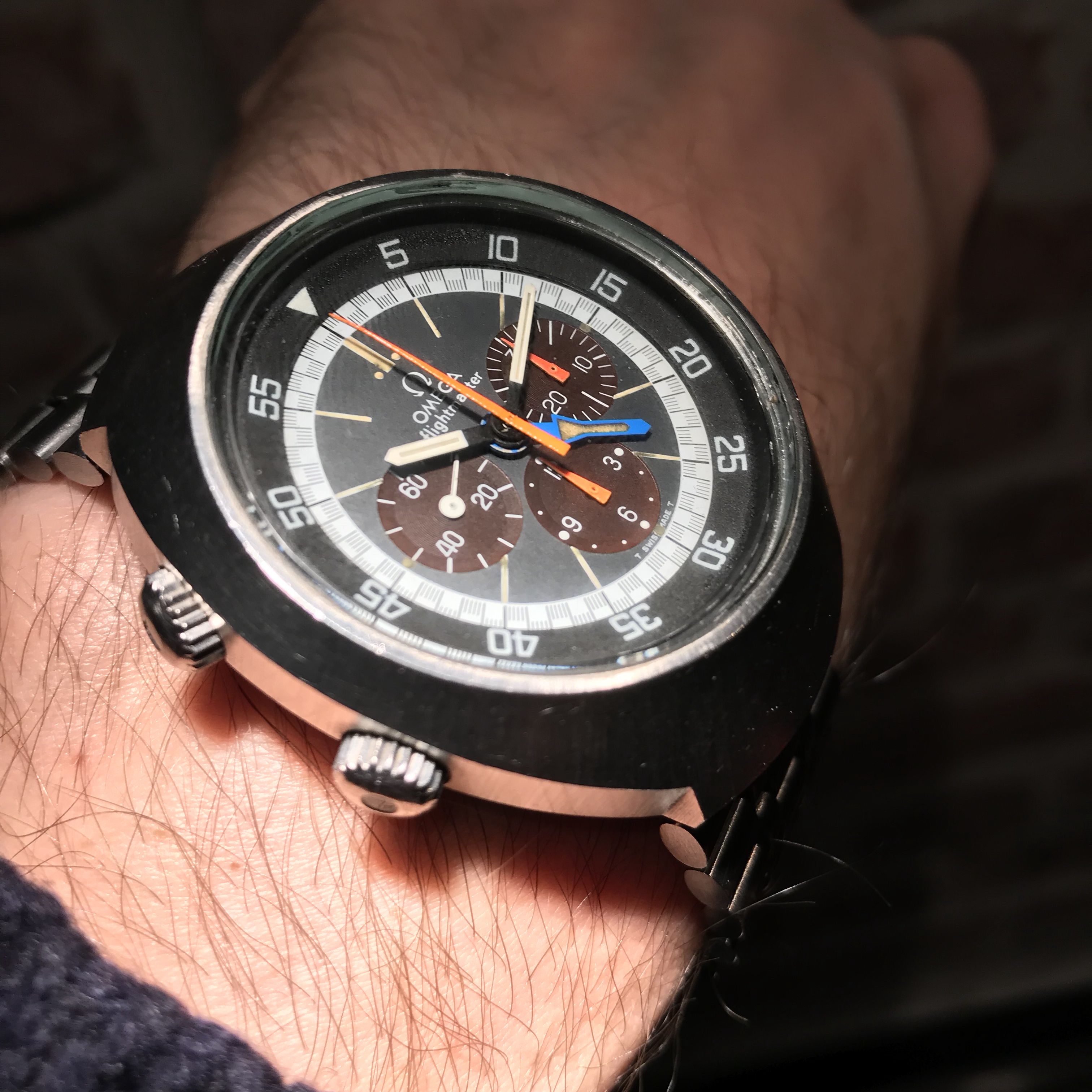

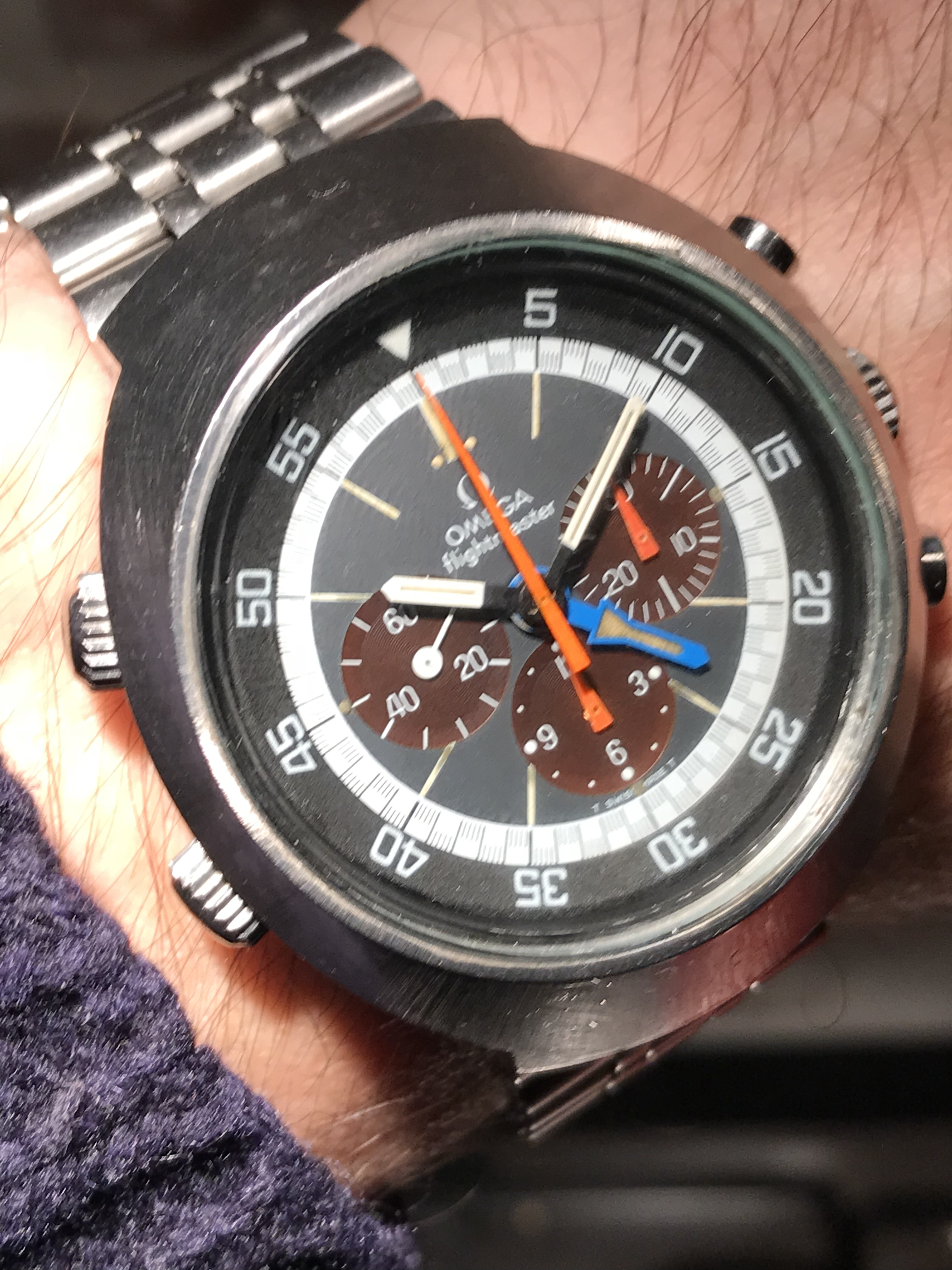

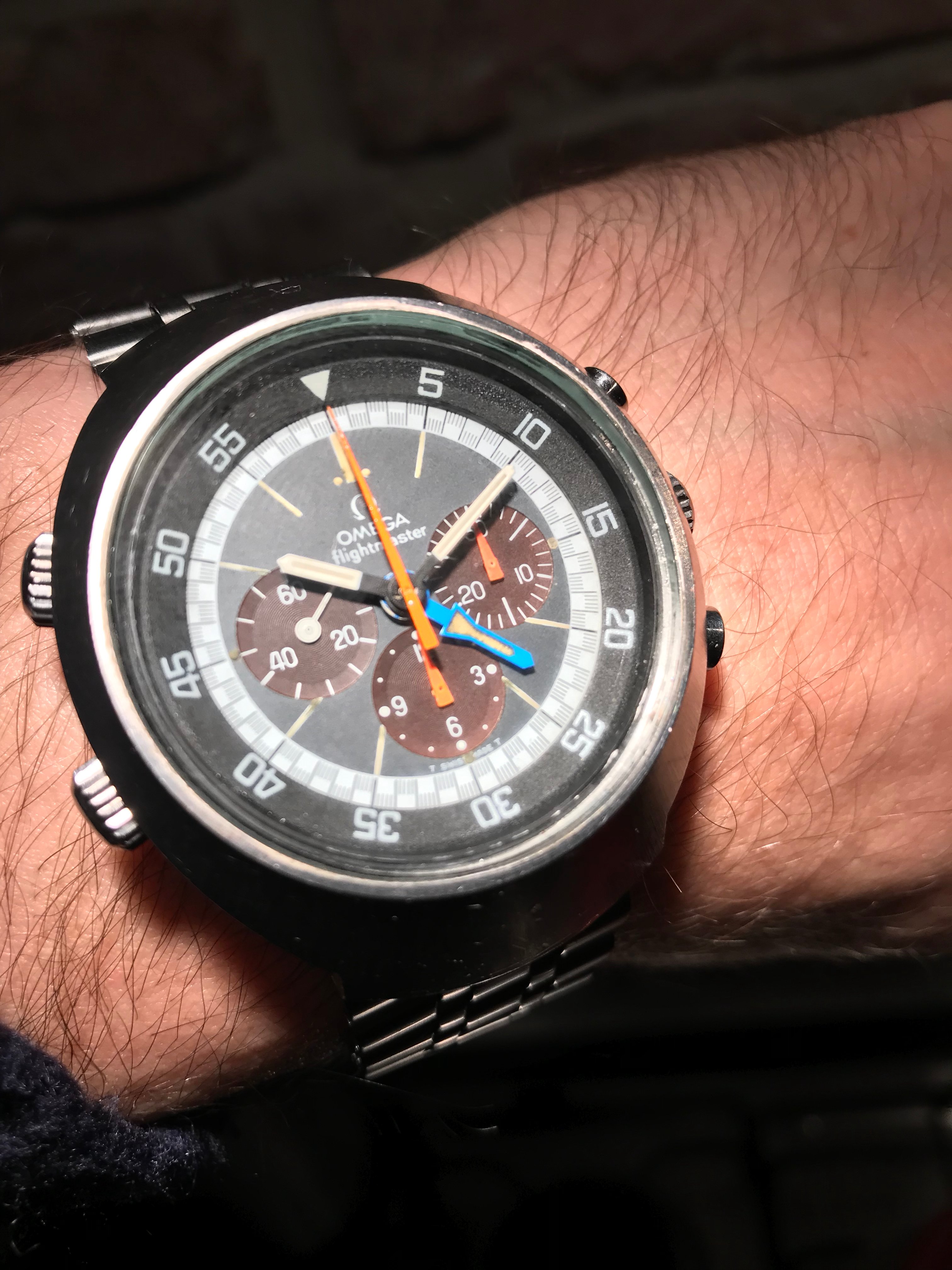

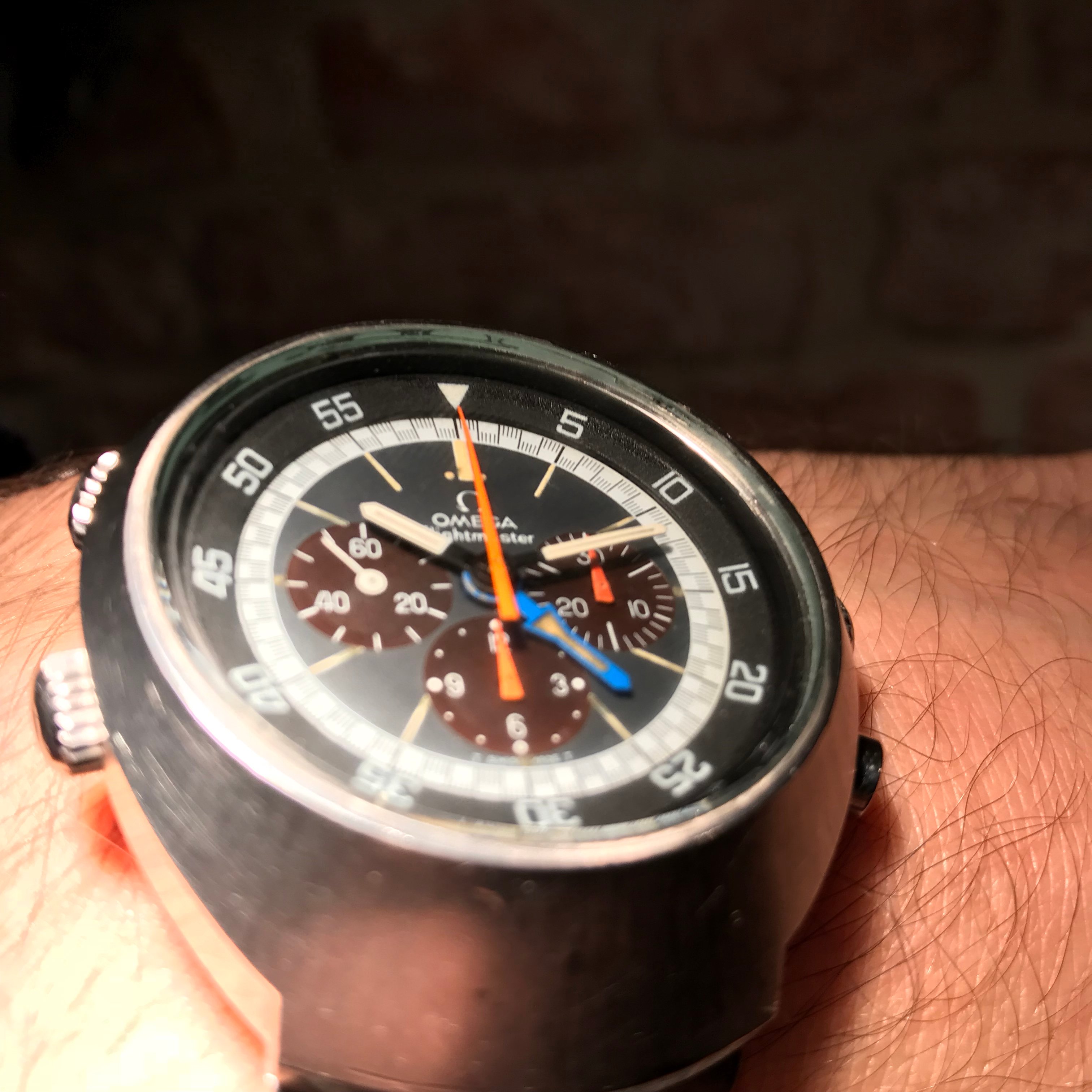

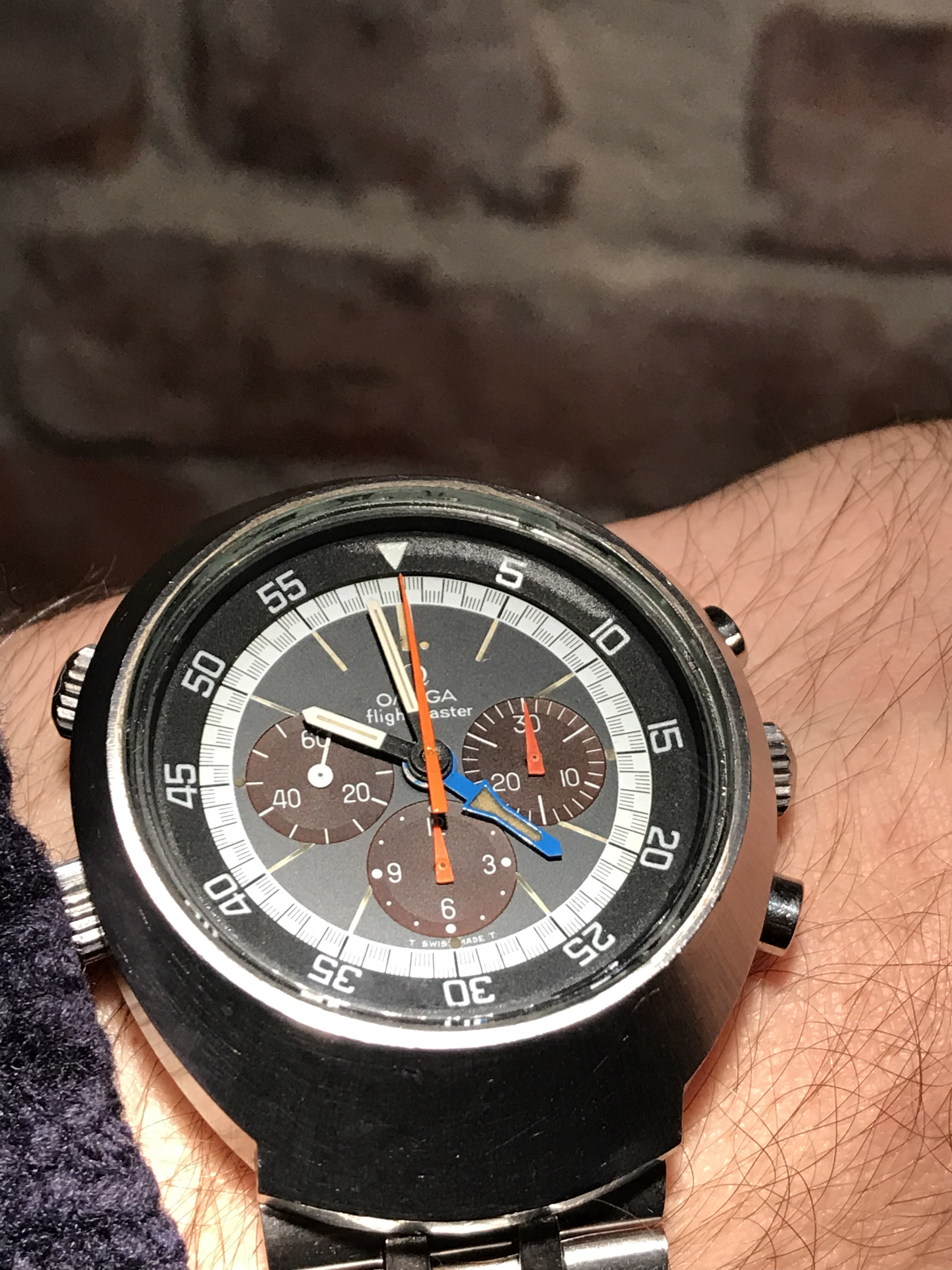

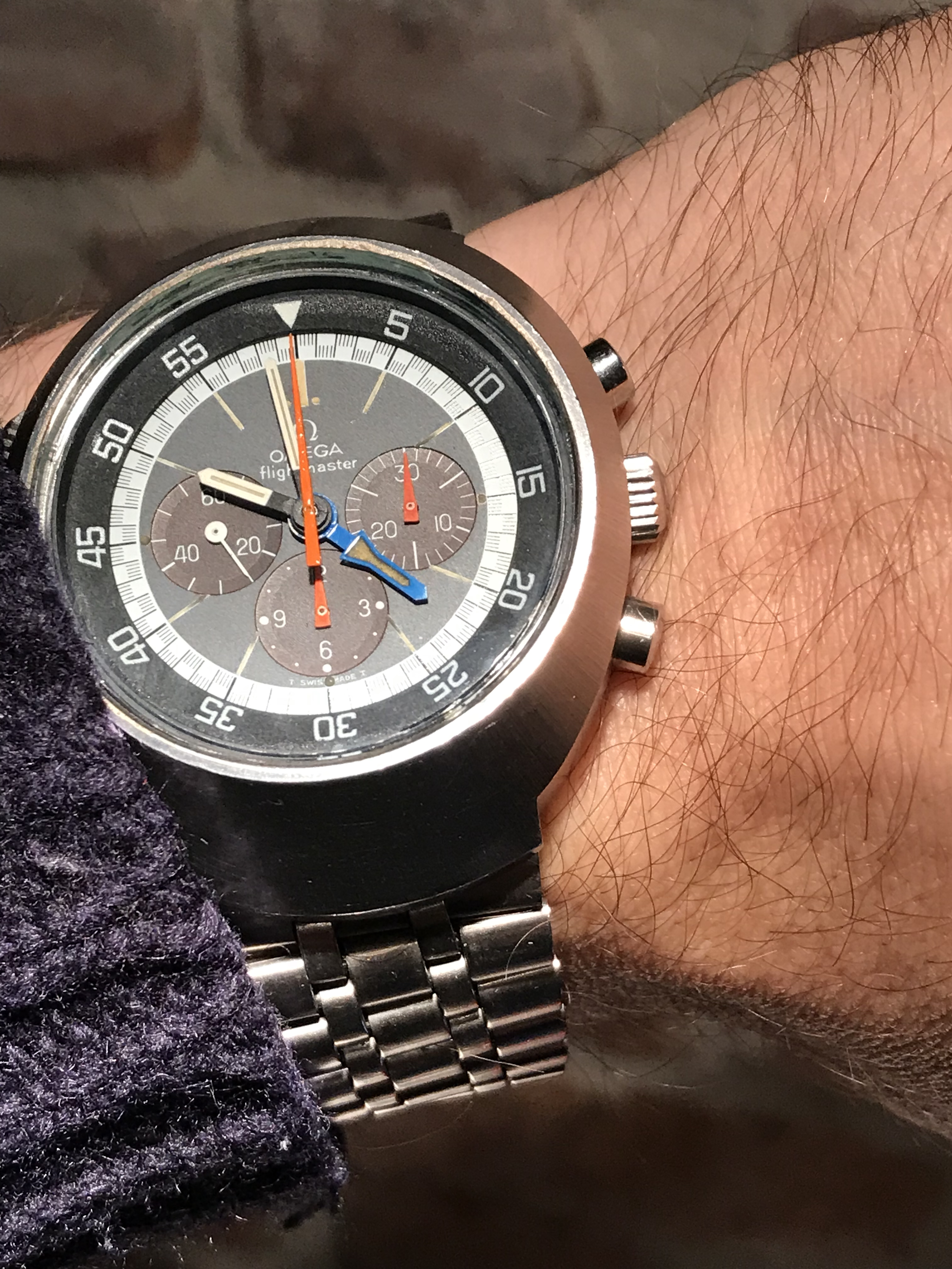

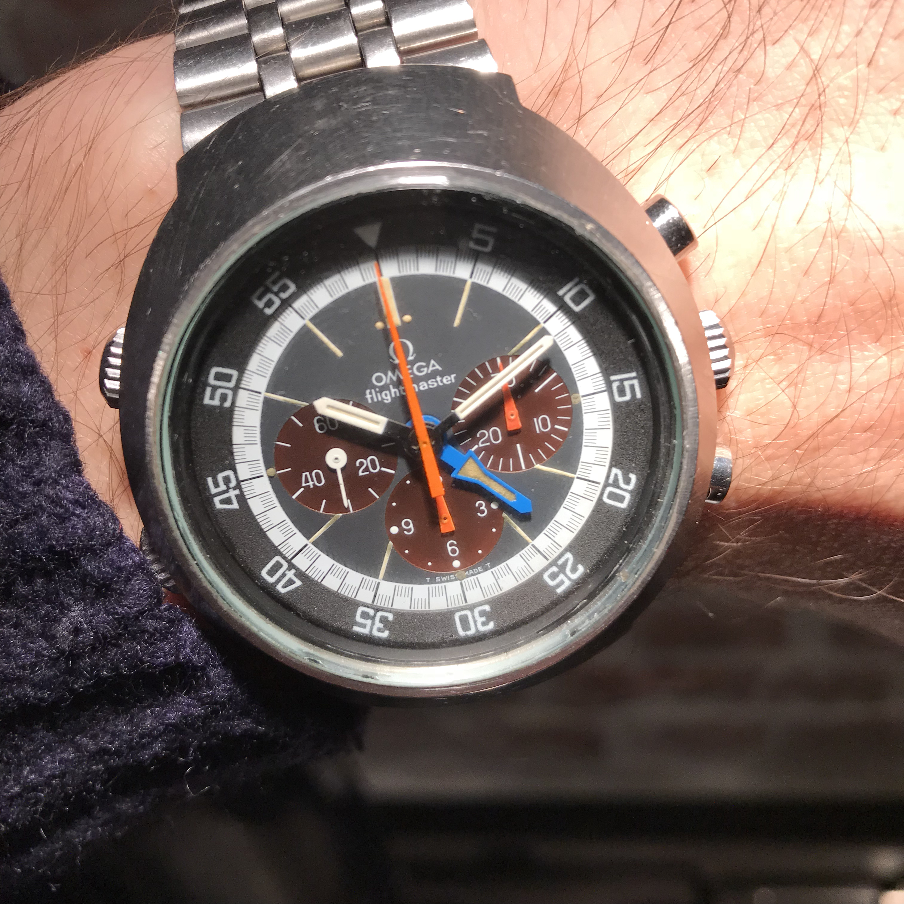

    Yesterday evening I also noticed what I had not seen before at your home. In good artificial light at home under the hood I noticed that it looks like there is moisture on the inner bezel at 5 and 10.
    It seems as if the closure between glass and cabinet is not good because there are some irregularities (black spots) to see at 5, between 10 and 15, at 25, at 35, at 45, at 50 and 55. It is not reflection.-were those places already there?
    -is this moisture (innerbezel) and oxidation (black spots between cupboard and glass) or is that oil (innerbezel)?
    -Is that place on inner bezel due to a problem?
    -Are all gaskets well?
    -Is the clockwork well checked with 25 sec deviation per day?
    His reply:
    Stains were indeed there - I received pictures from the old owner
    This watch has an original glass with old gasket type which are fat and can "sweat" and that looks like moisture but it is grease from the glass gasket.
    25 seconds a day is allowed for a vintage handwind movement. Will wear the watch and watch it after 10 days because that is the measuring method from Omega.
    He thereby reassured me saying:
    I can only indicate that the watch has had a full check at the Omega Service and the clock has been found to be good and for this a 12 month warranty is issued.
    Of course it is solved and if the deviation is too large I send the watch back (tot he Omega service center) to solve the problem.
    After 2 weeks wearing the watch, the delay became worse 7- 8 minutes over 14 days= 30-34 seconds/day. So I contacted the dealer again and he was very OK wit hit and asked me to send the watch back for free. He arranged it and the accuracy was with a max. deviation of 4sec. with an amplitude of+/- 269 grd. Problem solved. The oild leak want a really big
    But after one week wearing the watch the chrono started sweeping. So again I sent it back. This was a bigger issue I figured out and he could not do this by him self. So he had to contact his watchmaker. His watchmaker is really good in what he does, THE or one of the best certified Omega watch repairers in the Netherlands. For privacy reasons I dont call names. After Christmas holidays the dealer contacted me that he wanted to trade my own watch for a diffrent Flightmaster:
    “I think, a very nice solution for the Issue with the Flightmaster. I got in very nice Flightmaster yesterday and immediately thought of you to solve the problem. Just look at the photos in the appendix. This flightmaster is in a particularly beautiful original condition and even has the original hands and of course the tritium dial. My proposal is to exchange this Flightmaster and get your Flightmaster back. Think about it but I think it's a perfect solution.”
    I really would appreciate if you guys can chime in and give your advise, lessons or opinion. I think the dealer is reasonble in all of its communication. He gives me 2 solutions for this issue: repair or trade. What would you do? Both watches look good and both have their (dis)advantages.

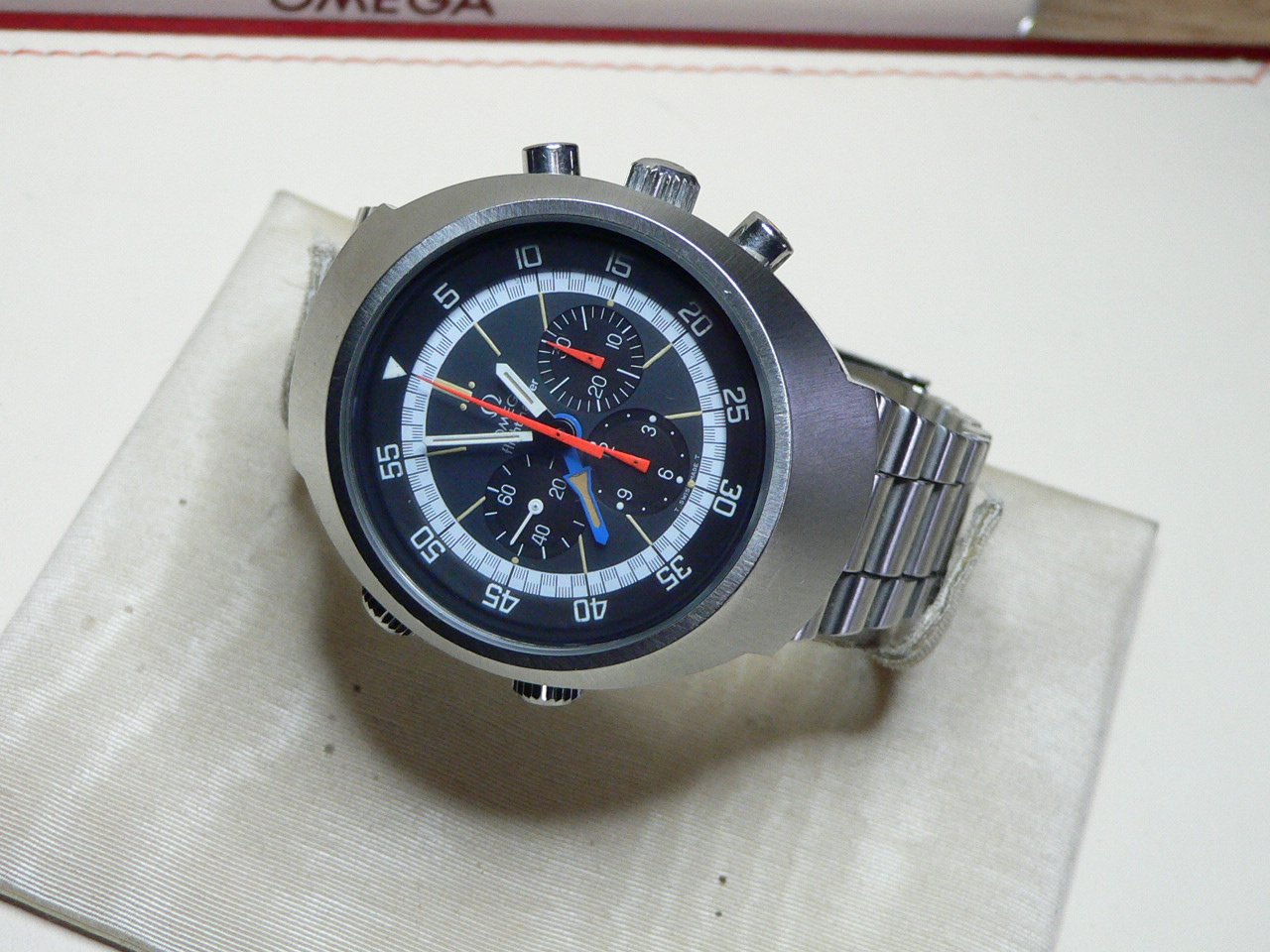

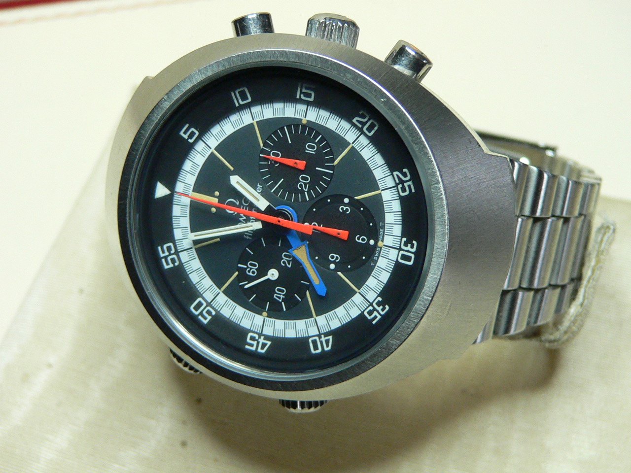

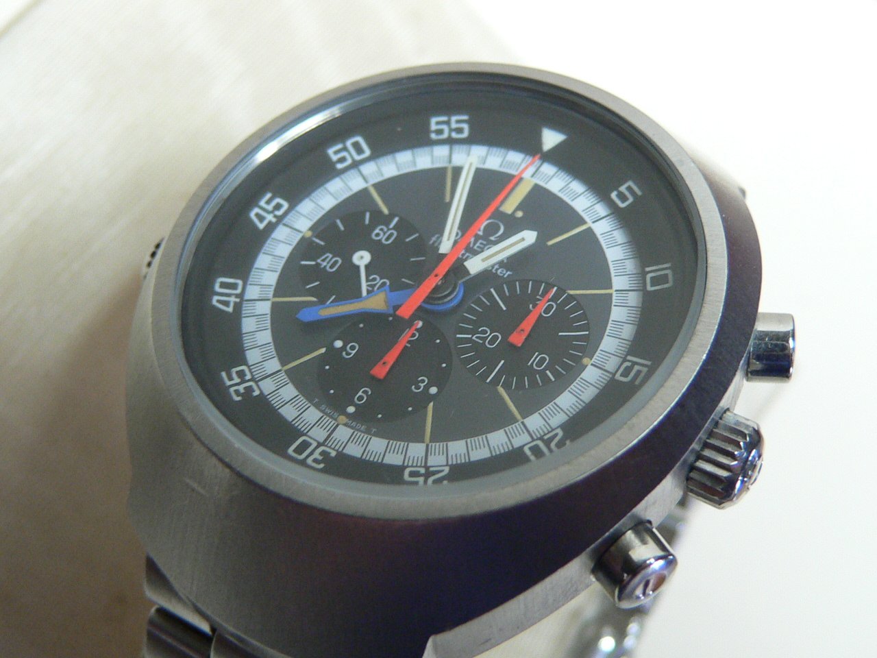

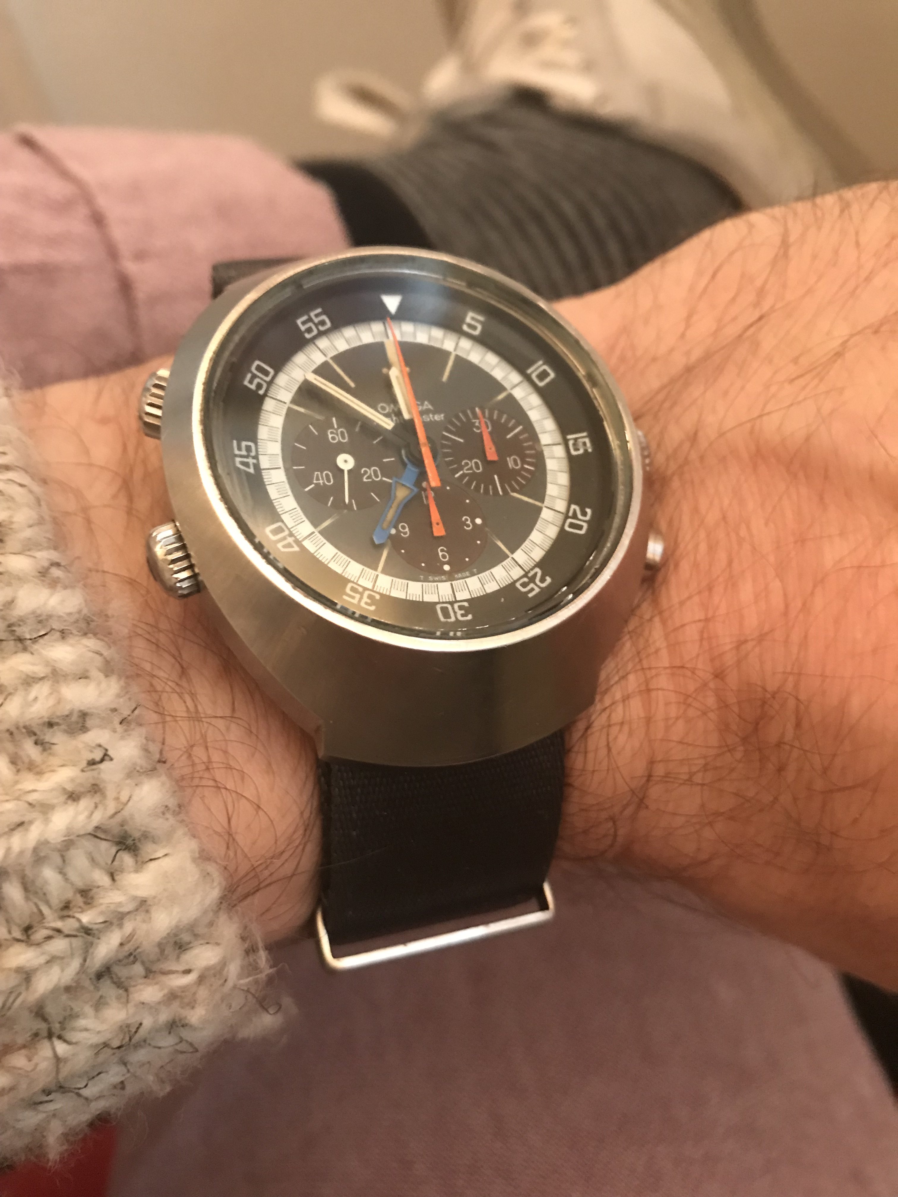

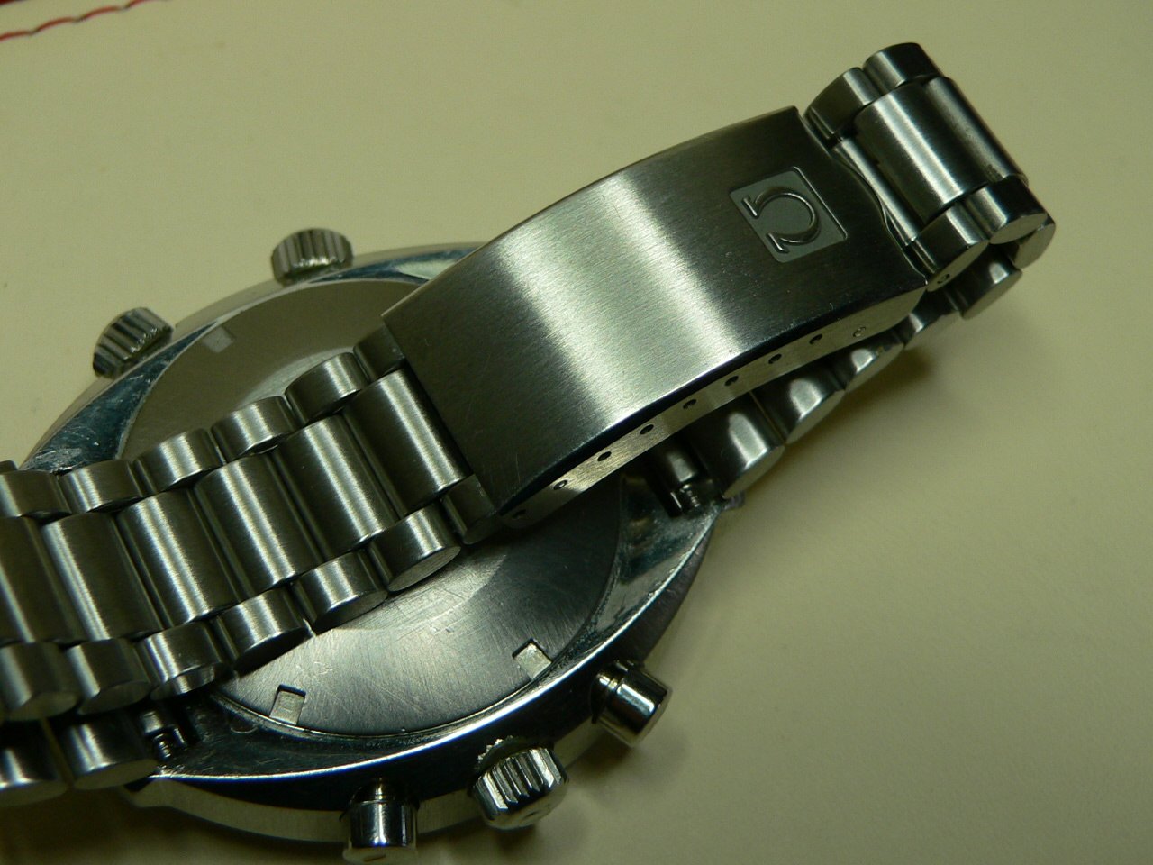

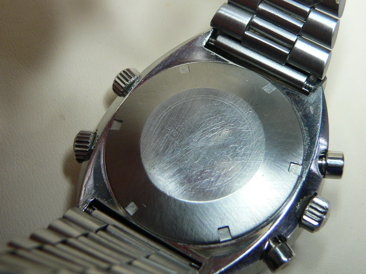

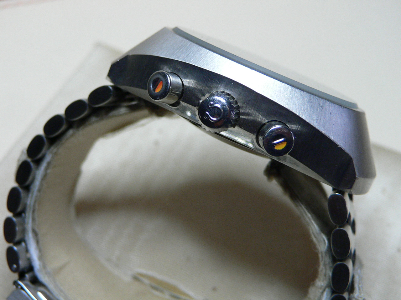

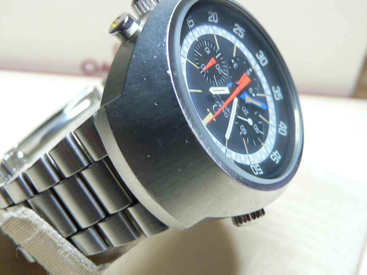

    The brown sub registerd Flightmaster with all the wristshots is mine and the grey one (pics P1280265-P1280274) with the white background is the proposed trade
    Brown +: great patina with brown sub registers, original condition, Omega Holzer bracelet, faded lume plots

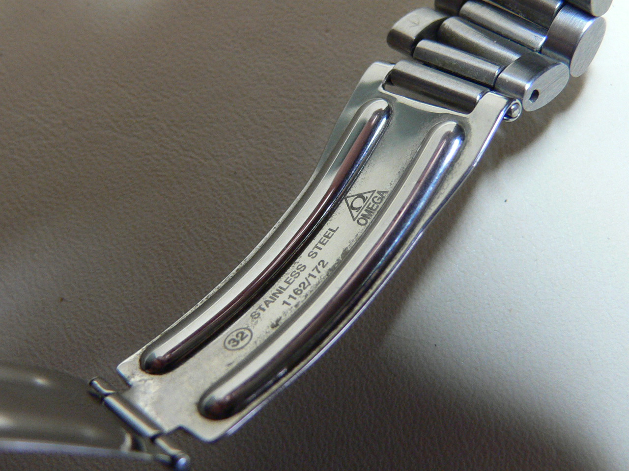

    Grey+: great overall look and patina, great original case, orginal 1162 bracelet
    Brown-/-: oil stains on inner bezel, irregularities on glass gasket, no paint on pushers, faded lume plots and faded /stained markers
    Grey -/- caseback looks a bit polished, not that much paint on all pushers
    So what would you do; stick with the brownish Flightmaster or do a trade?
    Many thanks!

    What you have here is an honest watch that has a wonderful presence and patina.
    Quite why the watch was sold to you without a full service is beyond me. (If a dealer cannot service a watch, just what are they for.) That so called inspection and guarantee are so much puff and nonsense it beggars belief that anyone with an ounce of integrity can offer it.
    All you need to do is get it properly serviced by a vintage dude. www.simonfreesewatchmakers.com is my choice but there are others including wwwswisstimeservices.com. Both of whom could refinish the case but I would NOT DO THAT. Your watch has a loveley dial and patina. I do not know if it is correct, but to me it looks a lovely vintage piece, that would be ruined if Omega serviced it.
    Flightmasters might be about to see a surge in interest, and therefore value. (New book, low price, currently a narrow appeal).
    I think getting rid of this one fast could lead to later regret.
    I suggest you service, and grow to love its imperfections of age.

    I would be very surprised if an Omega service center (or any decent/competent watchmaker) would have left the residue on the inner bezel when doing a service. Also the low amplitude and high beat error are signs that the watch hasn't likely been serviced recently. If it was, I would not let that watchmaker work on it again...

    What the OP actualy says is that the watch was checked (?) by an "Omega Service Centre".
    The guarantee is meaningless - it simply means that if you return the watch the dealer will have it fixed - and not necessarily serviced, and not necessarily by an Omega Service Centre. This is a typical dealer practice of showing willing without actually doing anything - after all many people will not return the watch to them for fixing when it goes wrong, so they save a service cost.
    I bet if you nail him down as to who he actually showed it to, there will be no paper trail, and perhaps not even an Omega Service centre. Perhaps a technician who once worked for Omega. Or a Shop that sold Omegas....

    I took this to indicate it had been sent back and worked on to some degree, not just checked...
    "After 2 weeks wearing the watch, the delay became worse 7- 8 minutes over 14 days= 30-34 seconds/day. So I contacted the dealer again and he was very OK wit hit and asked me to send the watch back for free. He arranged it and the accuracy was with a max. deviation of 4sec. with an amplitude of+/- 269 grd. Problem solved."
    Either way it clearly needs a proper service.

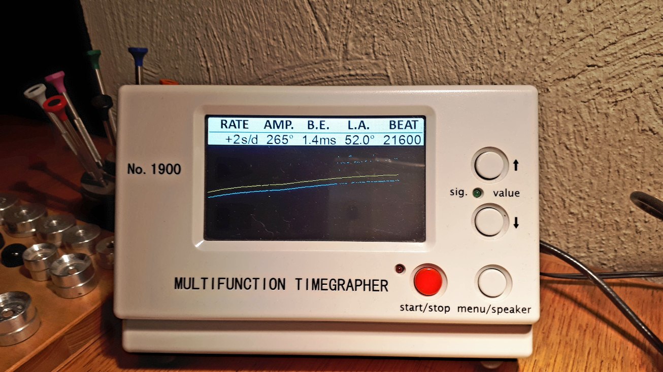

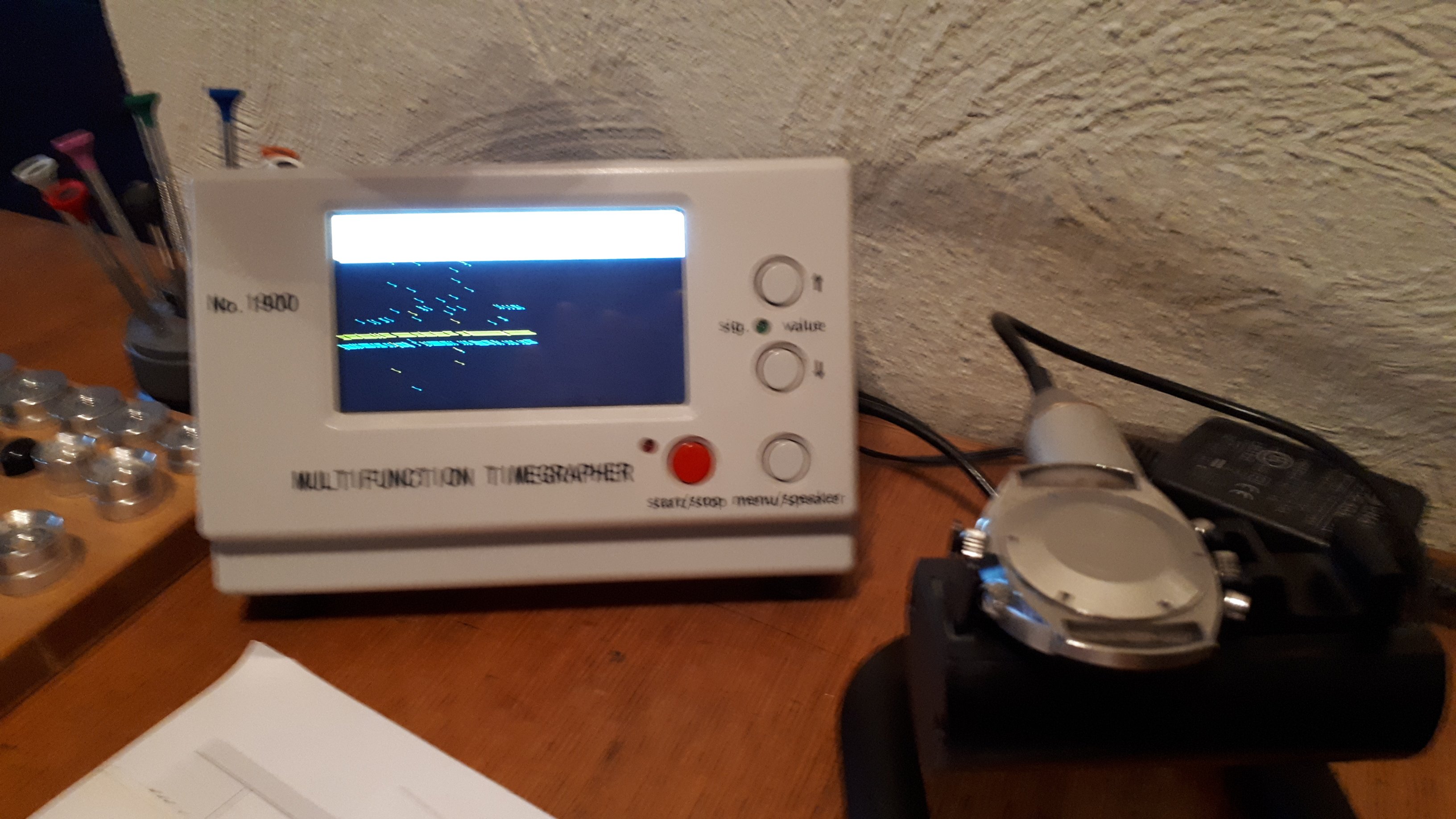

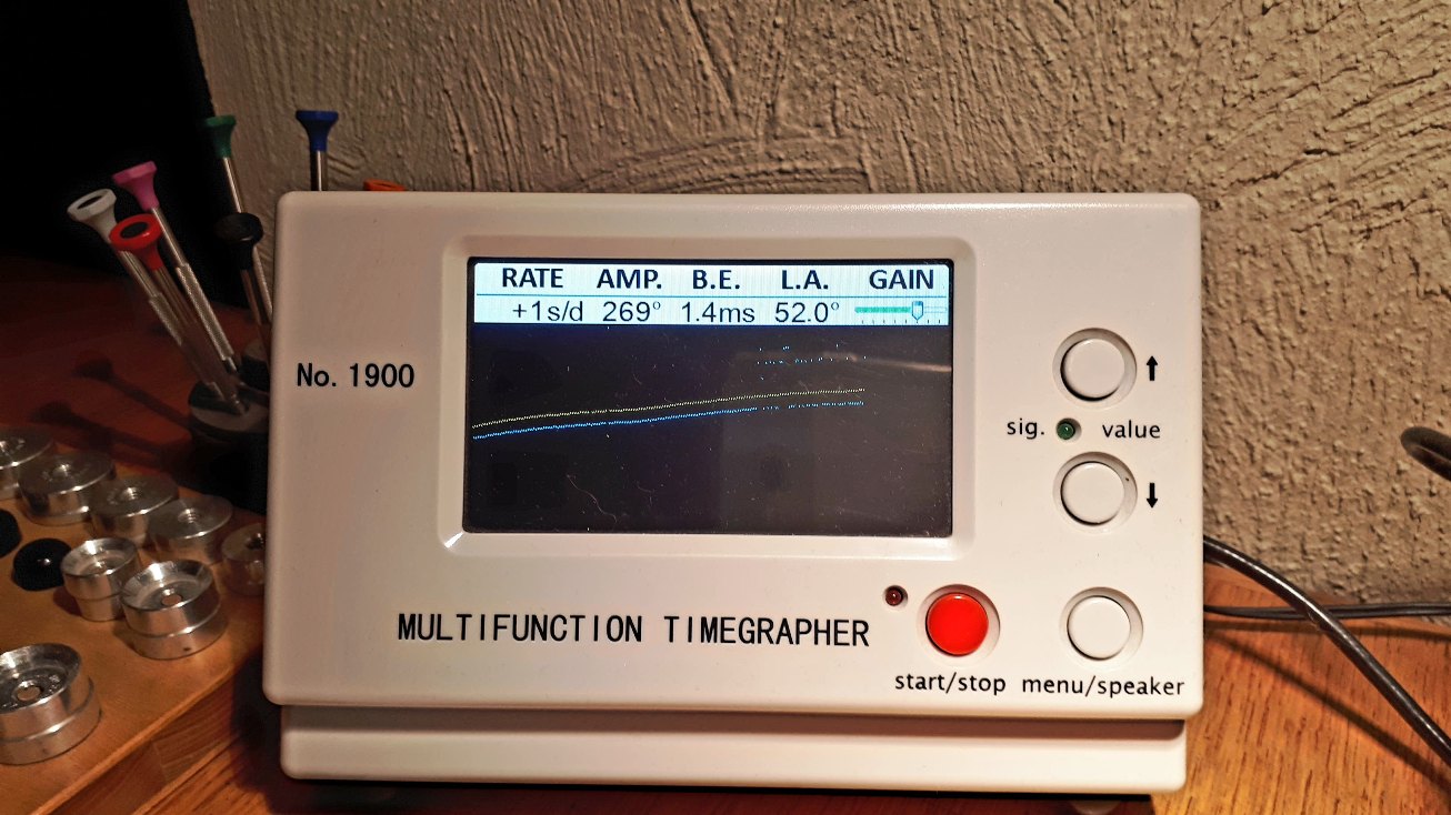

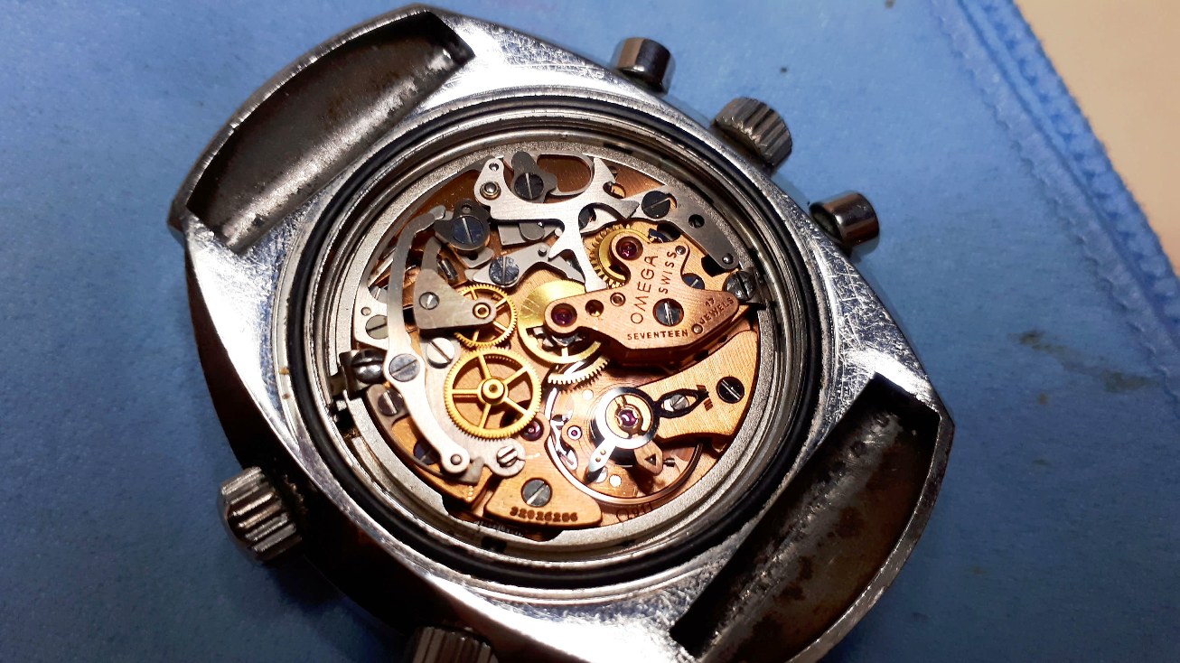

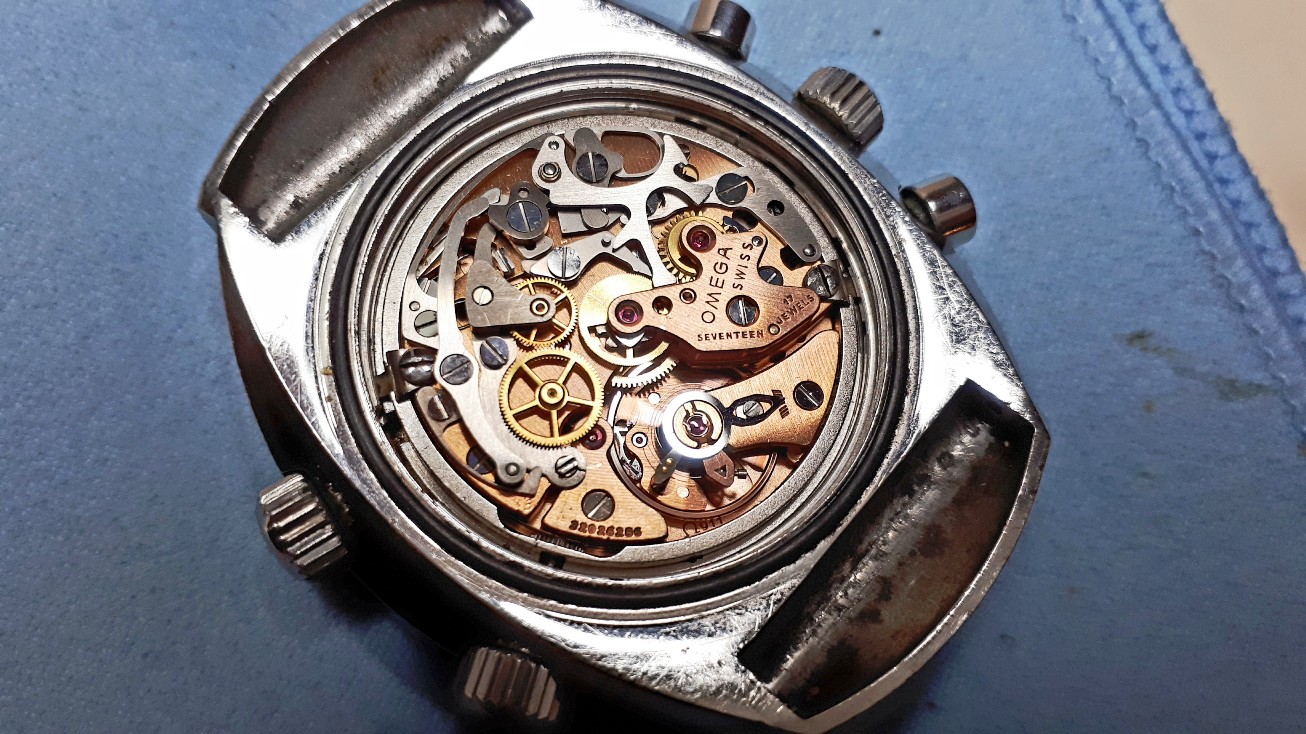

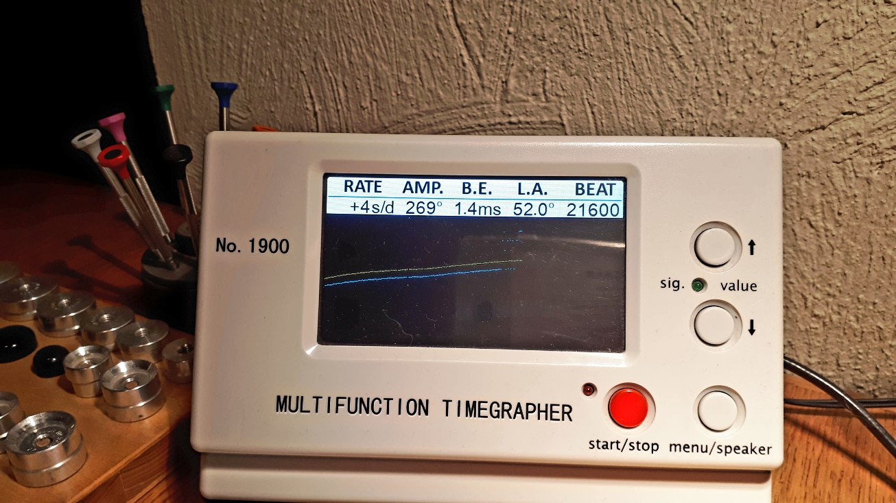

    These were actually the pictures that he had sent to me after the first complaint. The dealer always has been open to me that he does the fine afjustments by himself. He outsources the bigger issues and toal service to an offical Omega service center.
    So concluding he has only cheked the movement wihtout giving it a proper service and I will contact the dealer, to get it serviced by the Omega service center.

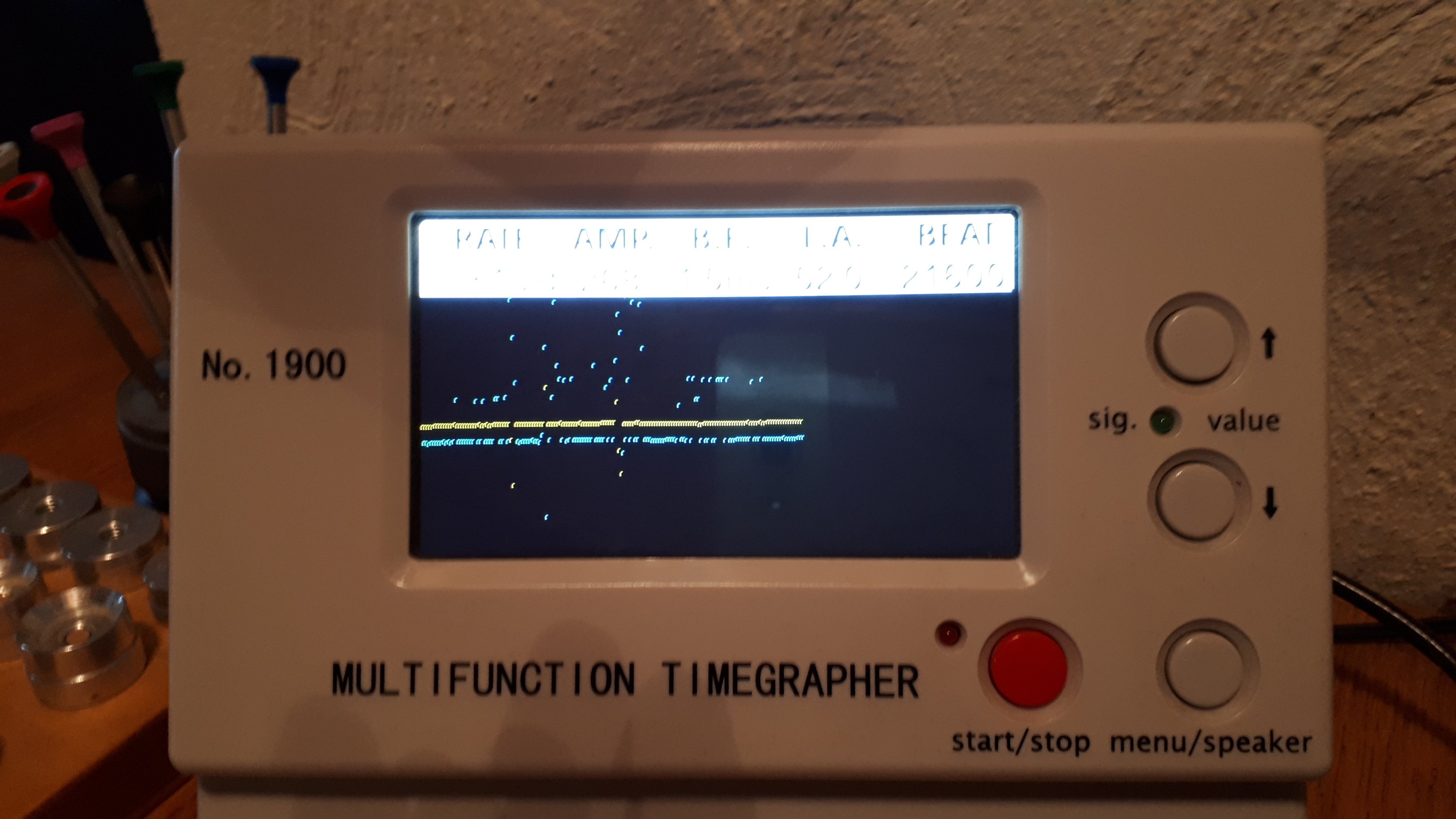

  12. Archer Omega Qualified Watchmaker Jan 16, 2018
    26,341
    65,042
    Lift angle is set incorrectly on the timing machine, so the balance amplitude is even lower than what is displayed - take another 10 to 12 degrees off what is shown there, so more like high 250's rather than 260's. Definitely in need of service if the watch is fully wound.

    Owning a couple of flightmasters, and having handled many more, the marks on the bezel are typically caused by the residue of a degraded seal - what a watch maker has used to remove the seal/how much there was stuck on the inner bezel can very much affect the way the bezel looks.
    I've also had both of mine serviced by Swiss Time Services - these watches are considered an Omega Cat 4, so at the more expensive end (towards £500 per service, including pushers, crowns, crystal).
    In your shoes, I would be asking the dealer for money to go and get this serviced by someone you trust... he's already behaving in a way which would make me feel uncomfortable.
