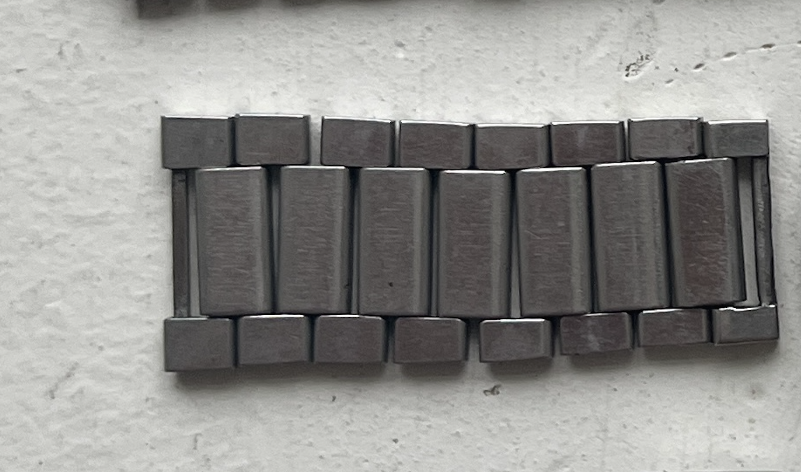

Hello,
I have a 1035 bracelet thats missing some fixed links making it too short so I'm looking for separate links / link sides / parts or incomplete flat link bracelets.
Should work with 1035, 1039, 7912, 1506 or 1067 bracelets
Let me know if you have anything at all! 😀
So something like this I'm looking for, but can also be in parts

If you are looking for proper fitting fixed links you need to stick to 1035 or maybe a 7077 for donors. Both 1506 & 1039 will have different sized fixed links than the 1035. Not sure if the 7077 will work but they have a shot. (I don’t know the 1067 well enough to say)
Spring links are a different story, mostly interchangeable between 1035, 1039, 1506.
2,270
15,731
Measured on a NOS 1035 bracelet the fixed links tapers from 17,8mm on the last link down to 15.8mm on the link closest to the spring links.
My 1506 tapers from 19,7mm down to 15.8mm.
1506 and 1039 are basically the same bracelet as well as 7912 and 1035 so I'm pretty confident they have the same measures except the few last links closest to the endlinks which are wider.
7077 are constructed different so the links will not be interchangeable.
Long answer but its the fixed links closest to the clasp I'm looking for so they should be around 15.7-17mm wide 😀
