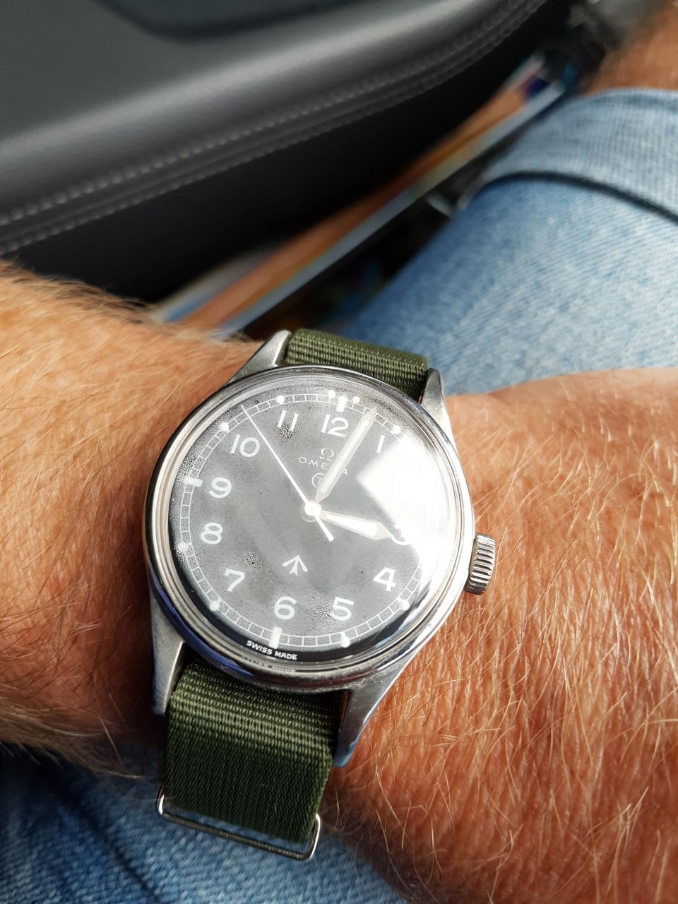

Another question if I may gentlemen.
Did the original Fat Arrow's have a glass crystal?
Reason I ask is I wore the watch last night and scuffed the face whilst shopping in the Trafford Centre in Manchester. Not badly, just a glancing blow.
I popped into the Omega shop to see if they could polish it out.
The guy tapped the crystal, took the watch and returned with the scuff removed saying they have a solution that removes blemishes off plastic glass.

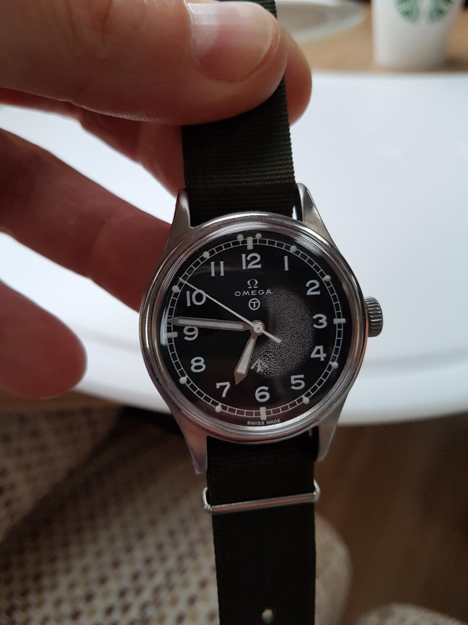

Keeping you busy now guys, another question if I may.......
I wore my watch at the weekend whilst it was raining and the crystal steamed up as shown in the pictures below. Should this happen? I know the watch is old but after the work its had, which included water resistance and pressure testing, I feel it shouldn't.
What are your thoughts or experiences?

I would not have expected the watch to be water proof. If they told you otherwise then you should certainly take it back to them.

I think you better take it back to the shop. The condensation will damage the dial.

Not necessarily. It depends on how much moisture have entered into the watch. If it is only minor it does not need to damage the dial. Also as @MCC say, one should not believe that this kind of watch is water proof, and I assume that the test was not at any high Atm level...
@Brindlehill you should "open" the watch as much as you can - pull out the crown and take away the case back. Then let it be for a day or so. Then put back the case back and test to put something could on the crystal (like ice or a frosen piece of something) shortly just so that it gets cold (and not too wet). If the crystal steams up again, it is still wet inside. Good luck!

You can see the moisture in the photos, and I would not consider it "minor" based on the photos.
Also, recommending that someone remove the back off a watch that is likely still under warranty is bad advice. If it was pressure tested and passed, it should not be fogging up like this.

Hi!
I know you are skilled and will not go into any debate!
However, I did not say it was minor, only that it did not necessarily mean a damaged dial if it was minor. I cannot juge if it is minor or not.
Why is it a bad advised to remove the case-back? Is it better to let the moist be kept in the watch? Sure if you open the caseback it might not be water proof after but it seems that it is not anyways. I have myself got a steamed crystal and solved it by removing the caseback and letting it "air out".

Because the watch is under warranty and opening it will void the warranty, and eliminate any recourse the OP has with the service provider.
In addition, just opening it and letting it "air out" is not enough to limit damage. You also have no idea what the skills of the person you are suggesting this to has, and they could easily do more damage than good by doing as you are suggesting.
And to be clear, I never said it should be left as is - he needs to contact the people who serviced it and go from there.

Hi,
Ok thanks for your answer!
I appologise for the bad advise! I got the same advise when it happend to me and it worked so I though I should share that when I saw that the watch have had the moist for a while as I though it would be bad to keep it that way. I did not think about the fact that it would limit the warranty, nor that he possibly could not open the case-back in a fairly safe way. My bad!
Then I hope he did not follow my advise (that of course was with good intentions) and will think more before I give advise in the future.
