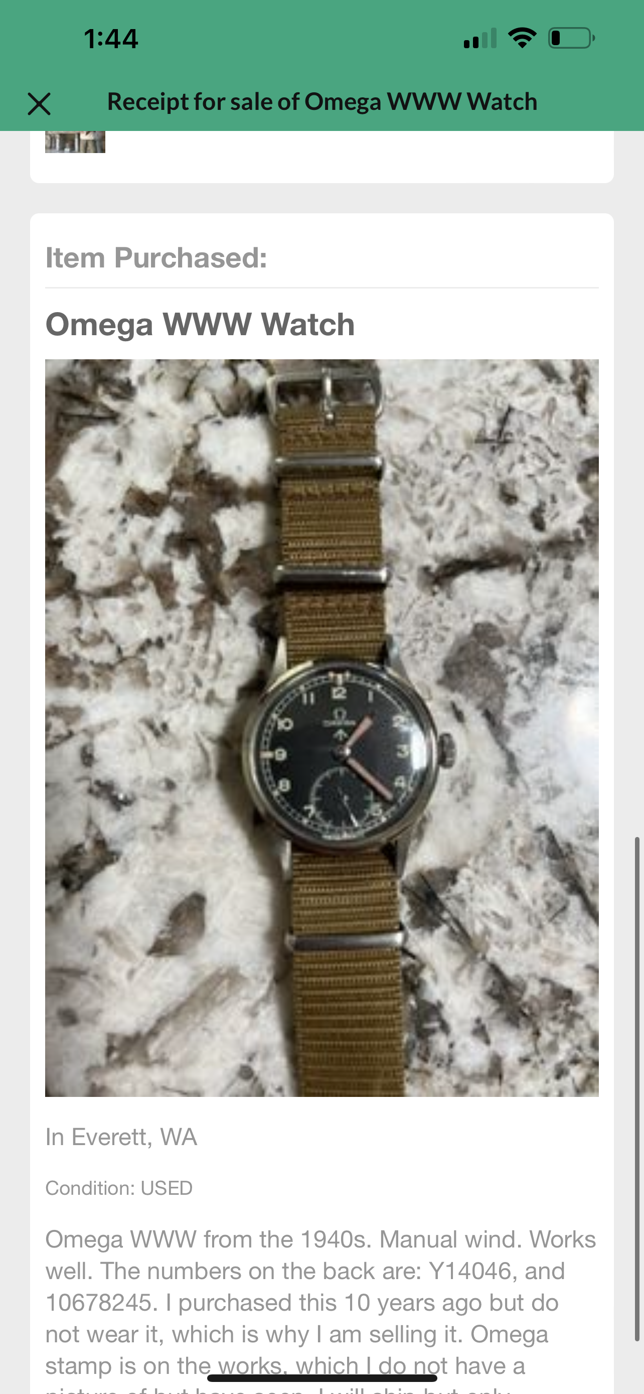

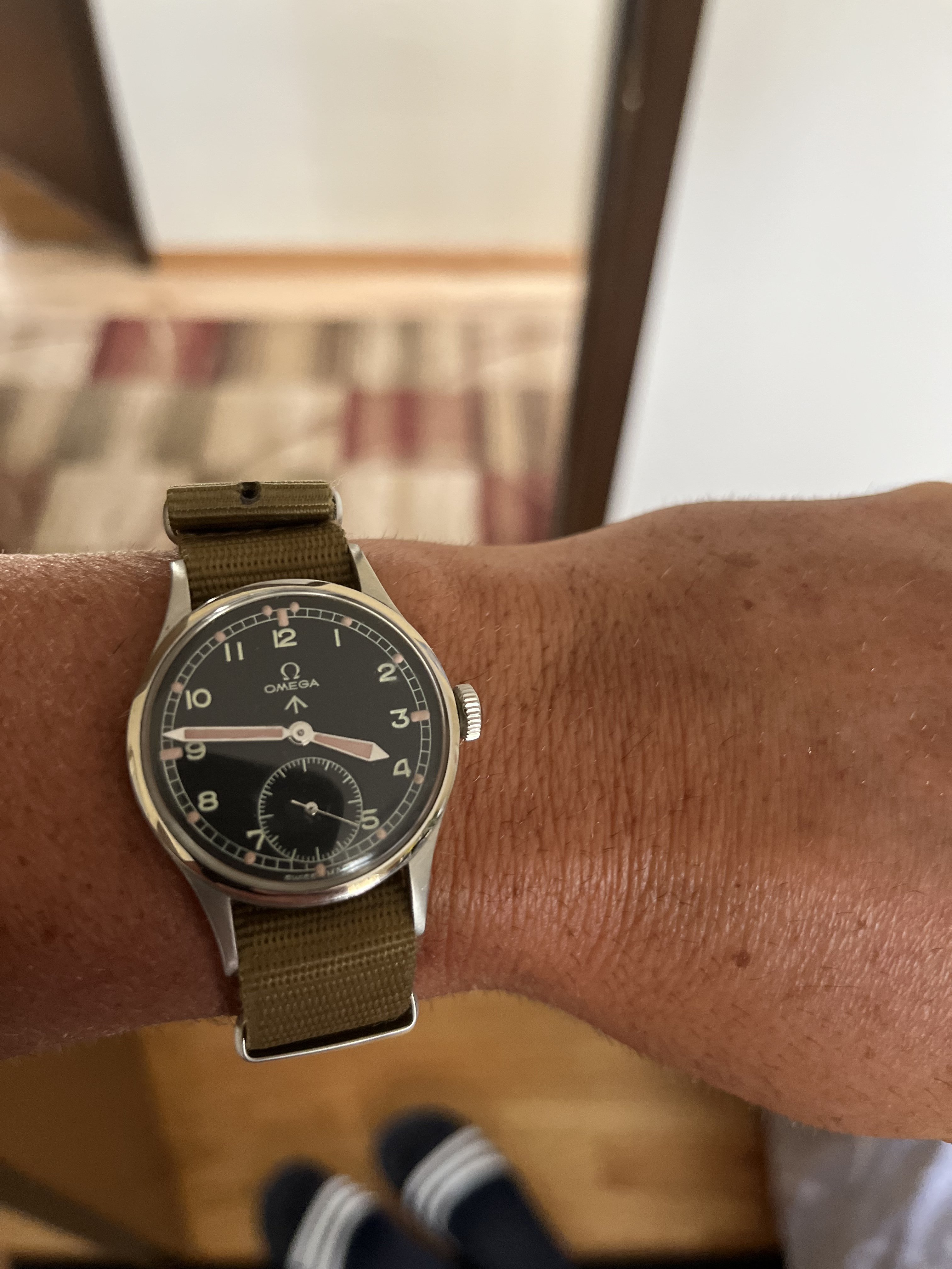

Hello I bought this watch for 600 . But wanted to confirm dial and hands are replacements or re-dialed . Any info will help please and thank you ! Movement and case are genuine of course .

Dial is repainted. Wrong Font and Arrow. Lume colour matched ; they never Age that way shown here. Pictures from inside and outside of the case back needed. Plenty of examples on the net. You will find and see the problems.

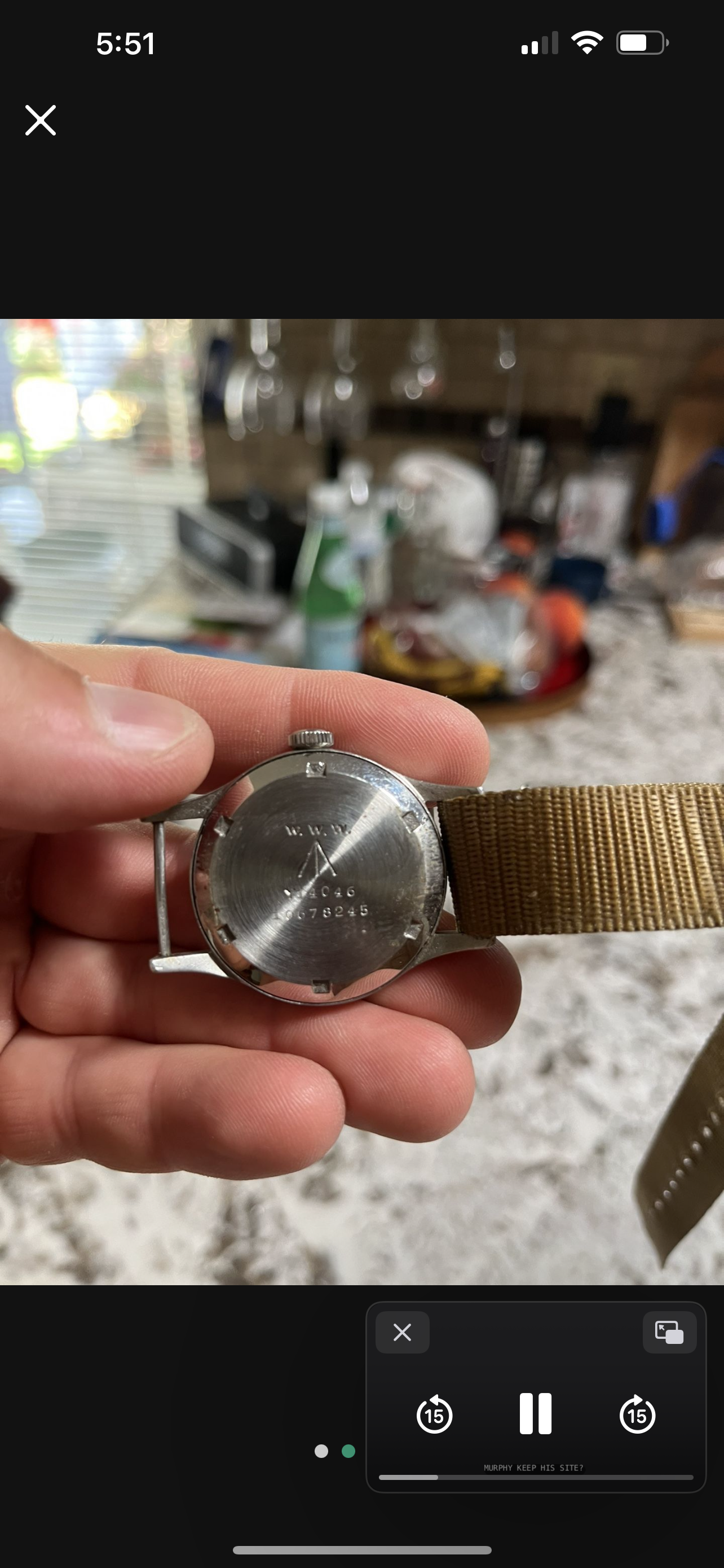

I thought so . The best part is I have a replacement MOD dial so that should sum it up. This is the case back

waiting for the watch to arrive . Does have correct 30t movement . Just don’t have pictures on the inside of caseback.
