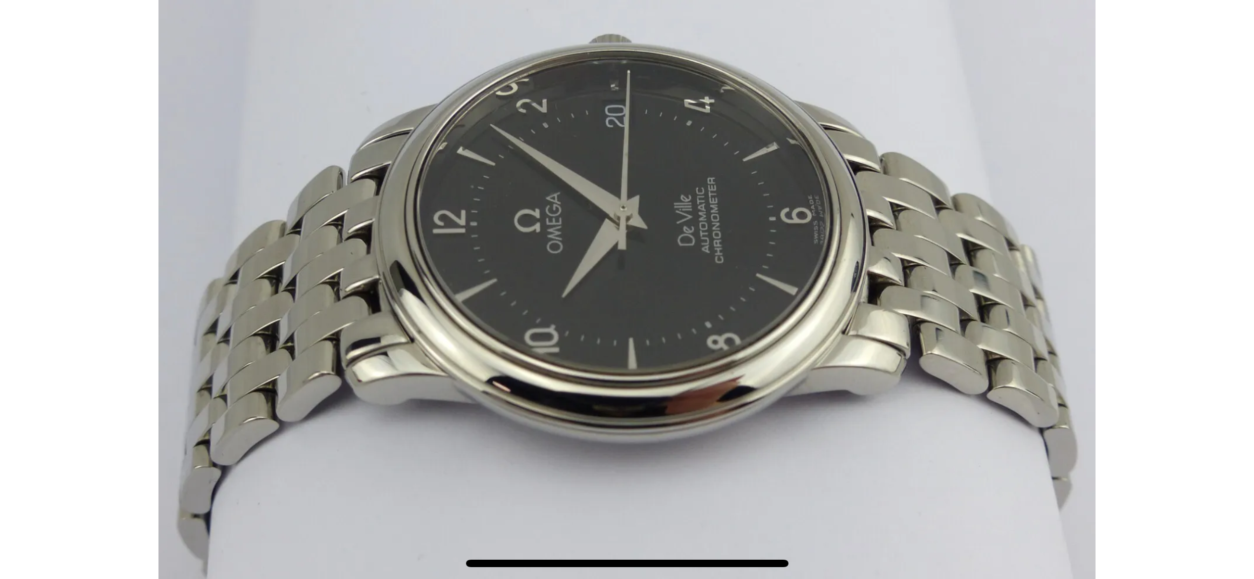

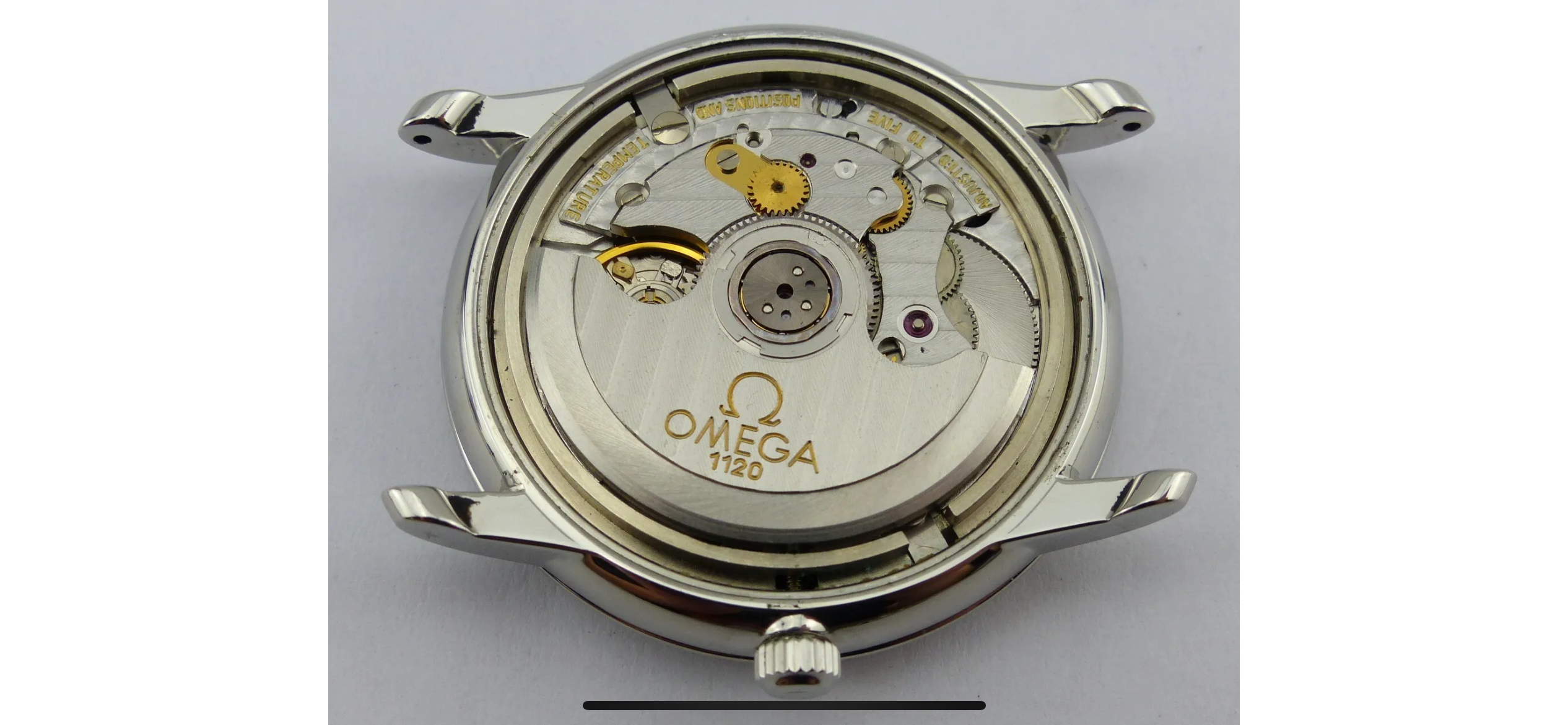

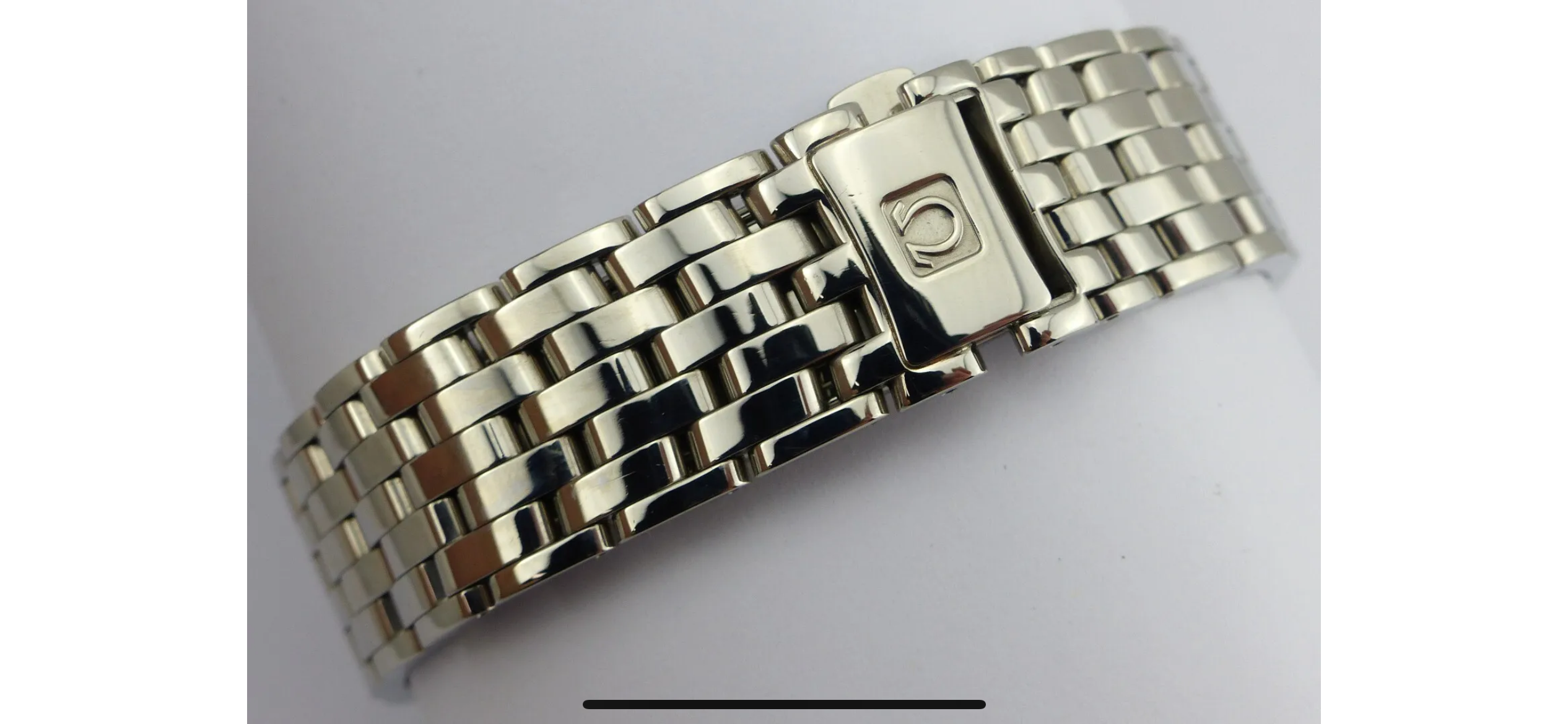

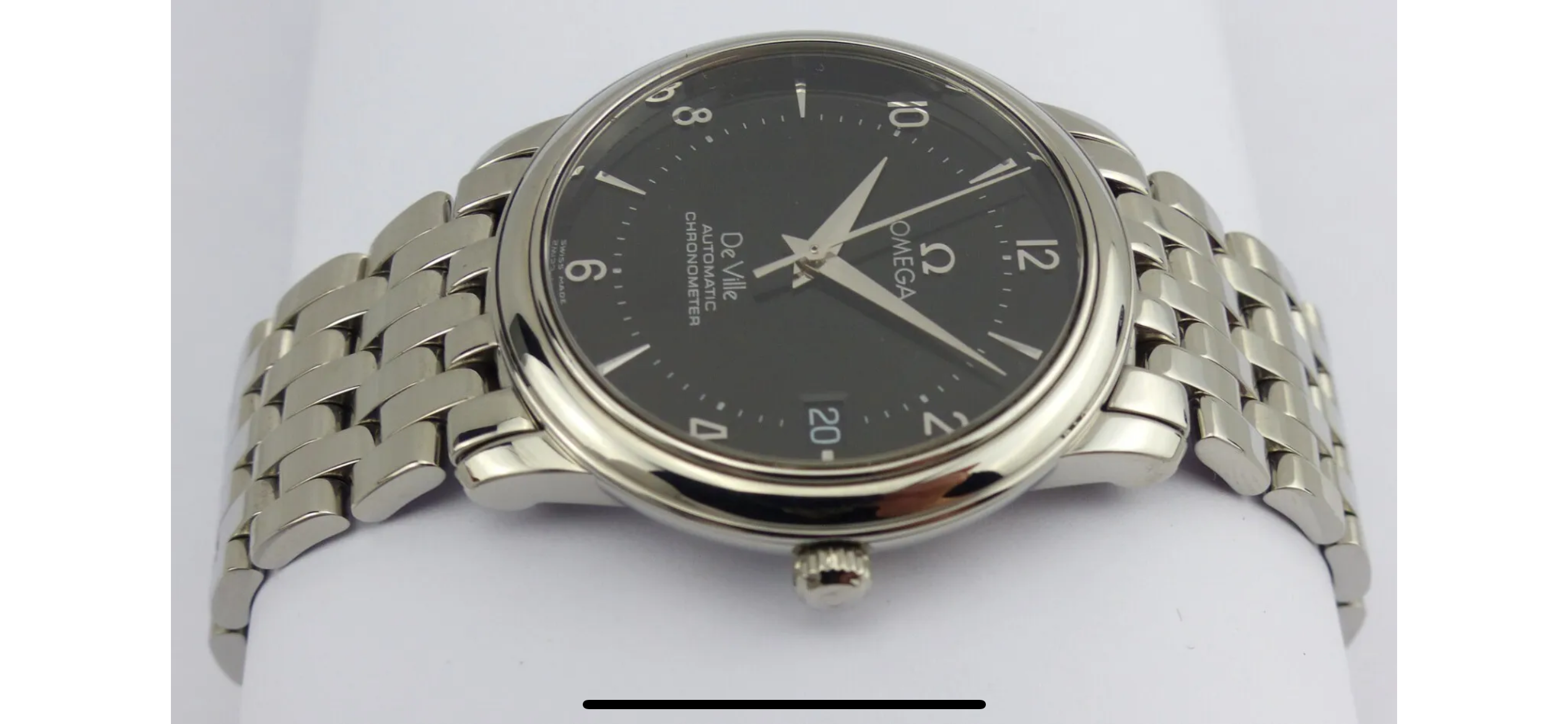

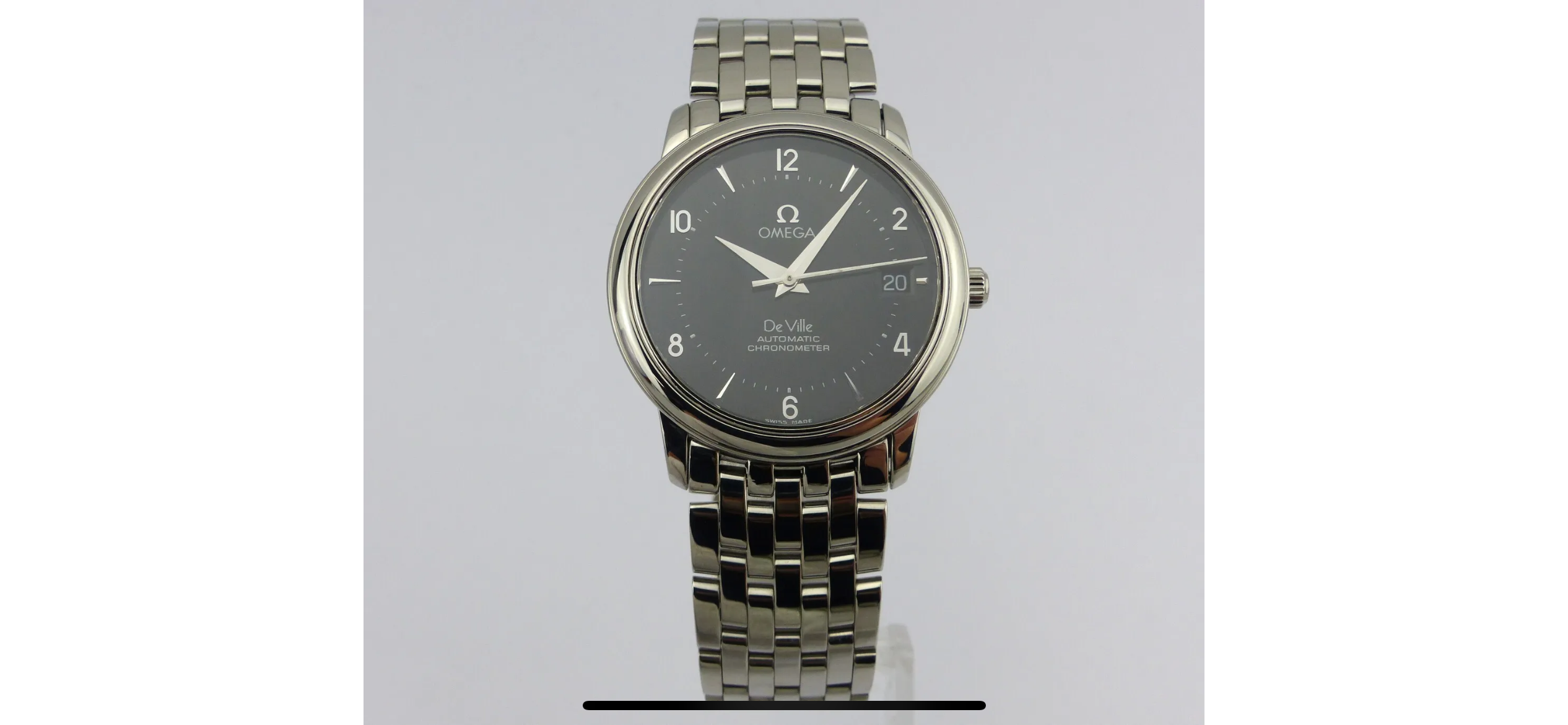

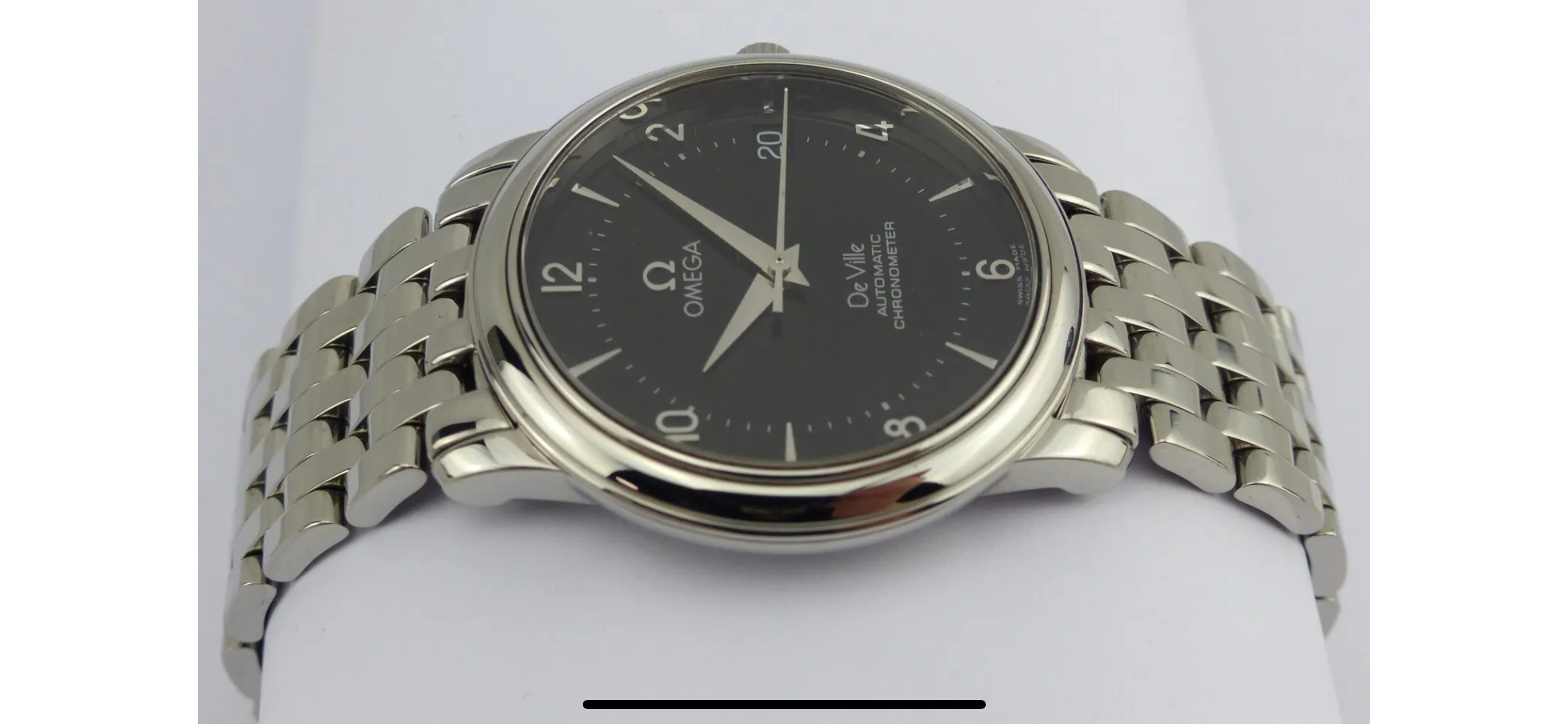

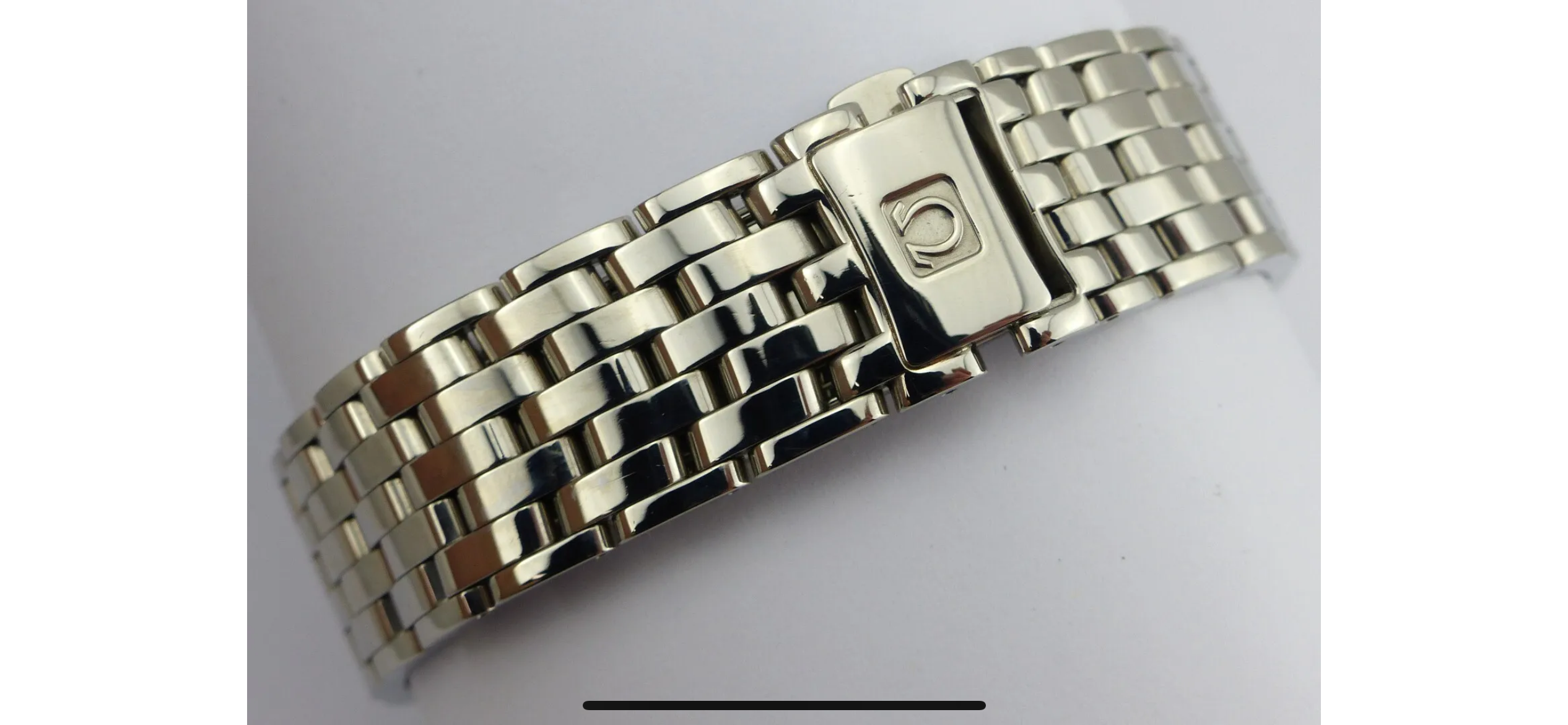

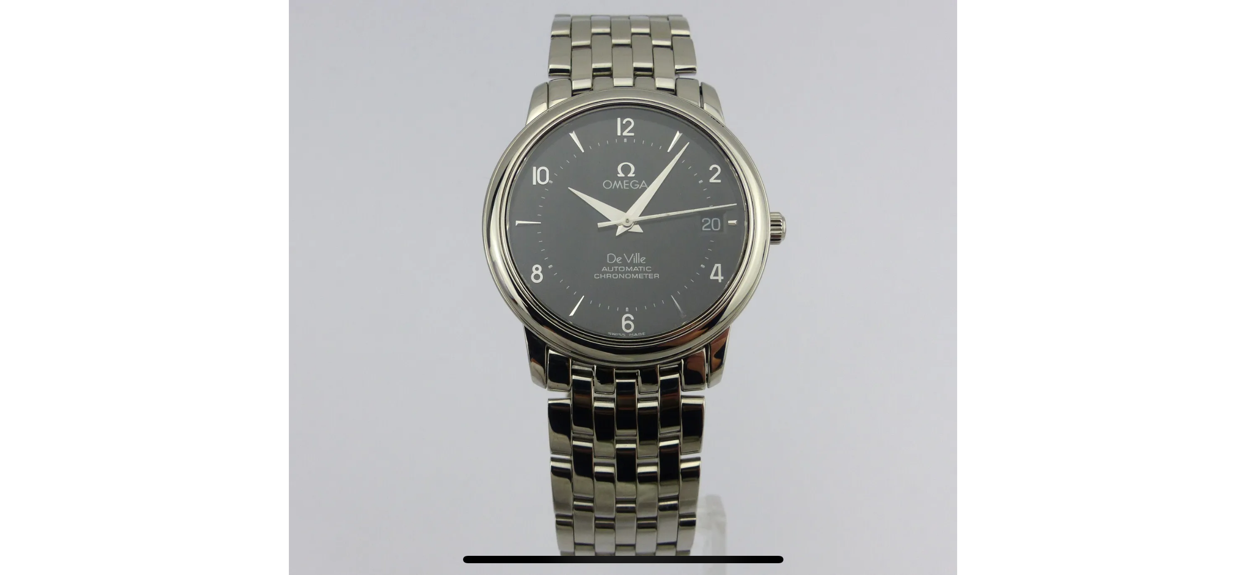

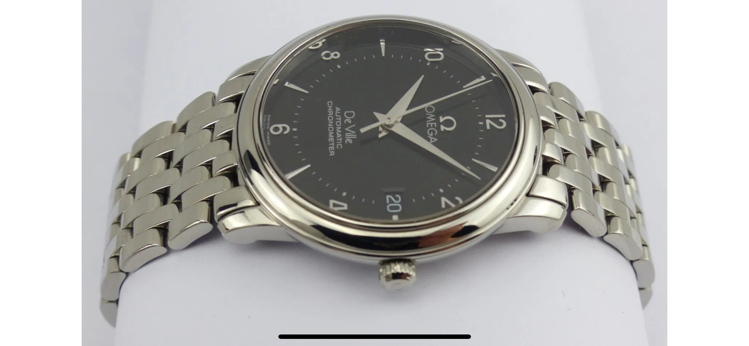

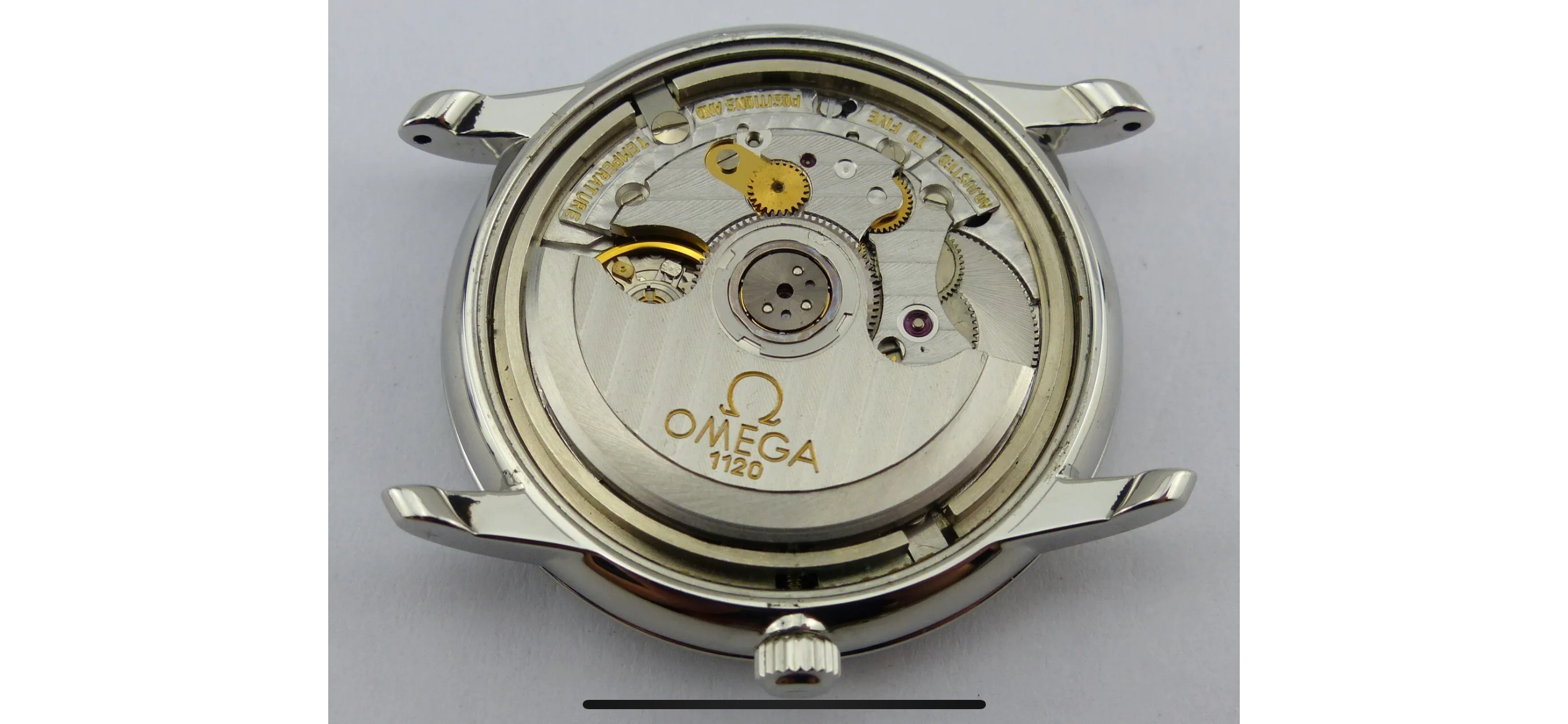

Hey there,
what du you think of this watch? I found it on eBay (1590 €).
This is the description:
De Ville Prestige Chronometer Automatic
Reference 4800.50.01
Stainless steel case.
High-quality automatic movement, Cal. 1120.
Officially certified chronometer of the C.O.S.C.
Black dial with silver indices.
Silver hands.
Sapphire crystal.
Case diameter: 34.7 mm (without crown).
Omega steel bracelet.
Concealed Omega steel folding clasp.
Suitable for wrists up to approx. 18.7 cm in circumference.
Condition:
Good, well-kept condition with moderate signs of wear.
Second hand minimally stained.
All functions flawless.
Accessories:
None.
NO BOX, NO PAPERS !
I’m always suspicious when there is no box and no papers.
Do you think that the price is ok?
What is the year of production and is it worth buying?
Thanks for your help!
Best regards
Peter

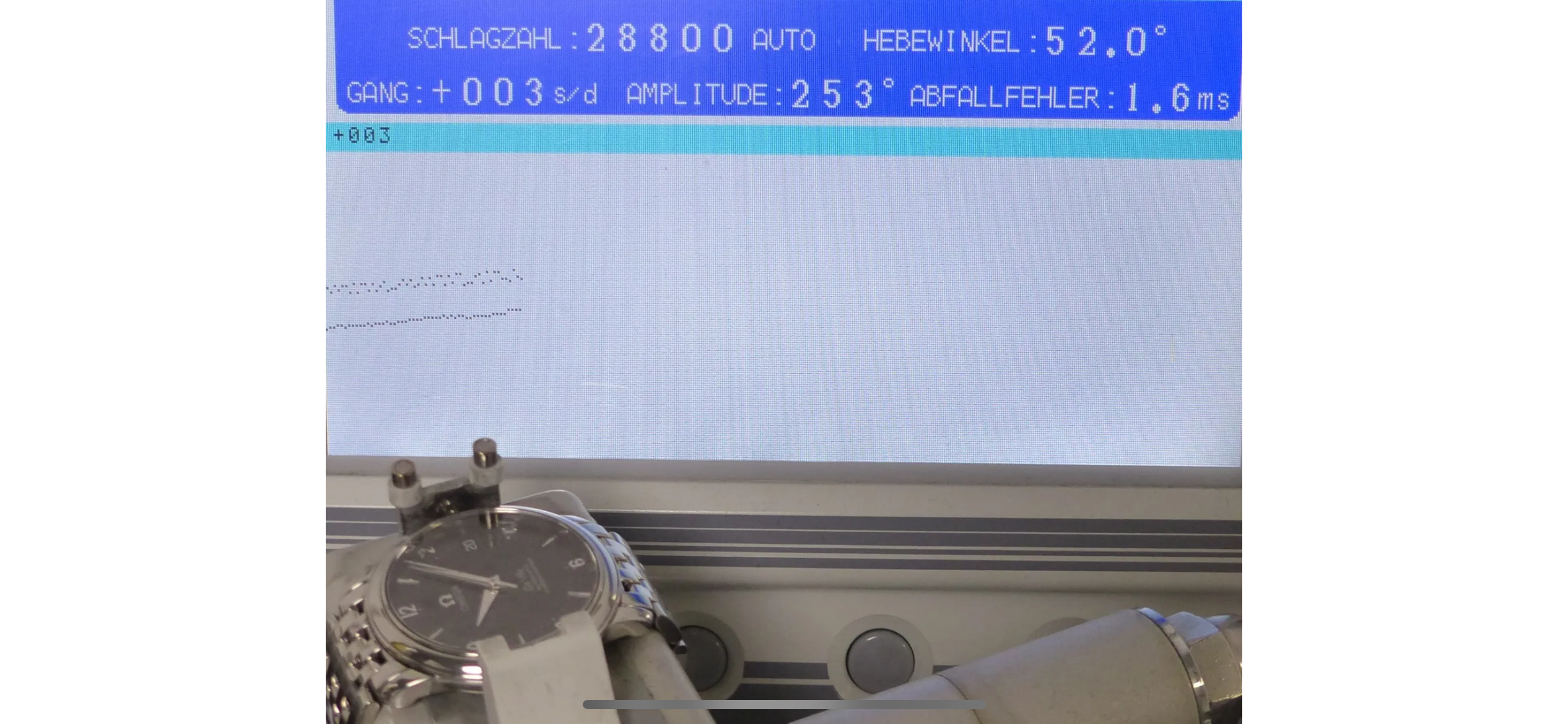

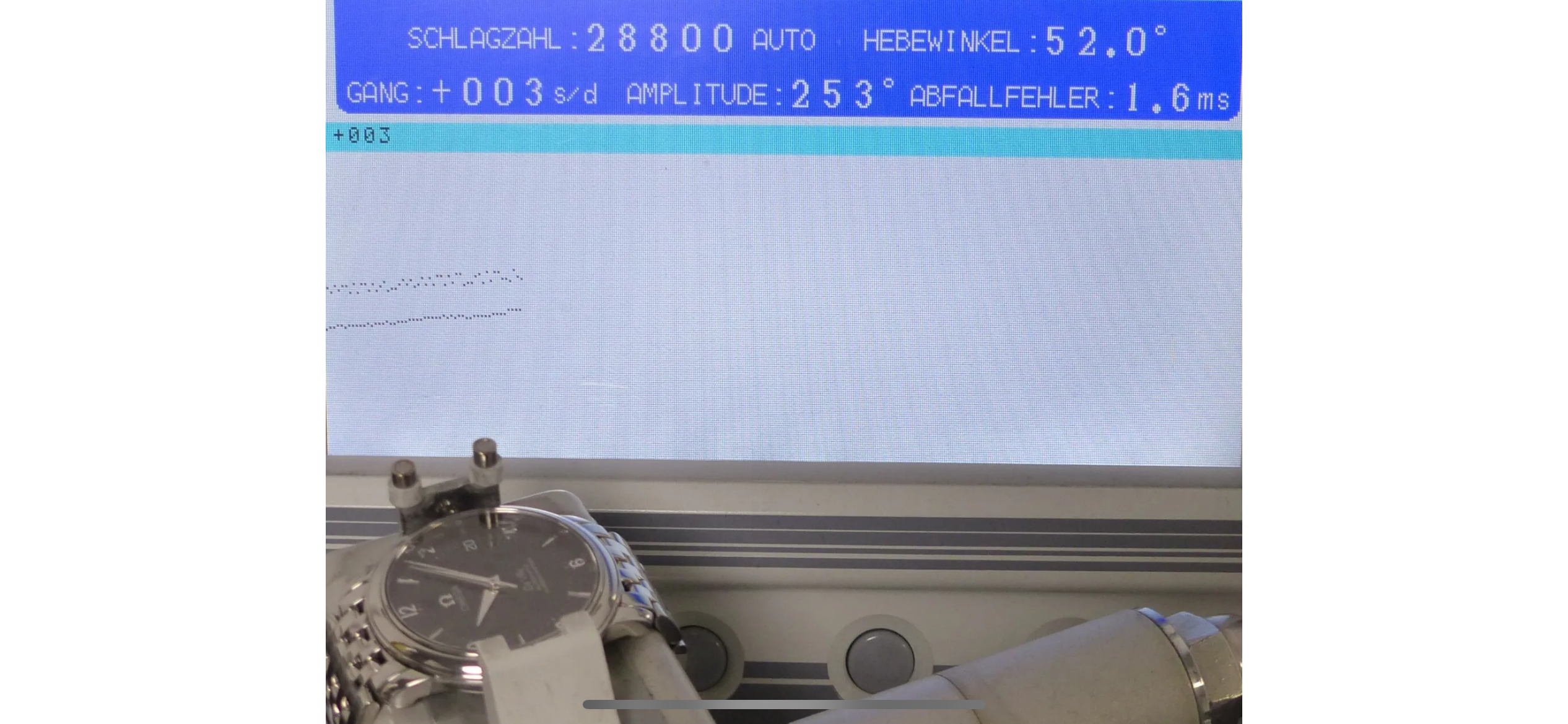

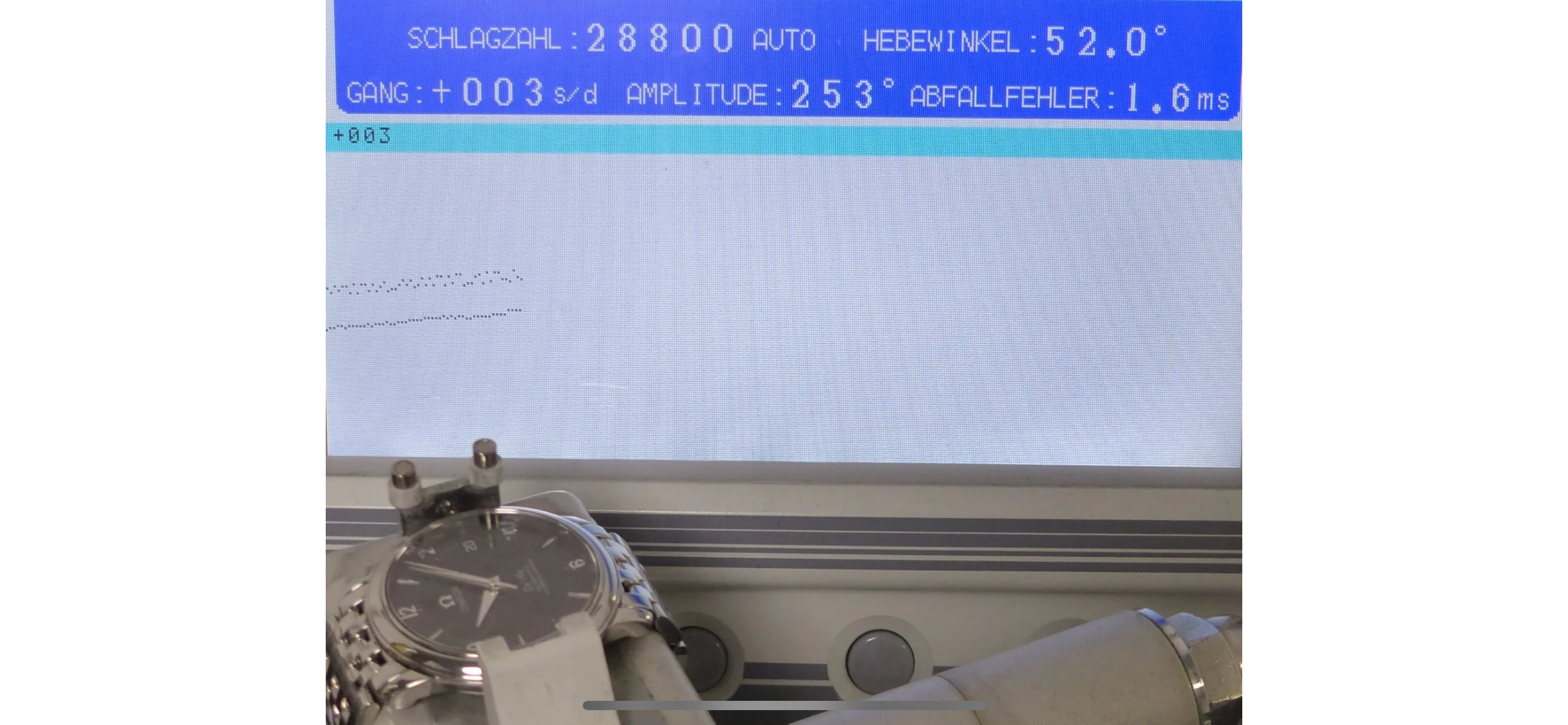

Are those values OK or would you be sceptical?
Would you recommend a service?
+3s/d is fine and the amplitude is ok as well. But the bear error with 1.6ms is quite high? Should I be worried about that?

The amplitude is actually low for this movement in the horizontal position. Also, looking at the dirt around the barrel area, a service is definitely in order.
Ok, thanks for the information.
I can get the watch for 1300€ and can return it if I don’t like it on my wrist. I’m going to by it. 😀
