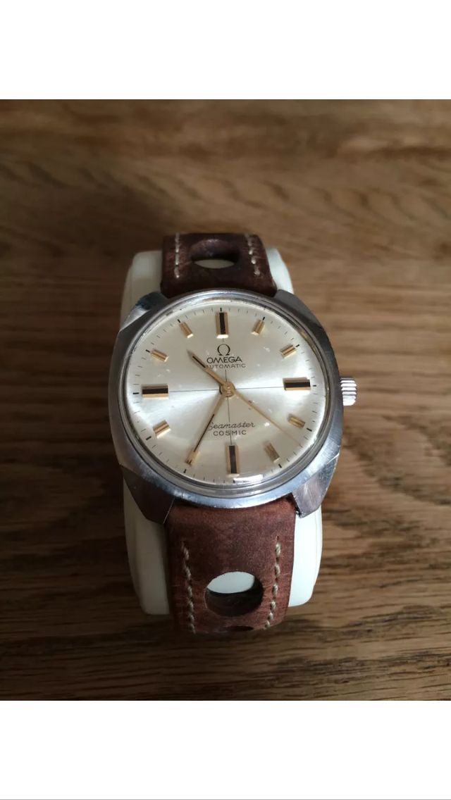

    hi I'm hopeing to buy my first omega cosmic cal 552 any help and advice would be appreciated ... image.png

    I'de just say, ask for the reference number. Be aware that some of them need a special tool for openning which can be a pain when you just need to regulate it.

    Is that funky stuff on the dial or on the crystal?

    That's actually one of the first cosmic I visually like... (normally too late 60ies/70ies for me).
    If the price is good go for it

    Because they are front-loaders, with no good way to release the movement from the case, at service etc, they often has damages to the dial. Especially at 12 o'clock

    What I should have said also, is that I have seen quite many Seamaster Cosmic with damaged dials, to draw the conclusion that the movement is not easy to remove (without a proper tool).
    So, to OP, when buying a Seamaster Cosmic, carefully check the dial for damages
