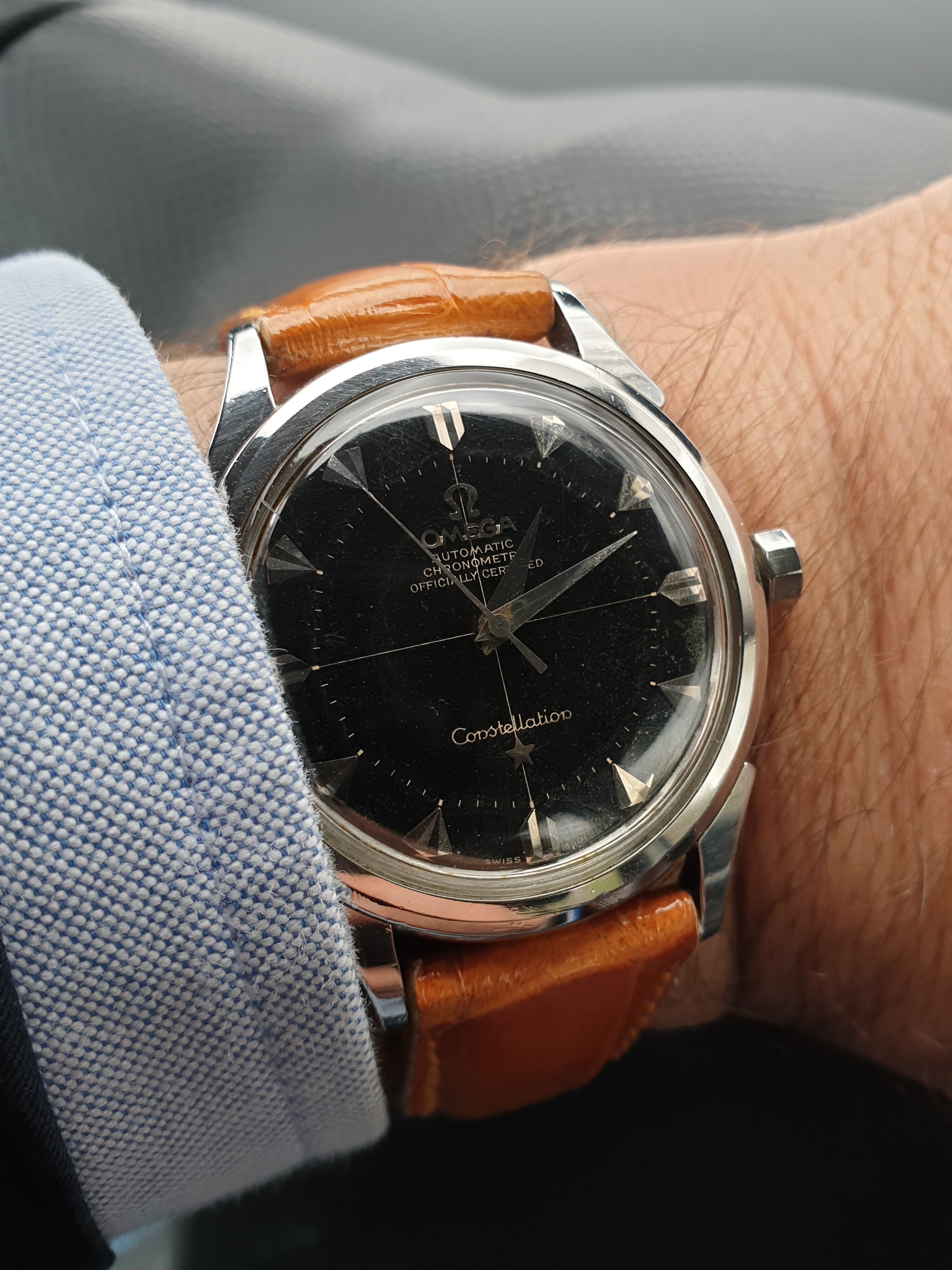

I am looking for my next Omega and was wanting a vintage Constellation (No Date) pie pan if possible. What calibres does anyone recommend, which movement is better?

You have a limited choice with those requirements.
2852
14381
14900/167.005
The earlier 2852 will house a cal 501 / 505
The others will be driven by a cal 551
The later movt will be easier to find parts for as it was produced throughout the 60s.
You would have a larger selection of case styles if you included a date complication.
Hope that helps.
