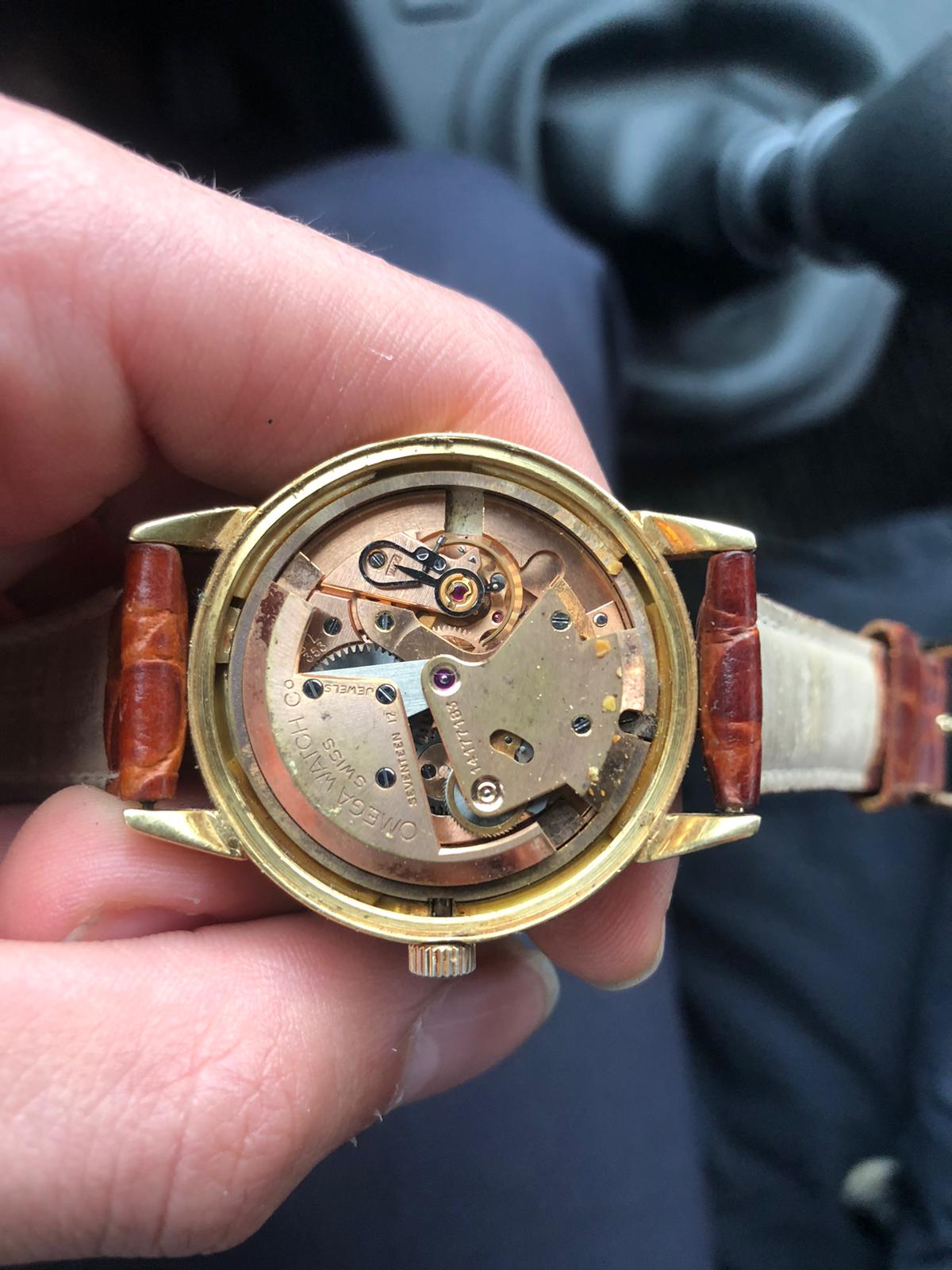

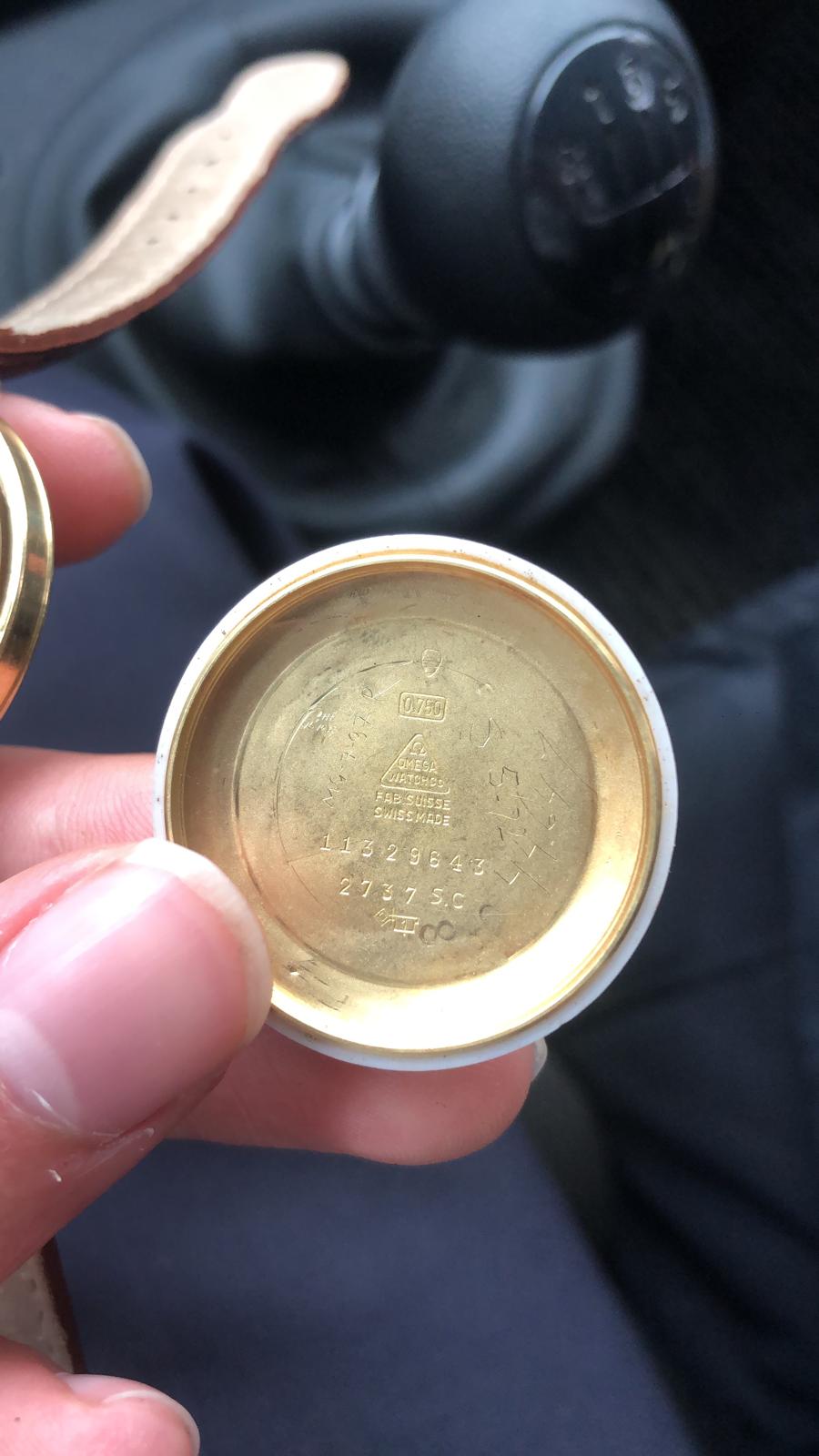

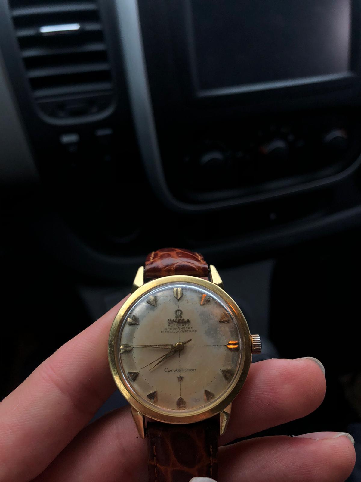

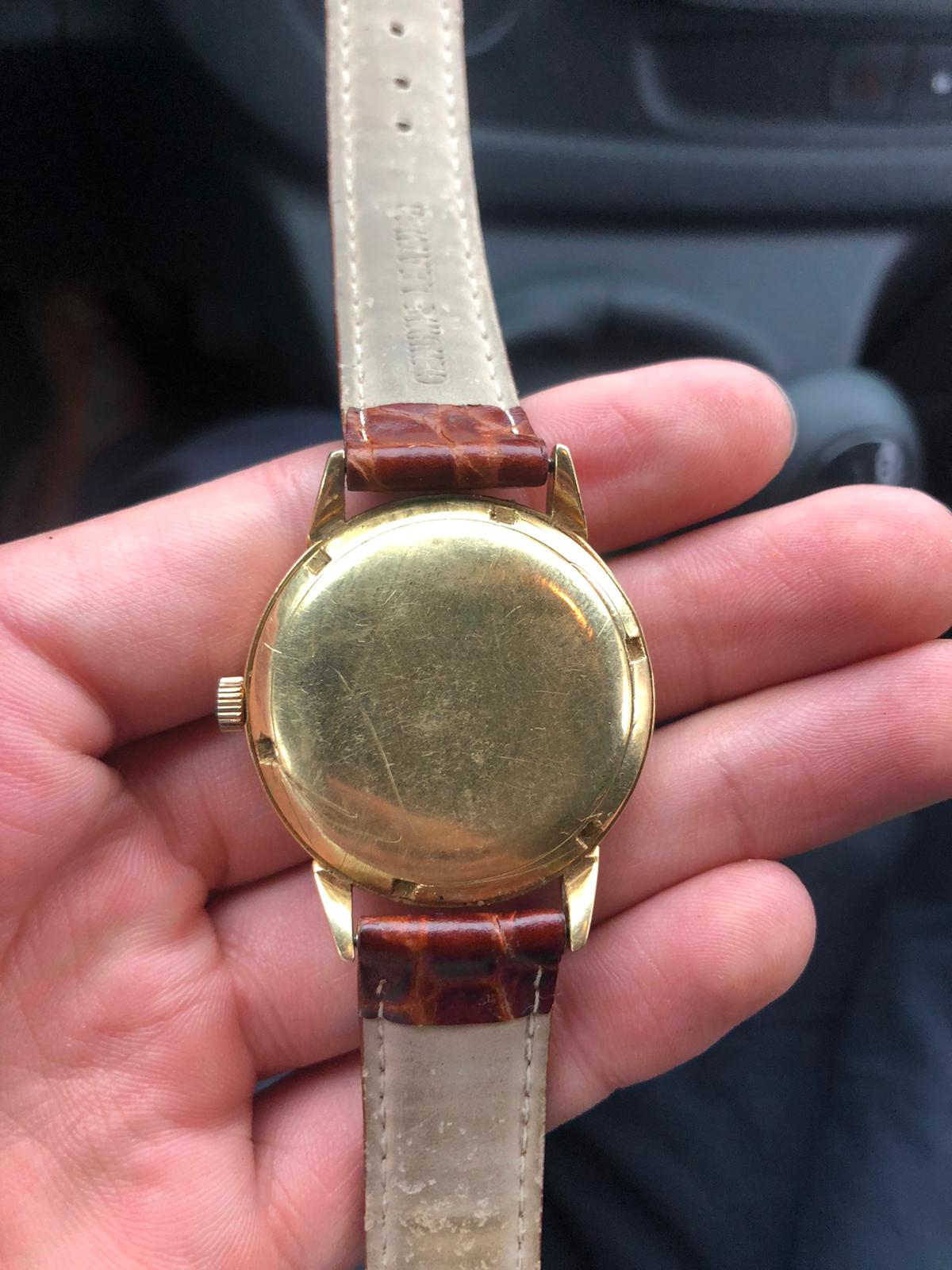

Hi everyone,
I stumbled across this piece. While at first I thought it was worthless and in very bad condition (i still think it is in very bad condition), I had some time to spare and started doing some research. At first I couldn’t find any early constellations with the 2737 case, just some unnamed omegas. Then I came across a post from Desmond mentioning that he had seen a constellation with this case just once.
Since omega messed around with the cases, dials and movements in the late 40’s early 50’s I thought that maybe this could be one of those very early constellations. What i find weird is that the movement is a 353 movement, shouldn’t the 353 always be a ‘date’ movement? Dials seems, all be it in a very bad condition, original.
So it’s either one of three things:
A very early Connie and quite a rare piece.
A rare 2737 18k case with a different movement and dial put in at some point during its life.
A complete mess of put together parts.
I know the dial/case/movement aren’t in the best shape (understatement) so please don’t tell me that. This post isn’t about the condition.
I hope anyone with some more knowledge about early Connie’s or the 2737 case can tell me something about this watch.
Kind regards.

It is a ref. 2737 and not 2373.
Reference 2737 is a rare Trésor model with screw down case back and 35,5 mm. diameter.
Anyway not a Constellation and it should have cal. 354.

My bad, got some numbers mixed up after reading too much.

This error is due to a picture of a put together 2737 Constellation that is displayed in Omega AJTT.

Thank you for your response! I guess my first feeling was right then. Too bad someone messed up a tresor to put this together.
