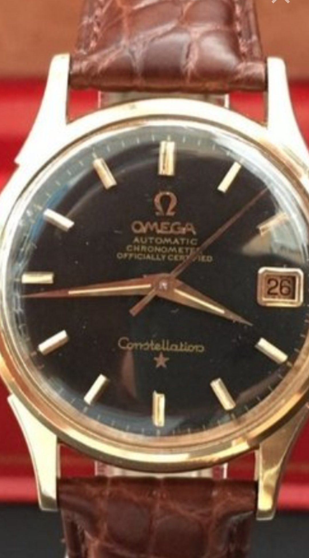

Good Evening!

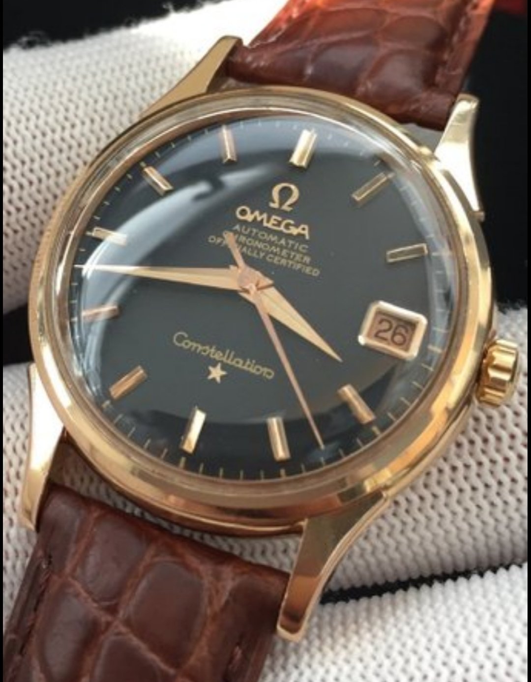

As you can see Im looking for a good and well conserved Omega vintage. What do you think about this Constellation?
Thank you for your suggestion and Advices!
183
576

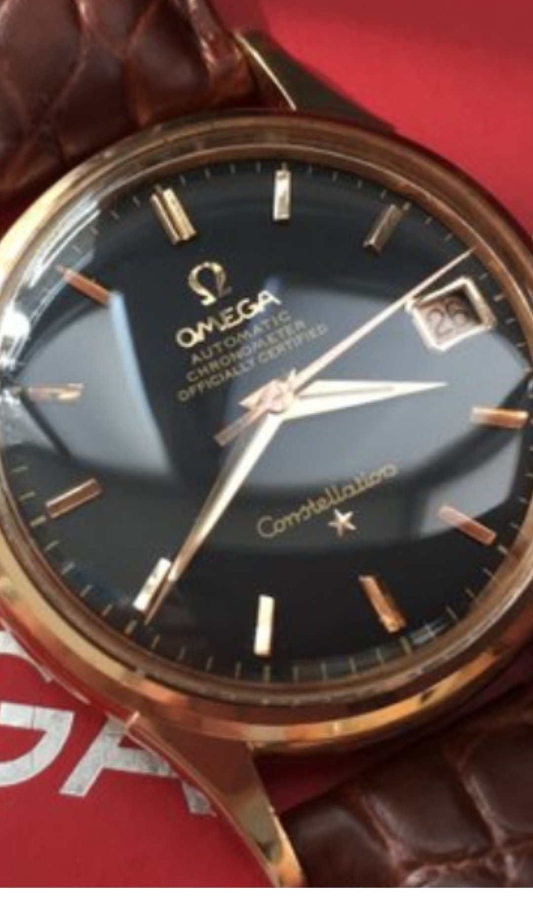

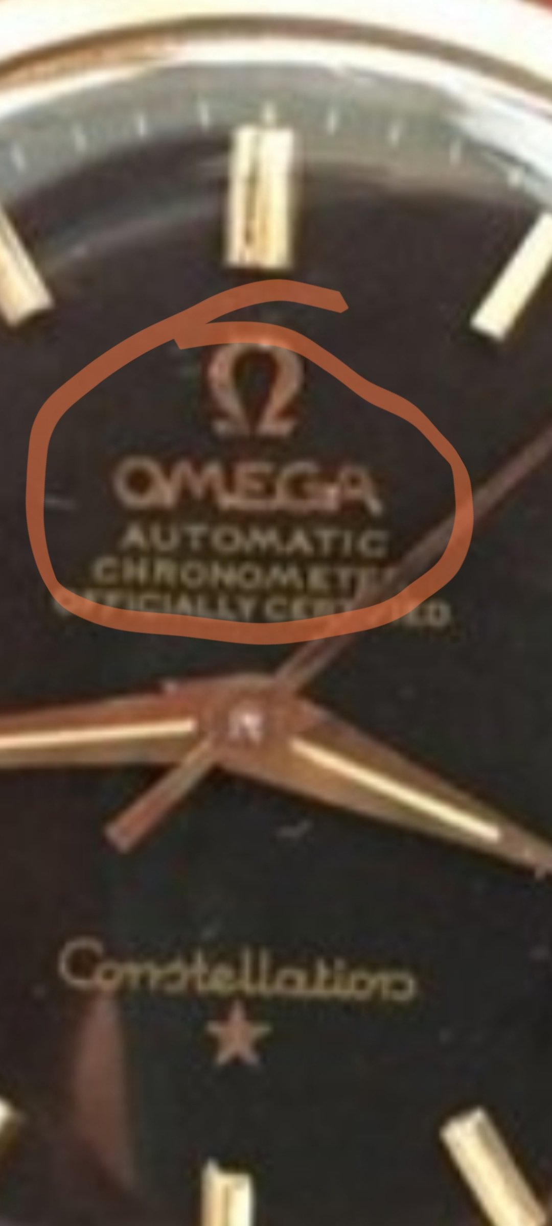

The misaligned indexes with the hour marks would make me judge it as a redial. Also, the Constellation star seems too close to the text.
Black dials on this reference are very rare and more often than not they were repainted when the black dials became more valuable.
But pictures are very blurry and with a bad angle so I cannot be 100% sure.. I think it is better to wait for more opinions.

Trying to post more pictures but yeah they are a bit blurry...Trying to get a good Black Dial Gold Constellation...maybe this one isnt the best...

How many 14393s have you seen with straight n in Constellation?
It’s a redial. Won’t be easy to find an original black dial in solid gold.

As I thought... Not the best deal for 2000 eur everything considered....Ok I Will wait for another piece... Thank you very much!

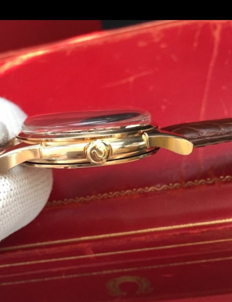

All photos are very blurry- sometimes deliberately by seller- always a warning sign.

The price also tells you a lot. If it sounds too good to be true… you know the rest. That’s the difficult thing about finding a good piece: Had this been an original black dial in good condition, it would’ve lasted minutes, maybe hours till it was gone. So for a bargain you’ll have to be patient and quick; to be quick you’ll have to know what you’re doing. This isn’t meant as an offense, don’t get me wrong. But you might have to pay up until you’re comfortable evaluating a dial on your own. And even then you’ll need time and luck to find a good one for an even better price.

Yeah Im studying Constellation Dial from 3 months
but like an idiot I thought this one was good. I Will be more patient... Sorry for the disturb and Thank you to let me save my money!
PS: Clearly isnt centered with Omega so yeah not a bargain

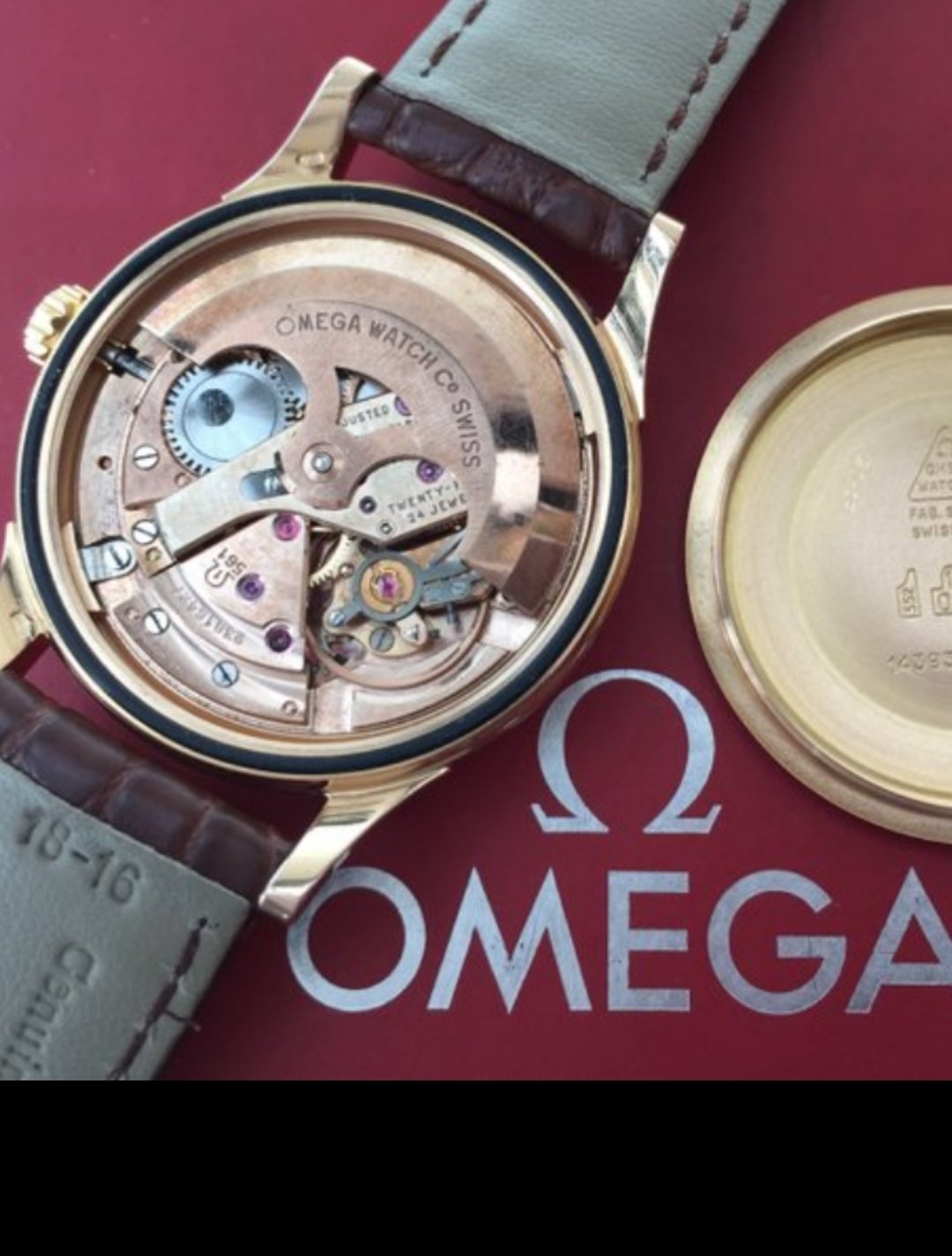

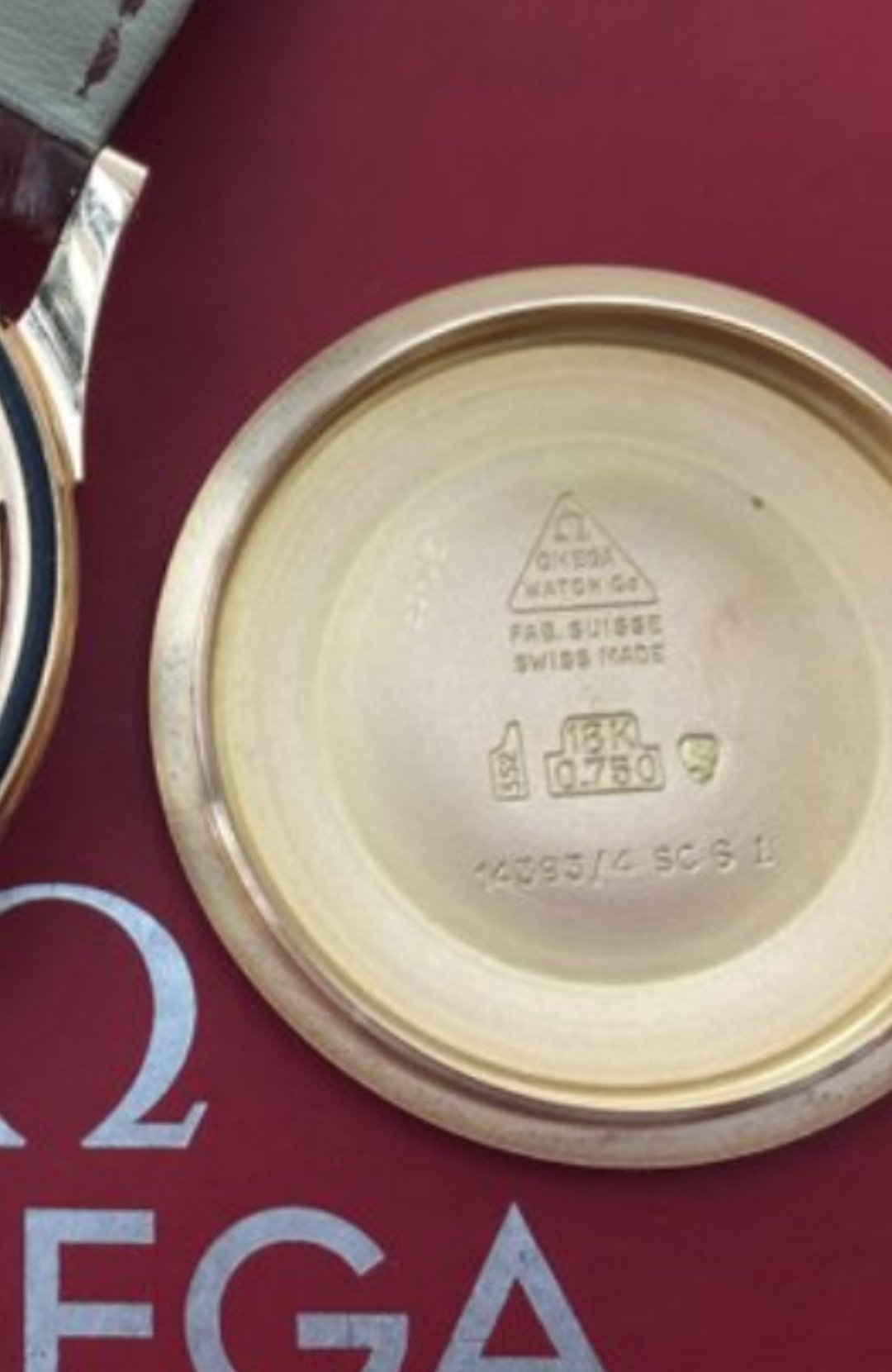

Apart from the redial as others have said - a 23,8xx serial movement in a 14393?
345
3,378
Omg... I didnt notice that... Thank you guys...
3,596
13,553
Good point. I gotta admit, I stopped looking further after the first glance at the dial, but that’s another downside.
