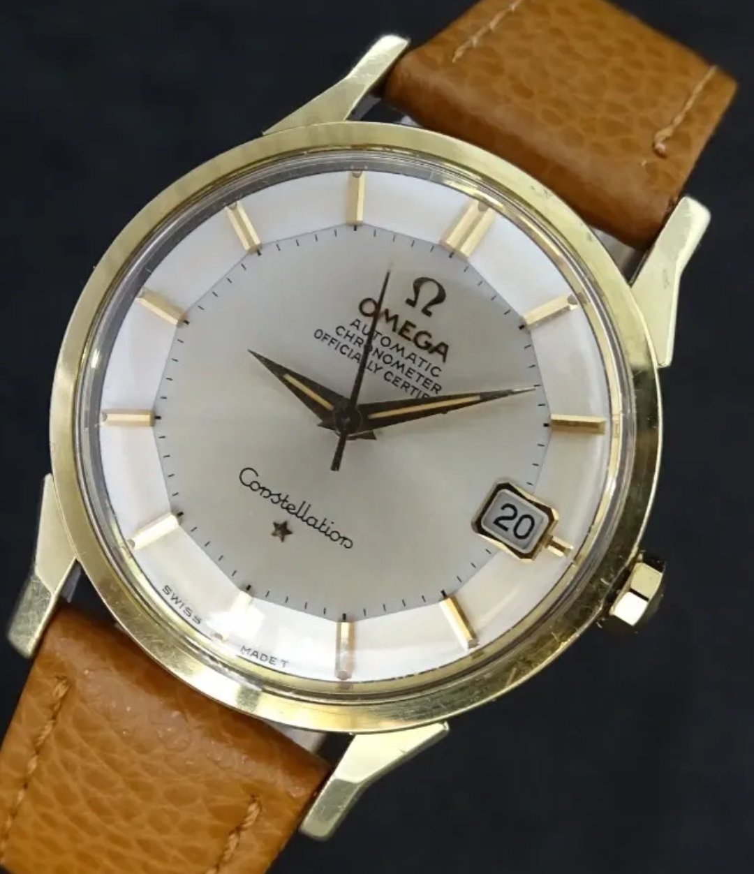

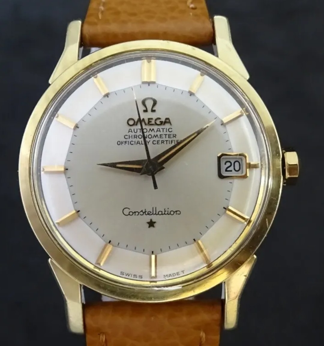

Hello! As my earlier posts show, I am looking for a Omega watch for my partner and he really likes the Constellation watches with the Pie Pan design. I am woefully inexperienced in all that is watches and am unsure what to look for in a watch. I see plenty of watches for sale on Ebay but to my untrained eye, I am not sure if they are legitimate, worth it or going for too much. Here is one watch in particular my partner likes and would be grateful for views on it. Here is the link: https://www.ebay.co.uk/itm/23474720...tem36a8062347:g:jqcAAOSwN4xjUe0V&LH_Auction=1
I also attach photos for posterity.
Grateful for any views!
Cheers,
Morgane
24,836
55,256

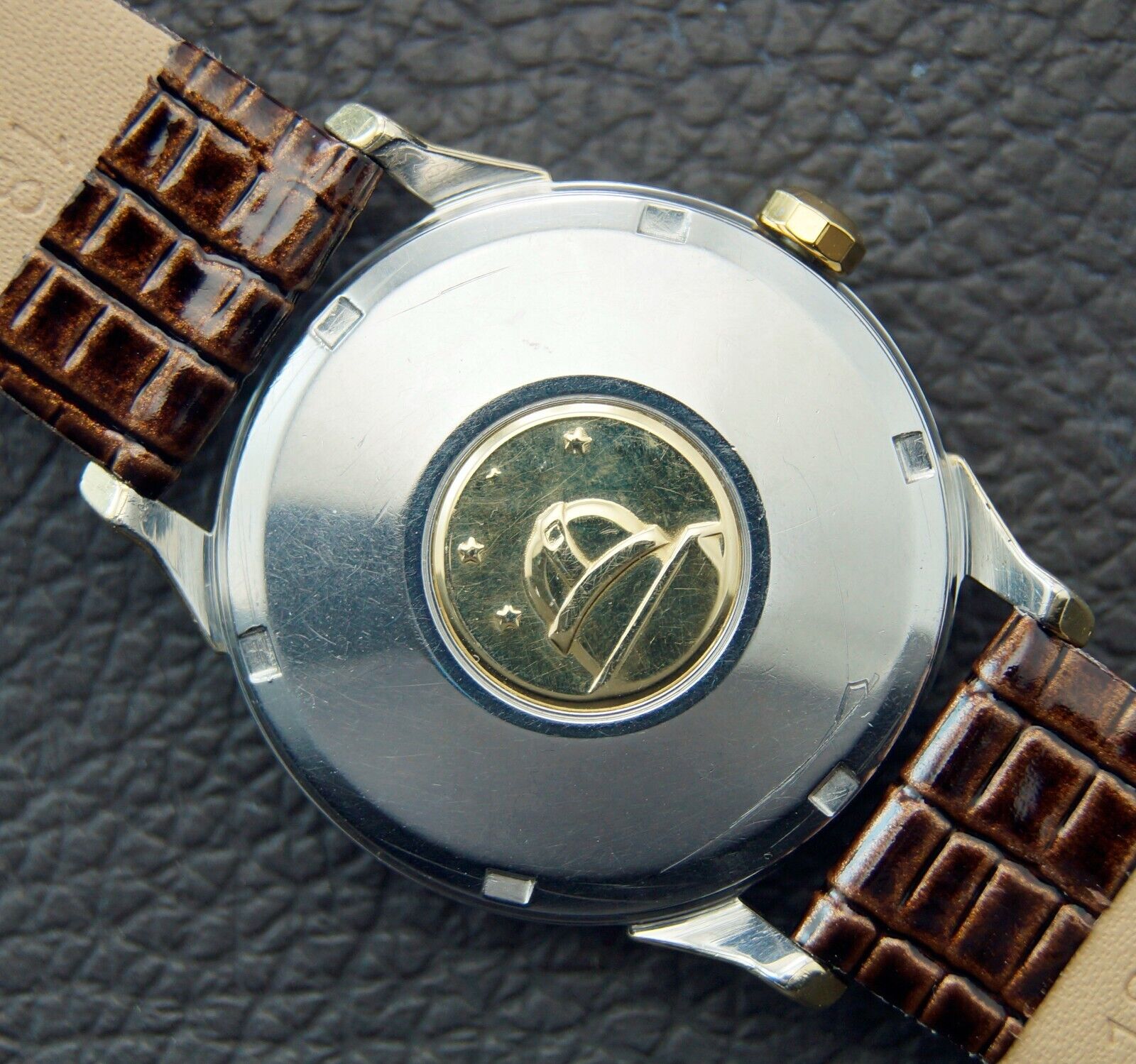

It looks like the case has been so aggressively polished that the gold cap is completely worn through at the tips of some of the lugs. And some of the stars are missing from the medallion. You want to look for a case where the original lines of the case are still visible and not totally softened and rounded from over-polishing.
223
411
I will echo what Dan S said, it appears to have been polished quite a bit - which isn't necessarily a bad thing but on a plated/capped case it can be quite unattractive. I'd honestly suggest looking for a better example.

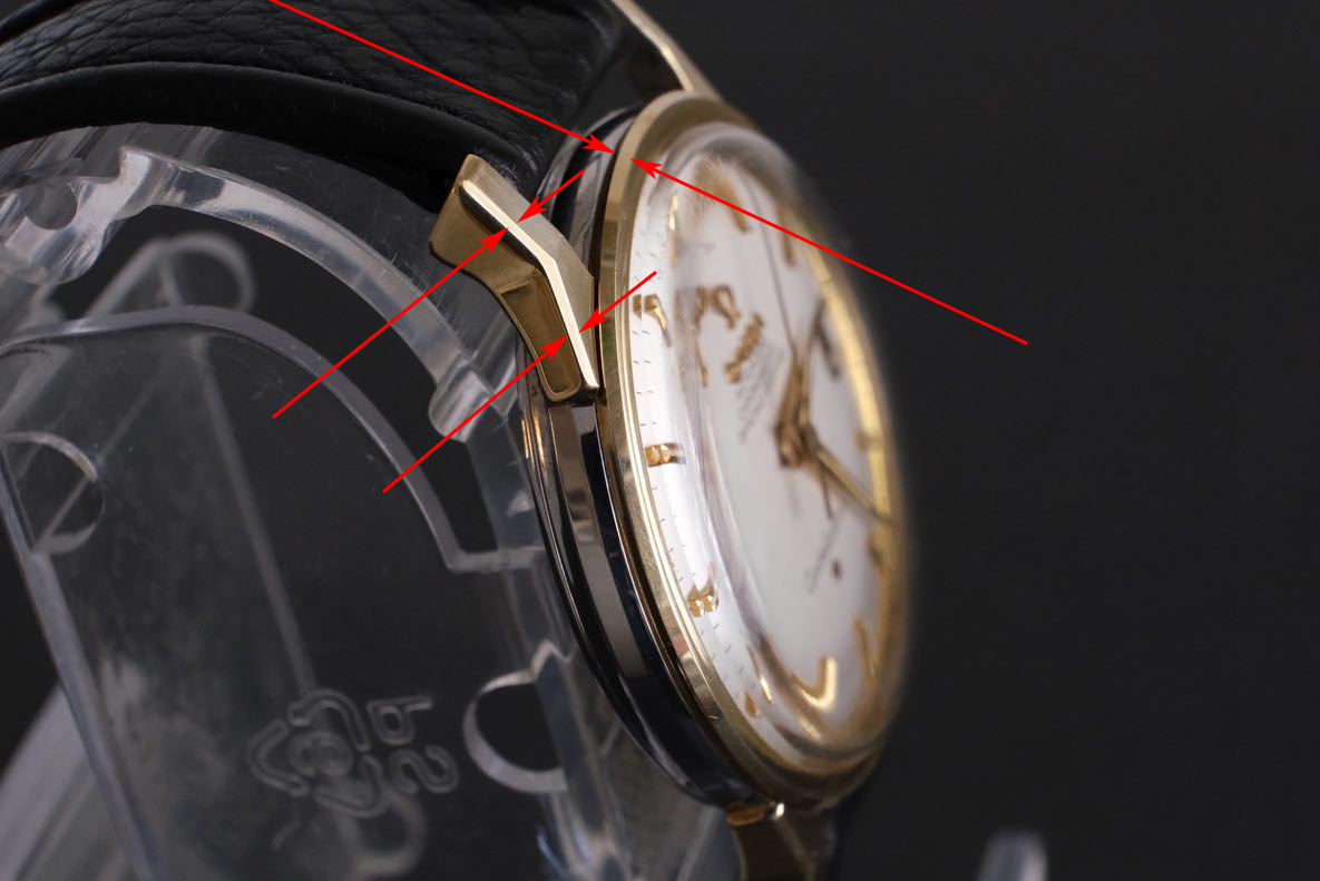

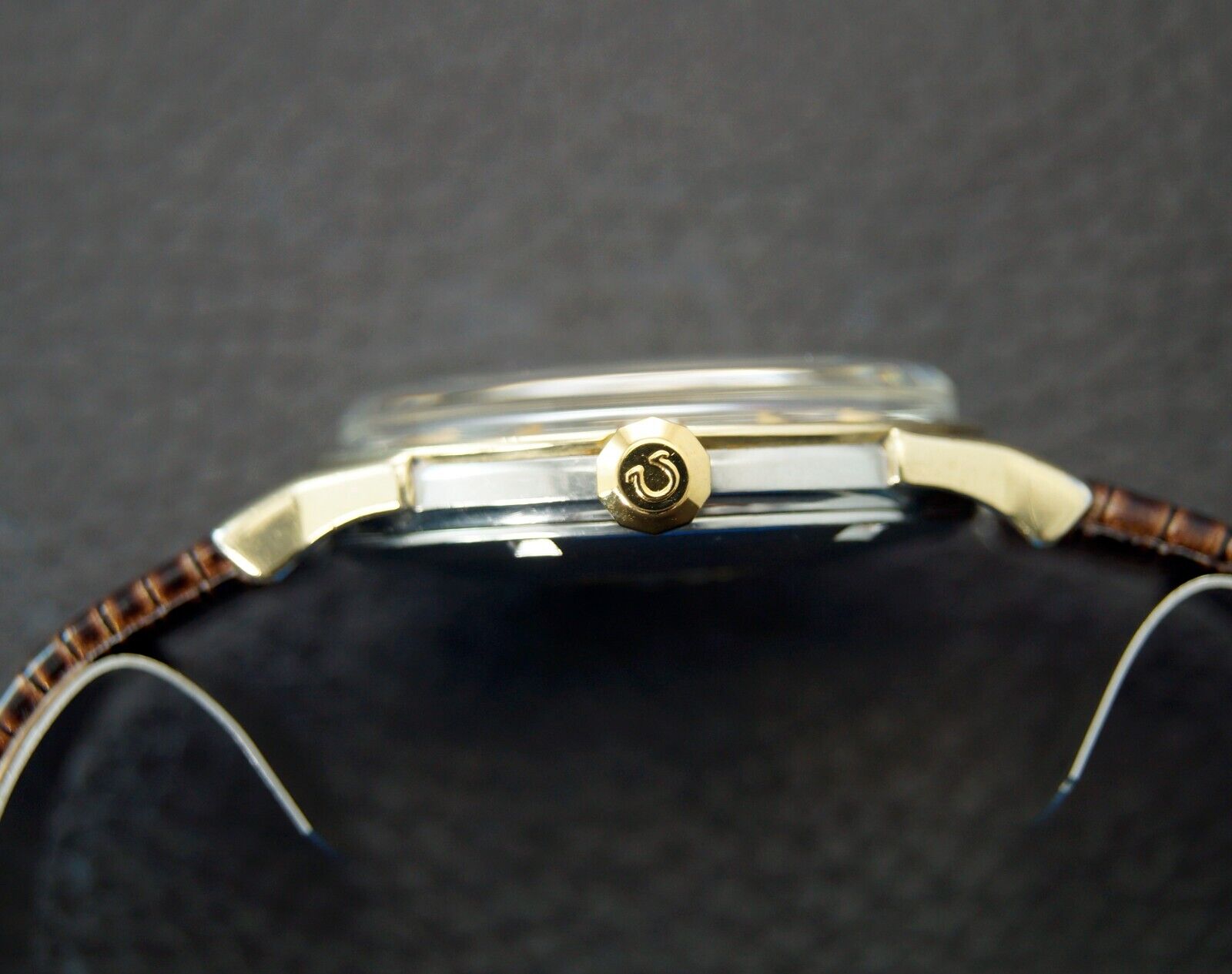

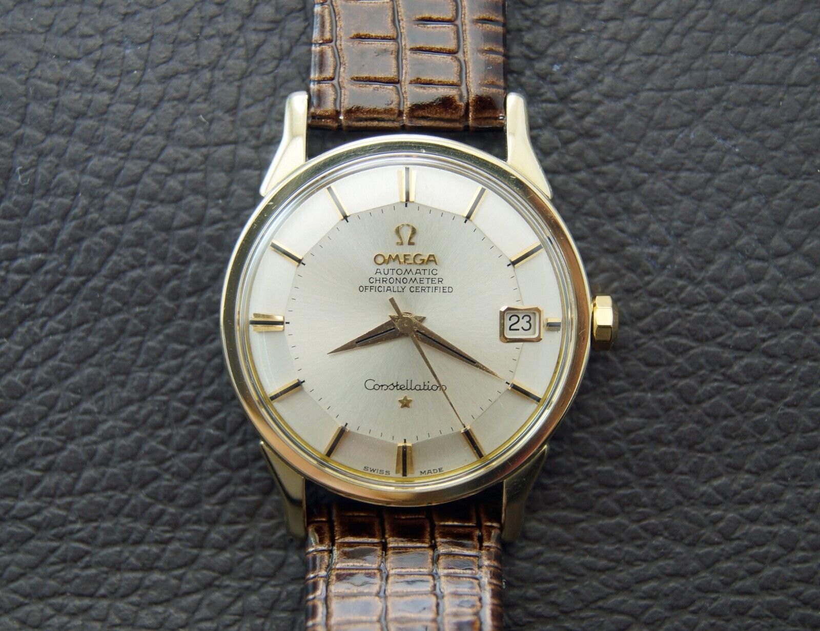

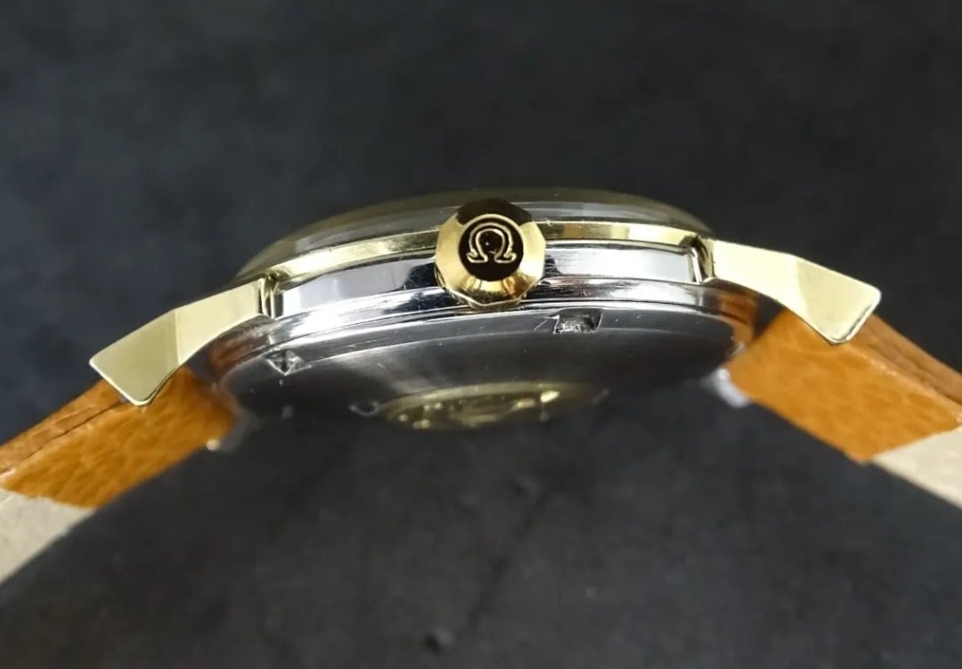

For reference, this style of case, often referred to as "dog leg", should have nice sharp facets and edges on the lugs and bezel. Some softening of the edges is perfectly acceptable and even expected at reasonable price points, but compare the example I have posted here to the two you have inquired about.

What a great teaching post thank you! I often overlook the bezel when assessing the case.

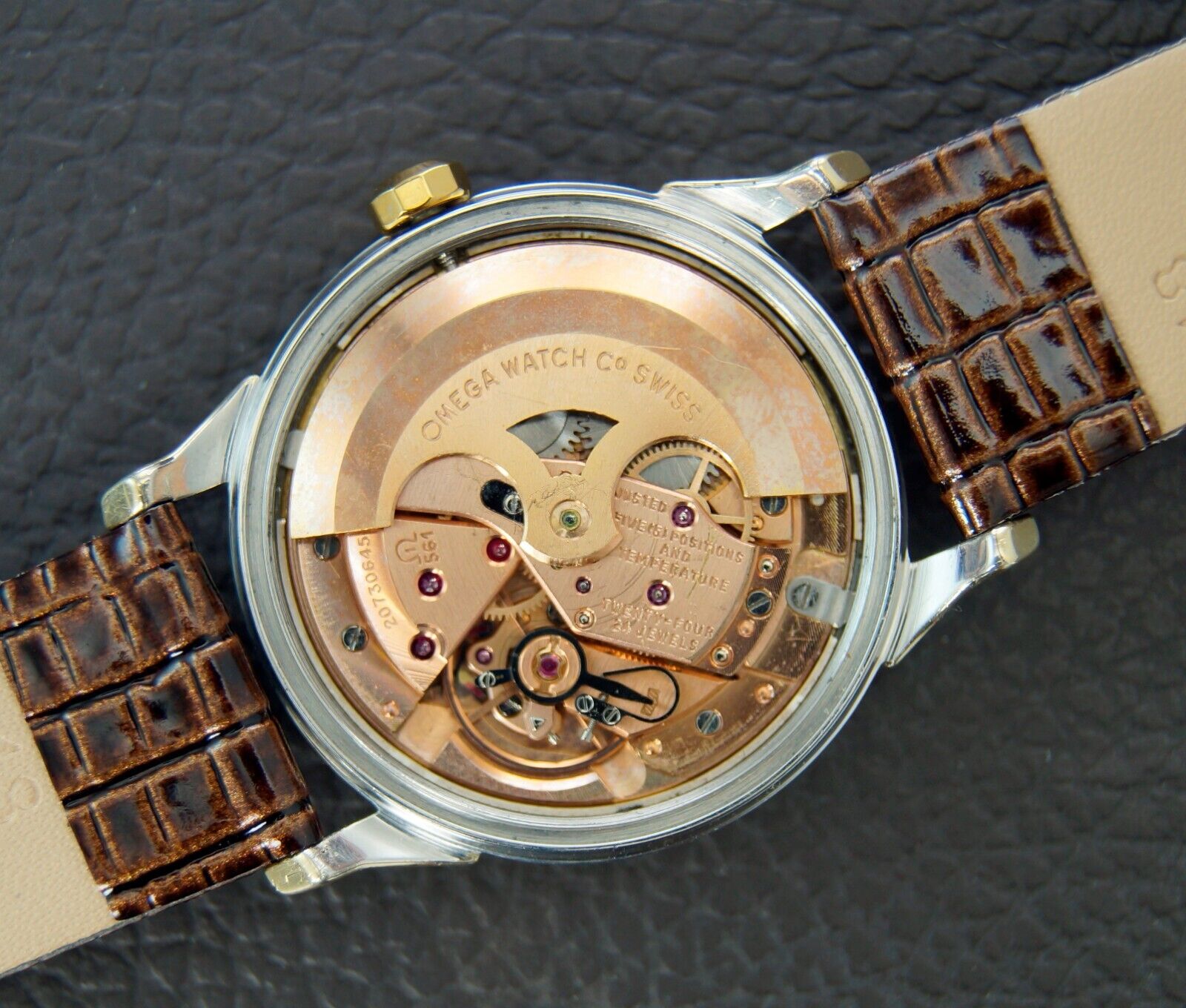

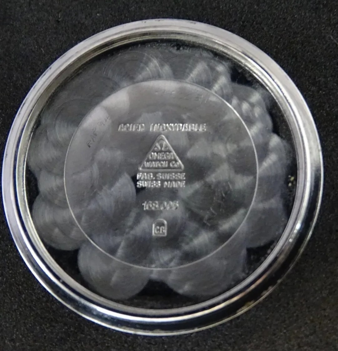

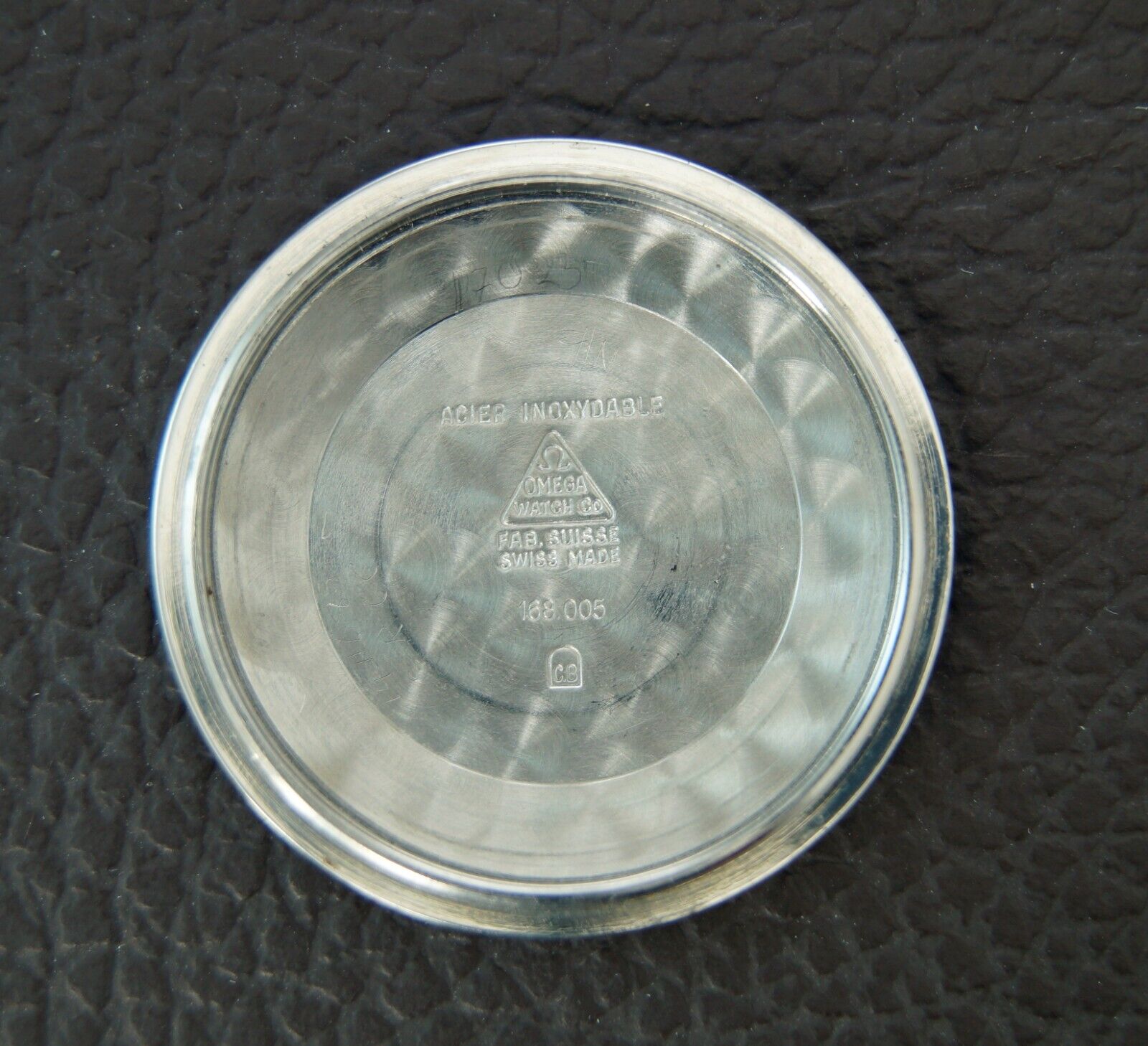

The watch you shared has some wear on the inside of the case back that means the rotor could be loose and need repair or replacing. Most vintage watches bought at auction require service from a watchmaker, which costs between 200 and 500 dollars/euro/pounds.
The very nice watch linked above by Dan that's for sale in this forum is a great option if he likes stainless steel. Buying here is the best way for noobs like you and me to get authenticity and quality. PLUS, it's been serviced recently.
If gold is his preference, it will be harder to find one with the nice sharp edges that make dog leg constellations so cool. There is a gold capped 168.005 on eBay (no reserve, low bid at the moment but it's early) I was considering suggesting. The inside of the case back looks weird, though. Before officially recommending it, I thought it would be best to get feedback from experts. The listing says it's been serviced, but that usually doesn't mean much on eBay unless it comes with documentation.

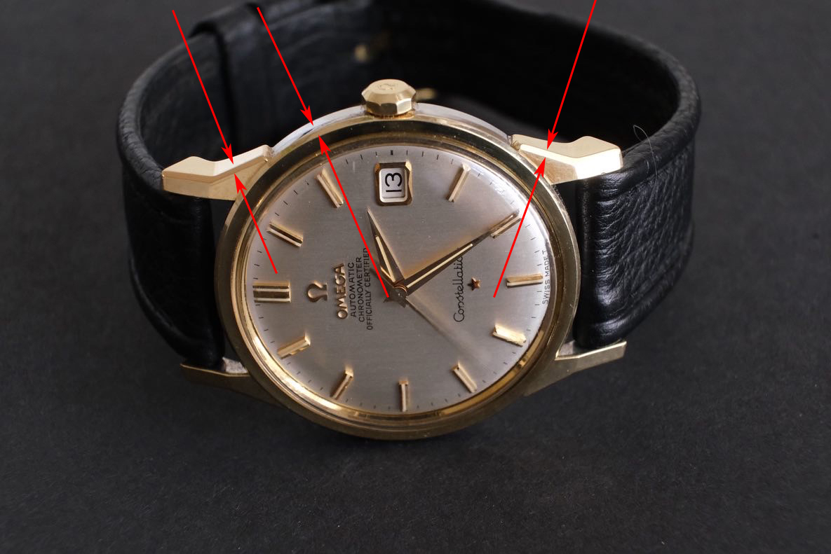

Excellent information. And as I’m the current owner of this exact watch, I can assure you the edges are indeed quite sharp 😀
