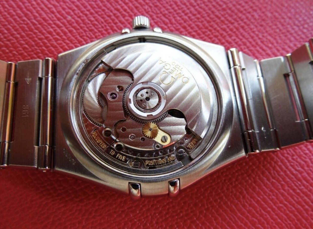

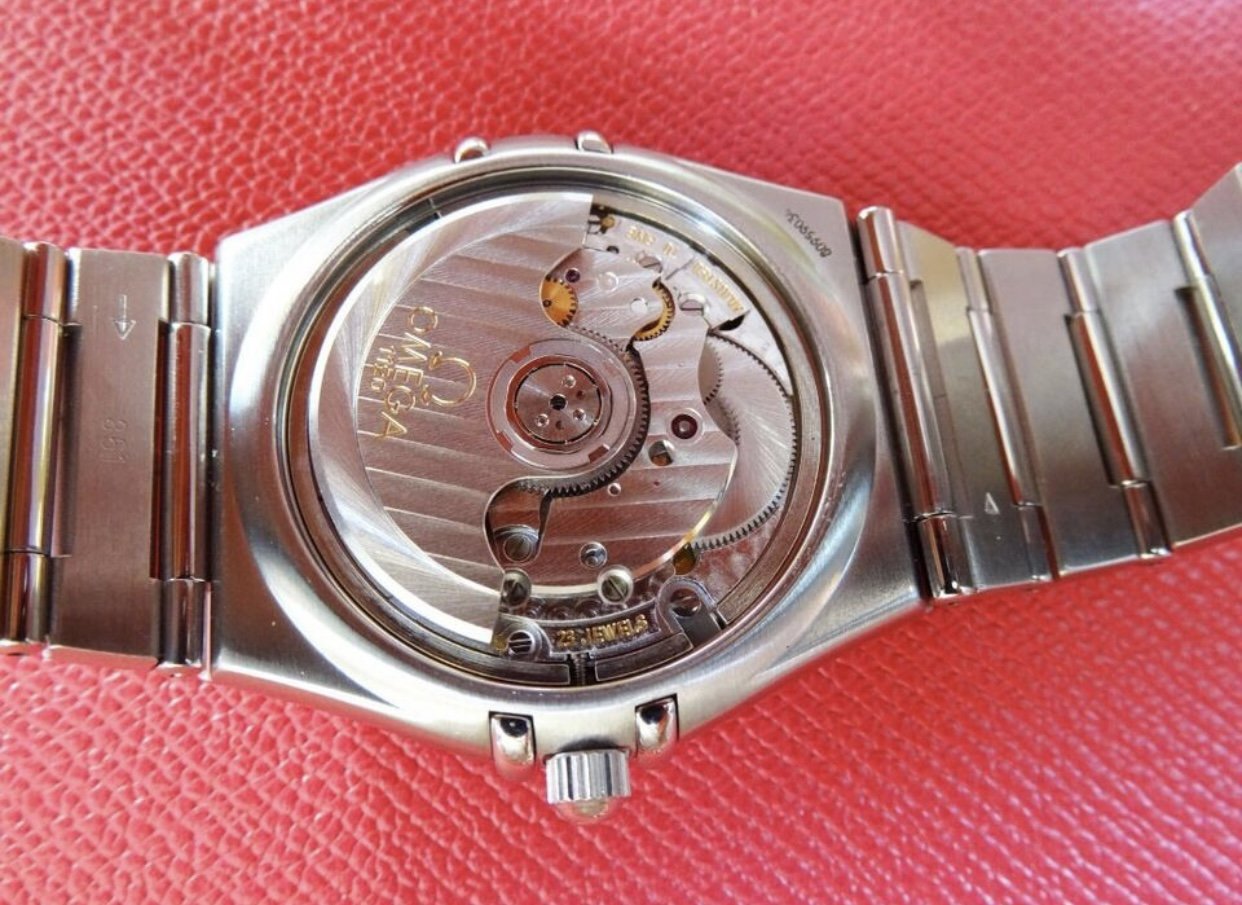

I am also not as familiar with the more modern movements. Typically Omega movements use a beryllium copper finish. This one looks more like an ETA Swatch movement.
Best to wait and learn before rushing in.

What you say. Actually goes in line with what I’ve read about the 1120 movement so far.
“The Omega caliber 1120 is a movement from Omega that is, like so many other movements from Omega’s history, based on an ETA movement. More specifically, the ETA 2892-A2.
Omega has then modified the caliber to give it better performance and to make it more visually pleasing. The original ETA movement has 21 jewels, but Omega’s modified version has 23”
so atleast that seems to check out so far.

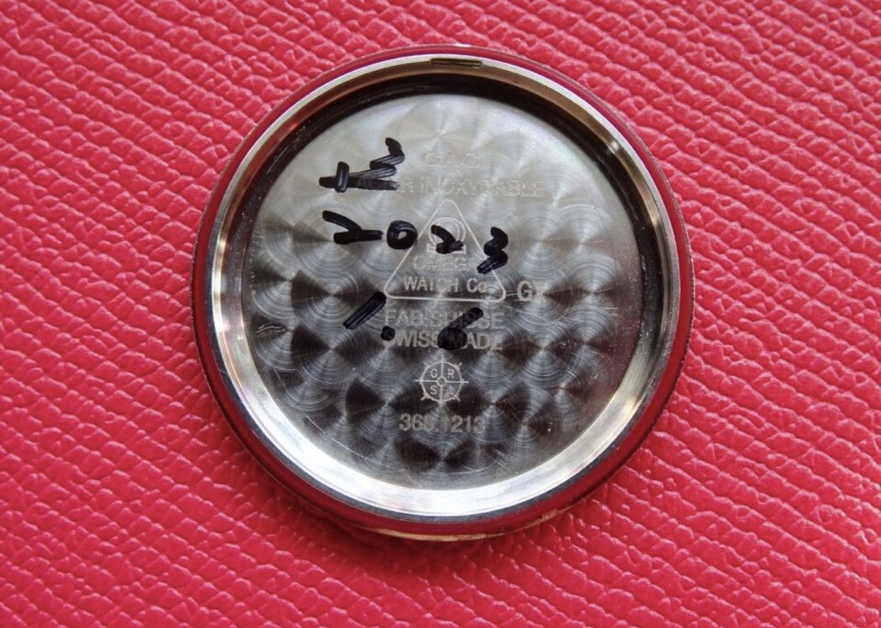

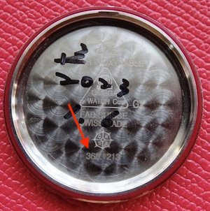

Looks fine to me.
368 = Gents watch / Self-winding Centre Second / Water-resistant Chronometer Calendar.
..... Typically Omega movements use a beryllium copper finish........
Later movements changed to a white (silver) Rhodium plated finish.

Looks fine to me.
what do you mean by 368?

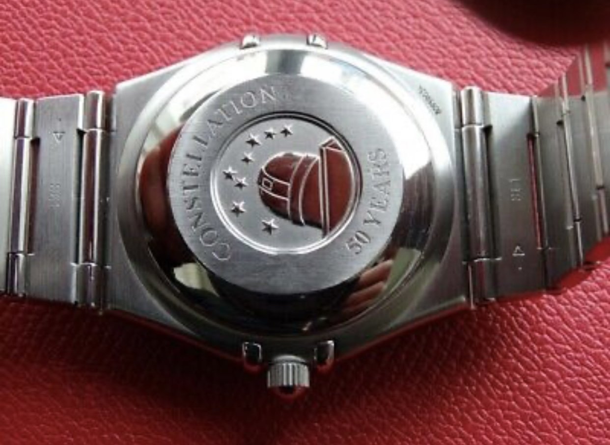

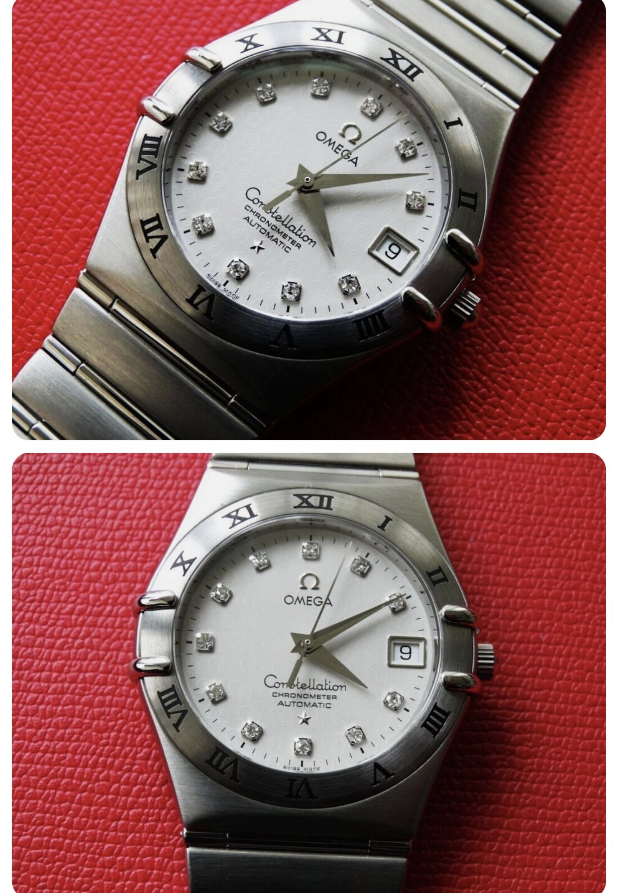

Yea this is a modern mid-size piece ~36mm so fine for both men and women, the Cal 1120 is Omega’s main workhorse movement of the 2000’s and is very solid, accurate and reliable.

Interesting print on the dial and I like the hands. Very cool.
