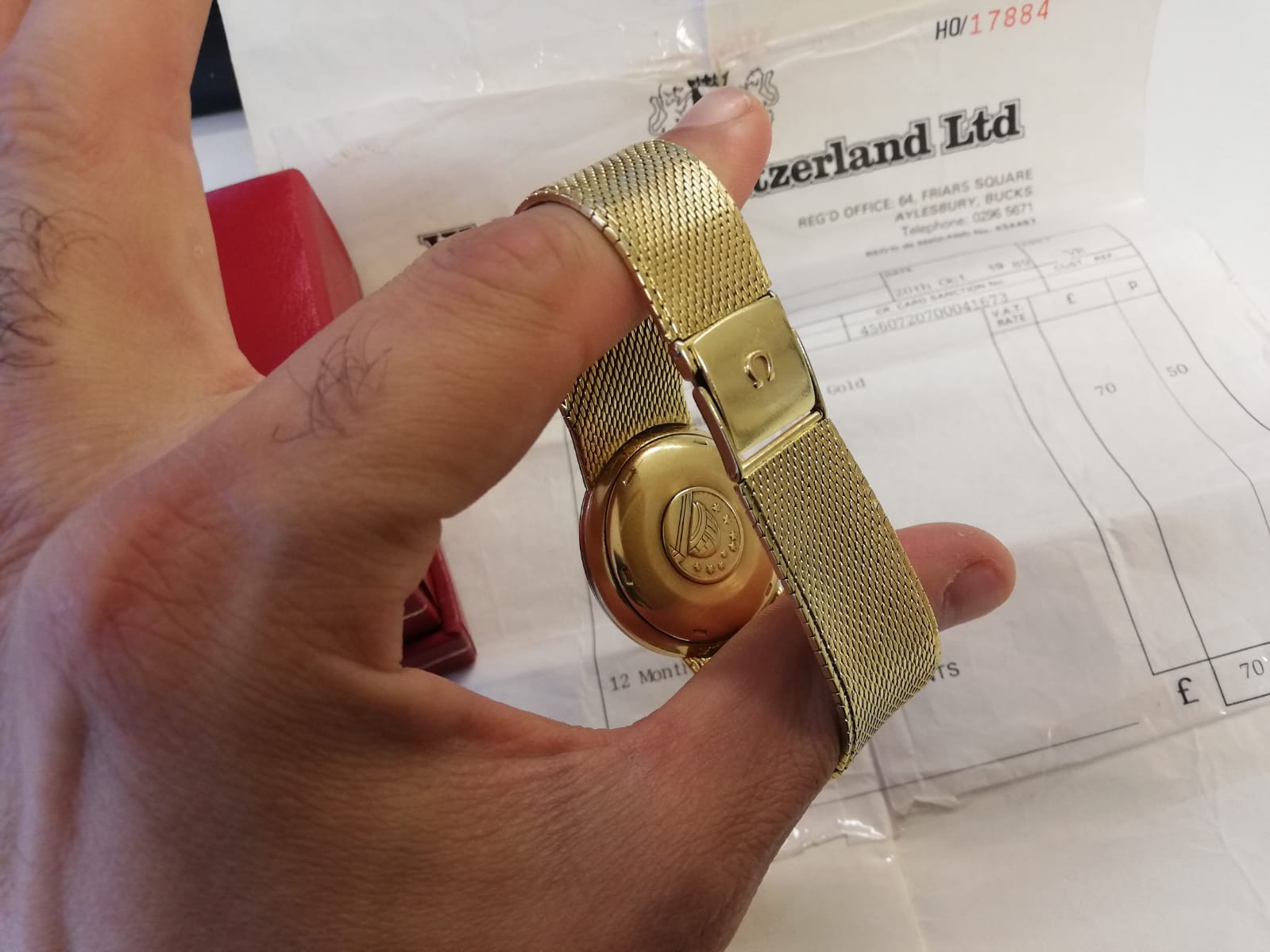

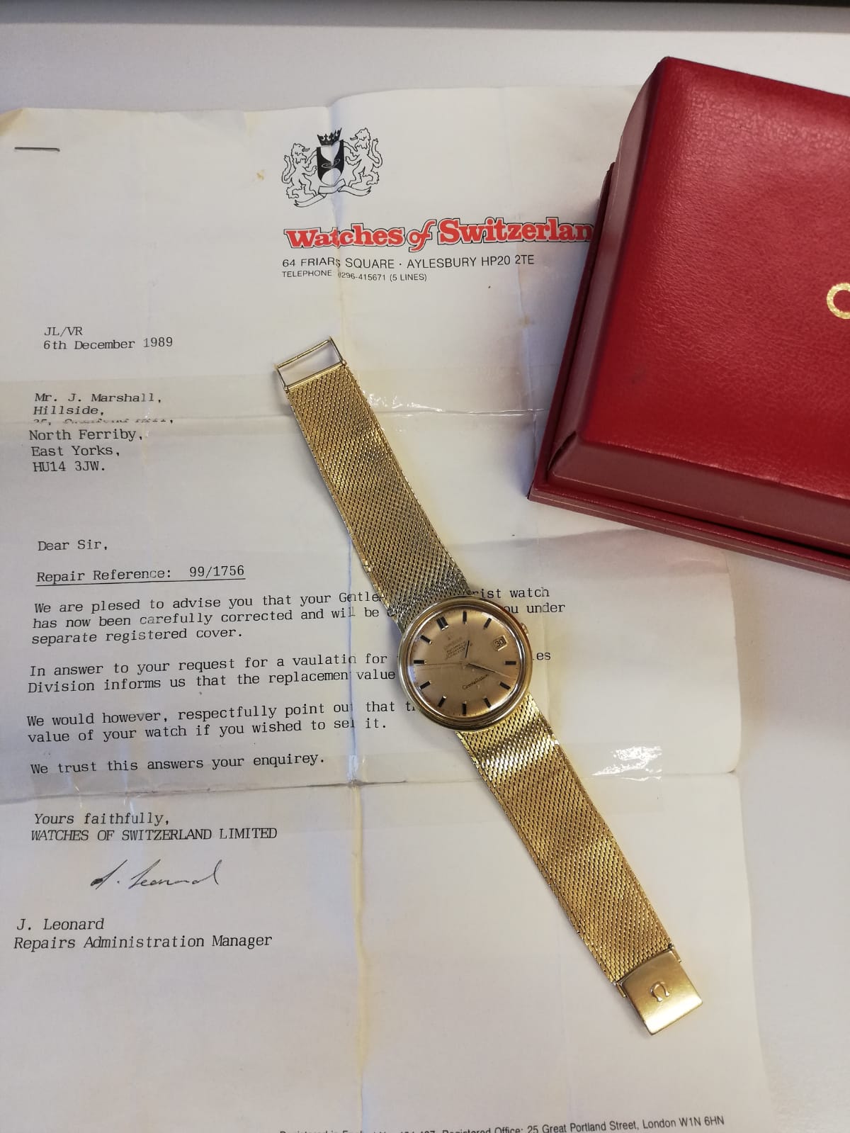

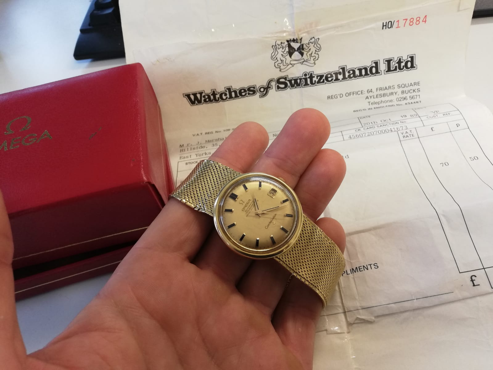

Hello everyone,
I was hoping you all can share some knowledge on this Omega Constellation. The watch belonged to my grandmother and she even had the original omega box along with some document of when it was last serviced in 1989.
Any info will be greatly appreciate it.
Thanks in advance.

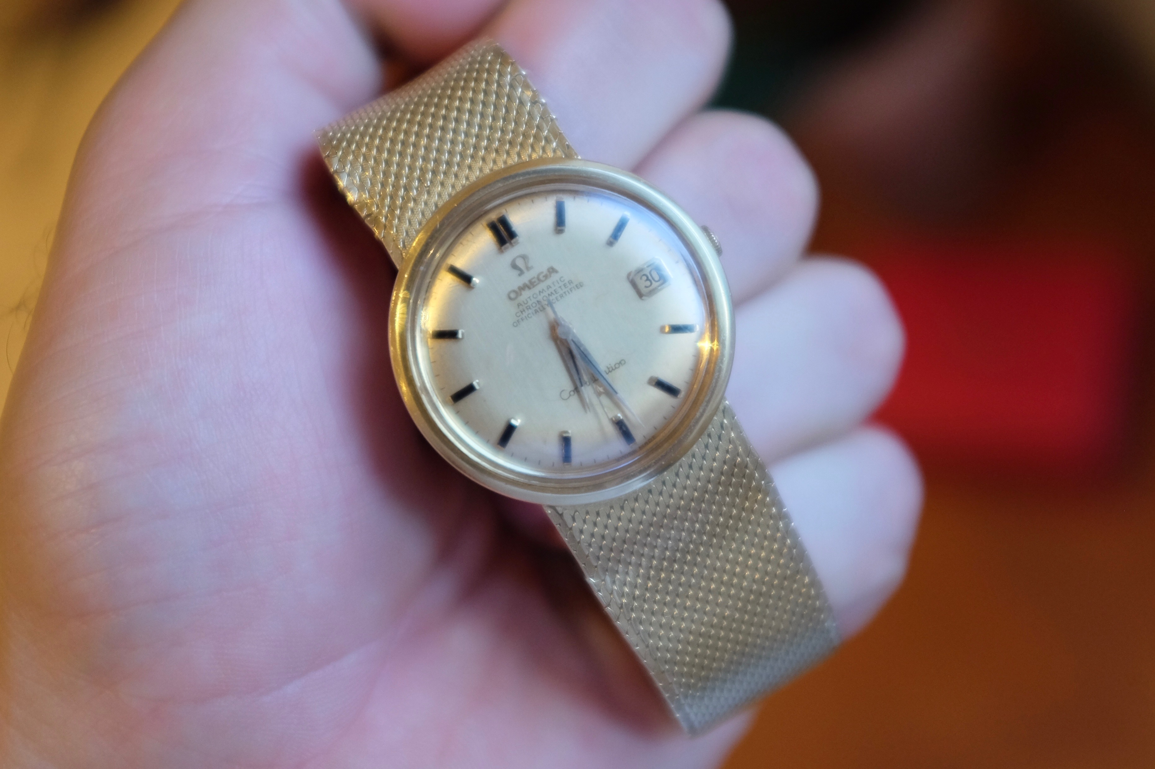

Mid-1960's Omega Constellation. Probably a UK made case and bracelet under license from Omega. Here is a similar watch from a 1967 catalog.
Watches like these are valued by gold content with maybe a few hundred for the movement. Not particularly popular today.

Looks like it is powered by a 564, that means you can pull the crown out one more notch and the day jump forward.
The intergrated bracelet is a big disadvantage every time it changes owners and looks like it has some streched/ damaged spots.
Value is estimated correctly by Gator.
