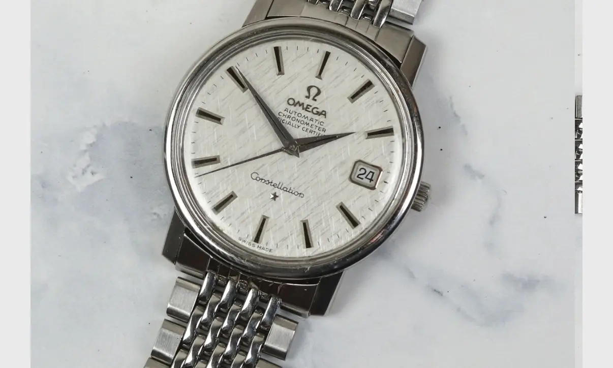

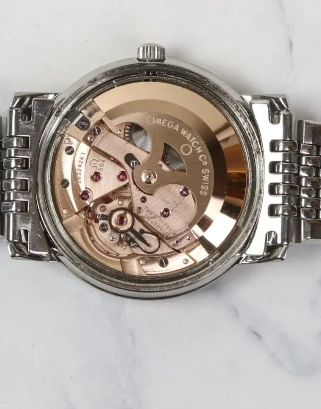

Sono interessato ad acquistare questo orologio. Potreste confermare che è tutto originale e le condizioni del movimento? Quale sarebbe un prezzo equo senza il bracciale?

I am interested in purchasing this watch. Can you confirm that it is all original and the condition of the movement? What would be a fair price without the bracelet?

You will get a better response if you share the research you have done on the watch.
You can find completed auction sales on the reference by searching EB to get an idea of price.
Also sharing the asking price is good idea.

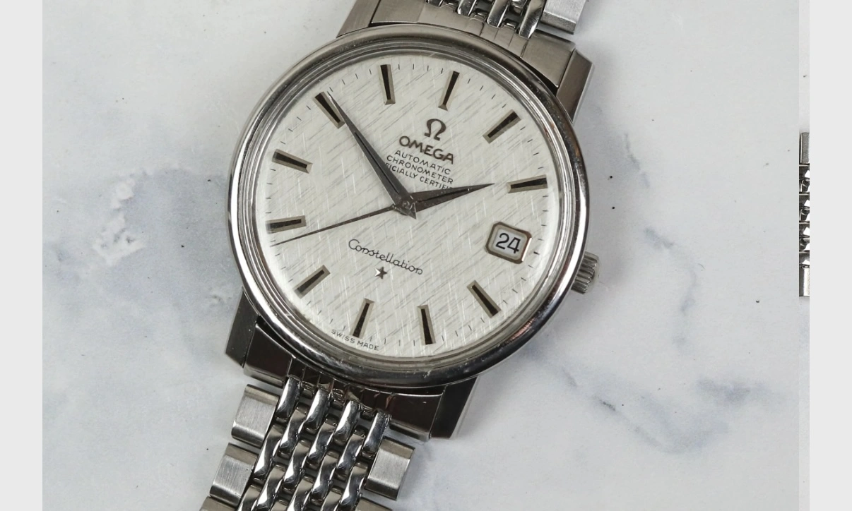

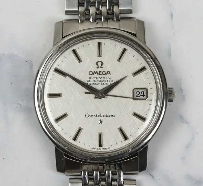

I don't see anything immediately suspicious. The 1 dial movement looks pretty messy, but I think those might be compression artifacts.
Looks like a bunch of people asking ~1200 USD on Ebay, though the last 3 sales(only ones this year) were $650, $850, and $900.

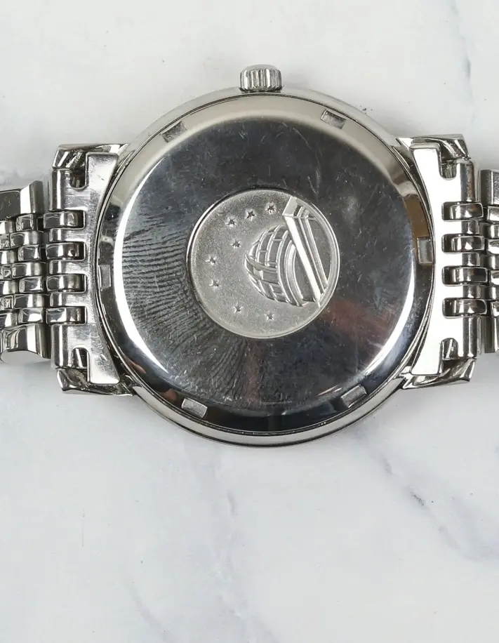

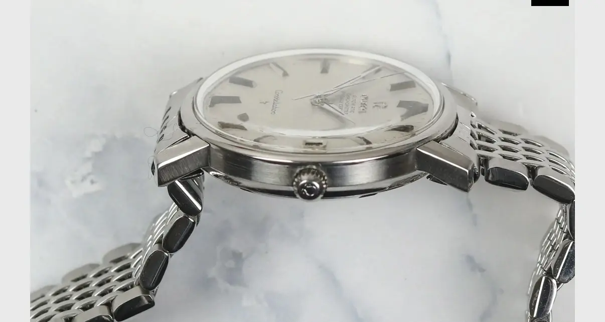

the case is polished, so that the lugs have lost their definition
but the bezel has been so heavily polished that it doesn't look like it even belongs on this reference.
@Yayatar16 look at the other 168.016/168.018s we discussed -the bezel should be flat around the crystal with radial brushing and then a sharp edge that then chamfers away from the flat section
